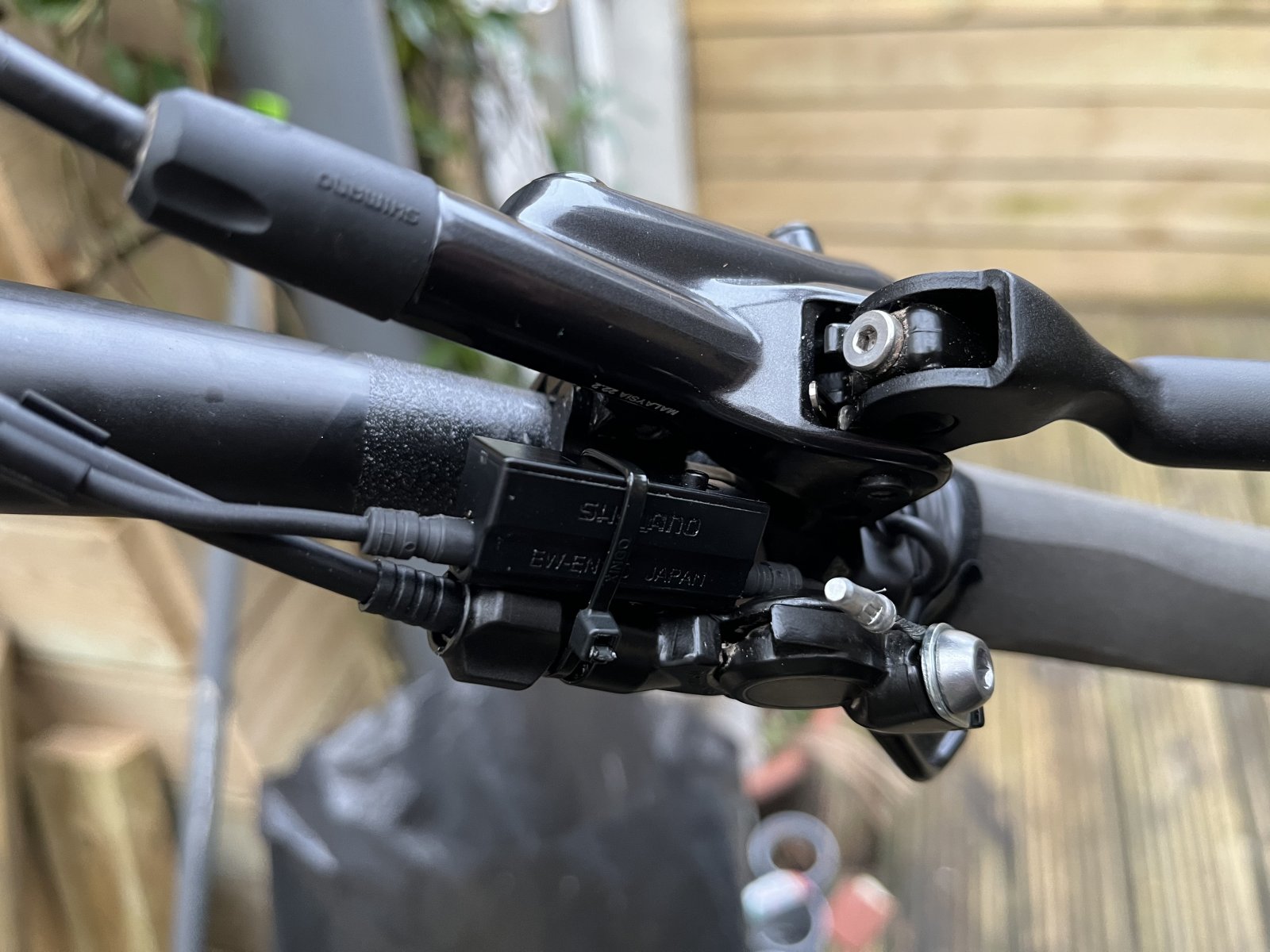

Can you post some more photos of how you have it mounted near your lever? What size frame do you have that required the extra wire length?
Yeah, no problem. I’ll take some in a bit.
i don’t think the frame size would matter as the cable from the black box to inside the headset is very short (150 or 200mm I think) but my frame is XL anyway.

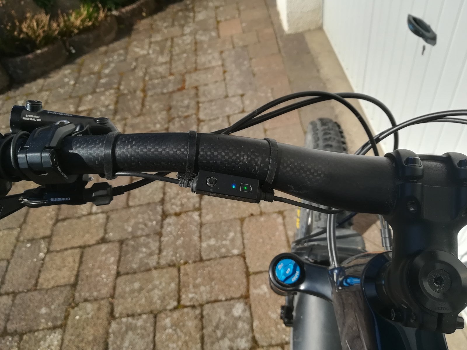

nice idea to hide the EN100 completly.
I did not like the the Orbea factory solution either and attached the box to the handlebar.
This solution does not require any cable changing and is quite unobtrusively.
All you need is a piece of outer shiftcable, and some cable ties.

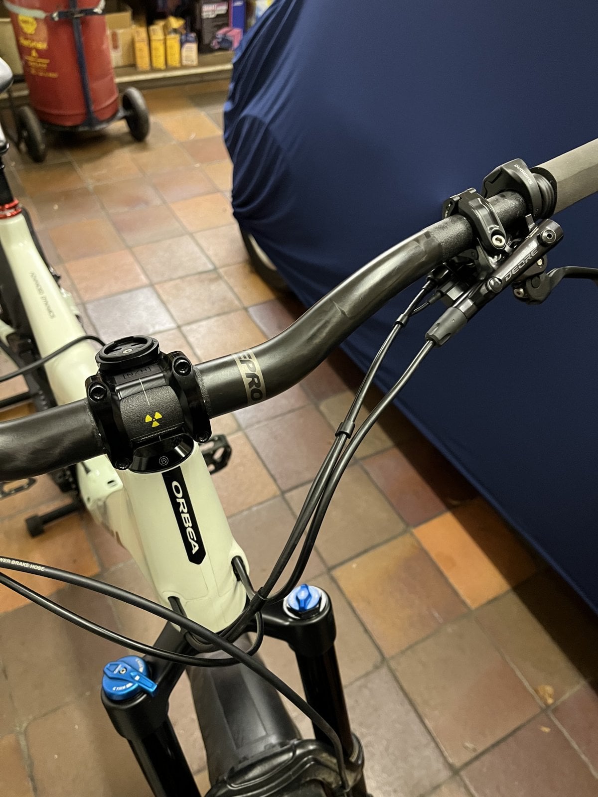

AAANDD… built my wife a small Rise! Most of the parts were from her Scott Ransom. As pictured is 40.5lb. Can’t wait to take these two bikes out!
How did you get this space there between the frame and the stem? Are these spacers of some sort?
My fork steerer is cut such that the stem starts exactly on the frame. Is it something I can do too and raise the handlebar slightly?
Feels like I lean forward too much...
I bought the nukeproof horizon carbon bars with a 35mm(or 38?) and they are really nice. Still feel like I need some wrist support so maybe go down the ergon grips. Bought the horizon stem to match and looks really nice.
Yes, Im currently planning to get the race face 35 R 35mm rise handlebar (Its more available in my area than the oneup, which by reviews seems even better, but I'll get whichever is available for worldwide shipping)
Im just debating with myself if I should get also a shorter stem than the original one.
I might replace the shaft to improve geometry to my needs, from 140mm to 150mm (with the fox34)
It seems like the original stem is 50mm length, so I feel good trying the nukeproof horizon stem at 35mm. I notice it has also -+5degrees rise. I assume by using the marker lines? Not sure exactly, anyhow seems like it might improve my issues.
I already pushed the saddle a bit towards the front of the bike, so I already felt better riding today. I have a good feeling about shorter stem + 35mm rise handlebar.
Edit: Now I see that nukeproof also has a stem mount for garmin. Yay!
