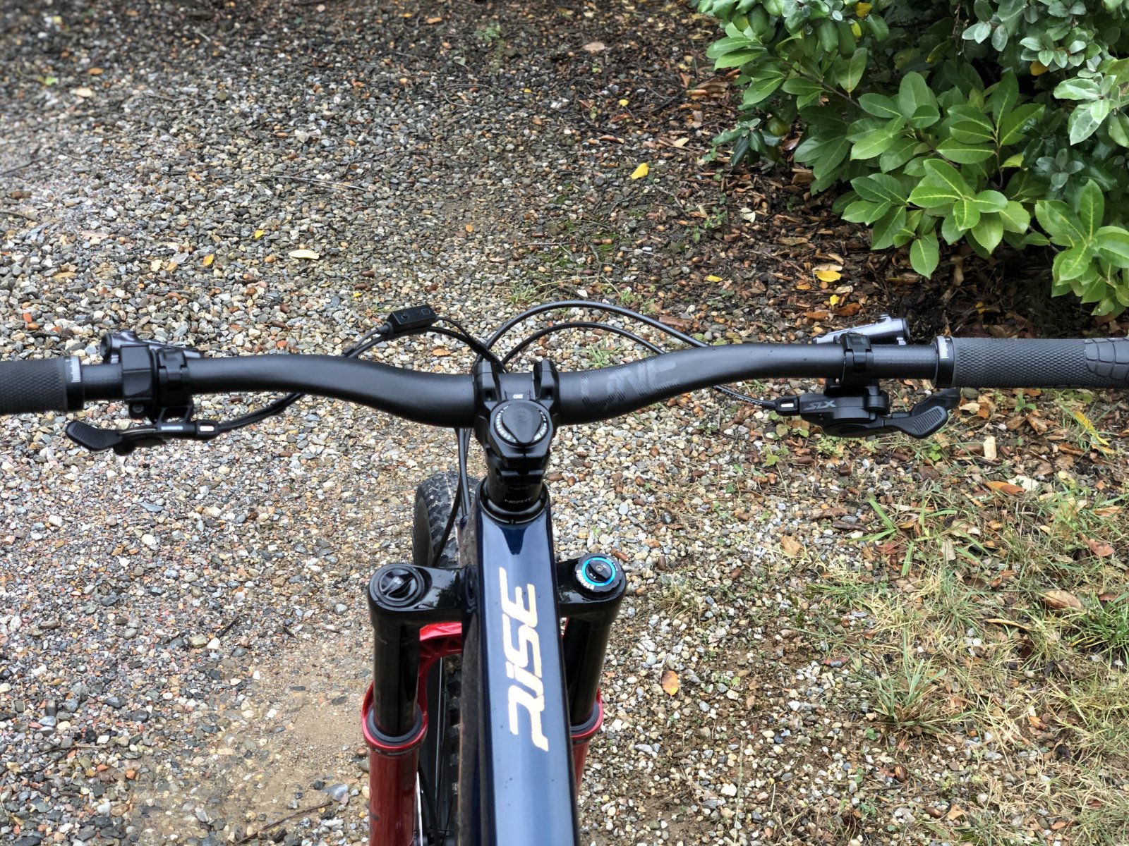

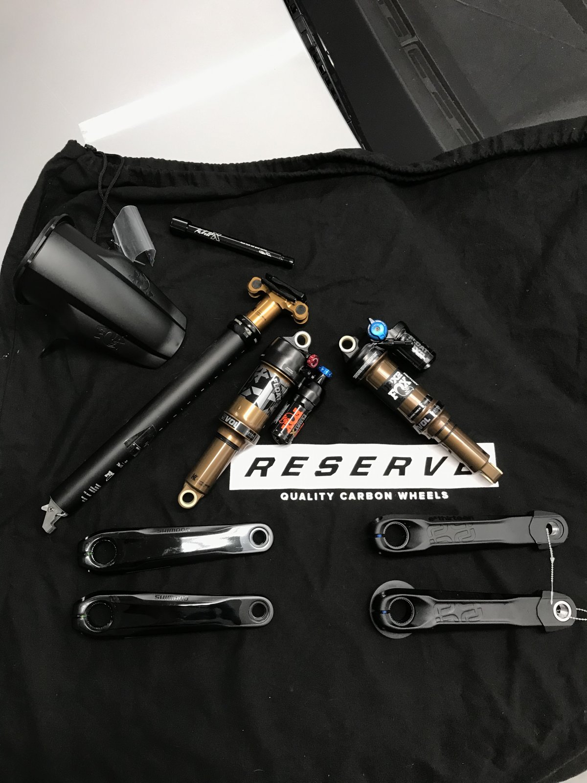

My Rise got an oem Fox 36, and will get shimano 160mm cranks, Fox transfer, fender, kabolt and factory tune Float X. I’ve spoken to Fox and their factory tune works well with the Rise kinematics if you are planning to upgrade.
AAANDD… built my wife a small Rise! Most of the parts were from her Scott Ransom. As pictured is 40.5lb. Can’t wait to take these two bikes out!

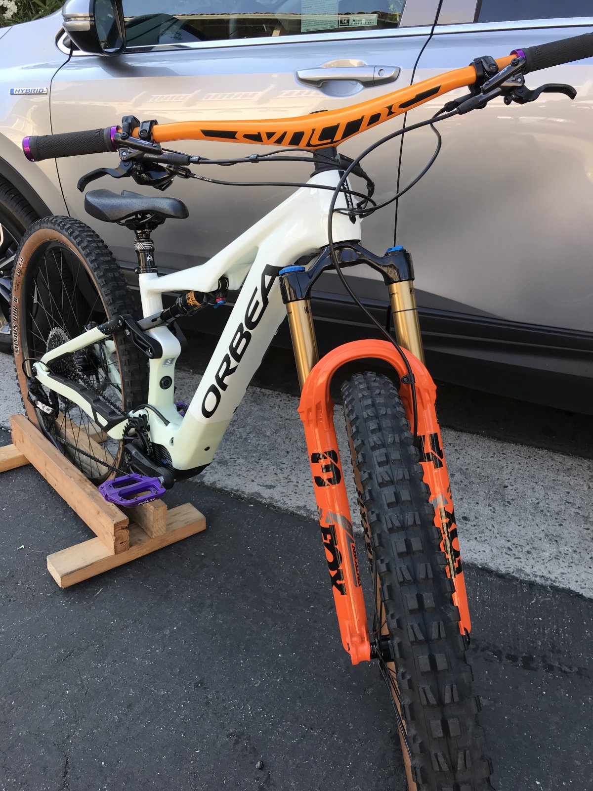

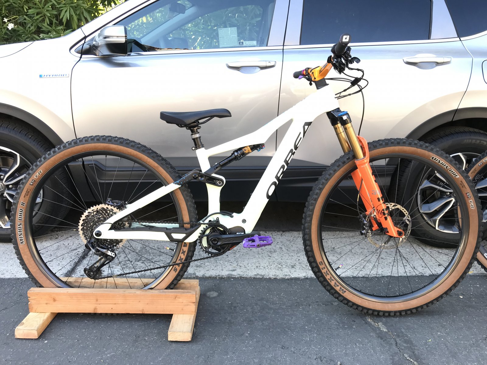

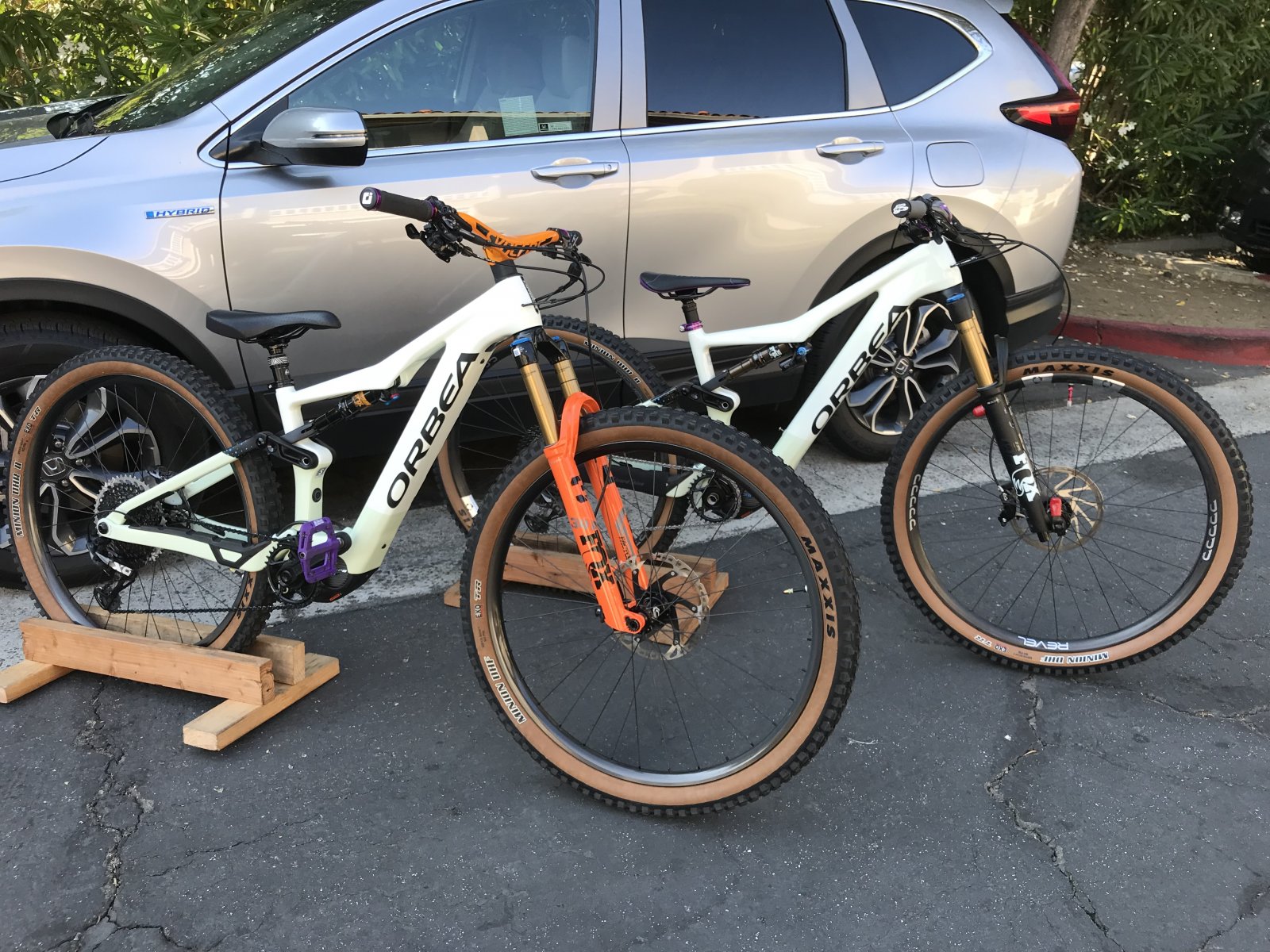

Got my XL M20 last week and I've been changing parts out. Still a lot more to do, but getting there.
Changes so far:
-2022 Fox 36 Factory
-Code RSC brakes with 200mm Rotors
-GX Eagle Derailleur with X01 eagle shifter. Still using the shimano SLX chain and Cassette
-oneup 210mm dropper shimmed down to 190 w/wtb volt wide sized saddle
-one up 35mm rise carbon handlebars w/raceface turbine stem
-DT EX511/XM 481 wheelset on dt 350 hubs
-2.5" 3c Maxx Grip Assegai in front, 2.4" DD DHR2 in back with cushcore XC
-Kona Wah Wah Pedals
Stuff still to do:
-Rear shock upgrade

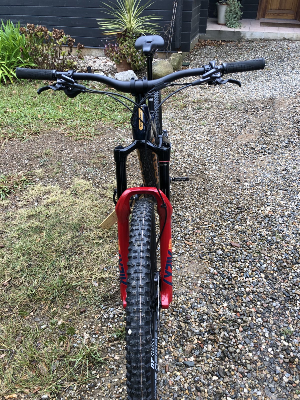

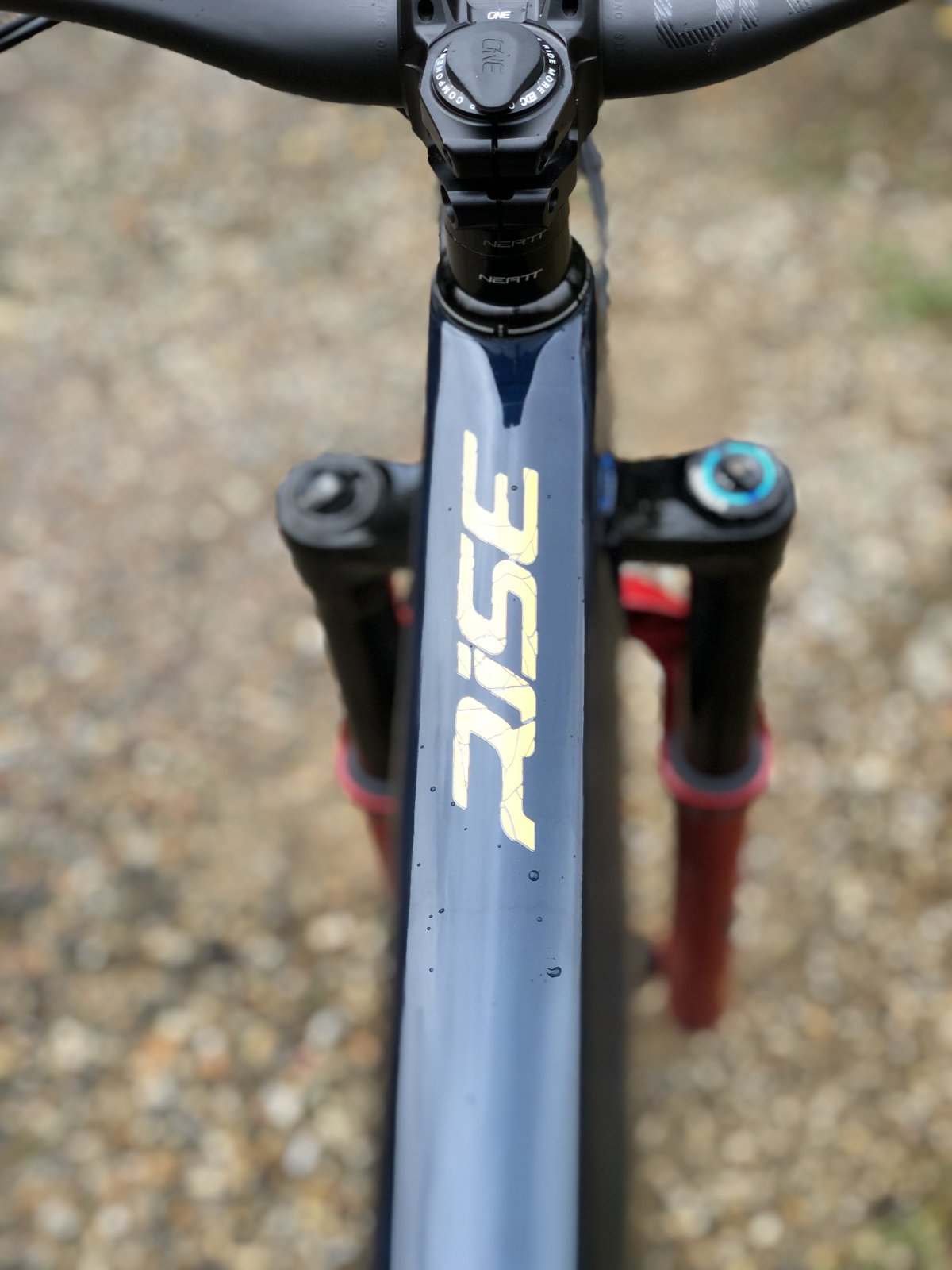

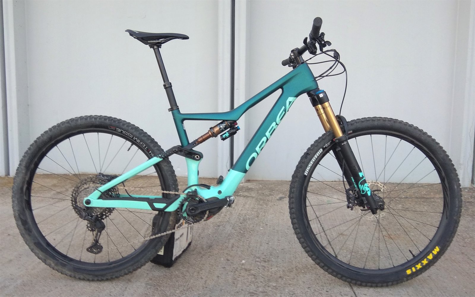

My Rise M10 size L has already 425km in just a month since I receive it. I made my upgrades clearly focused on making it even more lightweight and lively to improve its handling when going uphill over tough rocky singletracks while keeping its stunning downhill capabilities. These are my upgrades:
-Integrated handlebar-stem in a single carbon fibber part with virtually the same geometry of the OEM Race Face. I save 160gr.
-XTR 10-51T cassette, I save 160gr
-Carbon fibber seat, I save 140gr
-Speedsafe 29" carbon fiber wheels (very robust carbon rims 36/30mm wide), I save 470gr
-Real tyre Specialized Eliminator Grid Trail 2Bliss Ready T7 29x2.3, this adds 160gr over OEM Maxxis Rekon but is much more robust and provides more confidence on bends and jumps
Original weight was 18,7kgs including XT pedals
Total weight saving 770gr
Actually weights 17,9kgs including pedals
The weight lost on wheels is clearly noticable, it accelerates easier and faster, the handlebar feels very fast on bends and the reactions are very quick and very precise. The only minor downpart is it feels a bit more rigid and less supple on rockgardens due to the carbon fibber rims and handlebar stiffness but with a reasonably low pressure on the tires and the fanstastic Fox fork is perfectly usable.

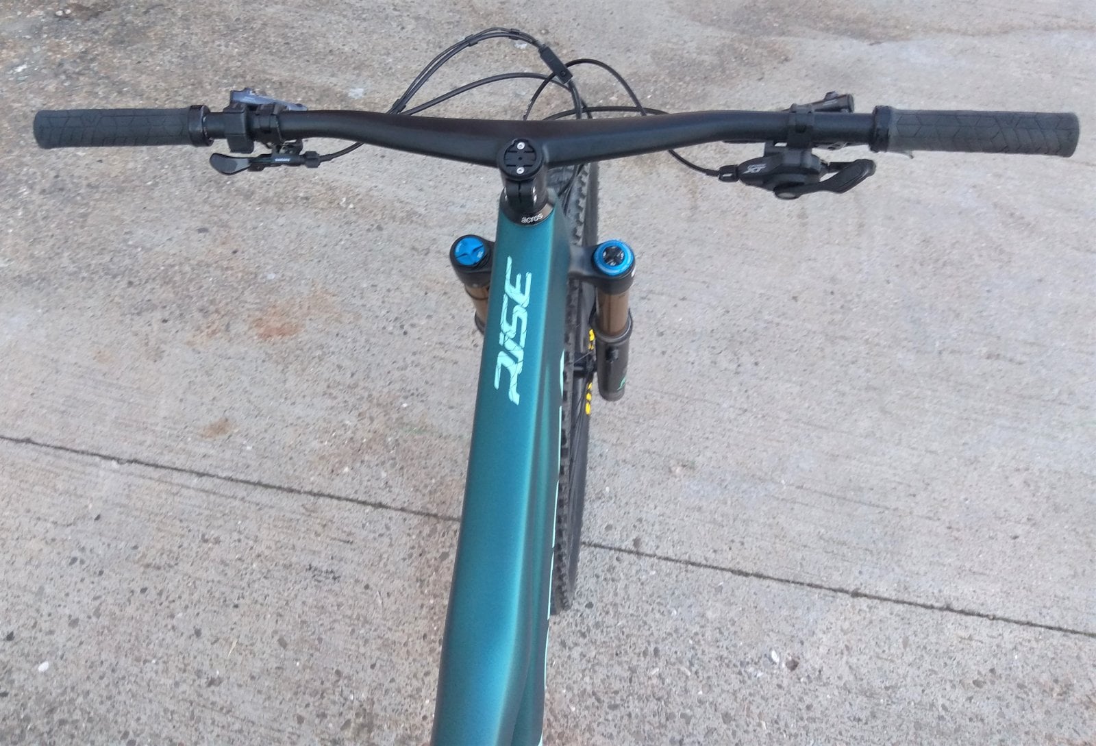

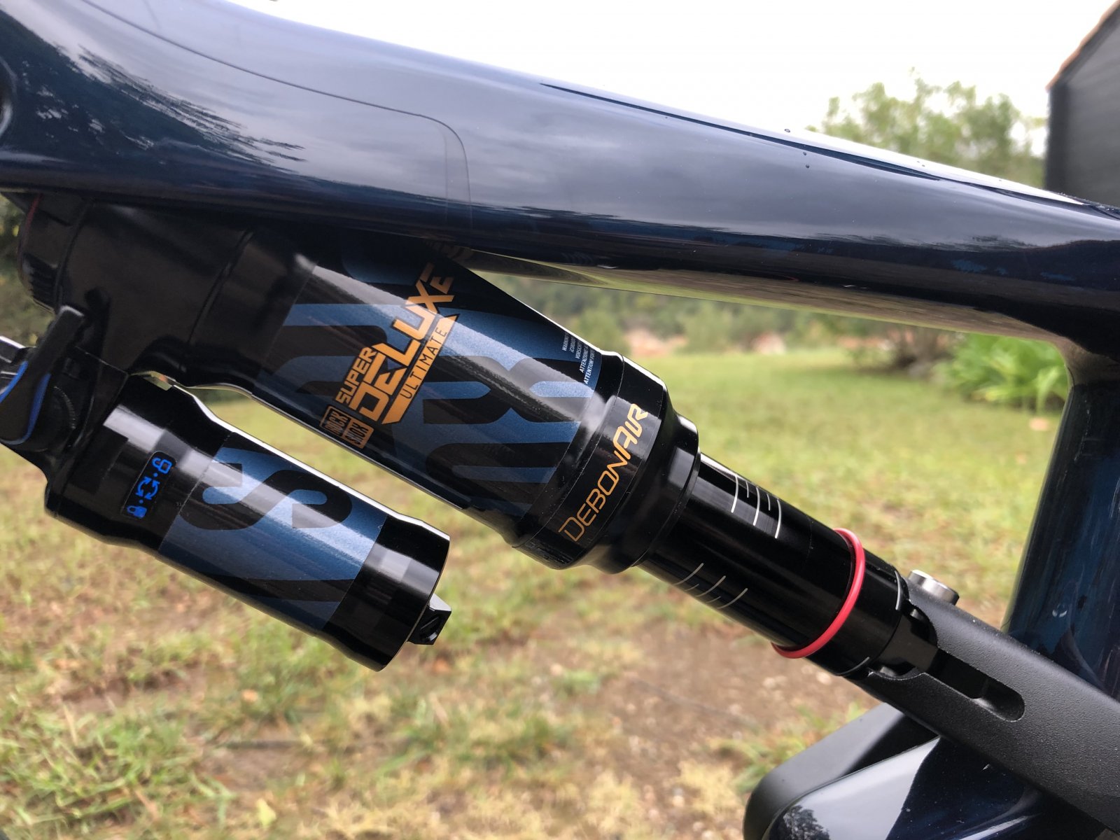

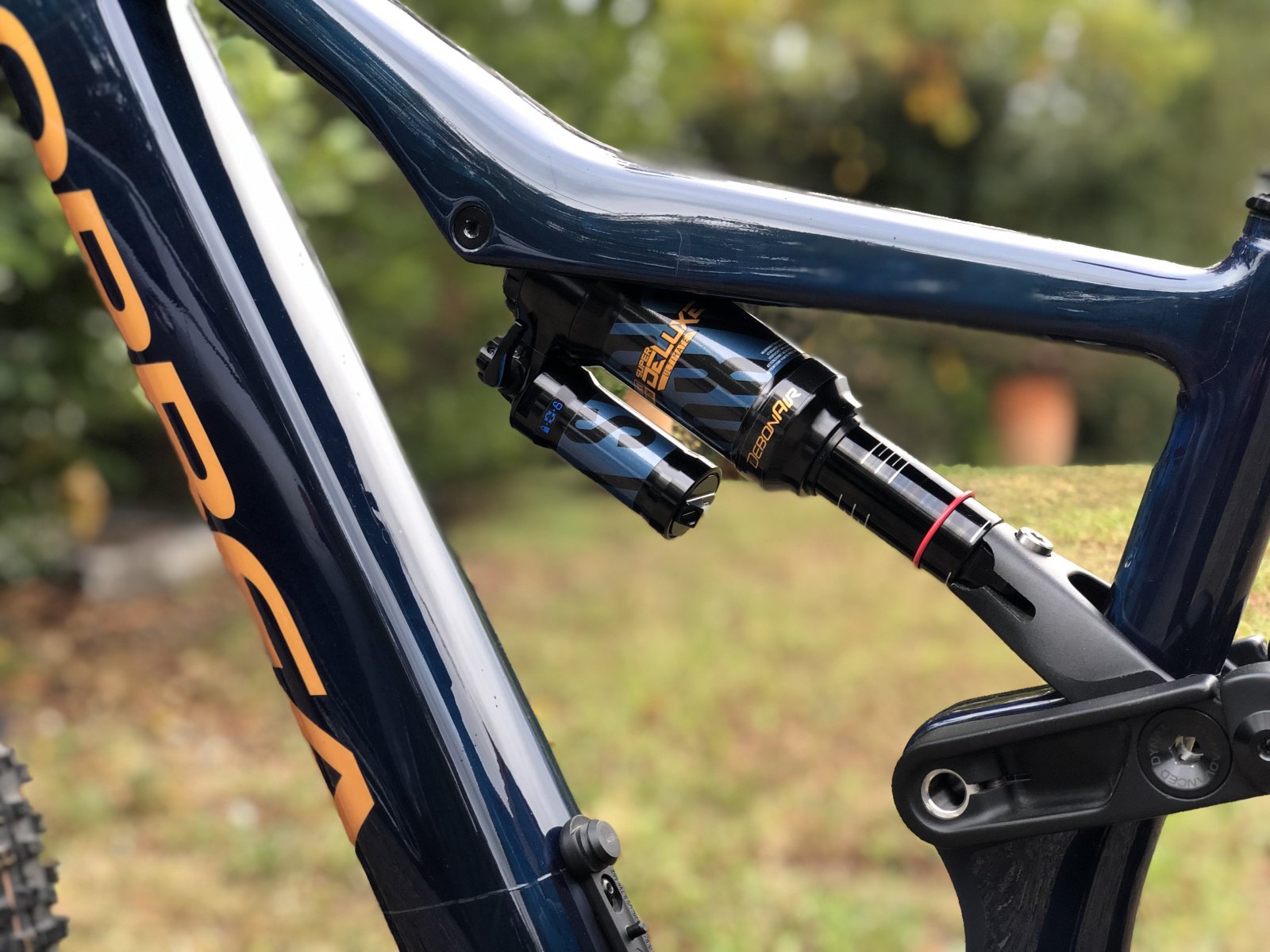

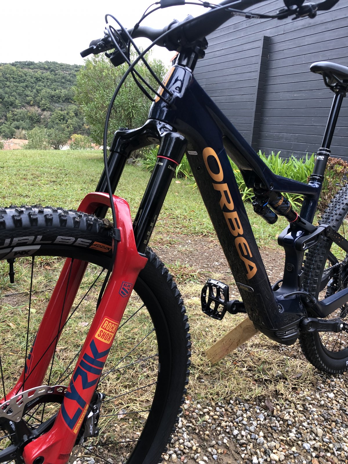

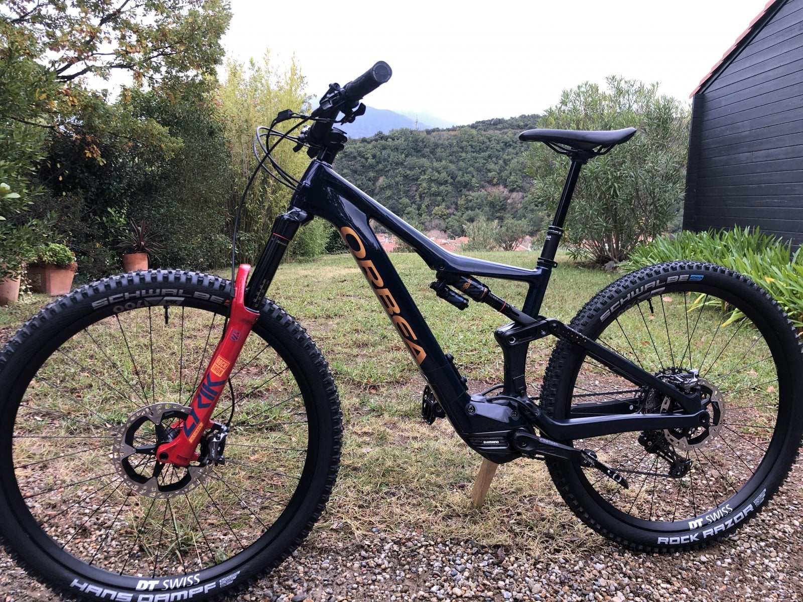

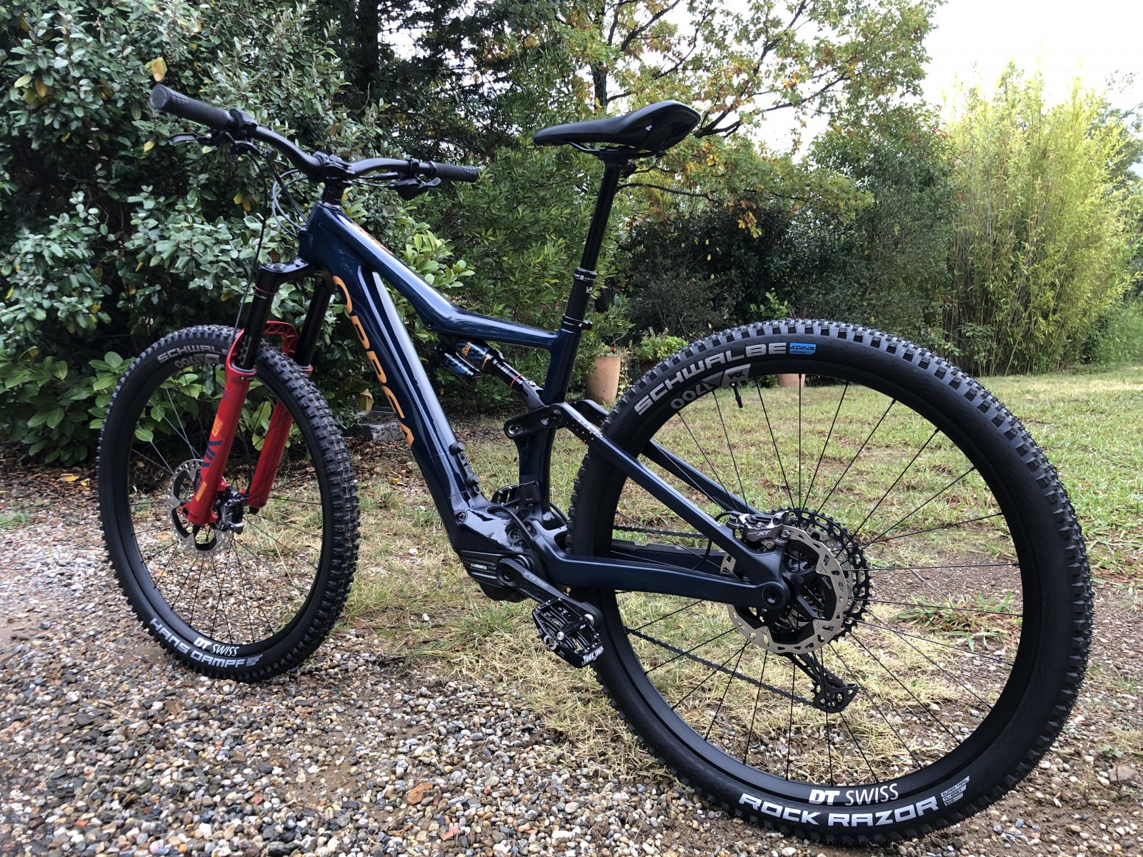

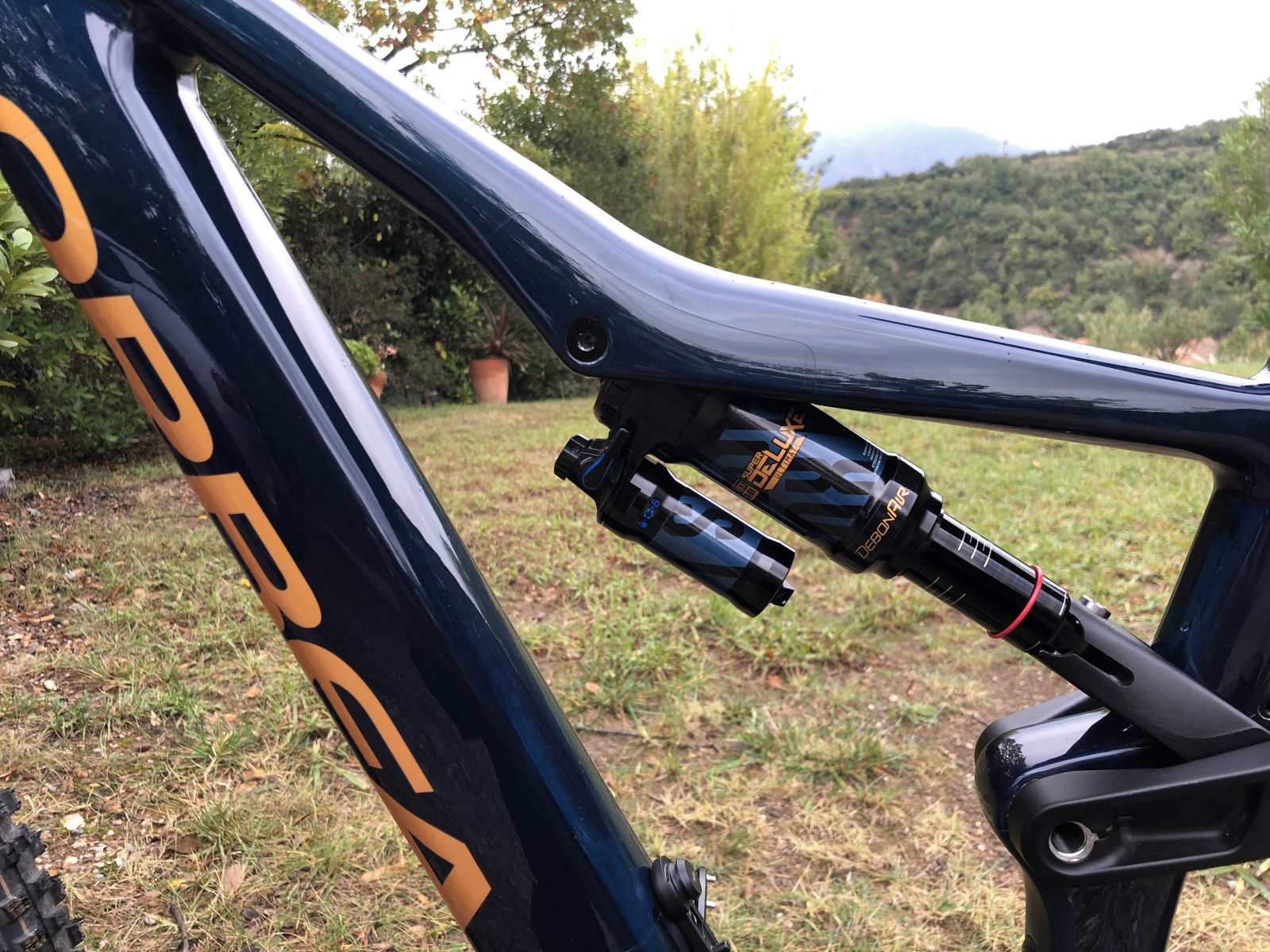

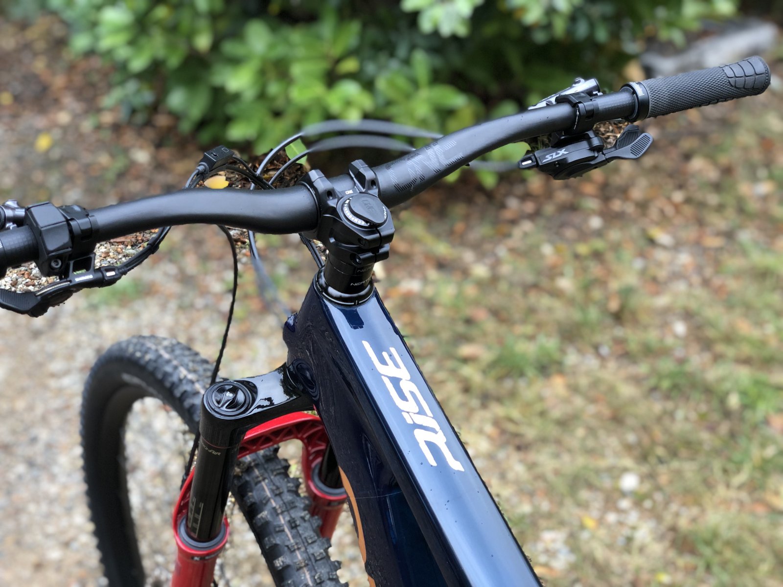

Let me show you my M20
Frame: Orbea rise M
Fork: Rockshox Lyrik Ultimate 160 mm
Shock: Rockshox super deluxe ultimate 210x55
Wheelset: Dtswiss XM1700 29x30
Tyres:
Front Schwalbe Hans dampf 29x2,35 Supertrail addix soft
Rear Schwalbe Rock Razor 29x2,35 Speedgrip
Brakes: Shimano XT 4 pot
Rotors: Shimano XTR 203mm Front, 180mm Rear
Handlebar: oneup carbon 780x35
Stem: Oneup 35 mm
Grips: Sqlab 70x
Seatpost: Yep Components Uptimizer 3.0 185 mm
Saddle: SQLAB 611 Ergowave Active 2.1 S-Tube 280 x 140
Shifter: SLX 12 speed
Rear Mech: SLX 12 speed
Chain: Shimano 6100
Cassette: SLX 10-51t
Pedals: Hope F20
Bike weight:19,4 kg

Nice PaPaYoU. Really interested in your damper upgrade. Didn't you need any offset bushings for the ultimate 210x55 damper? Huw much did it rise the bb?
His shock is 210x55 which is the stock size, no offset bushing needed. People that are using offset bushings, are using 216x63mm shocks and long shocking the bike for extra travel.
ok thanks. I would like to bump up the travel to 160 but all I´we seen so far is mullet 160, which I prefer not to. Will 216 x63 mm give around 160 mm?
