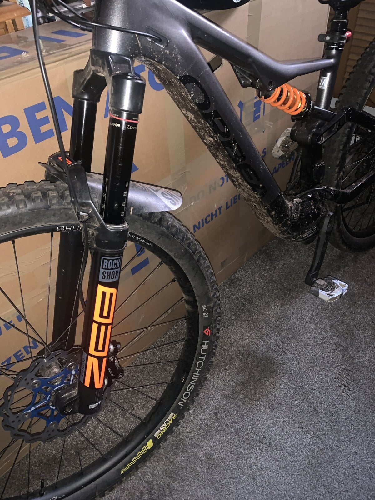

Hey @Erjabato,
That is exactly the disadvantage of the Shigura: Shimano brake lever and Magura brake line (but it's worth it, long-term test is still running). For me, this led to the experience of removing the motor, because unfortunately the line connector tore out when I tried to pull it through. 🥳 Just in case @Rod B. has a great guide here that helped me.
As a tip, I can directly recommend that you check the banjo on the Magura brake caliper for leaks yourself. The small rubber seal didn't seal and required a set of pads as an sacrifice to the trail gods. 😇 I therefore used a Jagwire line on the front wheel, but there were no problems on the rear with the original Magura brake hose.
Apart from that I can't complain, I last had an XT and I liked it too, the Shigura is a bit easier to modulate in my opinion and I'm now trying out different pads.

Thanks a lot Balticmoe!
I have ordered one Shimano MT520 caliper for the rear since I am afraid of removing the motor in the new bike, but I don't discard the Shigura in the front to make the test and expand later... even if it means a pads sacrifice to the trail gods :ROFLMAO::ROFLMAO::ROFLMAO:.
Thanks!

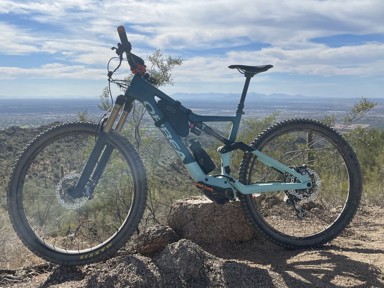

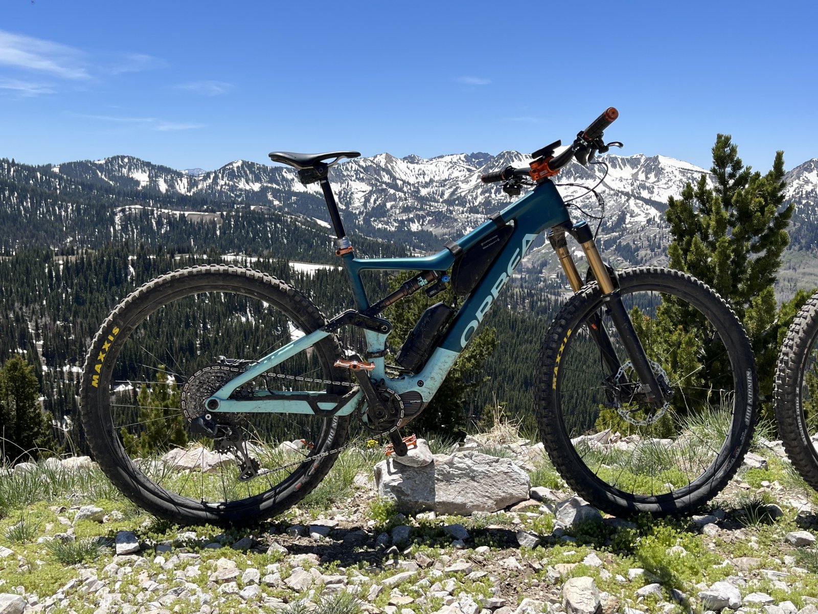

M10. Only a couple of mods so far, as follows:
- SRAM XO1 AXS derailleur/shifter (I am still using the Shimano cassette and chain)
- SRAM AXS dropper
- Deity Bladerunner pedals
- Deity stem
- Deity grips
- E Thirteen 160mm aluminum cranks
- MAXXIS Minion DHR II/DHF (both are dual casing)
- 203mm Galfer rotor up front
- range extender (not really a mod)

Salut,
Quel est la marque/modèle et la taille de ta sacoche de cadre ?
Merci de prendre le temps de me répondre, car je n’arrive pas à trouver une sacoche comme la tienne. Orbea aurait pu en commercialiser une.

@Cell4soul can you answer Haut's question?
Hi,
What is the make / model and size of your frame bag ?
Thank you for taking the time to answer me, because I can't find a satchel like yours. Orbea could have marketed one.
Hi,
sorry for the delayed response. The frame bag is the Blackburn Outpost Corner Bag. Here is a link:

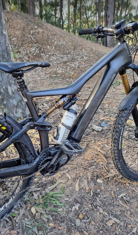

I actually swapped the XT Cranks onto the bike in the first week of ownership. While I was there I went from a 32T chainring up to a 34T.
what size cranks? I'm thinking of 160mm XT for my rise. I don't get tons of crankstrikes but think it would help being shorter.
I've considered 34 but riding without the guide is a big no for me. I took the guide off and where I ride I had the chain come off a few times which is not nice.
I'm looking for another saddle for this bike. I swapped to my goto chromag seat but have issues on this bike, I guess its an ebike thing, more on the saddle peddaling up, not sure. You seem on the fence about the sqlab?
I went with 165mm, seems to be working well for me.
That's odd, I've never dropped a chain on this bike and I never ran a guide on my old bike either. The only time the chain might drop is when the chainring is really worn down and the narrow/wide tooth profile is no longer working effectively.
With the saddle I'm starting to think its more an ebike thing than a problem with the new saddle. This is my first ebike so my theory is you spend more time pedaling in a seated position instead of standing sometimes, with the ebike I probably just bump up the assistance if I'm struggling with a climb instead of standing. Also I now ride for longer, my average ride was 20 - 25km and now its more like 40 - 50km.
The original saddle was painful after just one hour of riding, it was a really bad shape for me, just too narrow I think. I don't want to keep chasing the perfect saddle as that can get expensive really fast. The SQLab seems comfortable for at least 2 hours and I will keep playing with my seat position, I have seen some dramatic improvements here already.

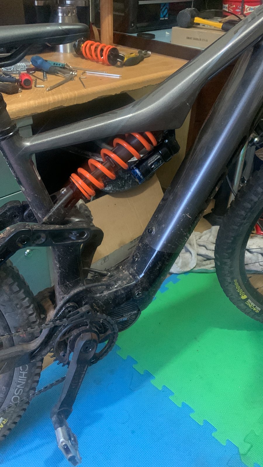

I collected my H30 on Tuesday and spent yesterday tinkering.
So far,
Swapped the Dissector from front to back and fitted a 2.5wt Minion DHF Maxxgrip up front. Set both up tubeless. Had to use the old 'inner tube in to seat the bead' trick as they weren't going anywhere with just a track pump.
Manitou Mezzer Pro replaced the Z2. Dropped the travel on the Mezzer to 150mm for the time being. It's quite a tall fork so it'll probably stay that way.
Brakes... The bike should have come with some non series twin pots so I bought a set of M6120s in anticipation (£160 from Merlin was a bargain). Fully prepared to drop the motor to run the hoses I was half happy and half disappointed that the bike actually came with M6100 twin pots.
It was good, because they're better that what was supposed to be on there but at the same time bad, because if I'd have realised I would have just bought SLX calipers for the same money. Considered sending back the Deores but there's no appreciable difference in power. They're just shinier.
Swapped the front disc to an XT Ice Tech 203. Bought a matching 180 rear without thinking and obviously, it doesn't have the magnet so that'll be going back. Also want some metallic pads as I'm not keen on the bite from the resin ones.
Grips, went for Deathgrip because I find the really comfy. Black is boring though so might buy some orange clamps for them.
Saddle I changed for a Specialized Phenom Expert. Was considering the Pro but it's a big increase in price for a small decrease in weight.
Fitted an Invisiframe kit which was painful. Not so much the kit, just that I'd have rather been riding that fitting it!
Next on the cards will probably be the wheels and a lighter cassette. It's been an expensive few days thought so that needs to wait for a bit.
I'll be seappingbthe dropper too. I reckon I'll easily get a 180 on there, maybe even more. Probably a Oneup. Oh, and while we're in that subject... Probably some Carbon Bars as well as they've been super comfy on my hardtail so far.
