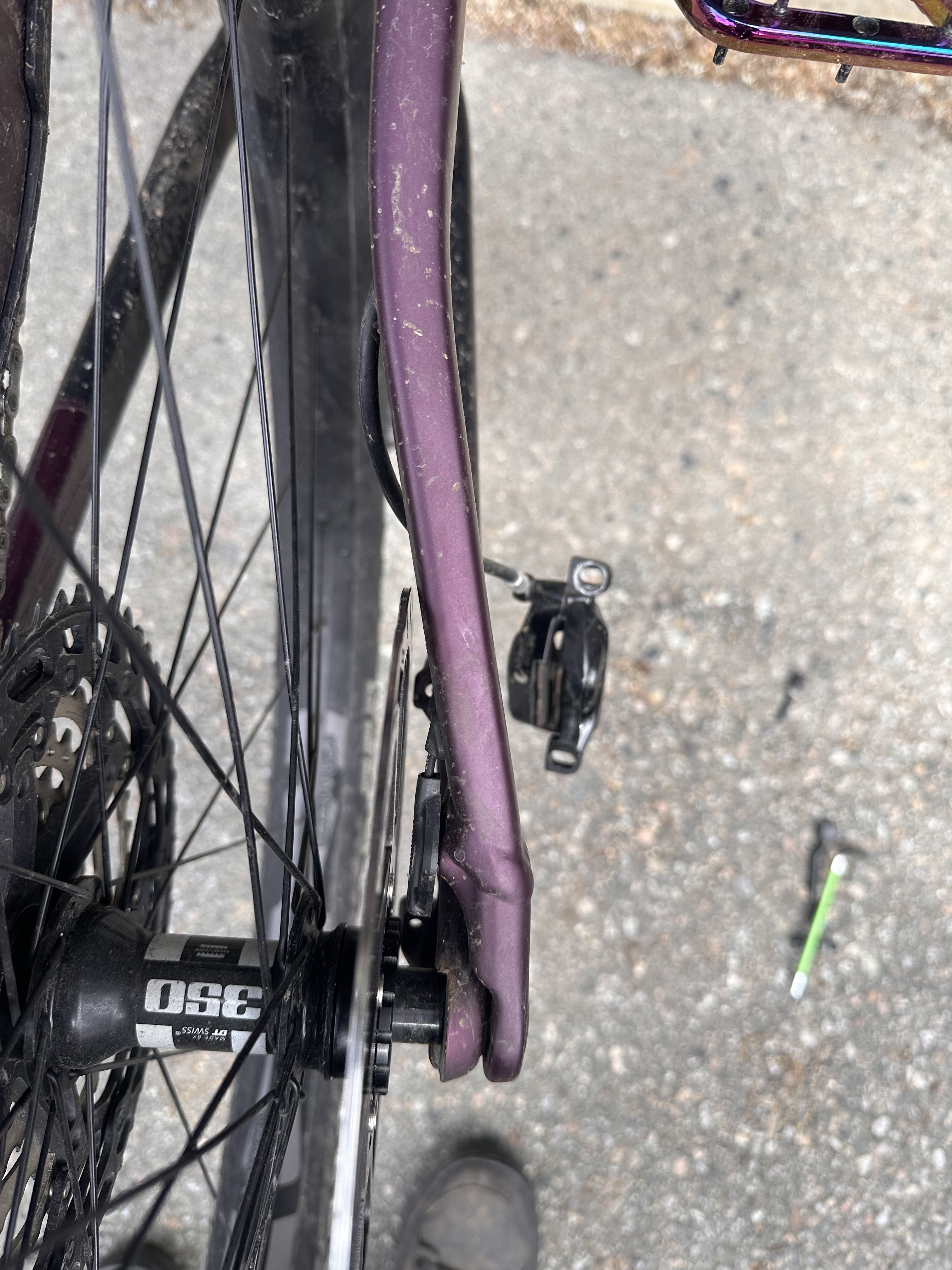

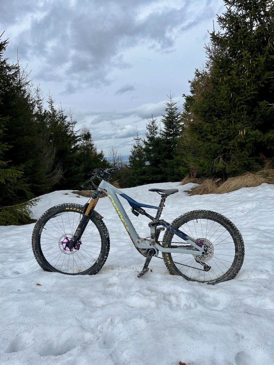

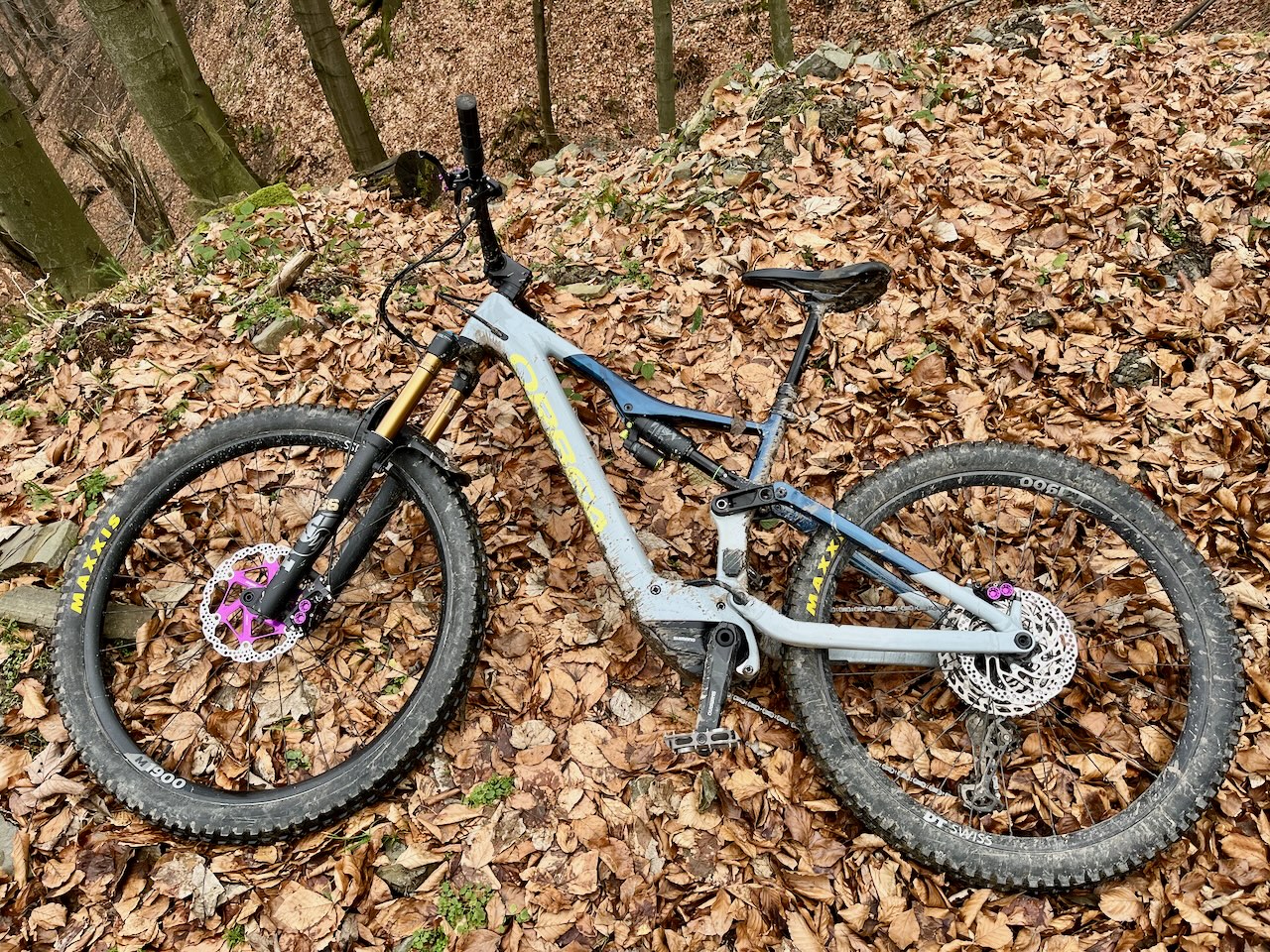

So, I´we been thinking of upgrading shock and fork to 160 rear and 160 or 170 in front, bit still full 29er.
The reasons are the following:
For a second time in 1.5 year my frame cracked (rear triangle, left, now right side). Perhaps the shock is bottoming out to hard that the frame been comprimised? The first time it cracked, I only used the bike for a few months and never crashed. I switched to a bigger volume reducer and it made big improvement, but still bottoming out.
The second reason I consider upgrade is that sitting down that much and having rather large roots where I ride make the bottoming out pretty frequent.
Third reason, the pedal strikes. Watching cranks break or the motor bearings take a lot of beating make me want to rise bb. Going up to 150mm fork would perhaps be enough?
In most regards, I like this bike and want to last. I also would like to ride more enduro-ish with it - and so far, I´mt to scared to break it in any of the ways described above.
I´we read a lot here of 160 mm upgrade, but not many reviews - does it really transform the bike to a real light enduro EMTB, or is there a simple, other solution to my problems?
Thanx in advance.
/Jonathan

Endurip,
Changing the Rise's travel to 160mm, will greatly enhance the bike's descending ability. Depending on the Rise model, it will have either a 65 or 65.5 head tube angle. The M20 comes with a 140mm Fox 34 and the M10 comes with a Fox 36 150mm fork. Changing the travel to 160mm will alter the head tube angle to approximately 65 degrees. This will much improve descending ability in chunky conditions, however you will lose a very slight bit of nimbleness on steep climbs and very tight turns. The improvement in descending, is well worth the very slight loss in nimbleness. I never once regretted switching travel on my Rise to 160mm.
If you are cracking your rear triangle, it's likely caused by rear shock bottom out. If your Rise came with a Fox DPX2, I would recommend switching to a Fox Float X. The Float X is better suited for heavier riders and or, chunky conditions. You'll experience less bottom out due to the added air volume which the Float X can provide. However, if you routinely ride double black/Pro Line and like to hit gap jumps, you may want to consider upgrading to a Fox DHX2 coil rear shock. Several buddies of mine ran the DHX2 on their Rise and really liked the shock. I routinely ride double black trails and like to rock crawl, but I don't jump much. The Float X works for me.

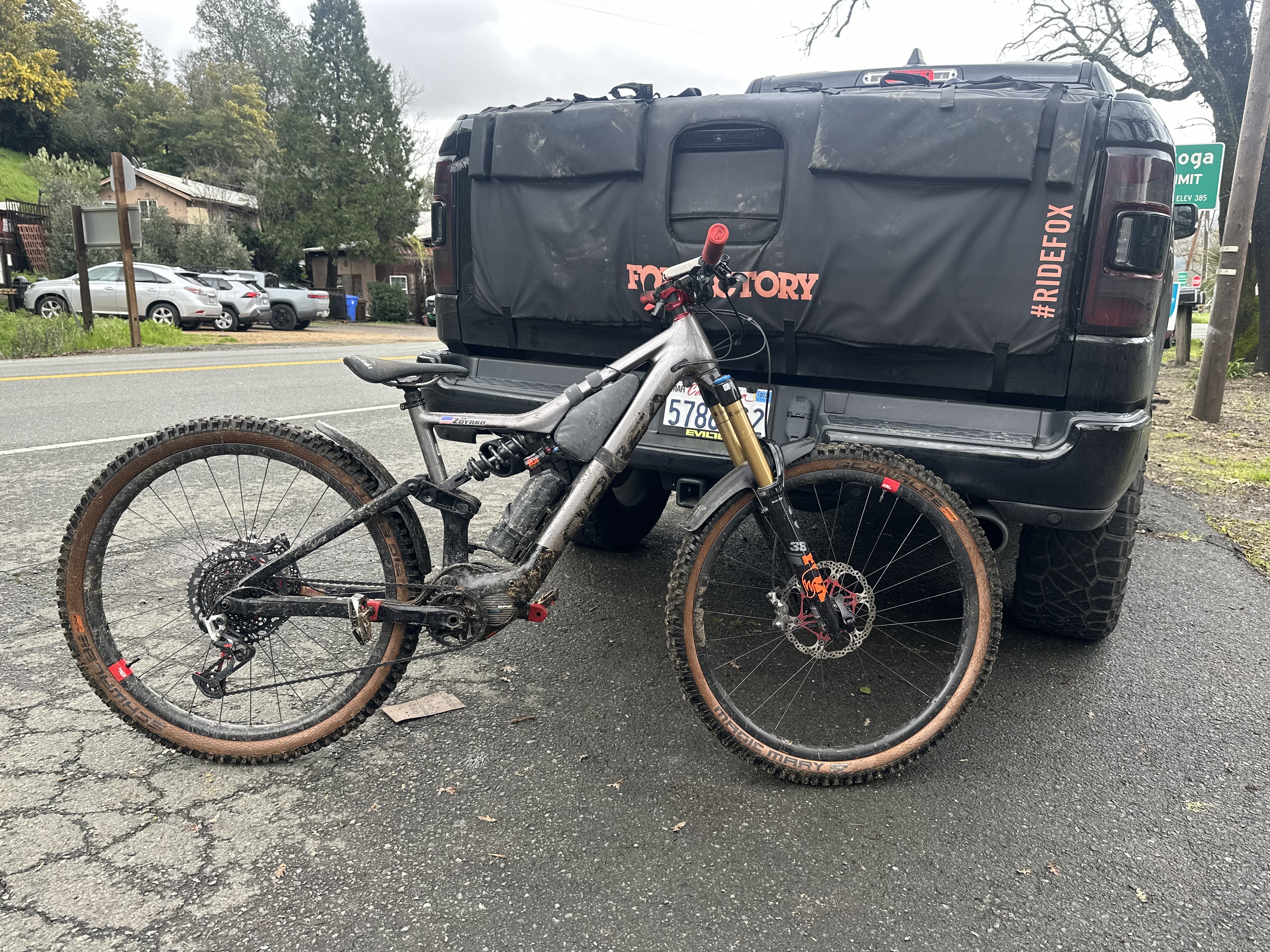

I def changed a lot to my Rise H. Every part of my H15 was swapped but here are the geo-centric upgrades. 170mm Zeb Ultimate, DHX2 Factory 8.5x2.5 in the rear. -1.2 degree 9point8 SlackR headset, 1 offset bushing on a full 29er. 165mm xt cranks. I do ride a ton of rocky terrain in NorCal, geo feels great. Geo below from a calculator w/ -1.2 degree headset. More than capable to ride anything I can imagine.
head angle65.5°63.43°-2.07°
seat angle76.5°75.92°-.58°
wheelbase1229 mm1251.5 mm+22.5mm
toptube (effective)619mm620.5mm+1.5mm
bb height336mm340.5mm+4.5mm

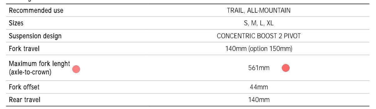

Orbea identifies the Rise as a "Trail" bike. Orbea has stated it does not want Rise owners to increase fork travel to 160mm. In particular, the Rise Blue Paper (Owner's Manual) specifies a maximum fork length which is measured from the center of the fork axle to the top of the fork crown. Exceeding this maximum distance will void the frame warranty. Increasing fork travel to 160mm will exceed the maximum specified length. Sometimes, you just have to say the hell with it and roll the dice, live large, ya know.
There are several reasons for the 160mm fork travel prohibition. Any increase or decrease in fork travel will alter the Rise's head tube angle and thus impact the bike's handling characteristics. Additionally, increasing the Rise's travel to 160mm can increase stress loads on the frame's head tube. I ran a 160mm fork on my Rise. I beat the living shit out of my Rise and it's doing fine. However, if the frame cracks at the head tube, I'm guessing I'll be ass out in the warranty department.

The Cascade linkage increases travel from 140mm to 150mm through the design of the linkage. It's my understanding from talking to Cascade, bottom bracket height isn't altered, it remains the same. I like that you can increase travel and not have to buy a new shock to use Cascade's linkage. Regardless of what suspension setup you decide upon, dump the 170mm crank arms.

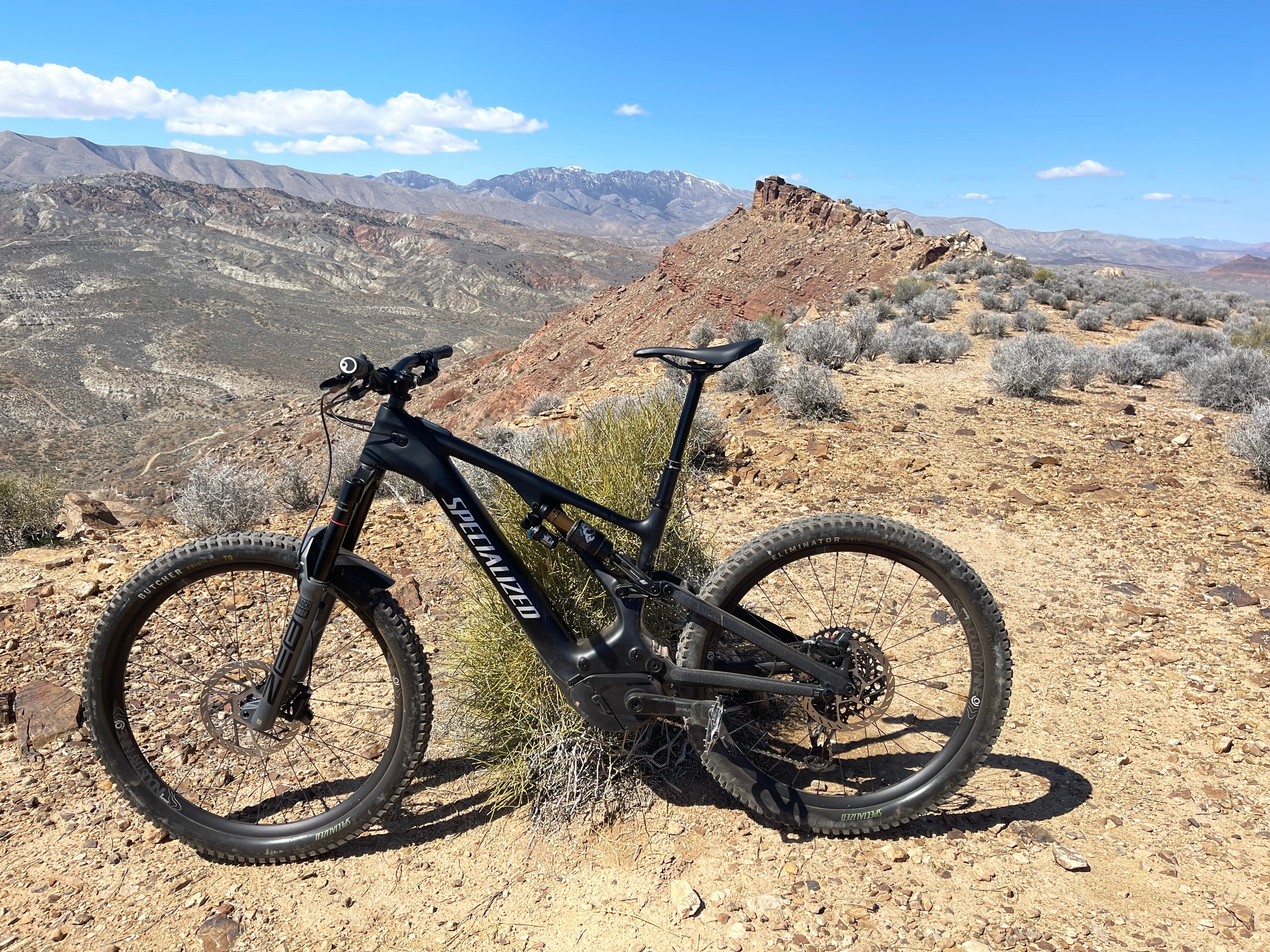

Been quite in here lately... I think my rise has reached it's final form now. Planning on keeping it for another riding season (12 months or so) then moving onto something else if something else is available. For reference, my riding weight is 185lbs.
My build is pretty specific... I wanted a lighter weight, all mountain style build. I specifically kept aluminum bars, aluminum cranks and aluminum wheels for durability and insurance while on long back-country rides. I do a lot of very big days on this where I am riding in eco/trail only and I bring 2 range extenders with me (one in a pack). Because of that, I need everything to be bullet proof and light weight parts aren't the path forward.
My build ended up the following:
-XL - Mullet Configuration - 360wh battery (w/2 range extenders as needed)
-Suspension: 2020 Fox 36 @ 160mm with acs3 55lb spring (black), 2021 Fox DHX2 Tuned & Modified by fluid focus - 8.5x2.5 w/1 offset bushing, Cascade components link, sprindex 500-550 spring set to 540lb.
-Drivetrain/Wheels: GX Axs w/north shore billet derailleur hanger, Shimano XT Cranks 160mm, Shimano Spider & 34t Chainring, GX eagle cassette, x01 chain, EX 511 wheels - dt350 hubs, 2.5 Maxxis Assegai front/rear with cushcore pro front/rear.
-Brakes: Code RS, 200mm HS2 Rotors, Metallic Pads
-Ergonomics: PNW Loam Alu 31.8 bar, PNW Grips, Spank 43mm stem, WTB Koda Wide Saddle, Oneup 210mm V2 Dropper, wolftooth la dropper lever, Crank Brothers Mallet DH Pedals, VC Guards brush guards
-Misc: Oneup EDC lite in steer tube, evoc medium frame bag, mughugger large fender

You're running a Cascade link along with the offset bushing and a longer shock?
How much rear travel does that give? I know the link bumps it up to 150mm and just running the offset bushing with the longer shock would give the Rise a 160mm?
So what's the travel with both of those?

Probably my last ride before my warranty frame and motor swap…. Fox 38 180/Fox DHX2 8.5x2.5 w/ one offset bushing and Cascade link, SRAM X01 drivetrain, XT Cranks, RF NextR 35 Bars/Turbine R35 40mm stem, and SC Reserve wheels w/ Hydra hubs. Replacement frame is Mulberry so Red bits are being swapped to Black

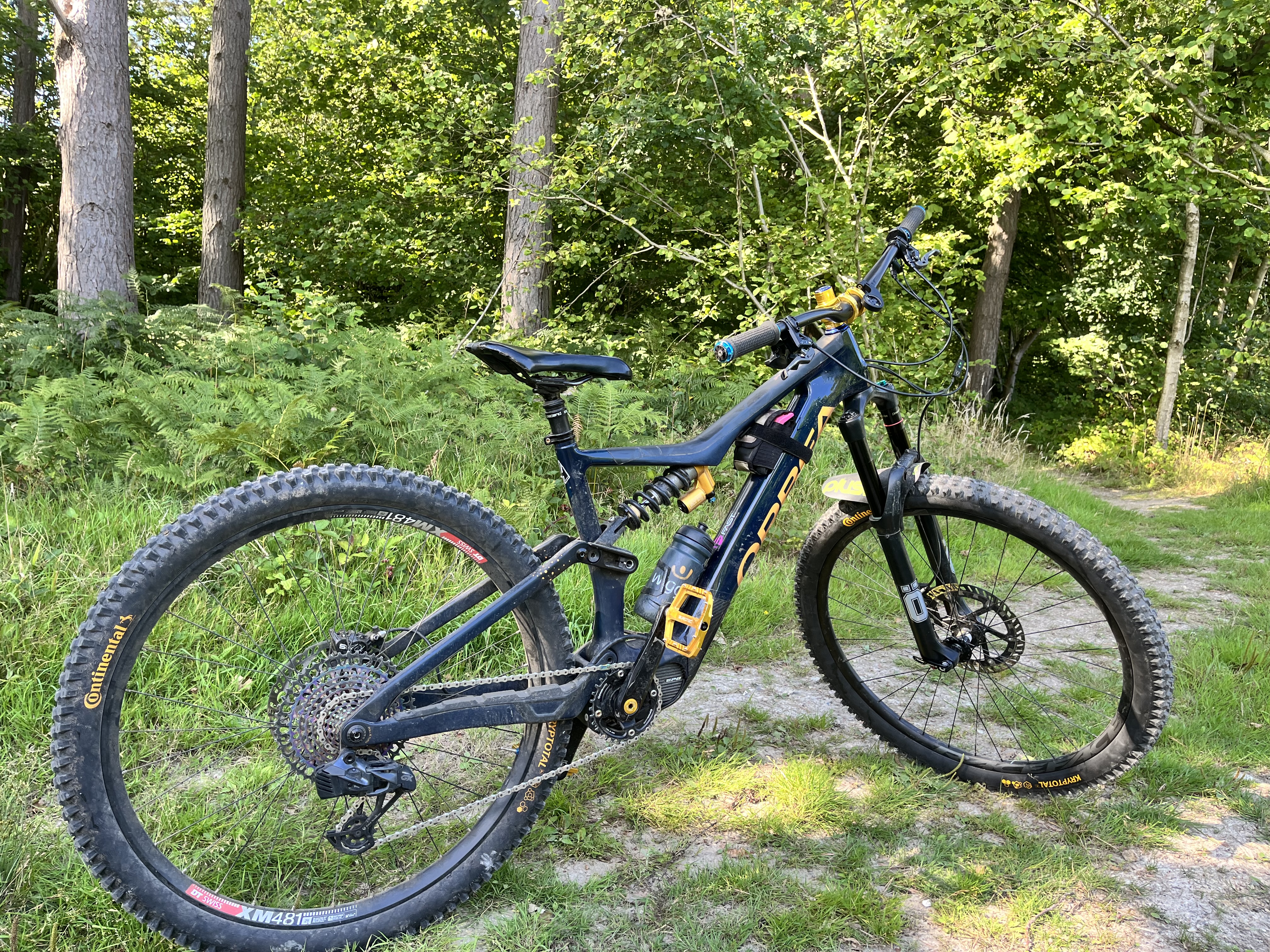

H30 2023. Mulleted with DVO Topaz shock and DT M1900 wheel. Fox 36 & 160mm with DT M1900 up front. DHF 2.5 & DHR 2.4 rubber. Hope E4 brakes with 200mm front rotor. The rear rotor is stock as I yet to figure how to match the Hope rotor with magnet properly. Deathgrip grips & Magped pedals from my previous bike. And replaced the stock saddle with one I had lying around the first day.
In plans, I have short cranks, OneUp carbon handlebar, XT cassette and shifter.

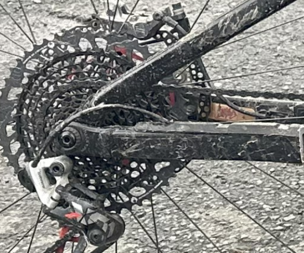

Stoked owner of a 2023 H10 Rise. Extensive upgrades and swaps, including Push shock and Mezzer fork presently at 160mm and 160mm crankarms. Latest kick is to try 220mm rotors, which fit with a few mm to spare on the back. I'm likely to give it a shot and listen/look for rubbing. I don't think I'm flexing the rear end much, but we'll see I guess... anyone else actually tried this?
BiGJZ74
Mar 17, 2021
574
444
American Canyon, CA
Stoked owner of a 2023 H10 Rise. Extensive upgrades and swaps, including Push shock and Mezzer fork presently at 160mm and 160mm crankarms. Latest kick is to try 220mm rotors, which fit with a few mm to spare on the back. I'm likely to give it a shot and listen/look for rubbing. I don't think I'm flexing the rear end much, but we'll see I guess... anyone else actually tried this? View attachment 141406
When I tried the rotor cut into the frame at the chainstay. If you zoom in on the pic from my post 4 spots earlier, you can see where I covered the damage with a sticker.
doochenozzle
May 16, 2023
38
23
Dildo, Newfoundland
gotcha - you mean this photo?
are the stays on your bike carbon or alloy on the M20? it's probably a bad idea, but I'm tempted anyway. that, and/or maybe file 2mm of the tabs where the rotor mounts to the hub to bring it in a little.
ebsocalmtb
Sep 29, 2021
238
265
Southern-Cal
That is a very bad idea. that's possible if you use a lathe or bridgeport and are certain that they tabs are square to each other. If you were to do it by hand, that is almost certainly a way to trash a rear hub. Fwiw, I run my rise in some of the steepest terrain there is, I weigh 175lbs, my rise is 46lbs and I ride EXTREMELY hard and fast. I have not had brake temperate issues with 200mm sram hs2 rotors and metallic pads.
