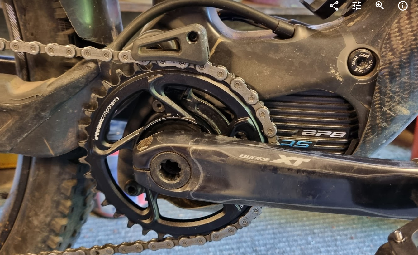

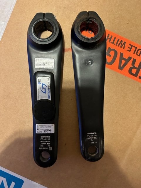

Just installed my Shimano M8100 Stages Power meter to the left side crank spindle.....I use Power meters on all of my bikes and had this sitting in a parts bin. It's nearly Identical to the FC-m8150 EP8 crank arm and seems to fit fine. Stages PM is a 165mm arm, M8150 is a 160 in the picture. When I realized that the m8150 was so similar, I ordered a 165mm right crank arm off Amazon to match the Stages Arm. Now I have m8150 160's, and em900 170's sitting in my parts bin...

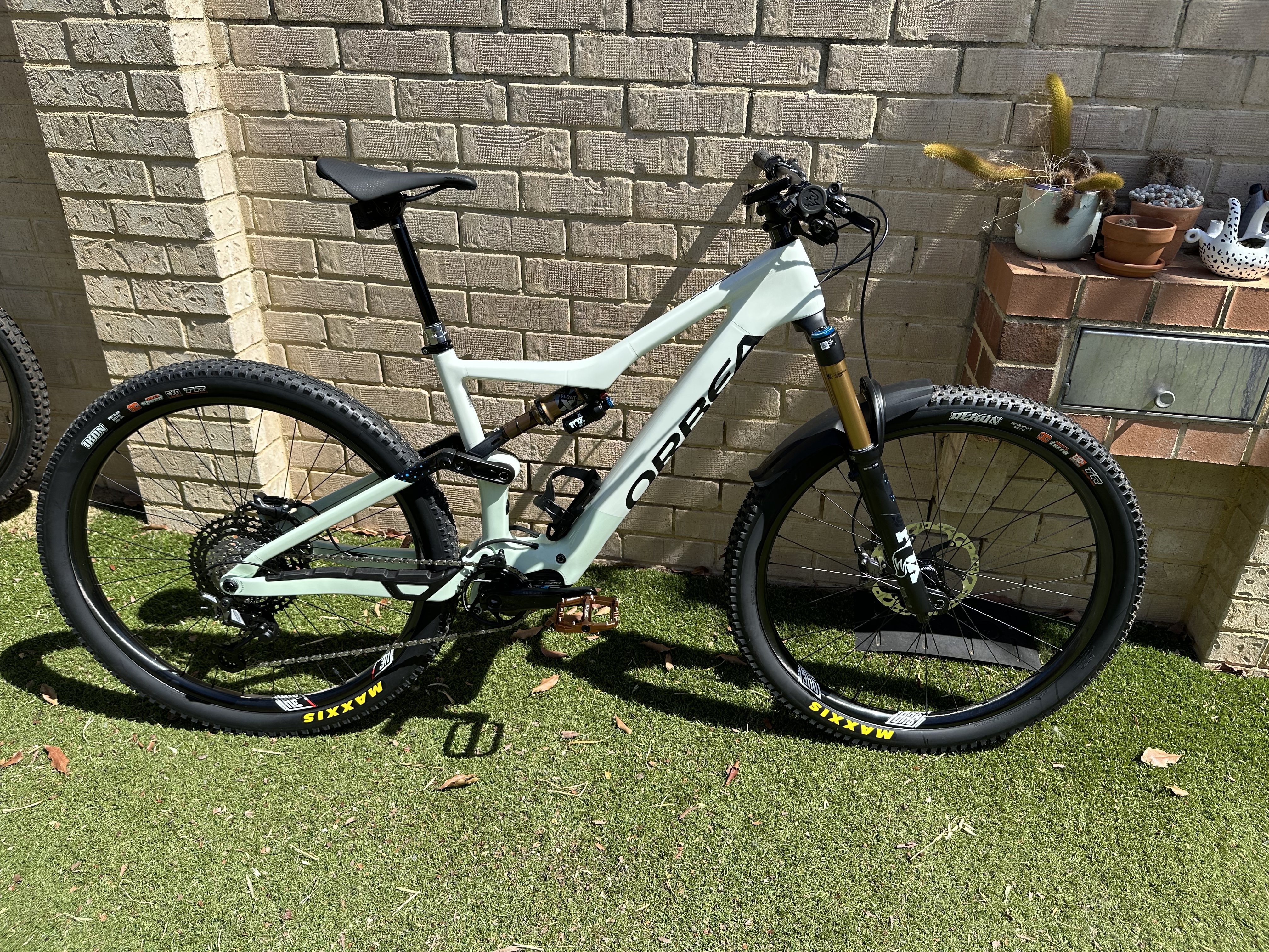

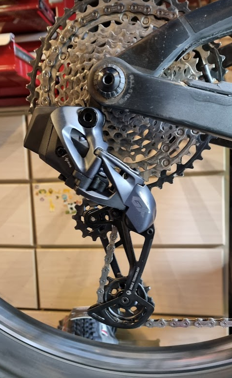

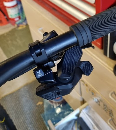

Finally got onboard with AXS. So far loving how it works but years of habit with shimano shifters has me wondering about the paddle shifter. Not the easiest to use!
EDIT: local shop helped me out and let me swap old paddle with the new design. Alot better, but still fumbling with it when things get hectic on the trail! I have used the left hand bikeyoke adapter, gets it in the right spot for me.
I will pull the cable out and put some black sikaflex to cover the holes soon! I have a 10-45 cassette in the mail as the original one is shagged with 2500kms on it. (not easy to find shimano cassettes currently!)

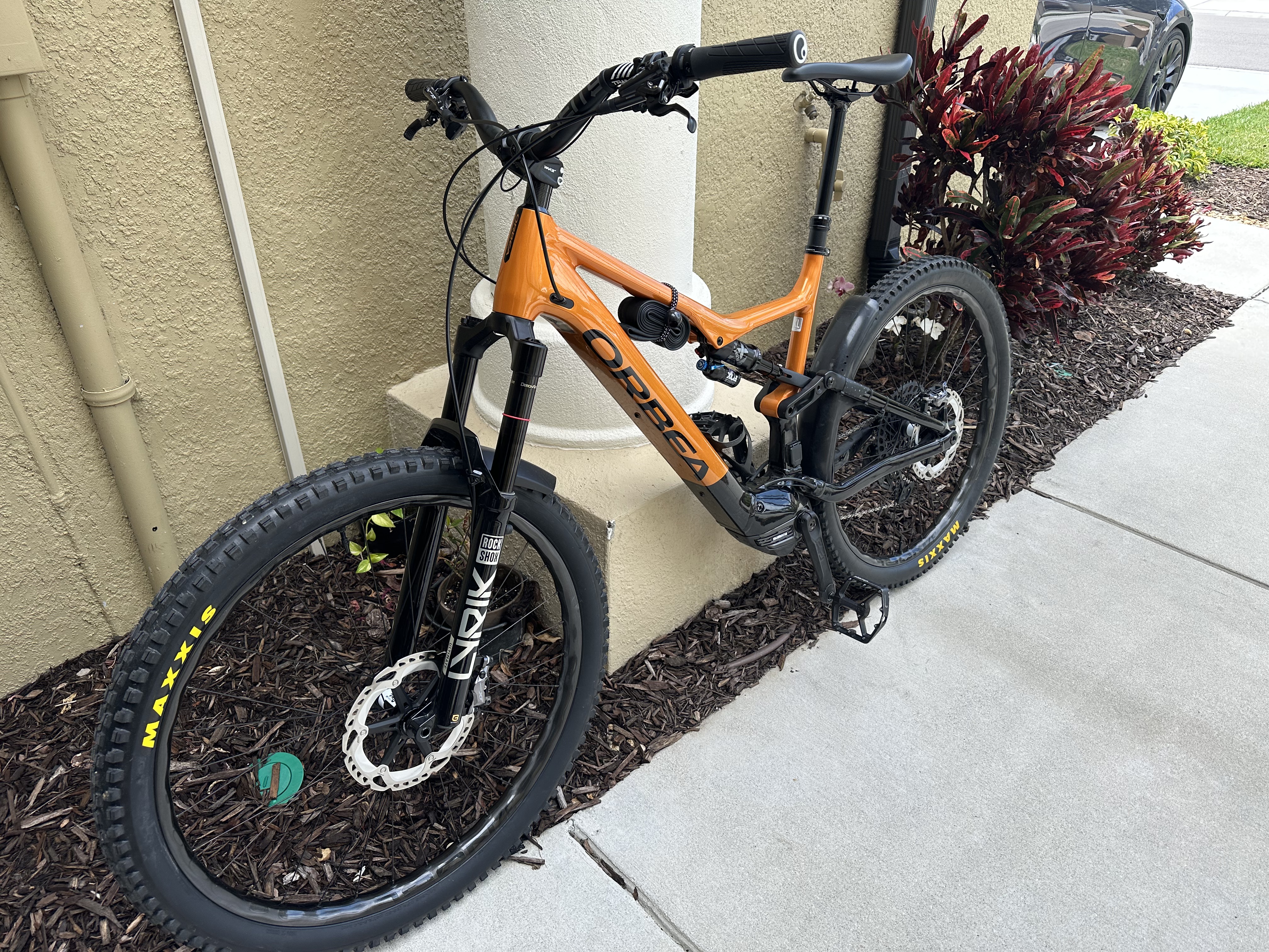

Completed yesterday! I didn't have plans to do any major upgrades to my H30, but then someone invited me to do some serious riding un Utah, and I realized the bike was not going to handle my 225+ lbs in tough terrain. Now the only original parts left are the frame, cranks, dropper post, and the rear tire.
Had major help from some guy named Rod ;)
- SRAM GX AXS
- GX casette, X01 chain
- Custom wheels with Nobl carbon rims, DT350 hubs, Sapim Race spokes
- RockShox Lyrik Ultimate 160mm fork
- Fox Float X rear shock
- XT brakes/levers with 203mm rotors
- Crank Brothers Stamp pedals
- Ergon SM saddle
- Deity 80mm riser bars
- Better stem on order, this one was an experiment
EDIT: Net gain 1.4 lbs., from 47.6 - 49.
- SRAM GX AXS
- Ergon SM saddle
Beautiful ride. Regarding Rod, that dudes a wanker.....Never listen to him....
What frame size is your Rise? I've been looking for a PM solution but had seen a few posts that there wasn't enough clearance for the Stages PM; I'd semi-settled on a Power2Max spider, but the price put me off, and I was concerned about the longevity of it with the forces it'd suffer.

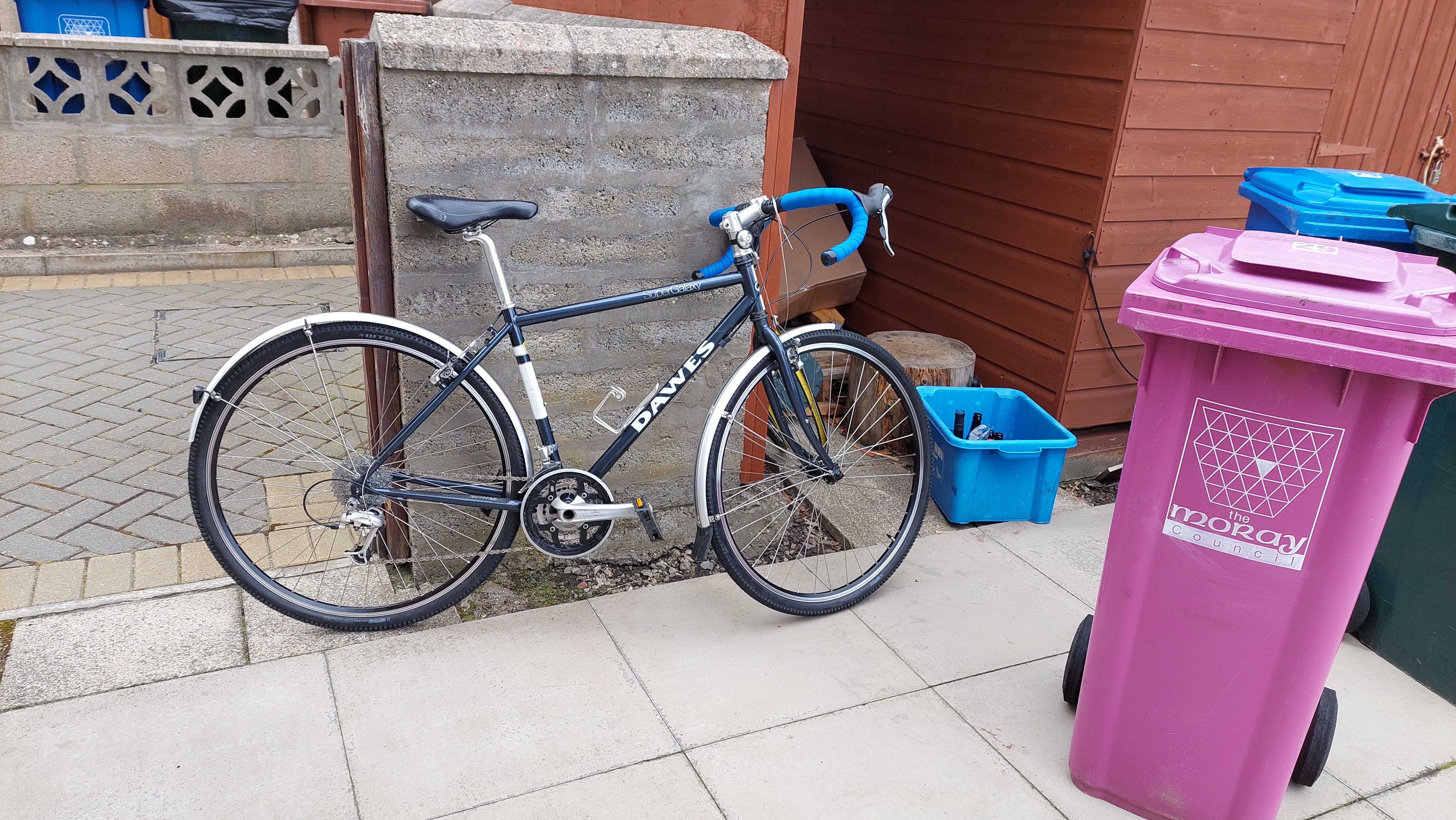

BITEX hubs on LX17 rims . Wider gravel bars with new tape and WTB 37mm Riddler tires and headset.
Large
- SRAM GX AXS
- Ergon SM saddle
I like the fact you felt you to swap the wheels for carbon rims to cope with 225lbs. :) Regardless of justification, a great move.
You didn't mention tyres/tires. If there was just one essential change I would make from stock it would be to ditch the Rekon. I can't be sure from the photo. You did that, right? Get a DHRII with min exo+ casing.
Have fun.

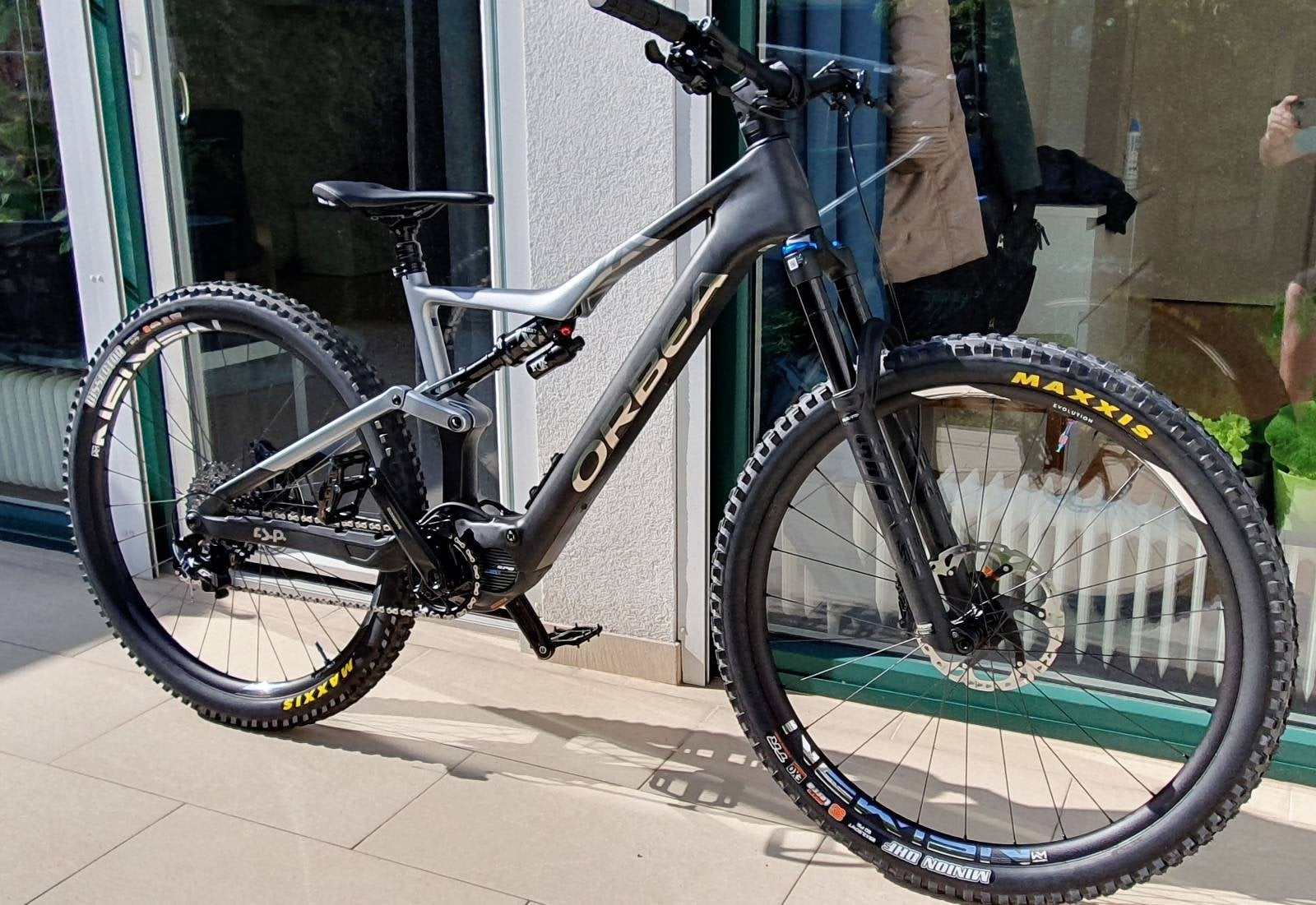

Hi,
here is my rise,
changes already done:
wheels, tires, shock, drivetrain, brakes, saddle
to come: fork, stem, handelbar, grips
so i change neraly everything.

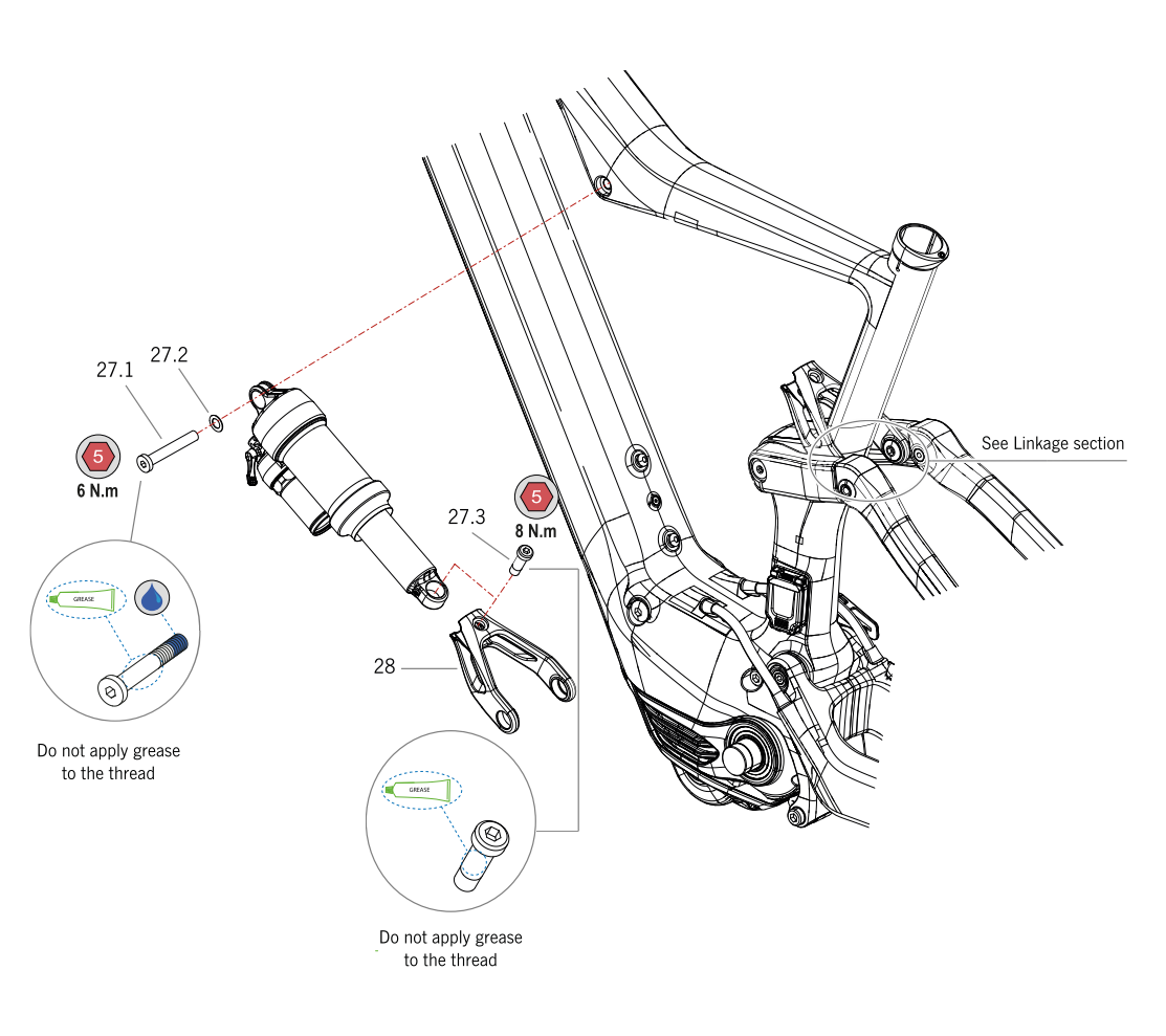

- When I changed the shock, I wanted to check the torque in the blue paper, and it says 6nm, but the screw itself says 10nm?
