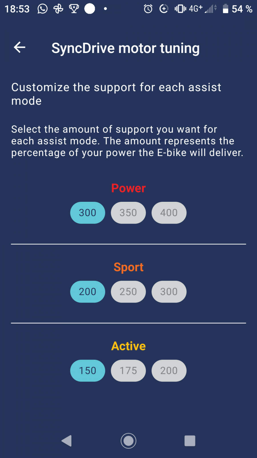

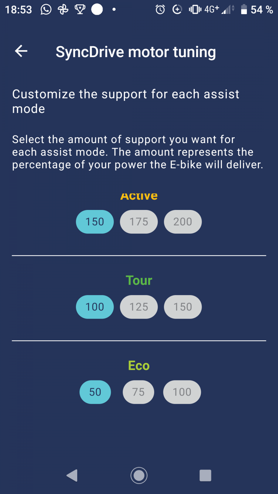

Yes you are missing something. Let me explain why.
I think that there is a some confusion as to how this motor works. For example. This are my personal settings:
What those numbers are, are percentages of your input. The 400 that is the maximum number is not maximum power in Watts. This is 400% of the input. OK. So what?
That means that the maximum that this motor can give you can be reached even in Eco mode set to 50%. You can reach the maximum on EVERY level. This is by design.
With default settings Sport is set to 250% and Power to 400%. My problem was that there was ABSOLUTELY NO difference between these two for me. Also the difference between Active set to 175% and Sport 250% was also MINIMAL. I could feel the difference at first spin, but after that the difference between Active and Sport was small. Why?
The answer is quite simple. My FTP (for those who don't know this is the max average you can produce in one hour) is right now 305. My usual wattage when just going biking is in the range of 150-200 Watts when going up the hill. So Sport 250% will try to produce power in the range of 375 to 500 Watts depending on my input. I have no idea what is the maximum power of Yamaha PW-X3 but it MUST be less than 500 Watts because switching to anything higher than 250% (higher than theoretical 500 Watts) makes ZERO difference. This is at least what my legs feel.
Now what? If you are a strong rider reduce EVERYTHING like me. If you are AVERAGE. Don't change anything. If you are a beginner max out everything. And PLAY with those numbers.
BUT. Why are you actually missing something without the app? Why to change anything? The answer is that if you will reach the max output of the motor too quickly (in Sport or even Active mode) your brain will be HIGHLY disappointed when switching to higher levels. Because there will be NO difference that will have any meaning. And that is not a nice feeling. Every assist level should produce a difference that you will be able to feel. Hope you will guys find that helpful :).

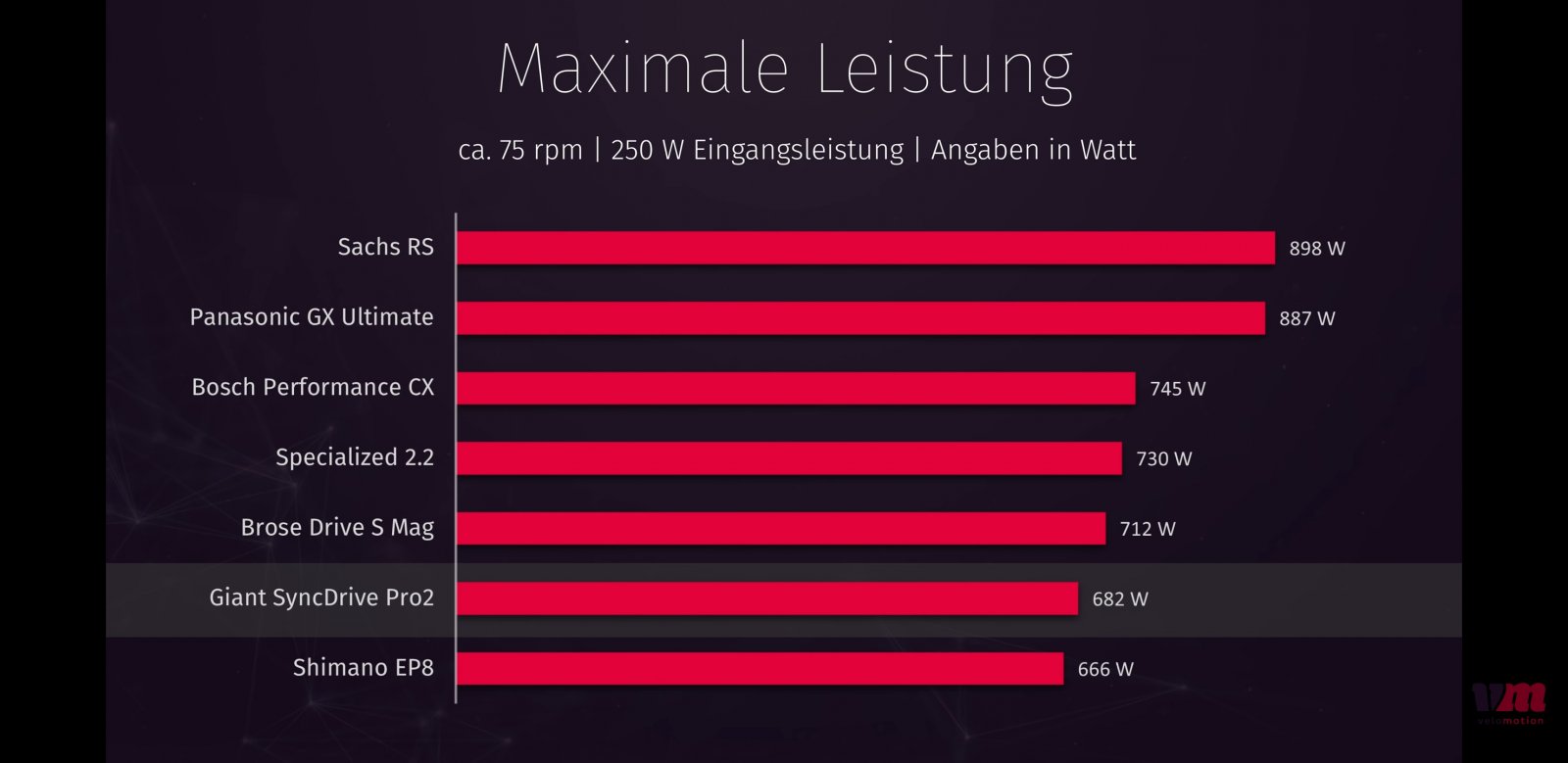

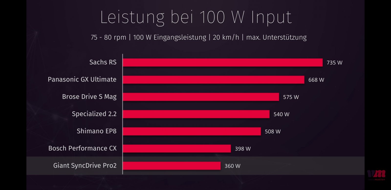

I found these(pics) max power output at an input of 250W and power output at an input of 100W numbers in the video from the German YT testers.
It seems the PW-X3 is modest with power delivery at lower cadences and lower power input. The tester said that's why it has reserves in higher cadences. But the max power output is lower so your theory adds up 👍

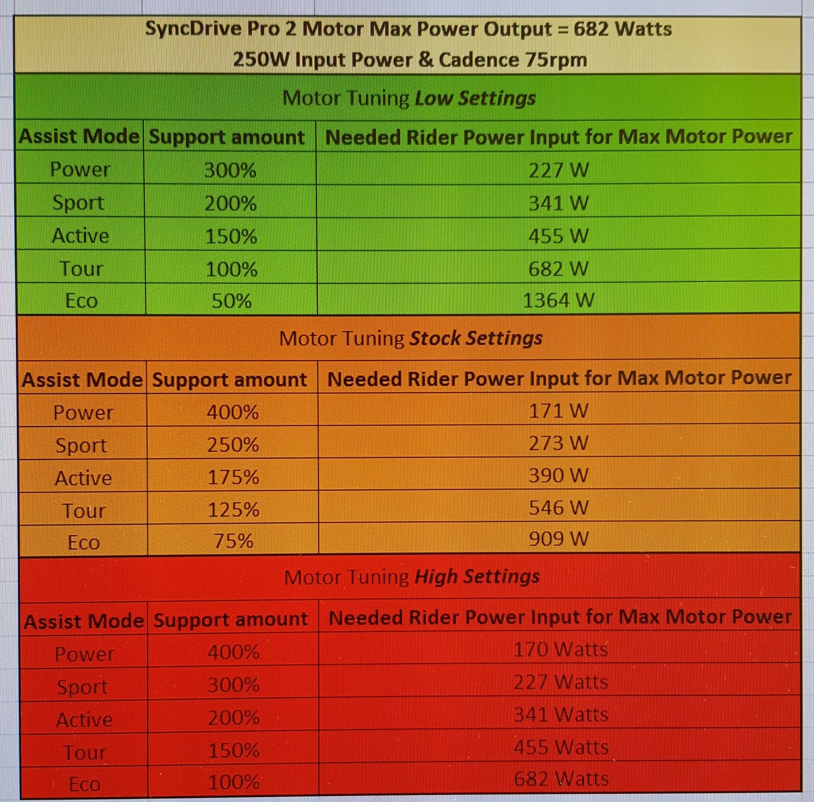

Hey guys to add up to the recent posts about motor tuning within the app...
I created an excel sheet with the all possible settings and based on in the german review of the 682 Watts of max power for the Syncdrive Pro 2 drive I added the calculated needed rider power input to reach/get max power from the motor.
It's especially useful if you know your FTP as goroncy already mentioned in his post.
Consider it as an informational post if anyone has a need for it... ✌⚡🚵‍♂️

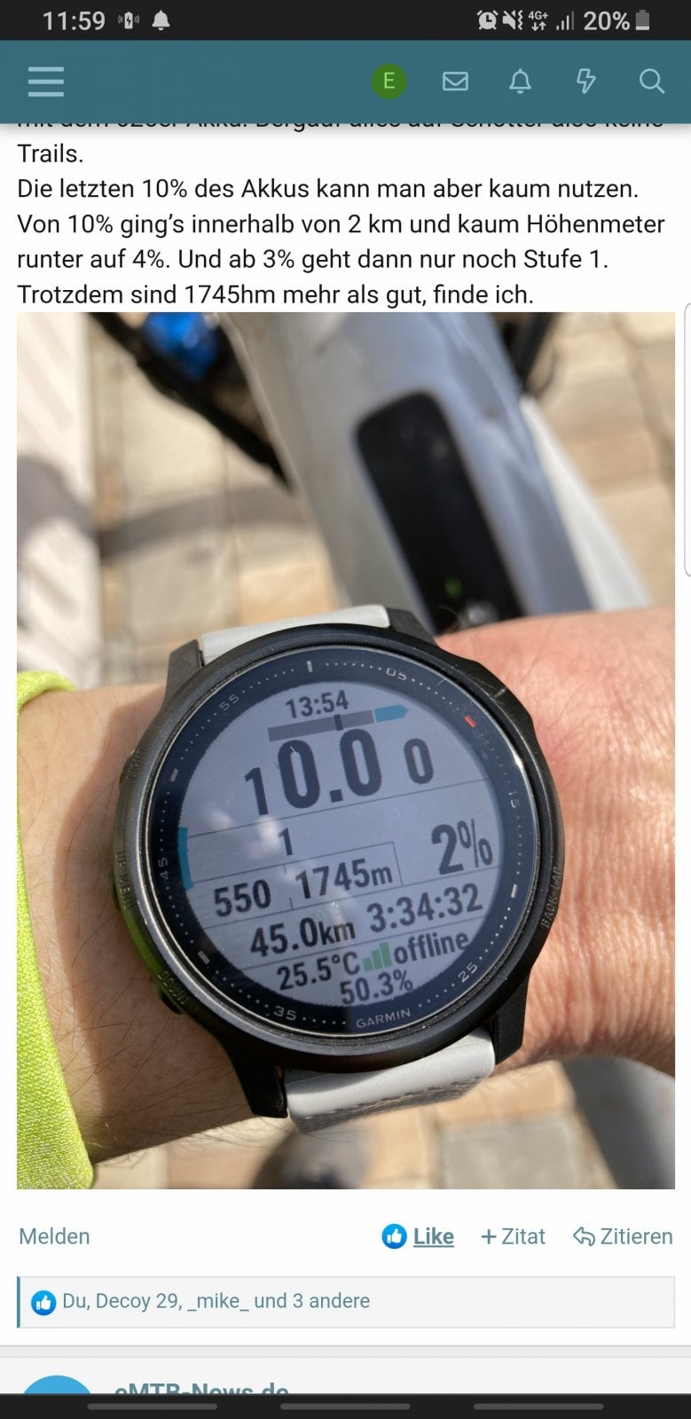

I am also following the german forum...maybe this is one of you guys I don't know, but it's a pretty excellent range if you ask me...99% in mode 2 / 625Wh
...looks like the warm weather is resulting in much improved range...✌

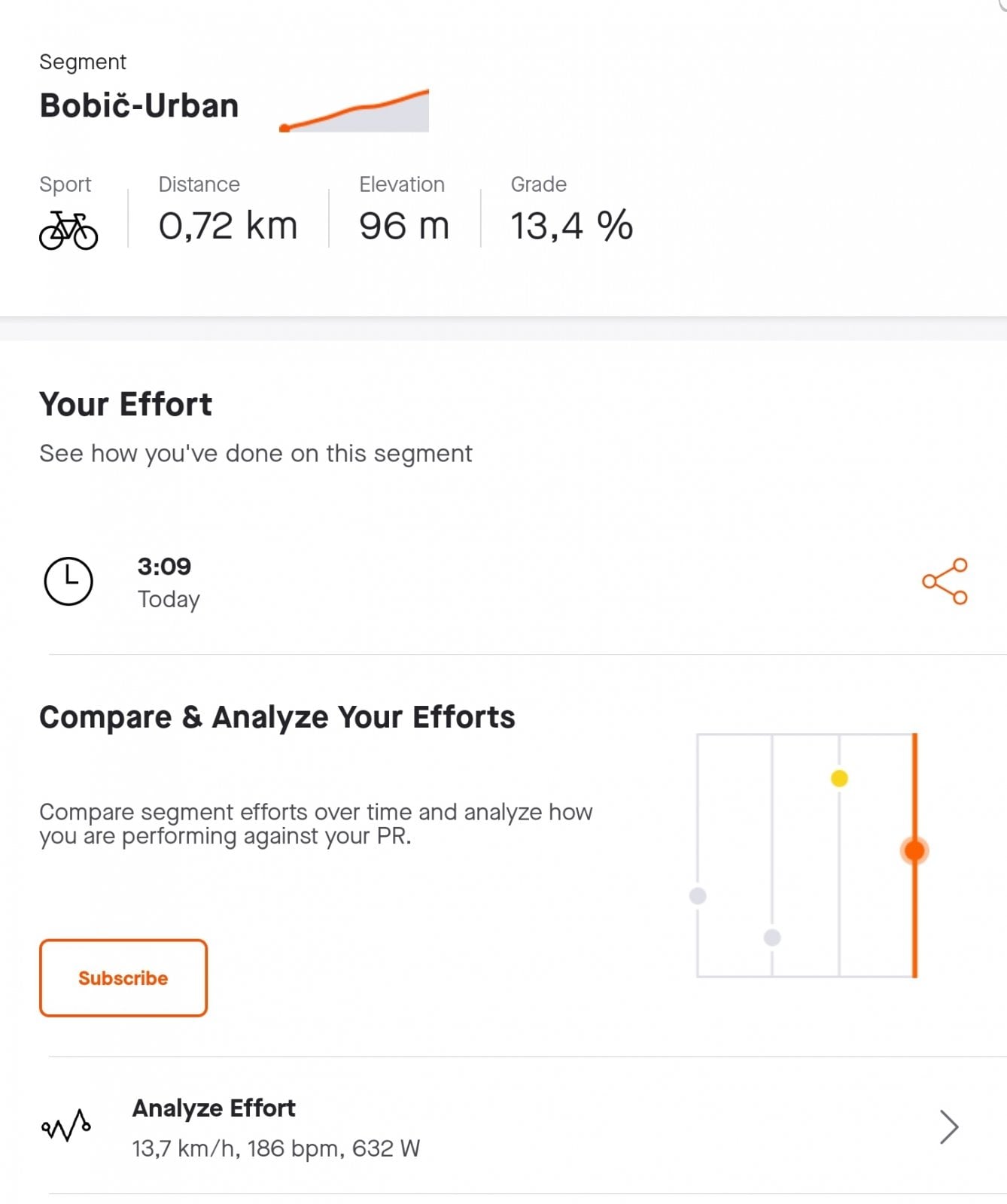

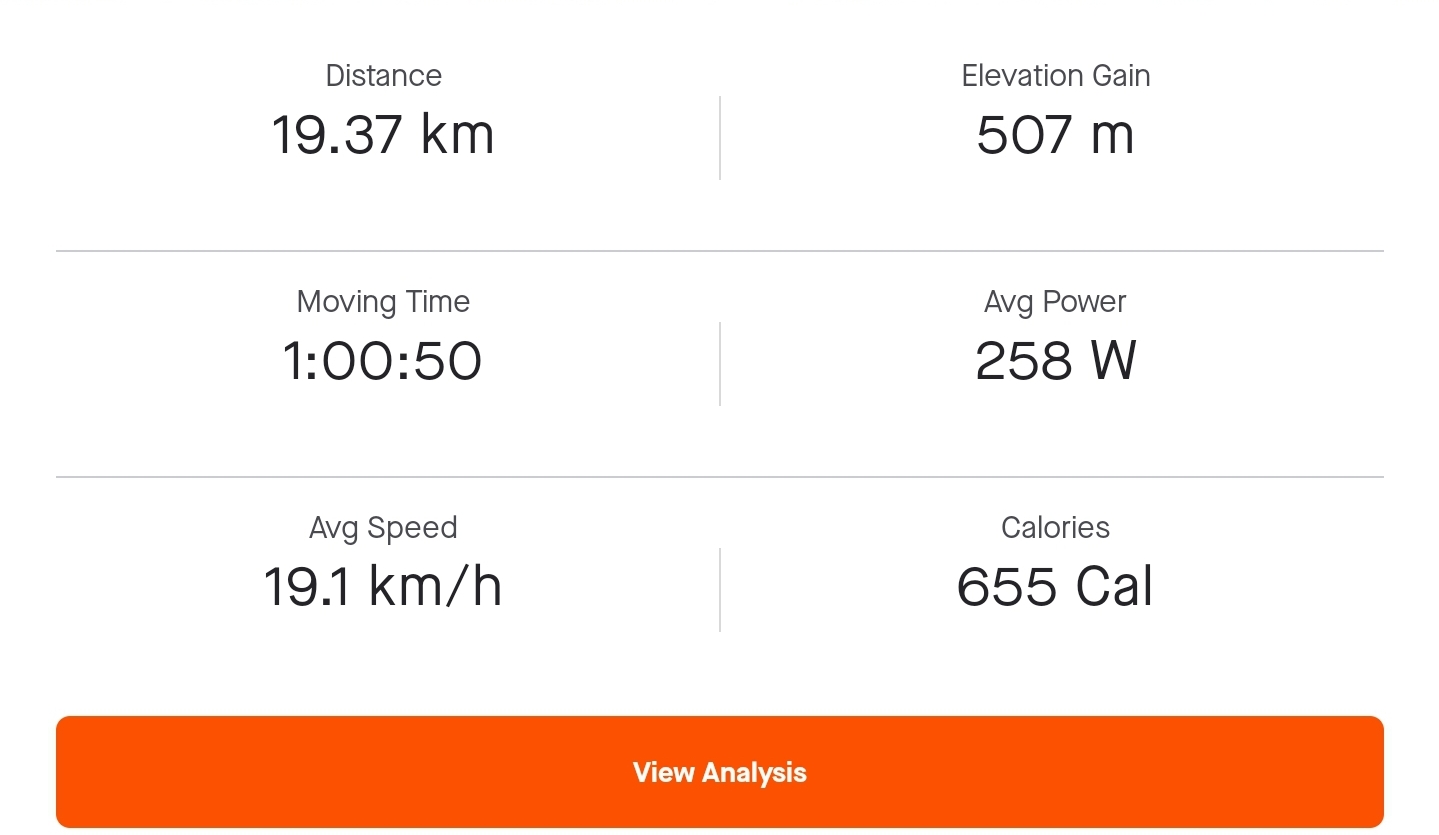

Did a ride today...
Auto mode only(no support on flat and downhill)
Half paved half fire roads
E+1 All stock settings and equipment
625Wh
15°C
Battery consumption 70% 》》》 42% = 28%
Elevation gain 507 m
Distance 19,4 km
Average Power 258 W(by Strava-not far of..in reality I am a bit bellow 250W)
Theoretically It works out to a range of 69km and altitude gain of 1810m...I guess the Auto mode isn't that bad even though it feels funny sometimes.
One interesting point was my full power result of 632W (by Strava analysis) on a climb segment where I was pushing full out gas...probably it would be even better because I forgot to lock the shock...
