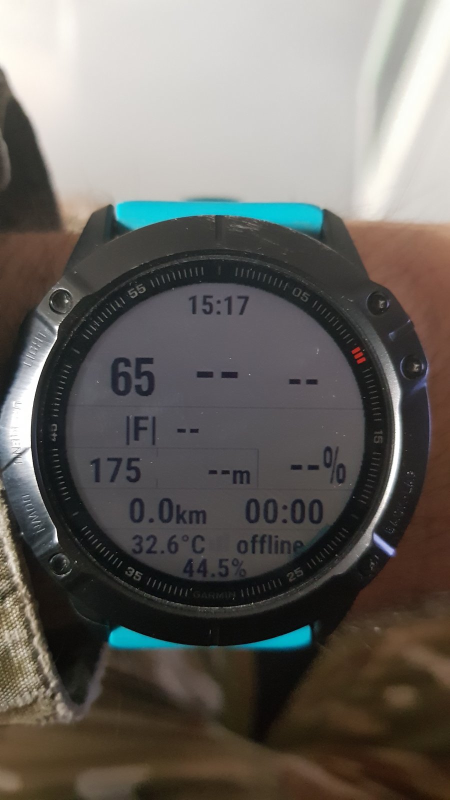

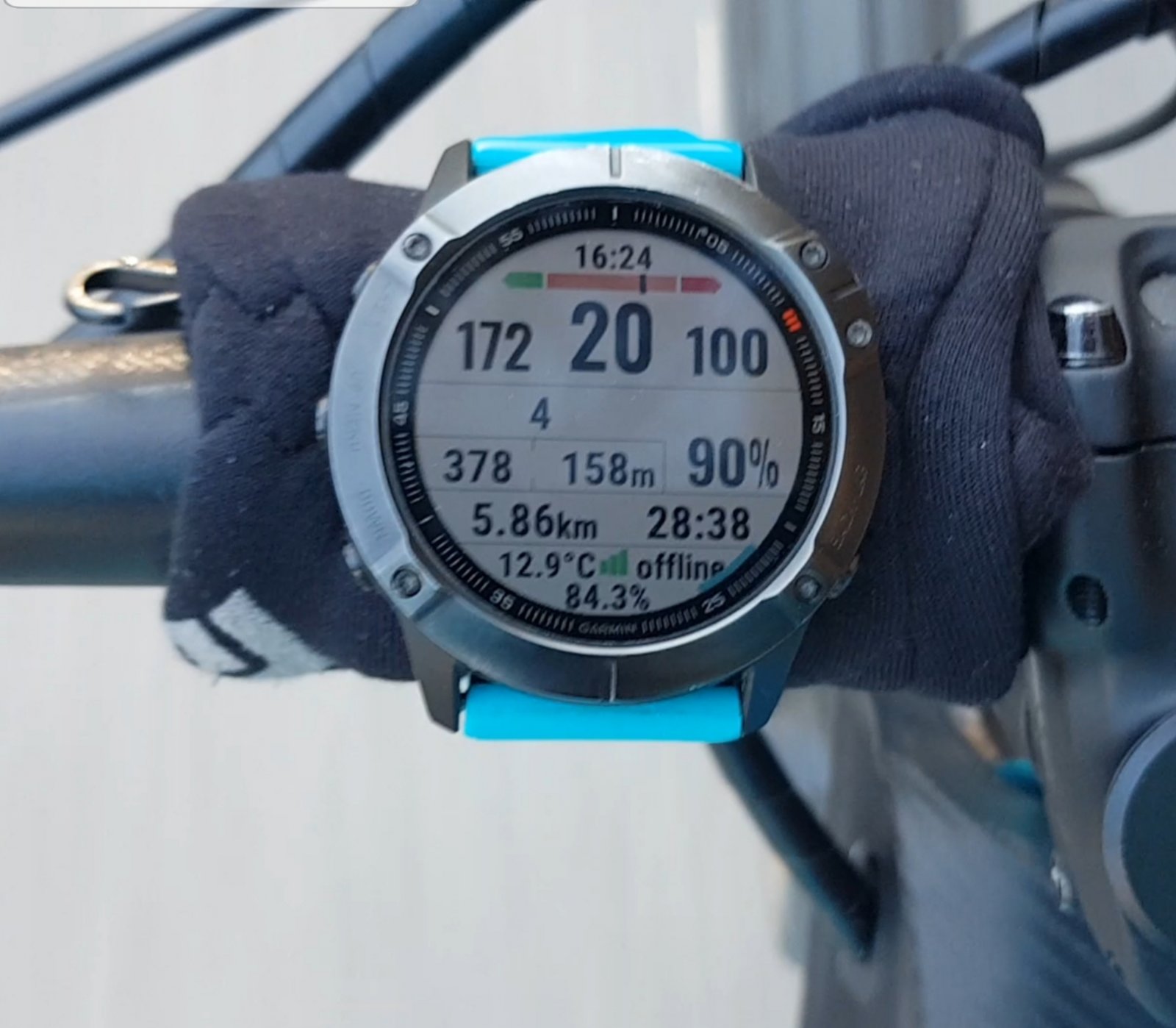

I have my E+1 connected with my Garmin watch where I can see the current power mode used(it showes them like 0, 1, 2, 3, 4, 5).
When I switch to A mode the bike is in mode 4 all the time(uphill, downhill, flat,...) it also feels like there is no software present that would regulate the power delivery in different conditions according to the sensor input.
This is a fair question, but I believe it is more of an integration issue (either on Garmin's side or Giant's side) and that they don't have a way to programmatically subscribe and publish the current power mode in real-time and display it to the user. So the Garmin engineer said eff it and just hardcoded the value to a 4 for display.
It would be a colossal screw up if Giant's automatic model is just hardcoded to level 4, despite all the marketing around the 6-sensor technology and smart algorithms. A simple way to test your hypothesis is to ride 30 minutes on each mode, each starting from full charge and on the exact same terrain, and compare the remaining battery life.

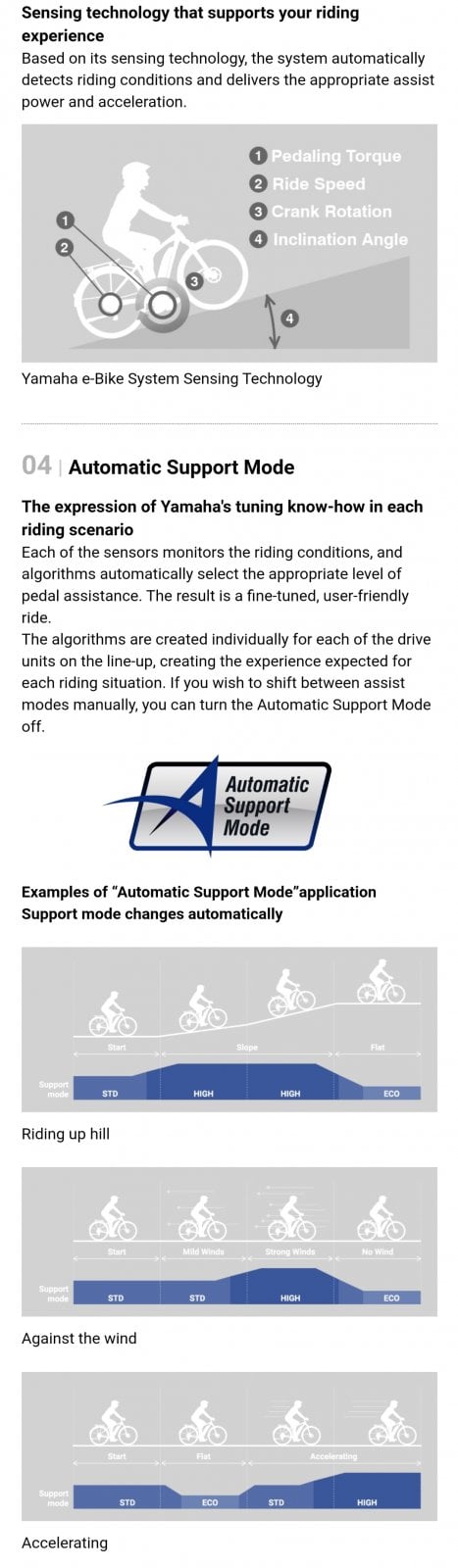

@emtbeast - the snippets in your last Post only apply to Yamaha Motors, but not Giant Syncdrive Pro because they added additional sensors and use they own firmware: PedalPlus 6-Sensor Technology | Giant Bicycles Official site
Comparing Apples with Oranges does not help a lot. If you don't like the Auto-Mode of the Giant motor, just don't useit or buy another bike ;-)

Hey good point 👍 I had my thoughts about the possibility about the Garmin being hardcoded to mode 4 in Auto.
Although I tried pedaling in Auto mode on flat terrain slow, medium, hard...etc...and the power delivery is the same strong as in mode.
I can see other modes change in real life. I will try to do a video of it when I have time.
I will also try to do your suggested test and will report about it...I am pretty sure 99% that Auto mode does not work as it should...based on 6 sensor inputs.

If someone has a garmin headset that can show "ebike" data fields such as power, then could that be used as a test to check what power the A mode gives you?

Regardless of the power mode set, Giant's Syncdrive Motor will provide assitance based on the input of the rider. Giant® E-Bikes, E-Bike Technology & E-Bike Usage | Giant Bicycles Official site
So if you push hard on the pedals, (regardless if the terrain) you will get the full power of the selected mode. And I expect it work this way - otherwise I couldn't do my trial-tricks like a flick turn on flat terrain or when going downhill ;-)
You would need to talk to engineer to explain in detail how the system is designed to work, and hence your expectations are pure guessing.
I agree that Auto Mode sucks on flat terrain with little input from the rider, but I love it going up on steep trails (see my earlier statements about it. Maybe Giant will make the Auto Mode smarter in the future, maybe not. At least the Auto-Mode on the previous Generation got better with every firmware update of the motor.-
I am using the ebike field for the Garmin Fenix 6X watch or similar watches from Garmin that shows all the data that comes from the ANT+ connectivity on the Giant motor system. It has a power field but I think that is the rider power input, not sure. Will do a video of it soon, where you can see mode change in real time.

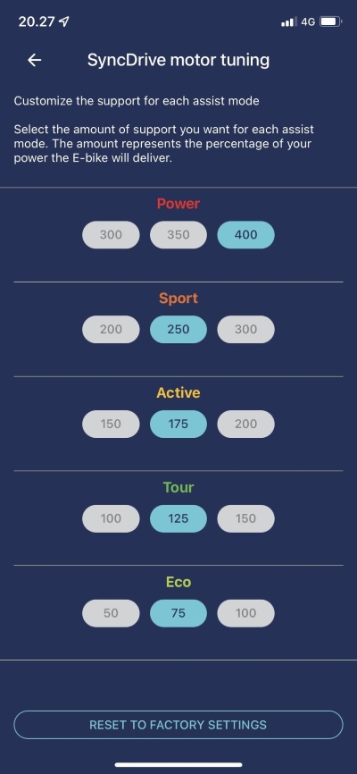

I have yet to connect the app to the bike, am I missing anything by not doing this? A friend told me that none of the power settings are at Max by default, so is there even more assistance waiting to be unleashed?
These are the default settings from the app. You will get more assistance if you pedal harder 🙃 I mostly use Active at 200.

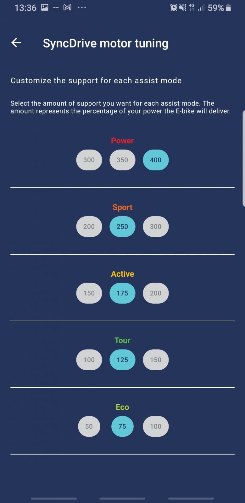

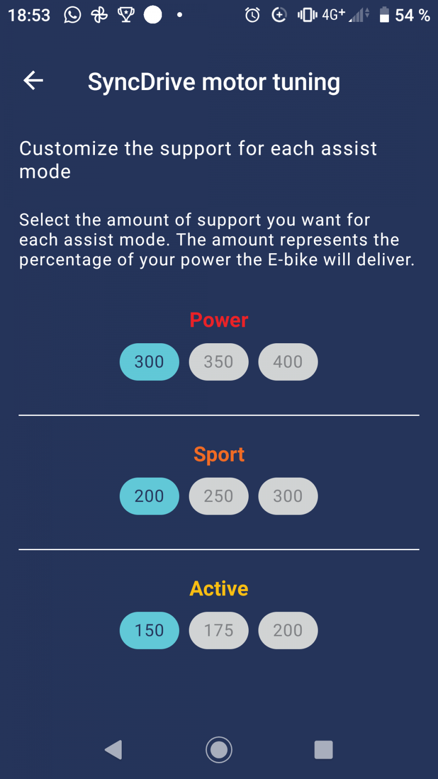

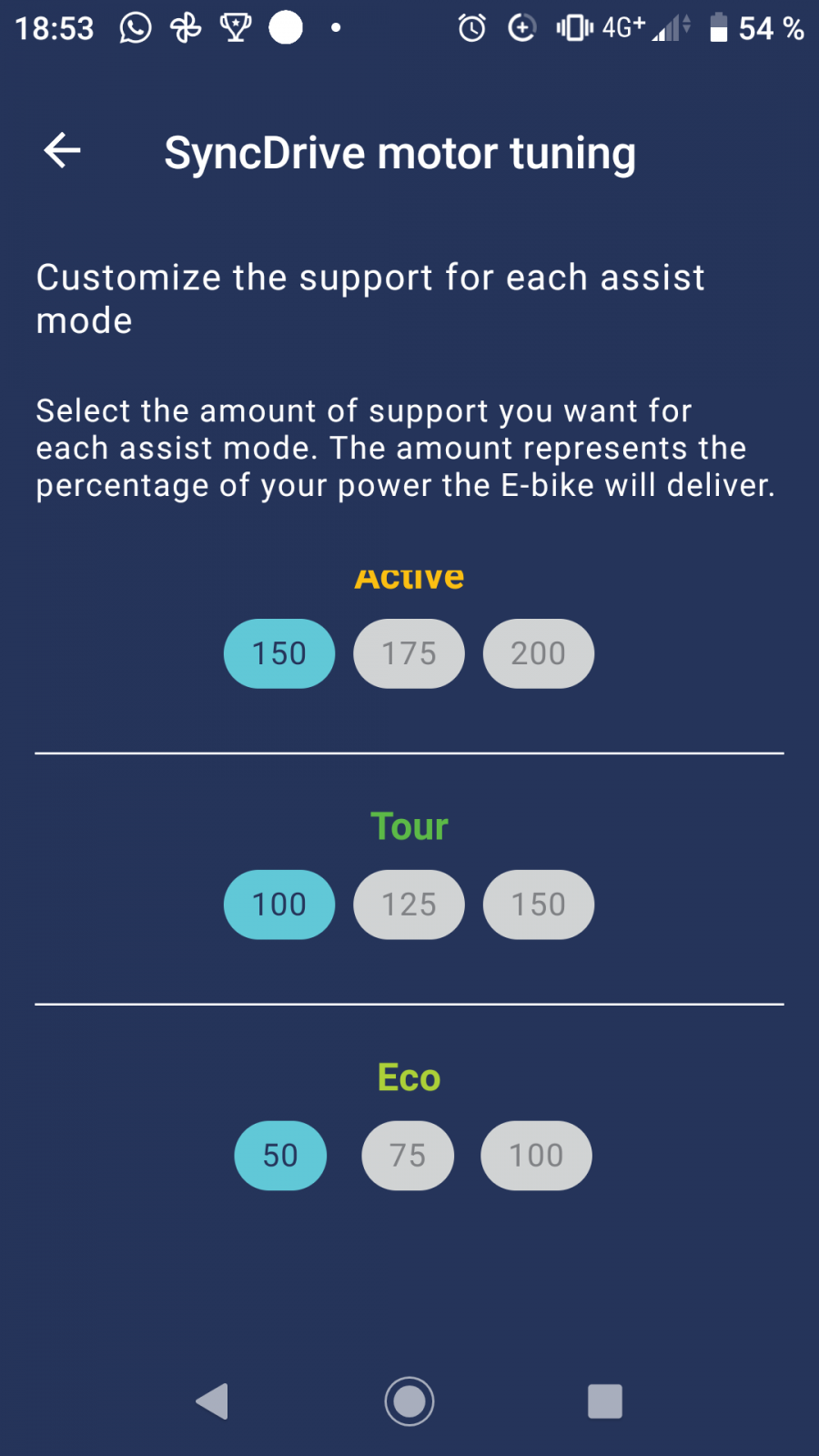

Yes you are missing something. Let me explain why.
I think that there is a some confusion as to how this motor works. For example. This are my personal settings:
What those numbers are, are percentages of your input. The 400 that is the maximum number is not maximum power in Watts. This is 400% of the input. OK. So what?
That means that the maximum that this motor can give you can be reached even in Eco mode set to 50%. You can reach the maximum on EVERY level. This is by design.
With default settings Sport is set to 250% and Power to 400%. My problem was that there was ABSOLUTELY NO difference between these two for me. Also the difference between Active set to 175% and Sport 250% was also MINIMAL. I could feel the difference at first spin, but after that the difference between Active and Sport was small. Why?
The answer is quite simple. My FTP (for those who don't know this is the max average you can produce in one hour) is right now 305. My usual wattage when just going biking is in the range of 150-200 Watts when going up the hill. So Sport 250% will try to produce power in the range of 375 to 500 Watts depending on my input. I have no idea what is the maximum power of Yamaha PW-X3 but it MUST be less than 500 Watts because switching to anything higher than 250% (higher than theoretical 500 Watts) makes ZERO difference. This is at least what my legs feel.
Now what? If you are a strong rider reduce EVERYTHING like me. If you are AVERAGE. Don't change anything. If you are a beginner max out everything. And PLAY with those numbers.
BUT. Why are you actually missing something without the app? Why to change anything? The answer is that if you will reach the max output of the motor too quickly (in Sport or even Active mode) your brain will be HIGHLY disappointed when switching to higher levels. Because there will be NO difference that will have any meaning. And that is not a nice feeling. Every assist level should produce a difference that you will be able to feel. Hope you will guys find that helpful :).
