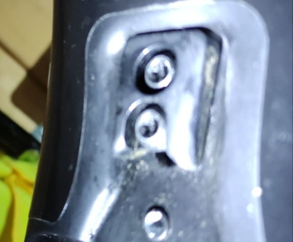

Unlike the poster above my problem is I can't get the battery out! For some reason it is tightly wedged, which is annoying so back to the bike shop to get fixed. With riding with a pal on exactly the same bike and he's battery unclips no problem. But you expect these are my niggles on a new design.
jbv
Sep 7, 2021
102
82
Vancouver Island BC
my battery is also in their very firmly. if my fingers and bike are cold, i often can't get it out, and use a large flathead screwdriver to help wedge it out. i've made a place indoors for it so a rarely drop the battery now....
i've wondered how the torx screw works internally. what is it turning and how does it hold the battery? i can't see or feel anything with the battery out to tell how it works.
Seems to be a V shaped cam that winds out when you turn the screw and locates in a notch in the battery just above the dubiously named safety clip.
I solved this today. Remove battery and cover, loosen the two Torx bolts in front of the cover. This holds the bracket the battery clips into in place. Then nudge it a fraction up. This created enough space so the battery was not binding on the bracket. Battery pops out perfectly now.
I’m wondering if my issue is the exact opposite ie instead of being too tight it is too loose. I’ll take it back to the bike shop and get them to check it out - and hopefully supply a new cover.
If that is the case it's an easy fix as I described, in your case you just need to slide the bracket toward the battery. We are talking mm's here.
Took it back to the shop today. The locking mechanism was set too far from the battery so would not fully secure the battery. This meant the safety clip also didn't work as it should so currently being fixed and a new cover is on its way under warranty.
Good that it wasn’t user error :)
The mechanic also reckoned there is a chipped or broken gear inside the motor which is causing the clacking noise - so probably a new motor as well. Just confirmed a new motor is on its way.

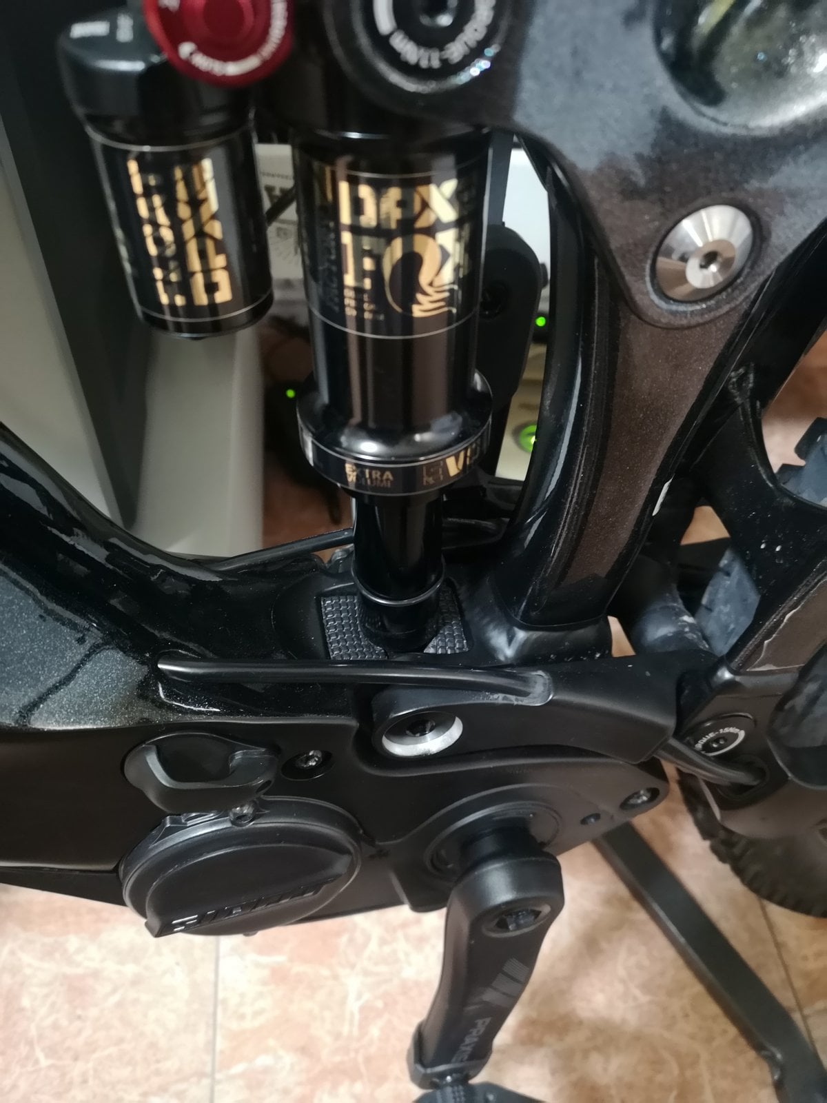

The point in the frame where the lower shock mount is attached keeps filling up with water and gunk. I’ve tried cleaning and poking, assuming there is a drain hole, but no joy. The only way to drain is to flip the bike.
Anybody else getting this issue? Am thinking of stuffing some Motofoam in there to prevent build up.
I have seen Marcelo Gutiérrez put a piece of sponge in giant Glory To protect that hole does not get mud.

El punto en el marco donde se sujeta el amortiguador inferior se sigue llenando de agua y suciedad. Intenté limpiar y pinchar, asumiendo que hay un orificio de drenaje, pero no me gustó. La única forma de drenar es volteando la bicicleta.
¿Alguien más tiene este problema? Estoy pensando en poner un poco de Motofoam allí para evitar que se acumule.

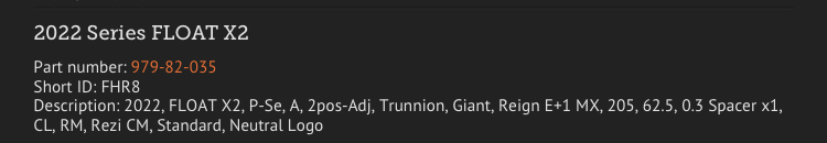

Have a Reign e+3 coming soon and a couple of upgrade already here (rc2.1, pedals, fender and stuff). Was looking for a different damper. Can anyone link a tuneID from an X2 Fox Elite/Factory damper? Looking for compression/rebound tunes so I can go looking for one :)
Weird - neither my fork nor shock (both performance elite) have a custom tune ID on them - both are blank where one would be. Does this mean they are 100% stock ie the same as you could buy off the shelf from a bike shop?
