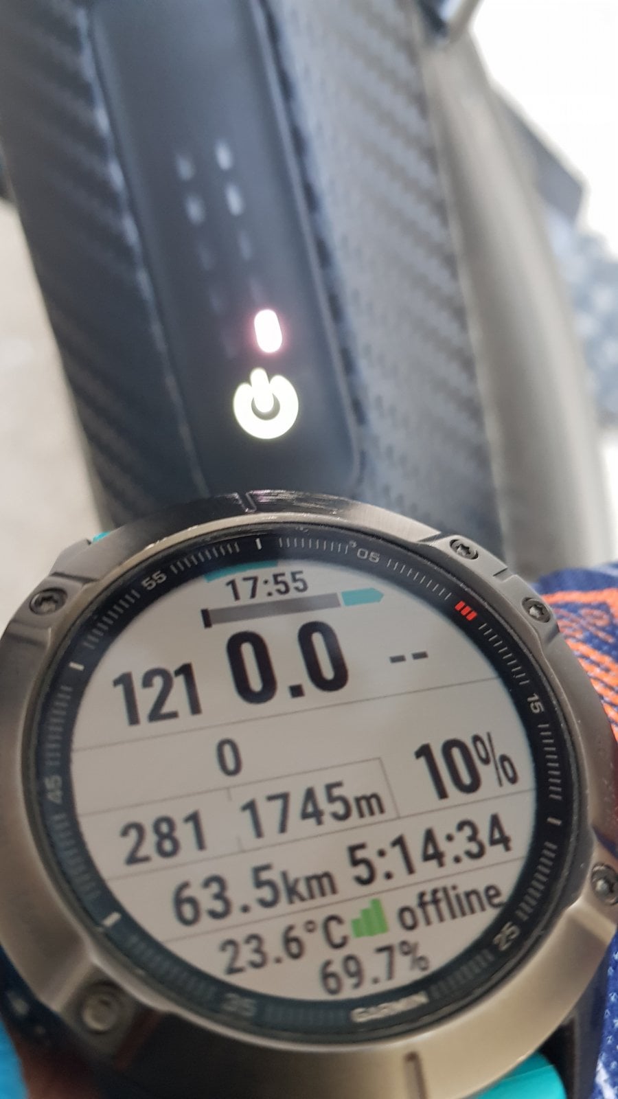

So I have an issue 🙁 bikes switches on and motor works, but I cannot change modes with the buttons on the bars or by pressing the power button. Can't even switch it off, just have to leave it till it auto switched off. Any ideas?

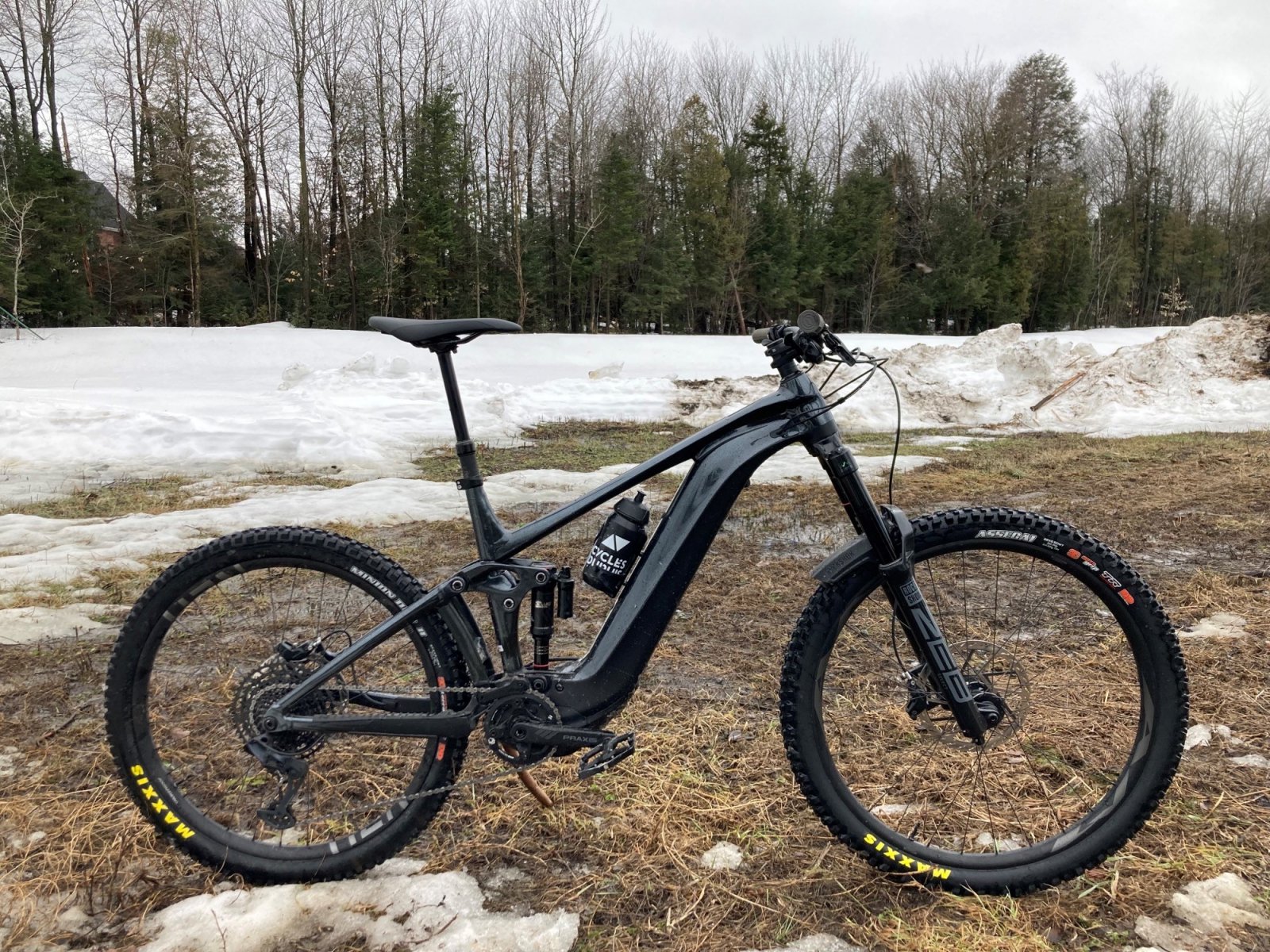

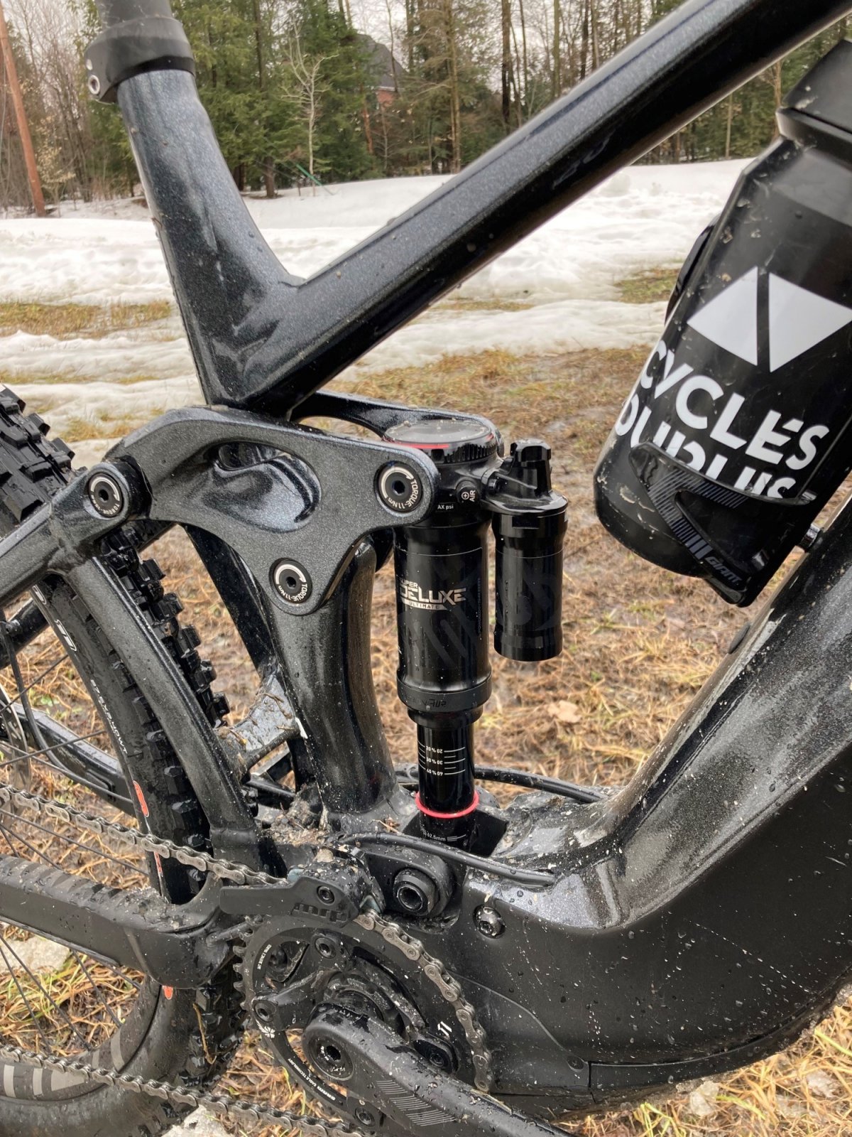

Replaced the DPX2 with a Super Deluxe Ultimate on my E+2.
The DPX2 was fine and the small bump compliance was super soft, but I had to pump it up @ max 350psi all the time and wasn't able to achieve 30% sag. I hated to pump that thing so much & the sag was a bit too much. Super Deluxe requires 70-80 less psi to achieve 30%sag.
Large negative chambers on Fox rear shocks are killing it for me as I'm an heavy guy...it's even worse with the X2 as it's 300psi max.
Super Deluxe is smooth, but the shock is definetely not as soft up top as the DPX2.
sprousaTM
Mar 4, 2022
36
43
So I waited 48 hours with no battery in the frame. Still the same issue. Friend of mine has a Giant as well as I have found out that uses a Giant RideControl Ergo SG unit. I guess I ll try to hook that up to the main cable and see if that works as someone in the thread has used it for a while. Maybe that gets rid of the issues and I can go back to the normal remote/ridecontrol. Last think I ll try tomorrow or wednesday.
Would really love to understand the source of the issue, but cannot find any manuals, technical information to the pw-x3 motor. No explosion views, no internal stats.

Another headsup concerning the Ridecontrol Go Unit. Was able to swap the Ridecontrol Ergo 1 SG unit from a friends bike over to mine. The unit is a standalone while the Ridecontrol Go unit seems to only function with the handlebar remote as a team.
After switching it works flawlessly. Can switch the bike on/off and change modes. The bike does not switch off by itself. I did connect via bluetooth with no problems.
Switching back to the stock configuration the issue is still there which makes me believe that maybe (at least in my case) the Ergo handlebar controller might be dead and not the part in the top tube with the LEDs. Would make sense since a different toptube unit had the same problem and the standalone controller works with no issues.
Sent back the spare unit and will get a different handlebar remote next, which is cheaper than paying the warrantyclaim fee.
