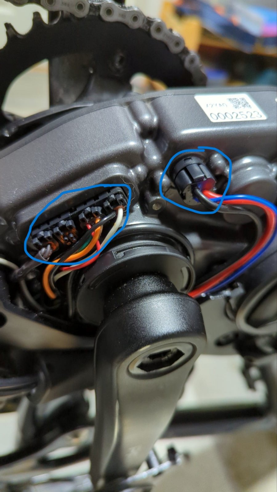

Took the cover off the motor to give it a check over and clean out any mud/water, quite a bit got in there. I took out the connectors as well to give them a check over and noticed a bit of moisture in there. Cleaned and dried them out.
I've got some of this Permatex 81150 Dielectric Tune-Up Grease anyone know if it's safe to use around the outside of the connections just to help prevent water getting in down the line? Cheers.
Buckle
Dec 18, 2021
48
62
I did a 6 hour loop in Torridon over the weekend and after stripping the bike down yesterday found much the same ( not too bad considering the bike was in the back of the car for 3 hours in torrential rain) The crud was easily cleaned up and dried off. However, I think this grease would be a good back up.
