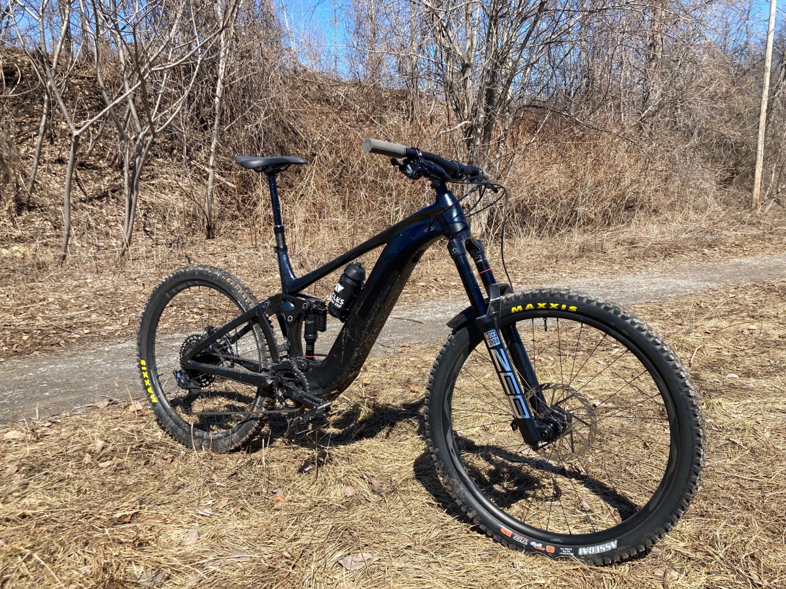

Did my first ride yesterday and had a blast, this is a game changer. Now I just need to set up the suspension.
Nice looking wheels, way to make the yellow Maxxis logo fit in the E+1 colors, IMO!
I ride an E+1 as well and I wasn't thrilled with the performance of the FOX 38 and X2 - felt way too harsh and jumpy for what I was expecting. I did read about excess grease and stuff and not having any tools around I've just decided to wait until I have a chance to go to a shop with official FOX service.
However I stumbled upon some post talking about equalizing the positive and negative chambers and I tried removing all the air, adding a bit of pressure (about 30 PSI, maybe) then trying to fully extend the fork and at first I didn't feel a hard stop when hitting full extension, but after a while it felt like something cleared up and I could definitely tell a solid stop when hitting maximum extension. After that I continued adding pressure and making sure I could feel the hard stop when fully extending the fork. Did the same with the rear shock.
The difference was night and day, honestly. I can use lower pressures to achieve the same sag (105 vs 120 PSI in the fork and 220 vs 250 PSI in the shock) and just using the recommended starting settings for HSR, HSC, LSR and LSC the bike feels so much better - way more supple and plush while at the same time making large roots and rocks almost disappear.
I have little experience and knowledge in this field, but maybe this helps someone. I'm left thinking that maybe the bike shop should have done this so that customers like me, to whom this need to equalize chambers wasn't obvious at all, can still enjoy a super enduro bike like the E+1 at its best.
