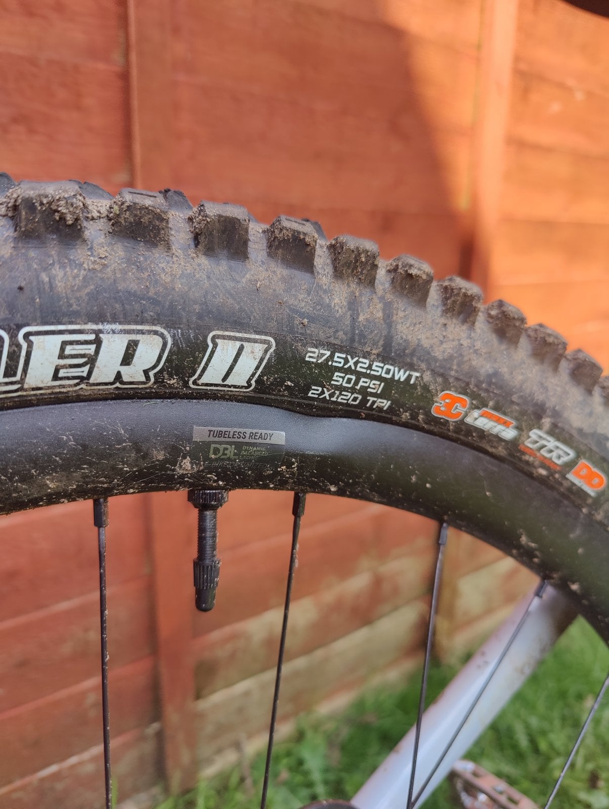

I went DT Swiss fr560 rims. Even stronger
The stock ally rims are soft. I'm running higher pressures now. Wheel is still perfectly true.

Yeah, I want to run the pressures I like without the rim falling apart. Fr560 is Dt Swiss strongest rim. I do a lot of bike parks and rocky trail riding so wanted something reliable

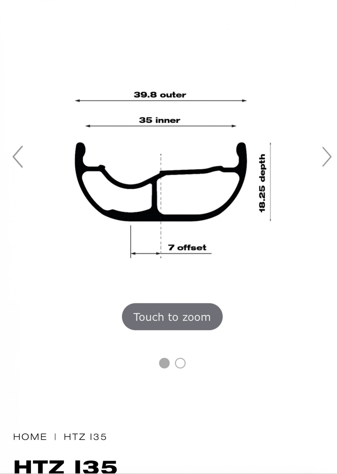

Hmmm someone always seems to issues with products no matter what… if you look at the cross section of the HTZ including 32 offset spokes I would be amazed if you destroyed it as well. Ruining a wheel doesn’t mean that much no matter what brand , there is many variables that come into play. So unless there’s A lot of complaints about a certain wheel and you start off with a good strong set your good to go 👍😎
“The thickest rim walls we offer, a proven I-Beam center support, asymmetrical spoke hole drilling and dependable 6069 aluminum alloy deliver a bombproof rim that doesn't break the bank. HTZ i35 and i40 rims are optimized for your e-assist trail bike running 2.6-3.0" tires.”

Except that you don't have ANY experience with the HTZ. Nor have you stated what WTB rims you've broken previously so any sort of meaningful comparison can be made.
HTZ i30 is most likely stronger than the FR650.
