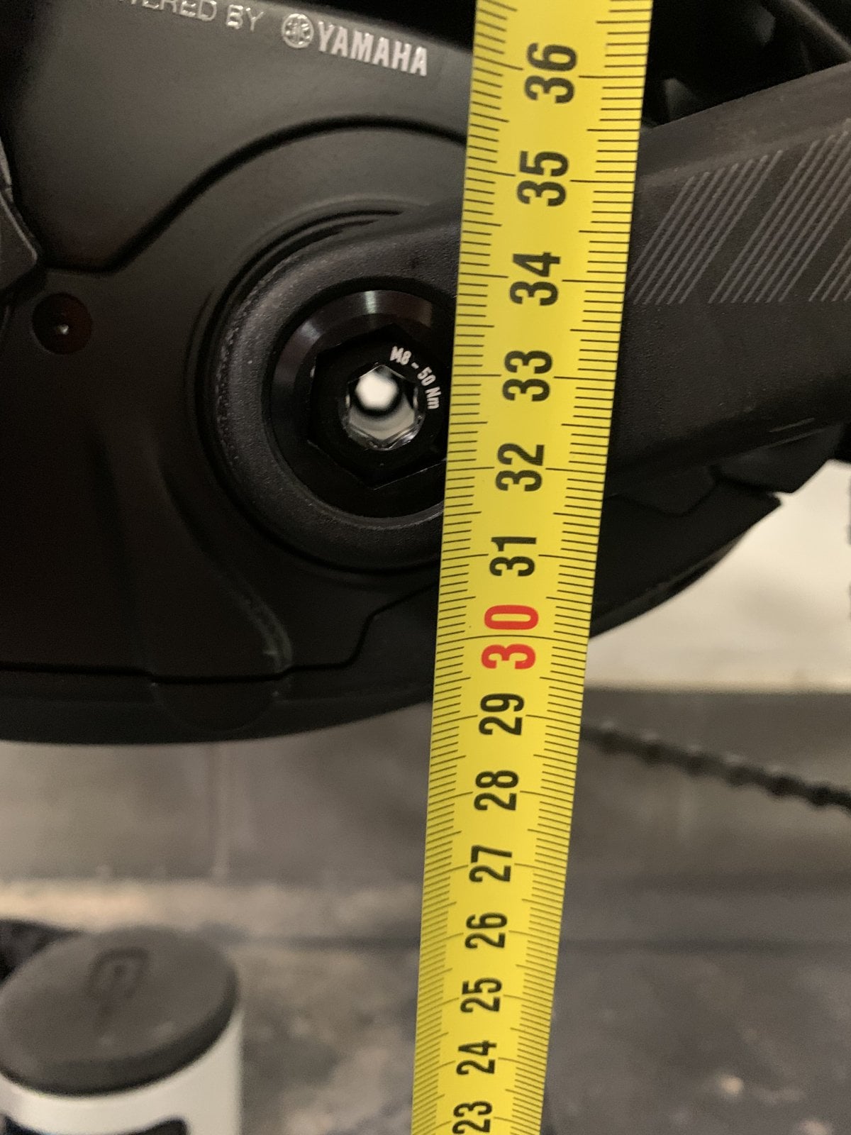

Hi Rob, just back from LBS with new Reign E+2, 342mm flip chip on “High" everything stock no modifications.

Hi Rob, just back from LBS with new Reign E+2, 342mm flip chip on “High" everything stock no modifications. View attachment 80988
Interesting. I’m gonna have to measure another time to make 100% sure!
I did get help from my daughter to take the picture, I held bike as level as I could at balance point and got pic as in line with the BB as possible (you can see through to the other site).

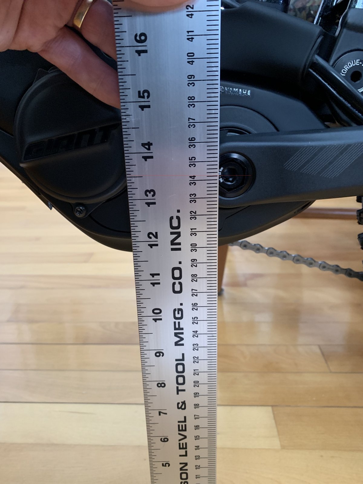

Check the pressure in the damper. And to be sure check the stroke of the damper. Maybe your bike "eaten" 2 or 3 mm of the stroke of the shock. Size of tires won't matter so much. We are all pretty much on the same gums. I'll check my bike in like 30 minutes in both low and high. With a good metal ruler.
I’ll check it out 👍. Last ride was at a bike park and I definitely added more air to the shock and ran less sag. But will be interested to check why mine is measuring this low!

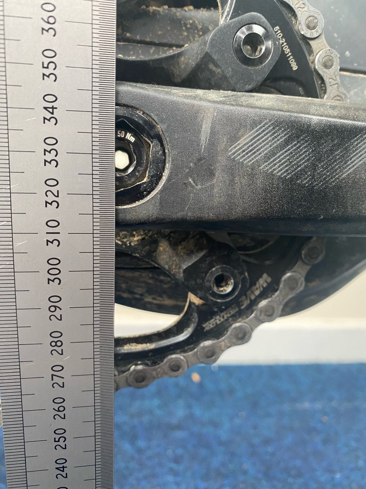

Here’s another pic (taken at the same time I measured but just wanted to check it was accurate). Camera height at the exact height of BB - can see through the BB.
Bike leant up against wall, straight as possible, at balance point.
Giant Reign E1, flip chip in HIGH:

You are using foldable measure. By design most of them will show 2mm less because the tip is moving. Check it out.
Yah I know but it was what I had on hand. Gives a decent indication +/- 3mm.
edit: could have used my measuring laser but didn’t think of that.
