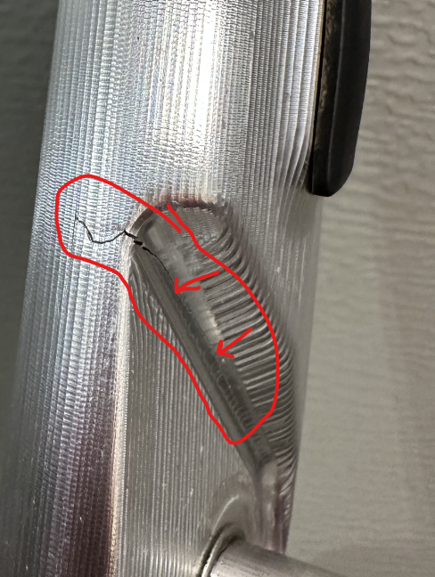

Hello everyone! It appears that the swingarm failure occurred at the pit designed for lower link clearance. Following the material failure, the bonding separates as the interface begins to bear most of the load. In some instances, even the link bonding may fail due to the uneven distribution of the swingarm load.
We've updated the swingarms on our Vikkelä bikes but haven't addressed this specific area yet. Receiving the broken parts is crucial for identifying the issue's root cause. The 7075-T6 production method sometimes results in quality inconsistencies, which could be the source of the problem.
As a high-end manufacturer, we're committed to providing reliable, top-quality products and ensuring customer satisfaction. Our 5-year warranty reflects this commitment and our goal to become a trusted name in the high-end mountain bike industry.
Our frames undergo rigorous testing, and while we didn't encounter this issue during testing, we recognize that our best-selling Voima model may still offer valuable learning experiences.
We're considering adopting an approach similar to Bosch's system to improve the warranty process. Customers purchase a replacement part, and if the warranty claim is approved after inspection, they receive a refund. This method could expedite the process.
We would appreciate your input on this potential solution, and your trust and satisfaction are paramount to us. Together, we can ensure the continued delivery of exceptional products and customer experiences.

Maybe the ultimate answer here for Pole is to appoint at the very least an authorised warranty agent in the UK and US etc to avoid delays in dealing with warranty claims. The process would be for the rider to deal with the local warranty agent who would have the authority to authorise or reject the claim and then act as the middle man to recieve replacement parts as required.........and send the broken part to Pole.
In response to your suggestion, while appointing an authorized warranty agent in countries like the UK and US could potentially streamline the warranty process, there are a few factors to consider. As a make-to-order company, we don't maintain local warehousing, which could affect the practicality of having a local dealer or warranty agent. However, we do have resources in the UK and reliable logistics partners who ensure fast delivery when required.
We understand that some warranty claims might involve accident damage rather than structural failure. That's why we already handle warranty claims in Finland using photos and videos, along with a written statement describing the circumstances of the damage. Our global warranty service is responsive, with replies typically within one day and cases resolved in just a few days.
We strive to create a fair and efficient process for both parties involved, and we are constantly working towards improving our customer service and relations. While the cost of a swingarm may be minimal for us, the main challenge is retrieving the failed parts for inspection. We appreciate your input and will continue to explore ways to enhance our warranty claims process.

I'm interested to understand if the newly designed swing arm is stronger than this one???
Based on Leo's take, it seems he wants to make sure that any potential "over-milling" in the joint area be assessed and immediately changed in the CNC programming for all units produced going forward.

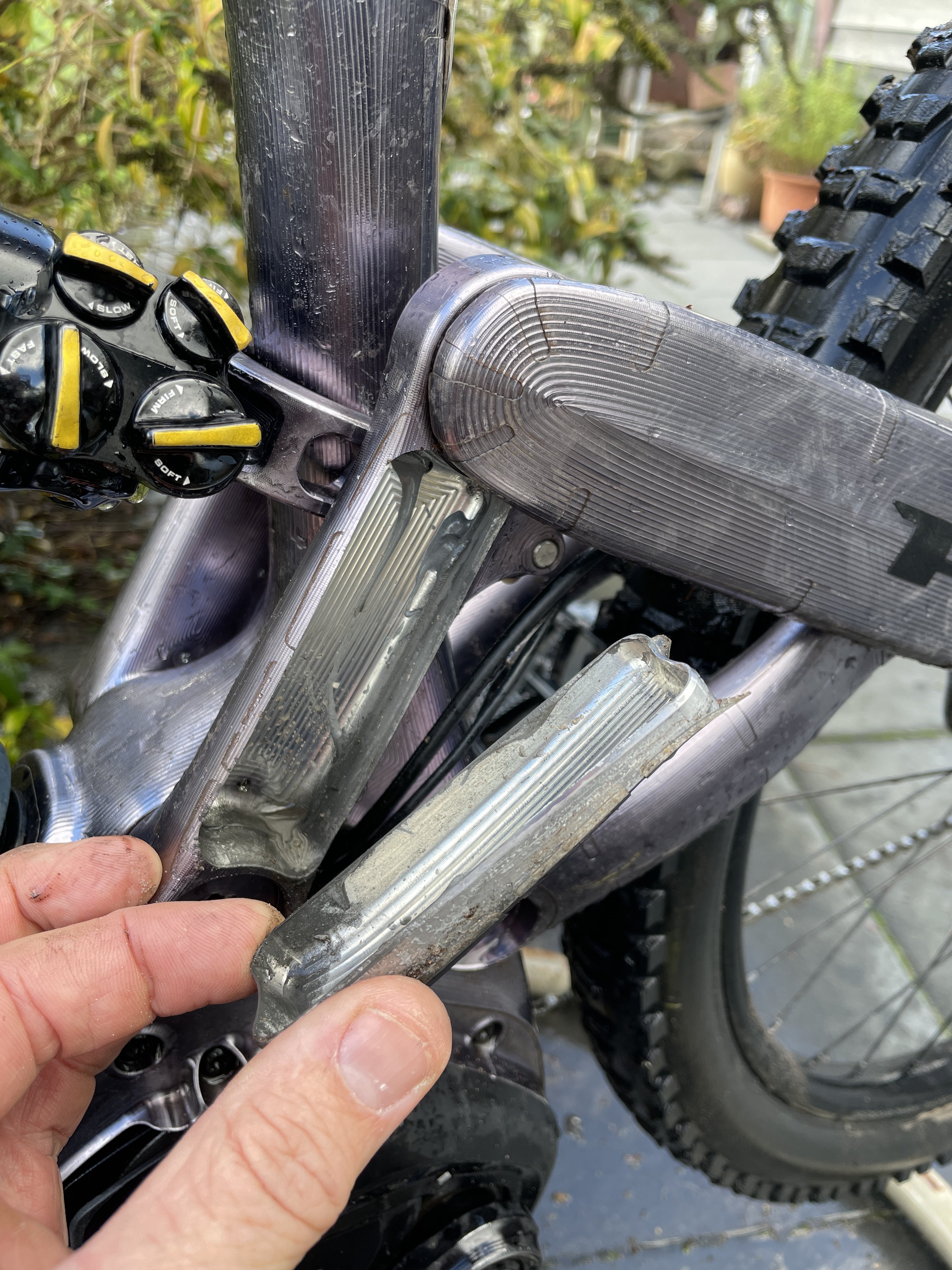

Hi Leo,
Yesterday after riding my Voima (april 2022, before led), a cap a small swingarm almost felt off. It seems to be glued in. Just glue it in again? Is the cap a part of the structure (I guess so ;-)).
What can I do about it? Other side seems to be OK.

Hi Leo,
Thanks,
Sander, the Netherlands
Interesting. Looks like the glue job is suspect. Although the swingarm appears to be functional, this looks to be a warranty incident and showed be logged with Pole. Hopefully, they will send out a replacement to swap out the part. I would get their feedback as to whether or not you should continue to use the bike in the meantime.

Hi Leo,
Thanks,
Hi Sander,
That's unfortunate. We've noticed that the issue you're experiencing typically develops over time; it doesn't happen suddenly. Our service team will replace the affected component for you. It's a straightforward fix.
While you're at it, please also inspect your swingarm for any cracks near the drive side and lower link joint. We've had instances of this, and it's crucial for everyone to check. Although we're not issuing a recall—since the issue is inconsistent and doesn't result in a catastrophic failure—it's better to be safe.
We are in the process of rolling out significant updates shortly to address these issues and will replace parts as needed.
