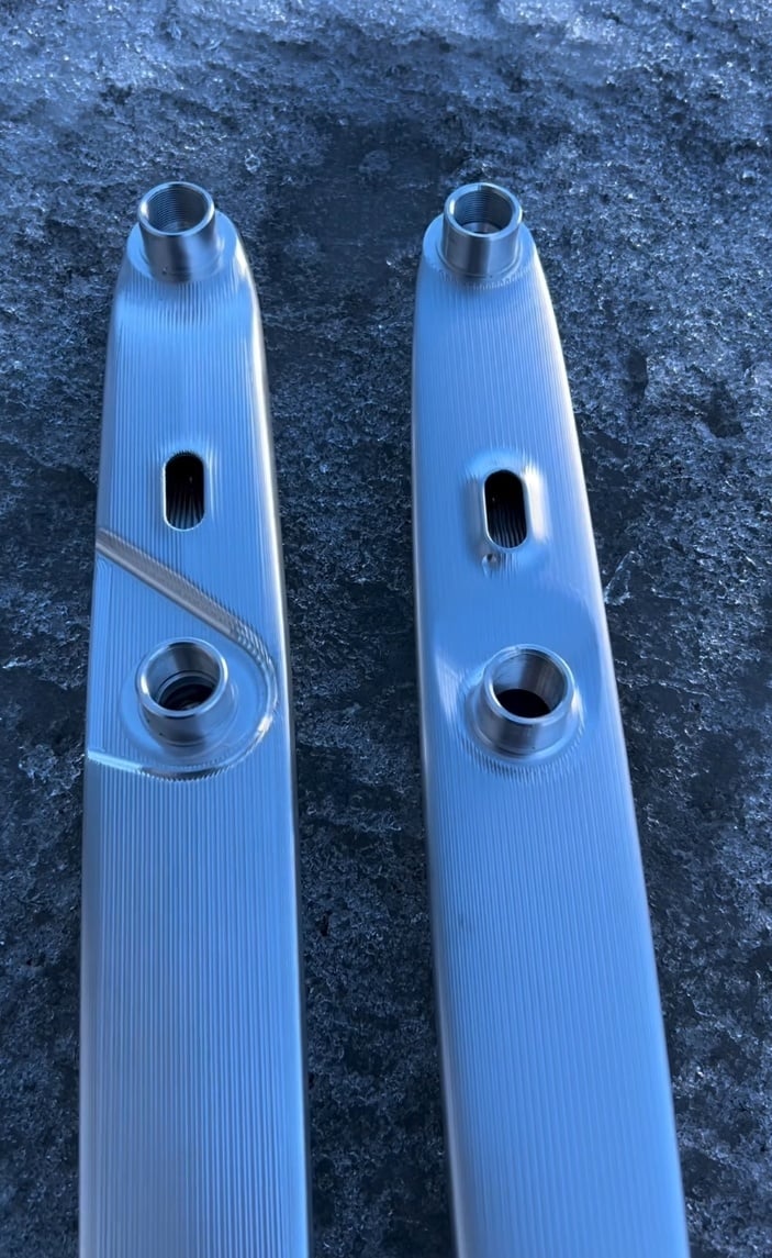

The replacement
Agreed on the prioritization.
Care to share the backstory on the take your time comment?
the replacement arm I received came with very few instructions, and I had a gap on the shock yoke after install. Pole advised torquing the axel bolts 10# beyond spec which wound up breaking the bolt heads. Luckily I had extra from the broken bits.

The replacement
It’s a shame that this happening!
Interesting, thanks for sharing. They did request a photo of the shock yoke so I’m assuming they have different versions of it and are insuring compatibility, likely due to what you dealt with.
