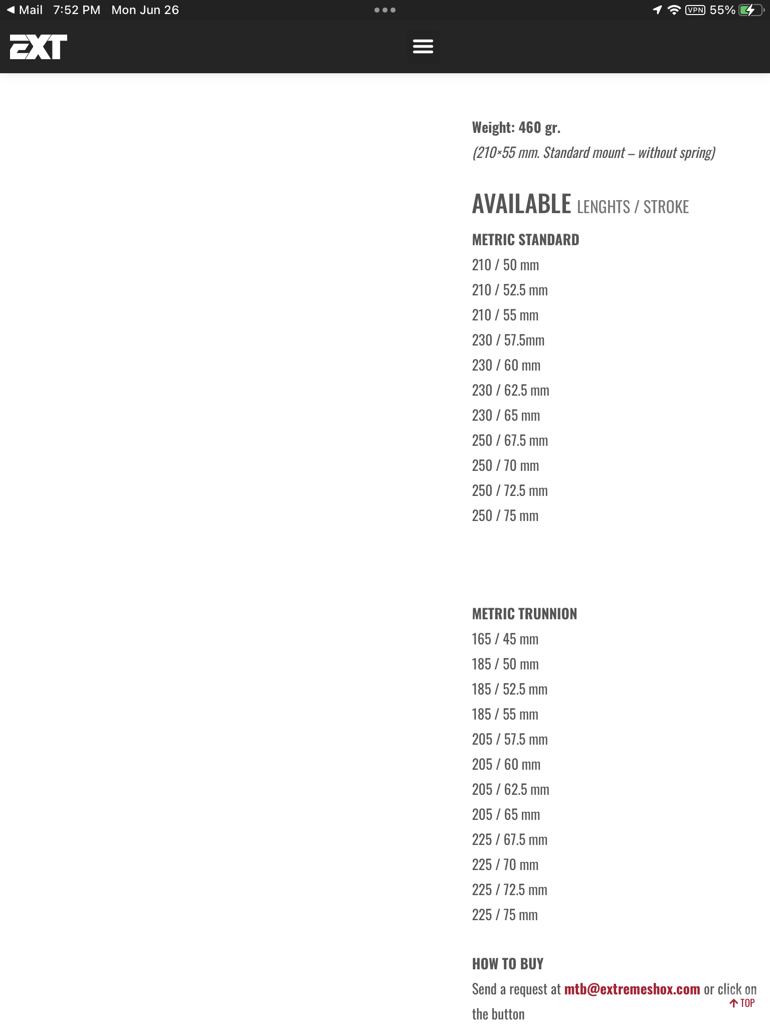

EXT doesn’t make an E-Storia in 250x75 guess I’ll wait on the Arma.
Onetime
Aug 10, 2022
481
501
Cali
They actually do. 😎👍🏼
EXT e-STORIA- E-BIKE DEDICATED DAMPER - Extreme Racing Shox

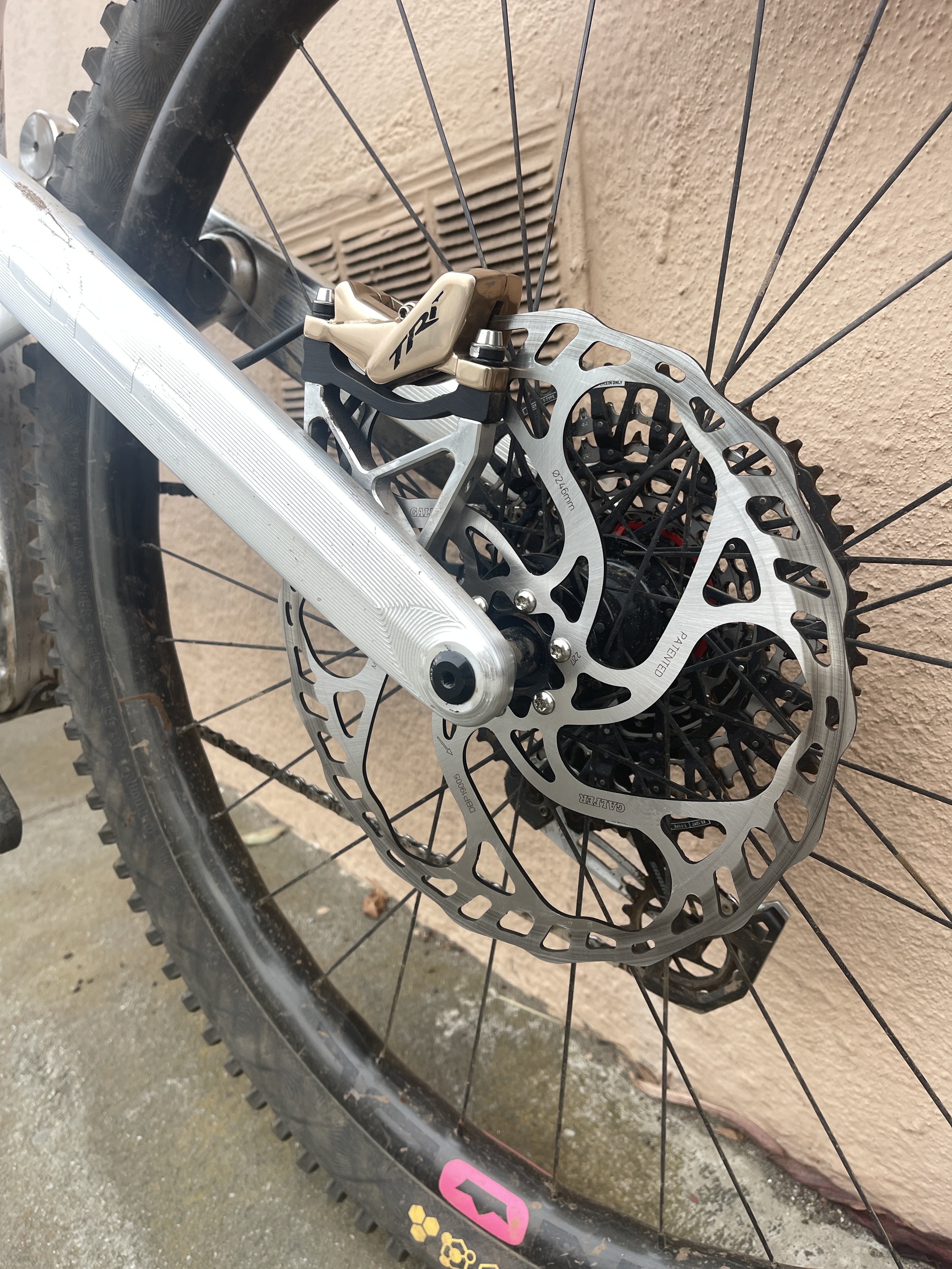

Not Voima specific but just added 246mm Galfer rotors and they… work. Just don’t mentally decide to covert them to 243mm like I did and chase your tail all day long figuring it out.
Once the washer spacers were added to accommodate that last 1.5mm (front only… rear got a 23mm added to the stock 223mm posts) they went sweet. Before that it was another story 😂.
That's more leverage on the mount and the rear swing arm. Might be worth asking the question of Pole.
You don't want to void the warrantee by running a rotor that's too big.
Side note. I haven't found a situation where a 200mm rotor on the back isn't enough.
I'm not trying to put it down but running a 246mm rear rotor just seems so unnecessary. I'll switch back and forth between my Galfer 223mm and 203mm rotors and at times I think even the 223mm is total over kill with my Trickstuff Maximas.
It was an interesting experiment but after todays ride the 223’s are back on. Those 246’s feel great up top but warp bigly when they get hot toward the bottom of the hill. Clanging around bangin the pads for a minute and then straighten out again when they start cooling off.
At 250lbs kitted the size felt pretty perfect from a leverage standpoint, but the 223’s work just fine.
Ran it by Leo and he didn’t know of a reason why it wouldn’t work off the top of his head.
It was a fail anyway. Something’s wrong with the design of those rotors. The warp way out of shape when they get hot.
What do you weigh on 200s? I’m captaining the meat wagon over here 🥩
