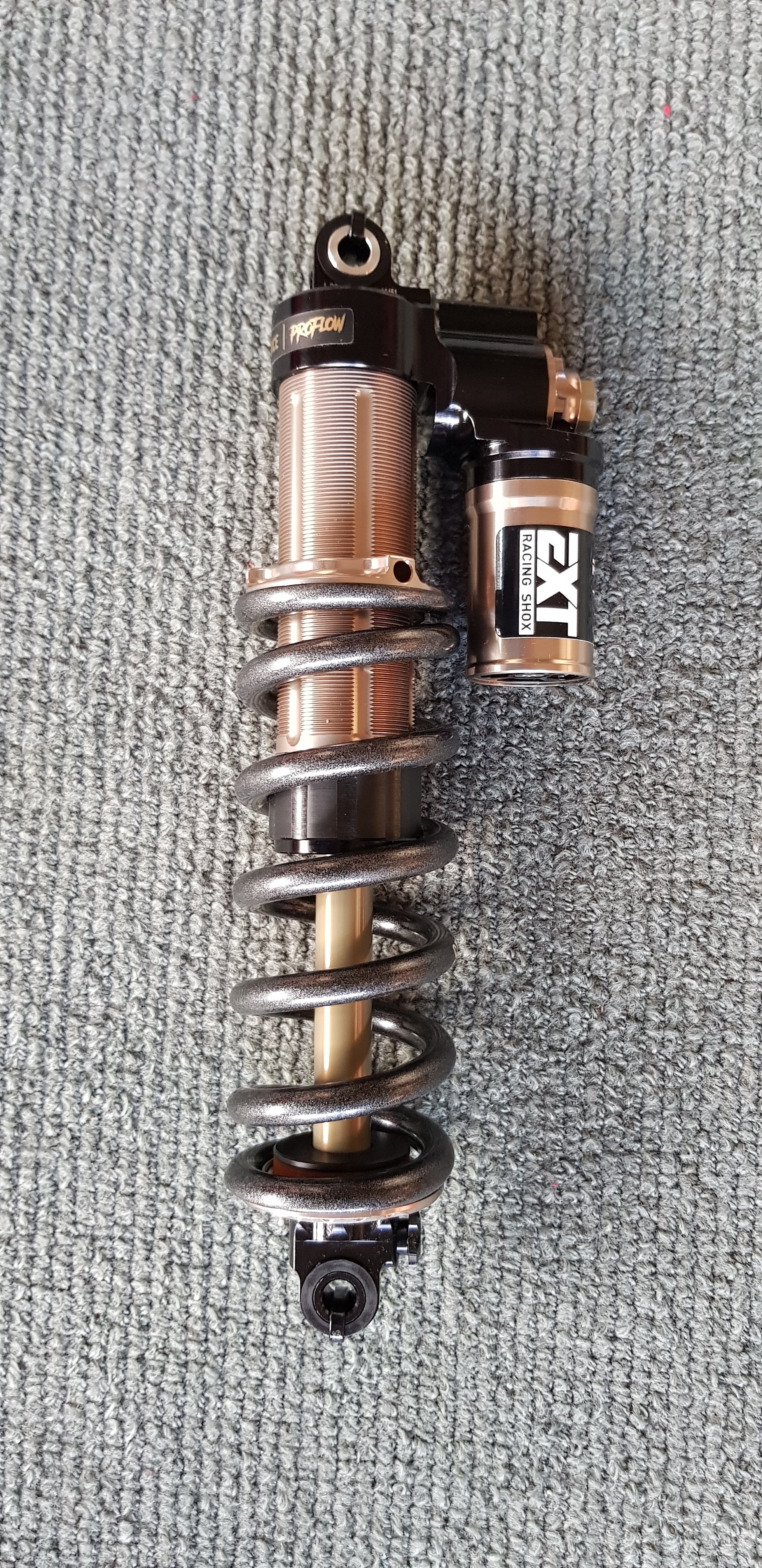

Nice! I've ordered one of those as well. Hard to beat EXT, I've had them on my past couple bikes. Have you ridden one yet?

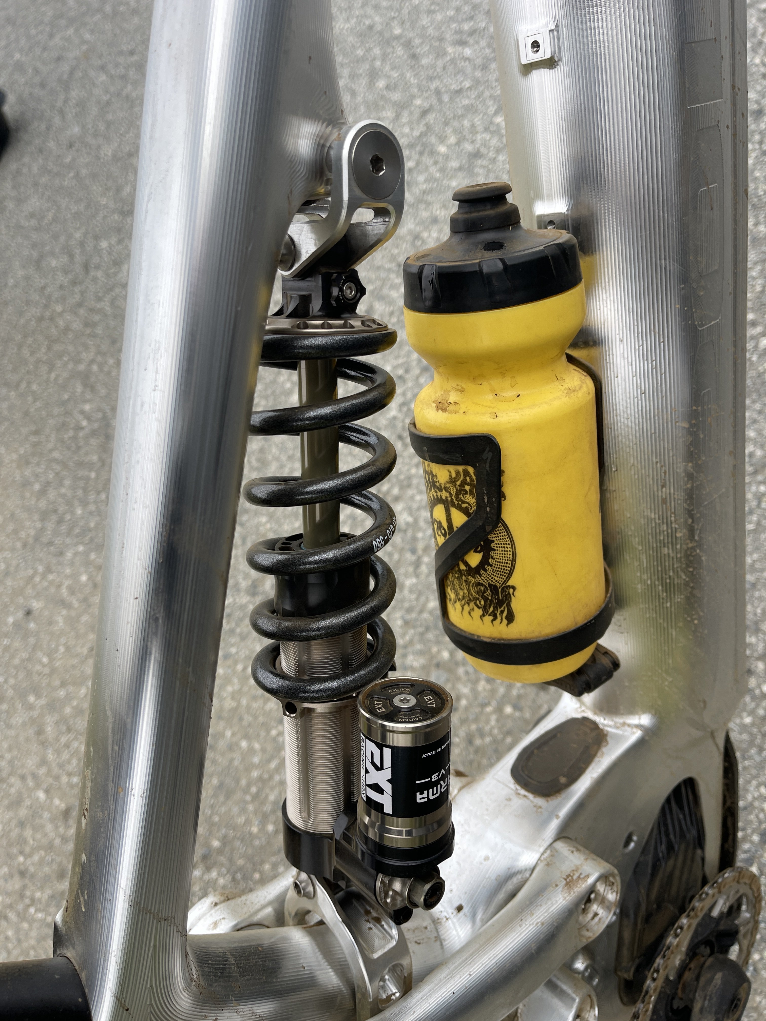

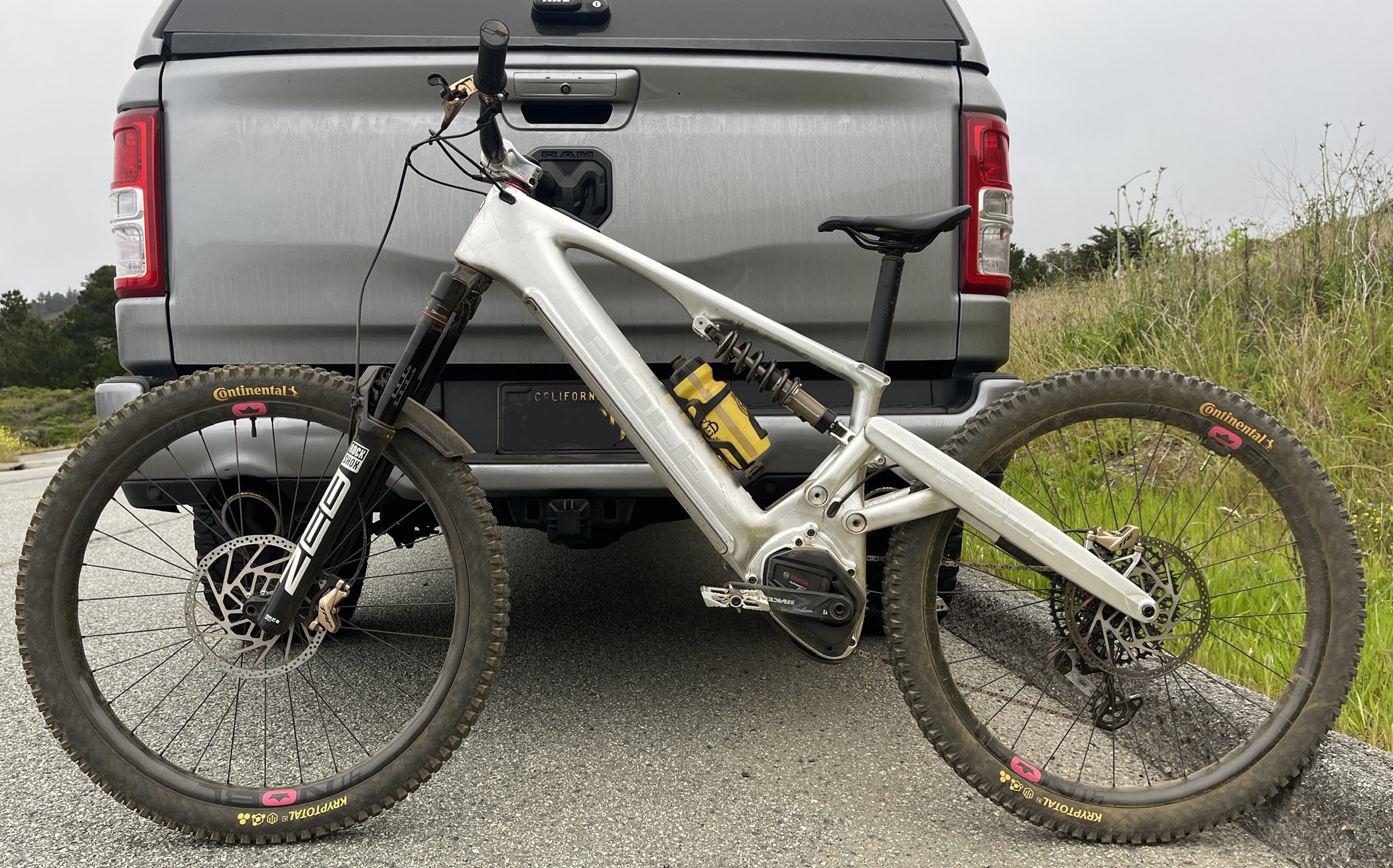

EXT Arma just arrived. Other worldly compared to stock. Shakedown ride tonight with first fully drained battery doing turbo laps on the local. This bike is something really special.
View attachment 115973 View attachment 115974 View attachment 115976 View attachment 115975
Why slamming stem so much?
I’m similar height as you and have 30mm under stem and 60mm rise bars, and 10mm rise stem. It’s just feels so much better seated, nice going down too. Basically matching saddle height with grips.
Also, which spring rate you ended up getting?
Blownoutrides
Mar 22, 2021
244
182
Maintaining similar stack height to my last few enduro bikes. Going higher could feel comfier seated but I’ve had issues with not enough pressure on front wheel when cornering when I’ve gone higher. Bar is 30mm rise but I’ve got a 50mm rise bar to play with. We’ll see.
Got a 500 and 550 from EXT. Went 550 to start with and feels pretty spot on, if a little on the soft side (?). Might swap the 500 for a 575 just to try it. My zone has a lot of jumps/drops but very few landings LOL. so having some spring in reserve doesn’t hurt.
