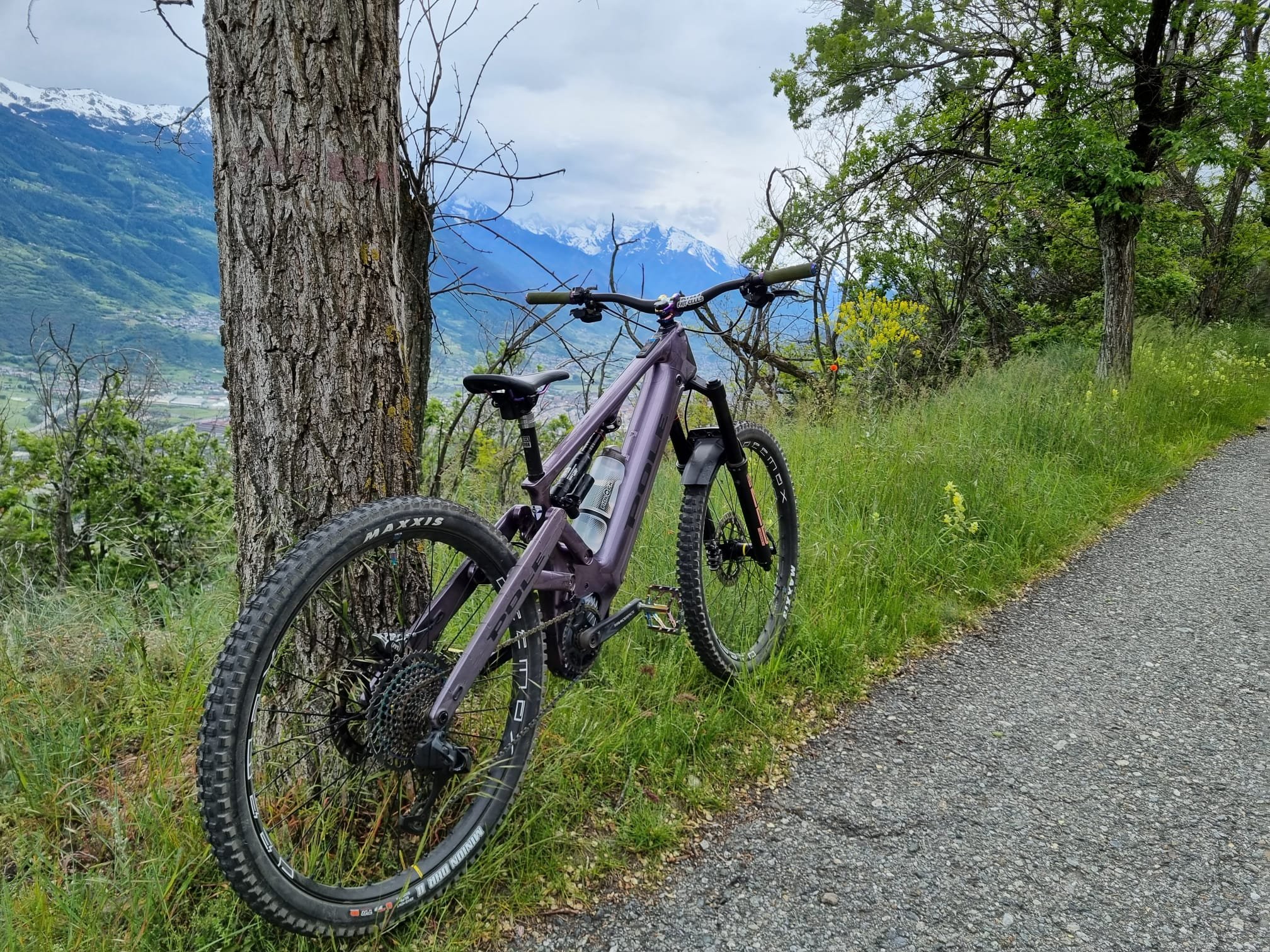

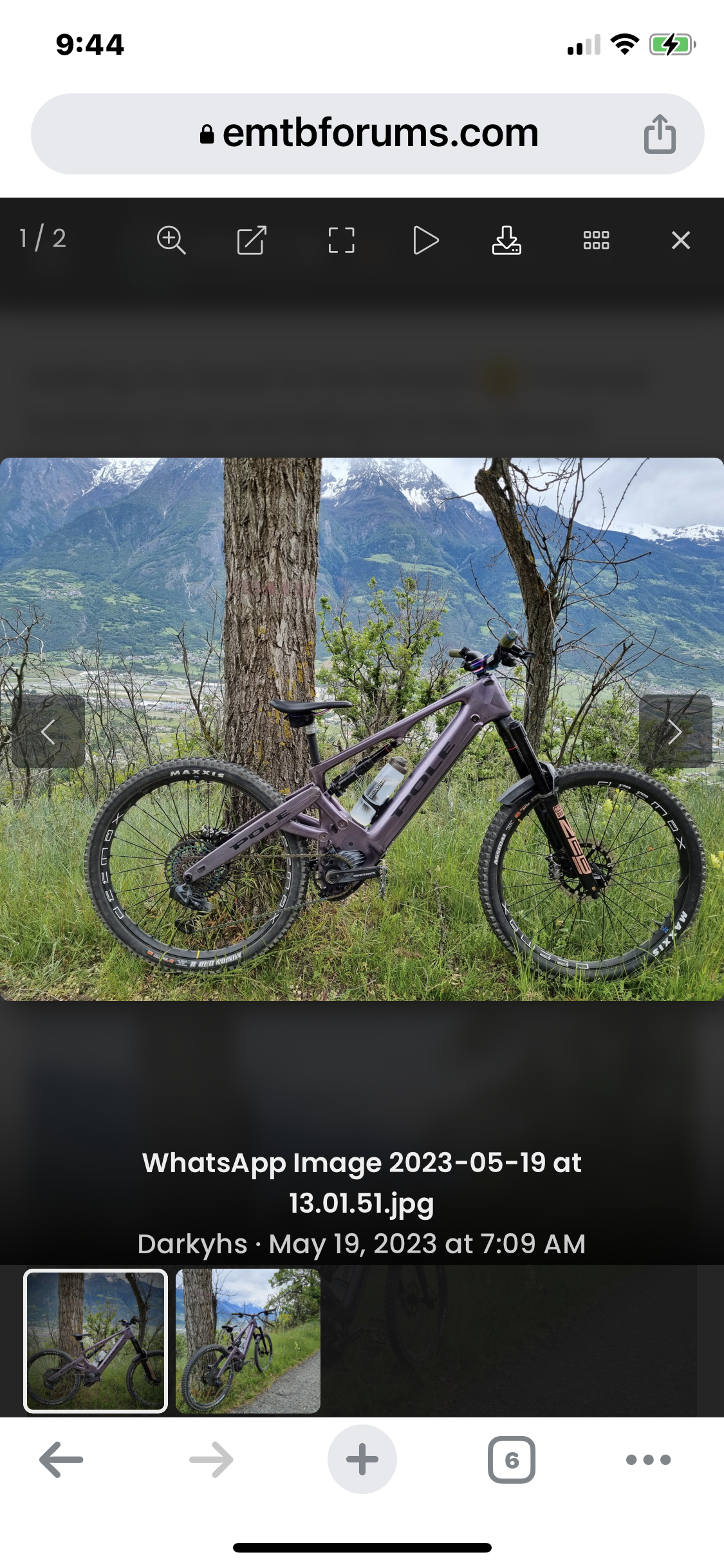

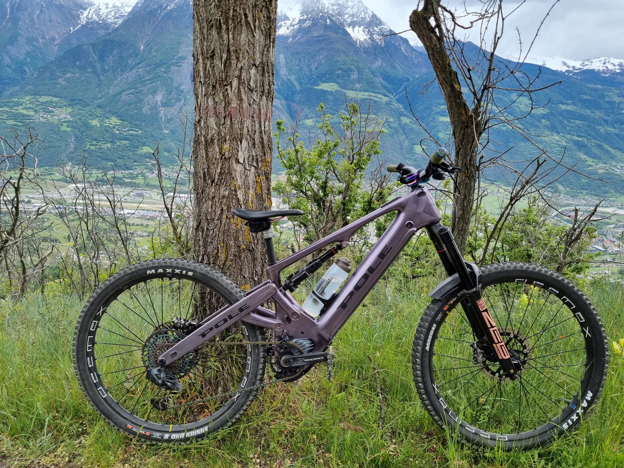

Adding my beast to the thread :) Finished building it up and riding it in the always beautiful Valle d'Aoste <3

Not sure I understand your ask here. The size is K2 and I am 181cm.
The bike fits quite good actually. I have both front and rear 220 discs from Magura with the MT7 and at home waiting the 220 spacer from Pole. Now I use the 20mm spacer from SRAM. Will Post pics once the new 220 brake mount has been fitted. Looks quite cool as well.

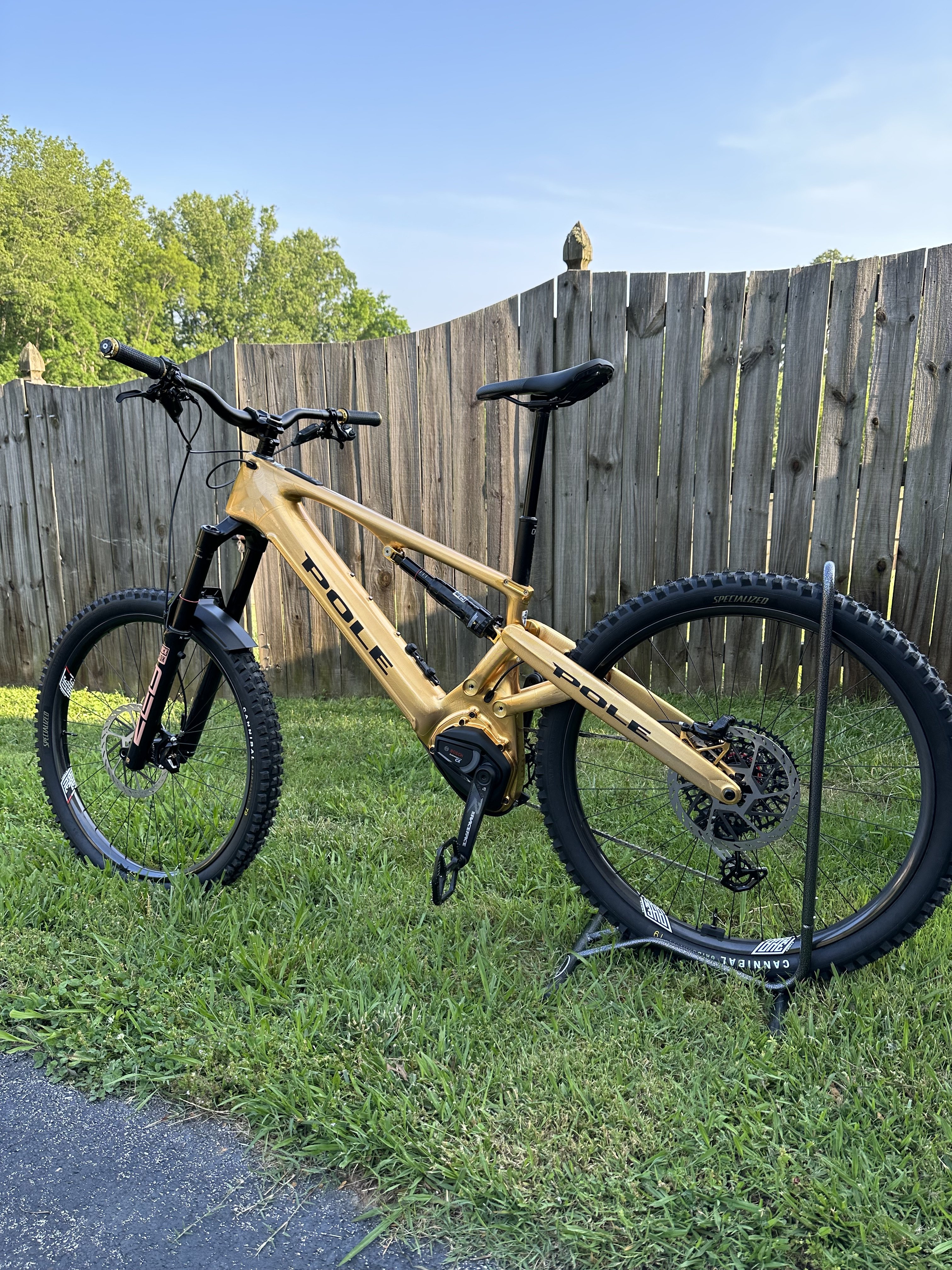

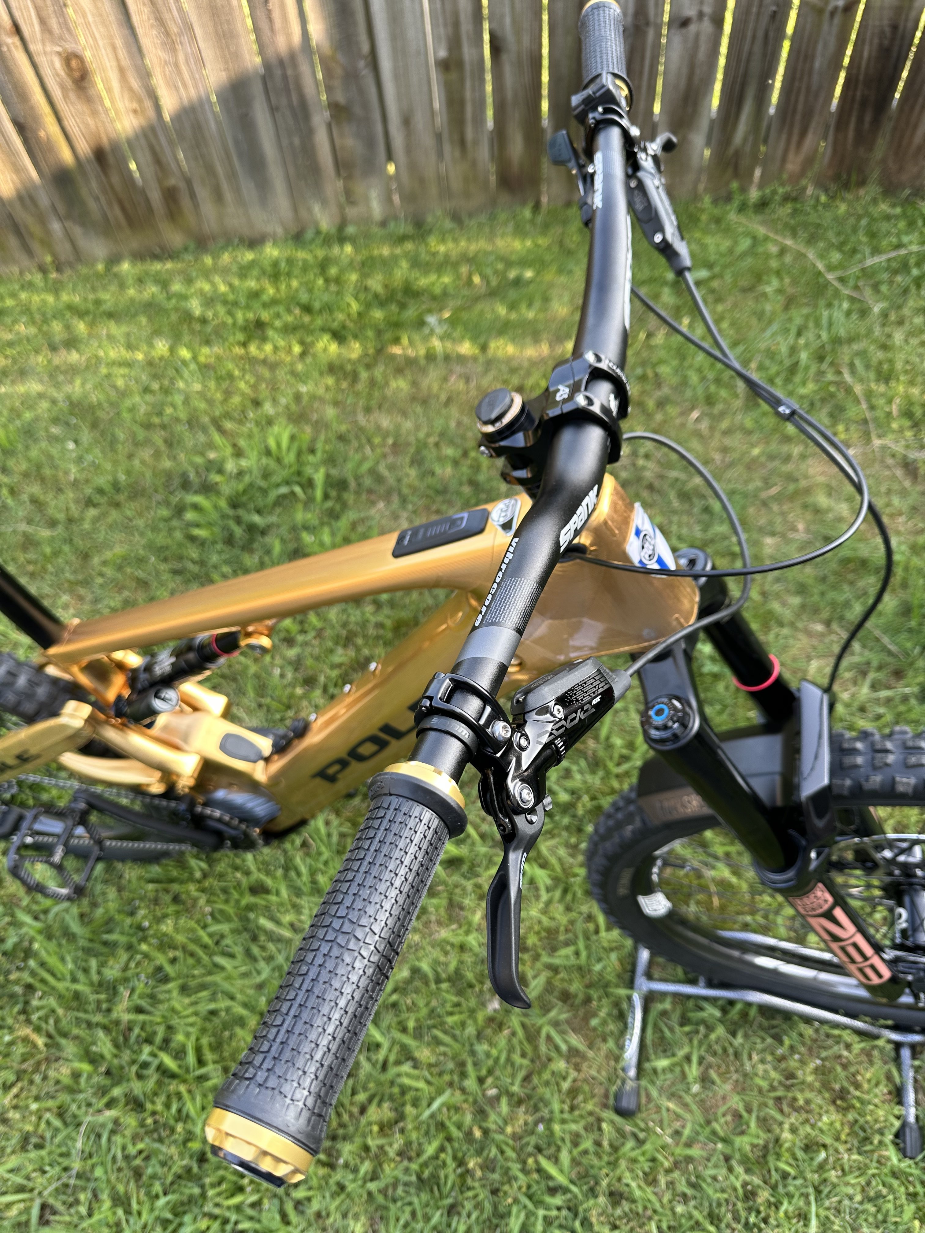

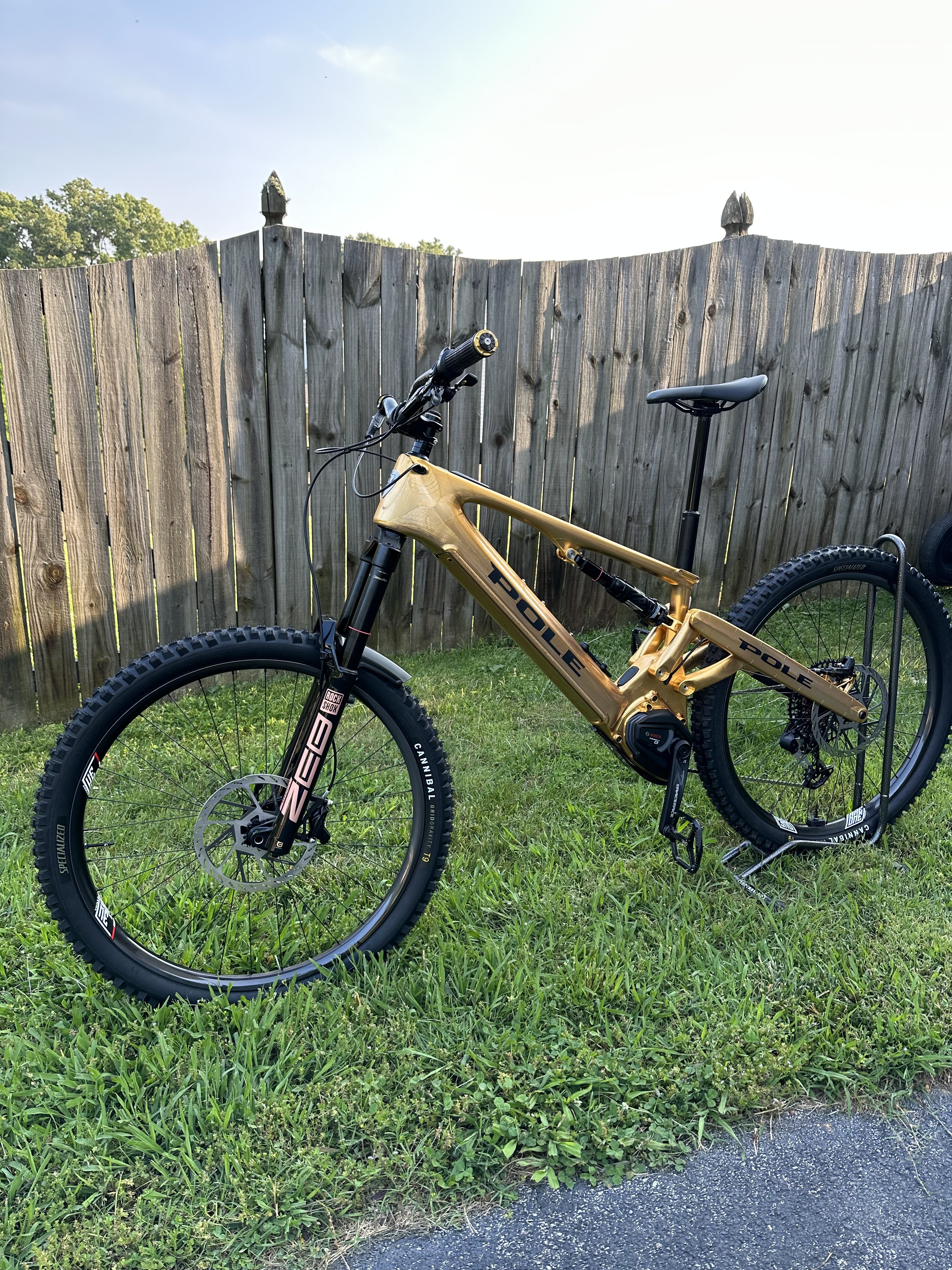

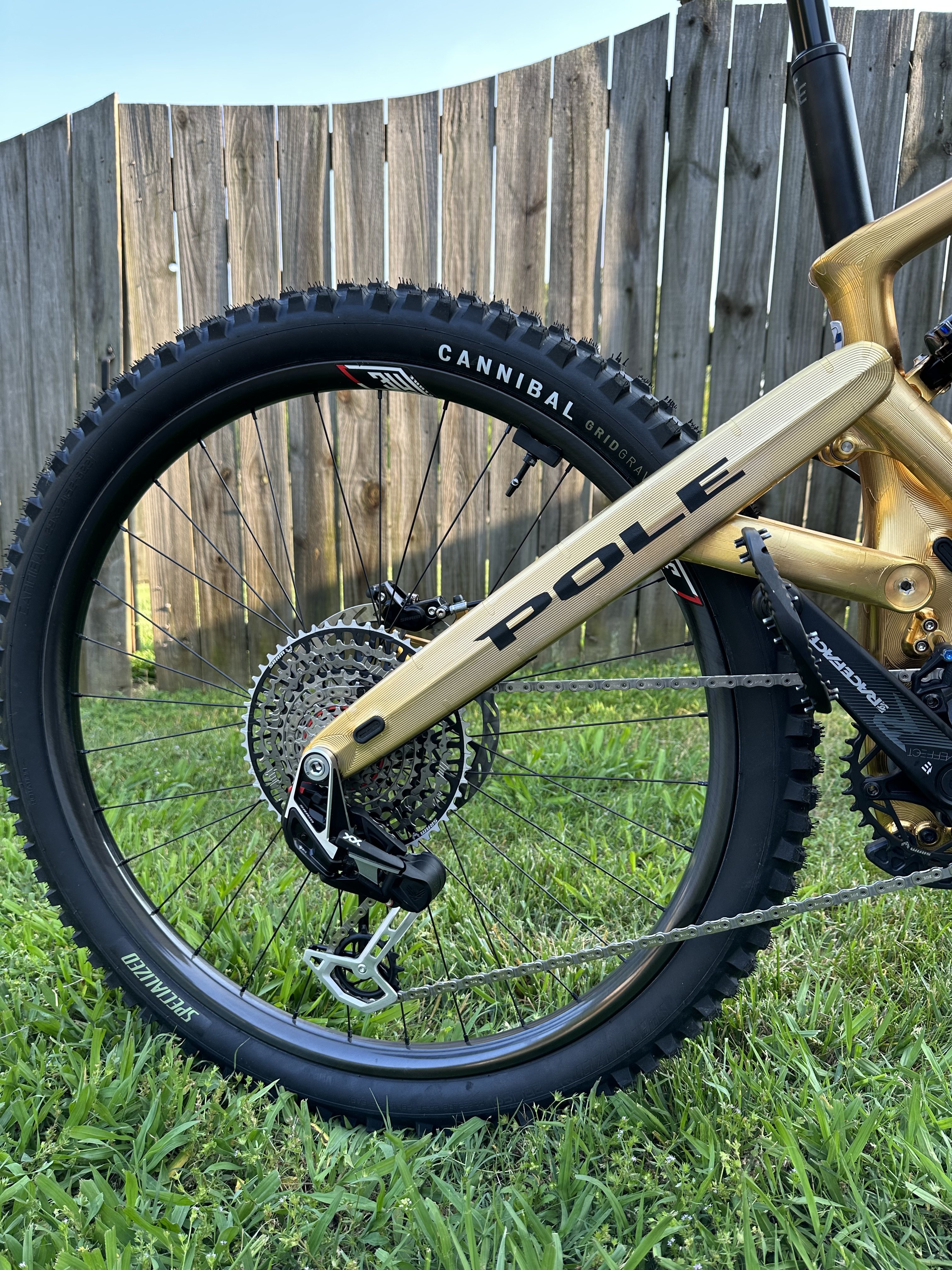

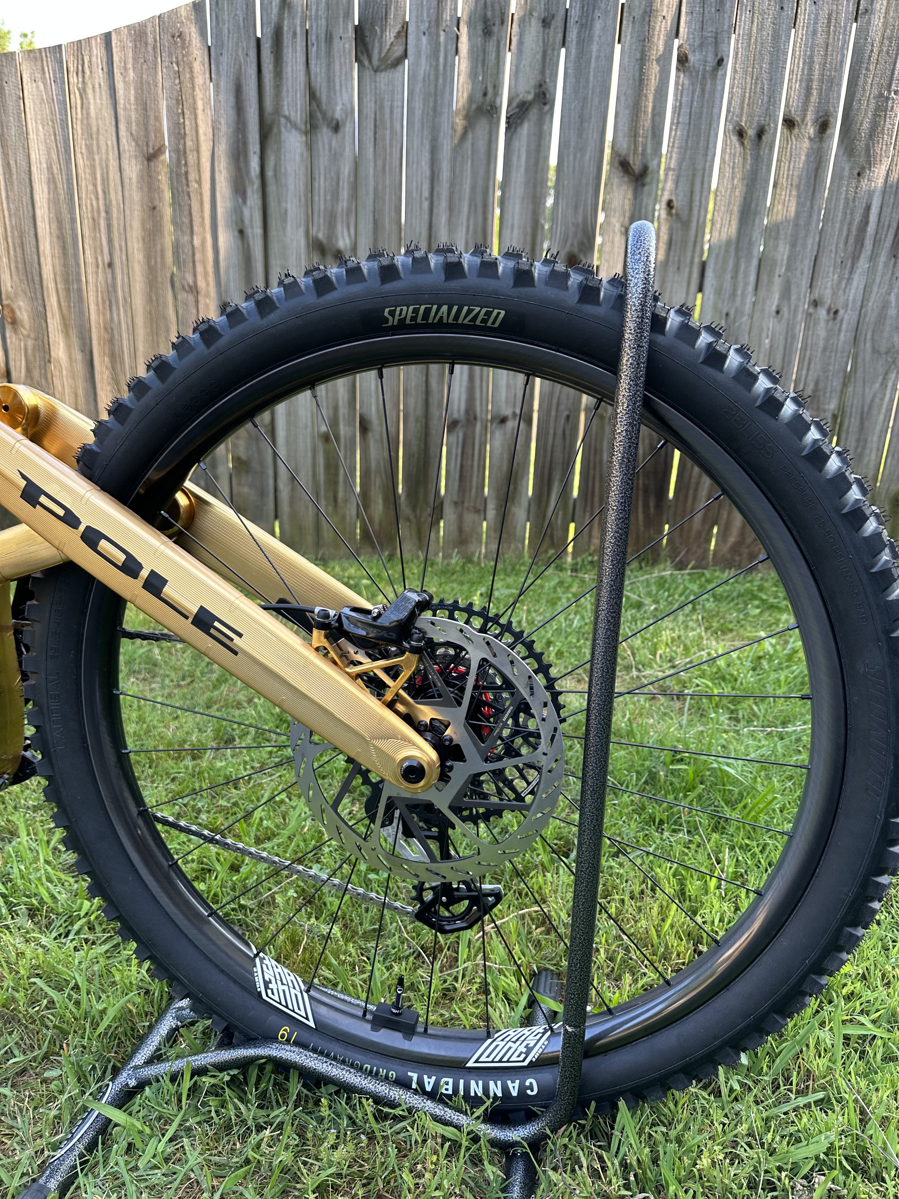

Well buddy of mine built mine up today. Weighs in at 56.5 lbs. Sorry no pics cause pouring the rain here. Only question I have is with the charging. The charger isn’t charging the bike and can’t seem to figure out why. Any recommendations? I plug up and nothing happens. No lights or anything.
Build is K3 Race
Spank Vibrocore Bar 40mm Rise
Rev Grips
I9 Stem (50mm)
SRAM XX Tramsmission
We Are One Strifes with Hydra Hubs
Ordered the 220m adapter for rear so 220/220 now
Specialized Cannibal Tires
One Up Dropper (210mm shimmed down to 190mm)
Overall pretty pleased with how it came out. Can’t wait to ride and figure out the charging problem.
Maybe try charging the battery out of the bike, plug the charger directly into the battery.

I took the battery out and it is charging. Something must be wrong with the charging port on the bike. Thanks.
Sounds like your buddy who built the bike might have messed up the battery connection when he was routing the cables. The cables pass right by that connection and if you cram them through without watching what you’re doing it can damage the wires to the connection.

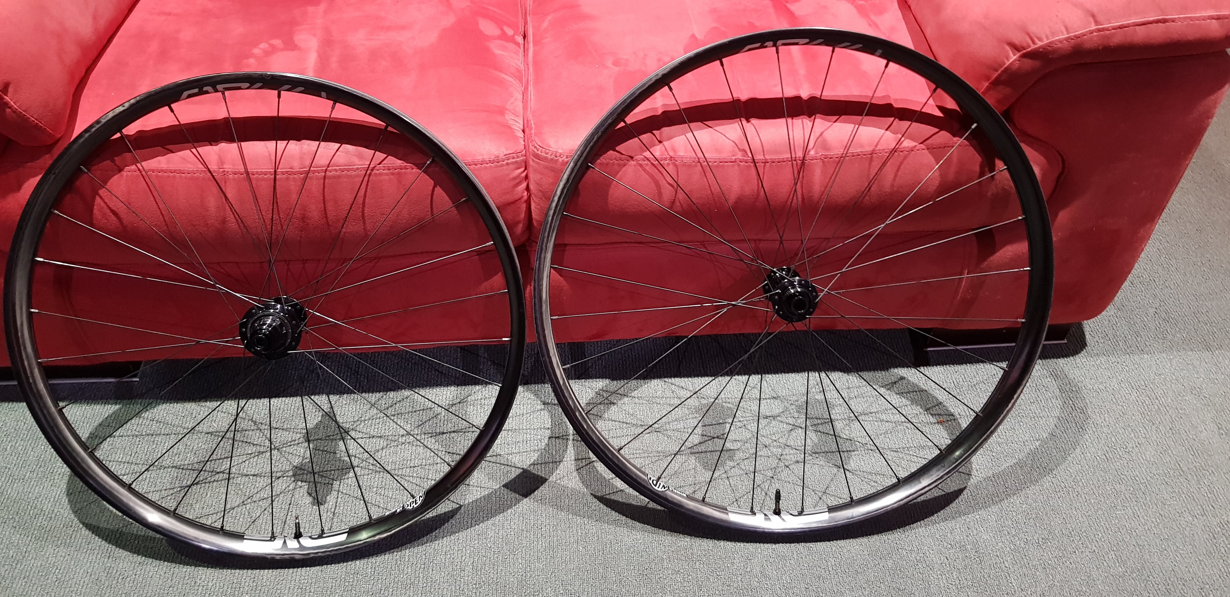

Nice, I think I'm going to build a wheelset using Berd Spokes new hubs and WeAreOne's new Convergence rims.
WR1 convergence are by all accounts great wheels but I would check in with them re. ebike use before ordering. Especially if you’re a big human. The vertical compliance they’ve designed into the rim profile may not be ideal for e-bikes or big humans.
I’ve called them about this and they are good to go on both counts 🤙 running the triad on my Voima and they are incredible

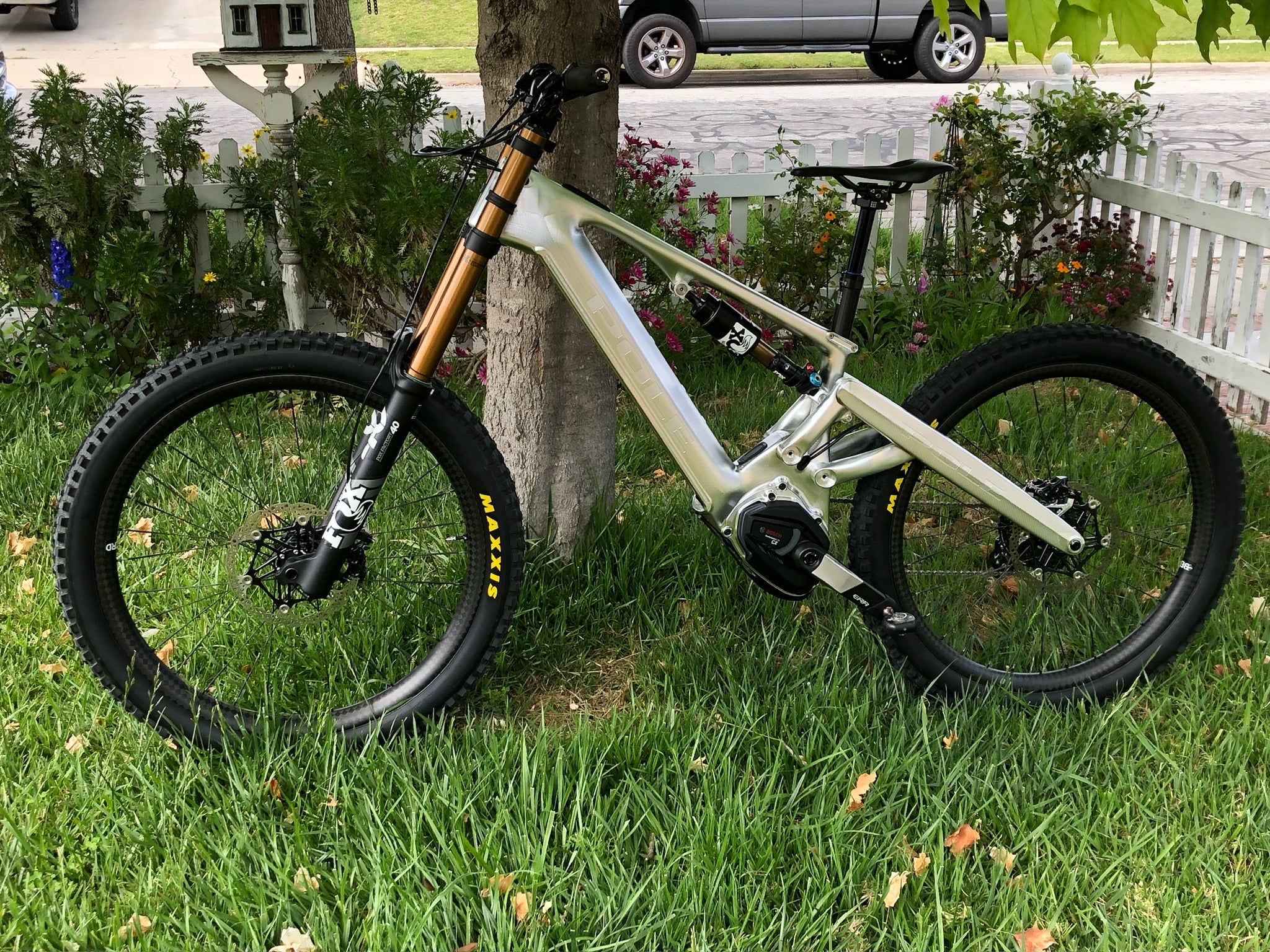

First ride yesterday on my custom K3. I think I’m in love.
Was super nervous about the looooong front center (which thankfully measures ~880mm vs. 888 in the geo chart) but she absolutely goes. Planned to do a cruise lap through my local skipping all the bigger stuff just to get a feel for the bike (my first full power eeb), but it felt so dang natural once up to speed I just hit everything first go.
Even with suspension settings way off it was an absolute blast. Excited to get the squish dialed (EXT Arma on the way).
One issue I have is seat post insertion - anyone tall on the K3 have any insight into how to get the seat at the correct height without exceeding the minimum insertion depth? 6’4” / 193cm running a OneUp 240 and it’s still about 50mm shy of where I’d like it.
Mine developed a sound like a broken music box when climbing after just a dozen or so rides.
Theory is that the shallow rim depth for vertical compliance led to big rim distortion and spoke de-tensioning, which is causing them to rub against each other under torque. WR1 is stumped. Handing off to local wheel guru this week.

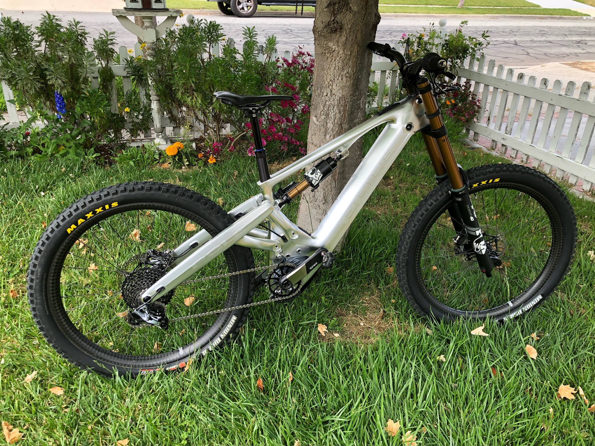

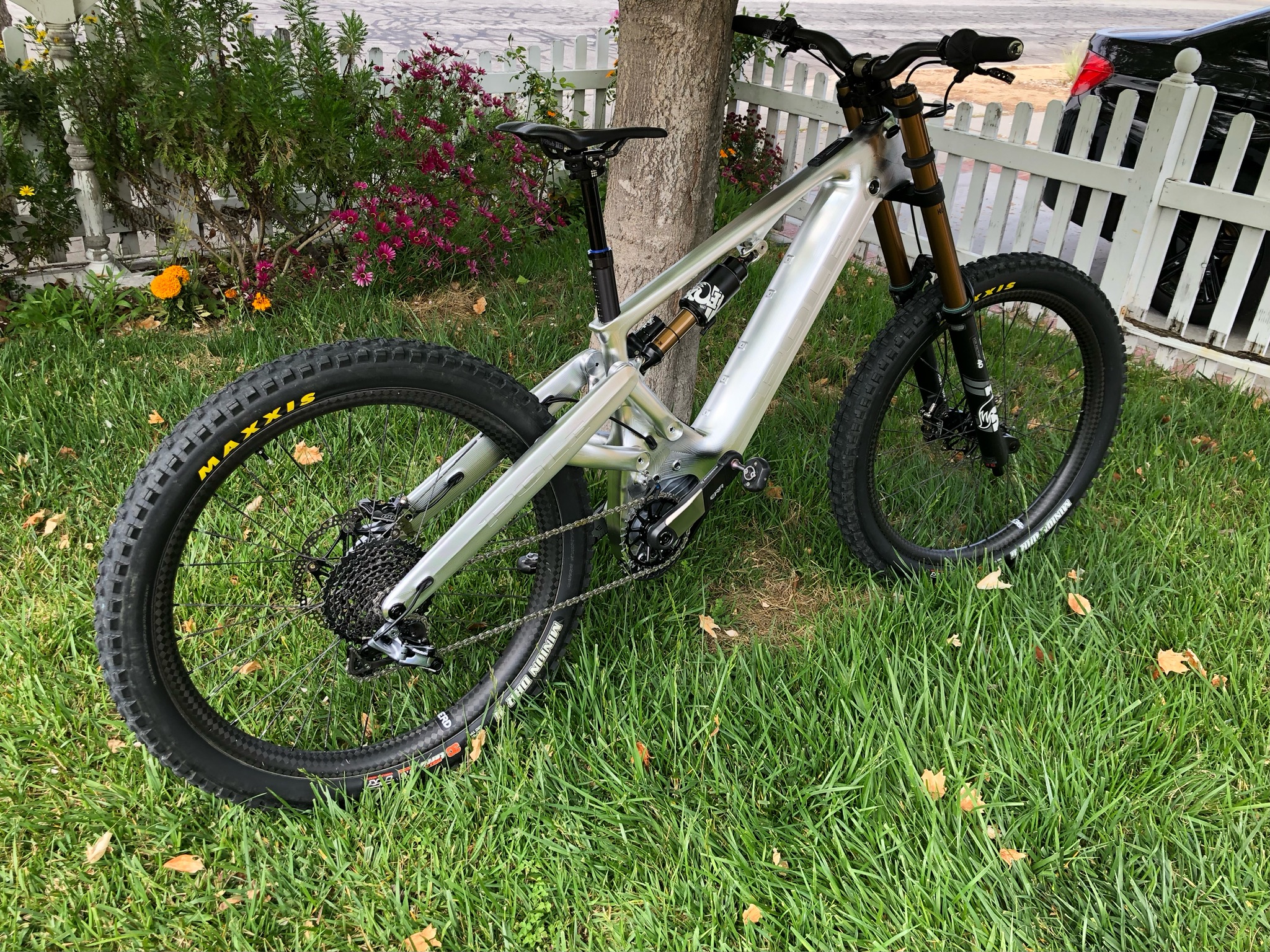

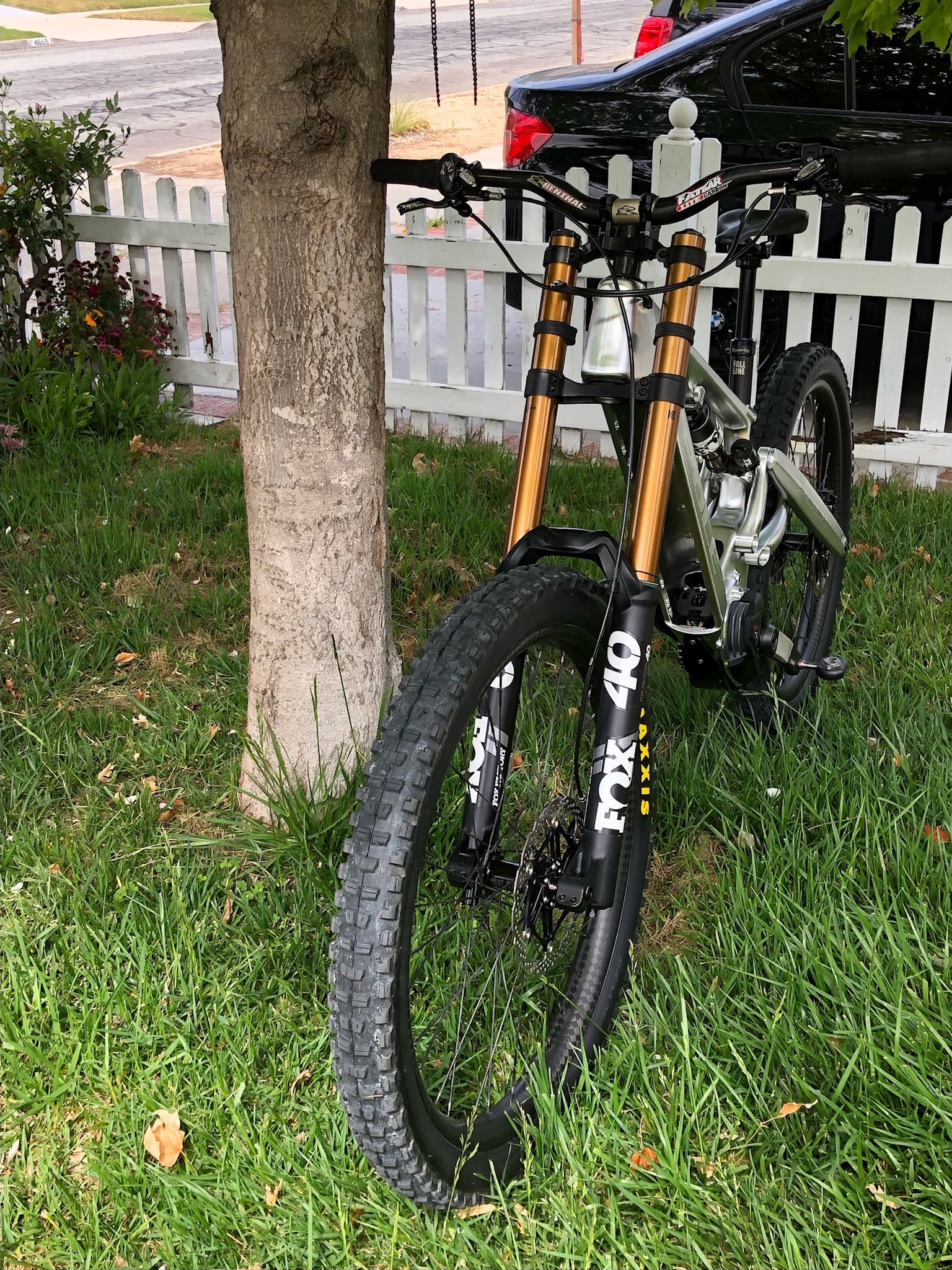

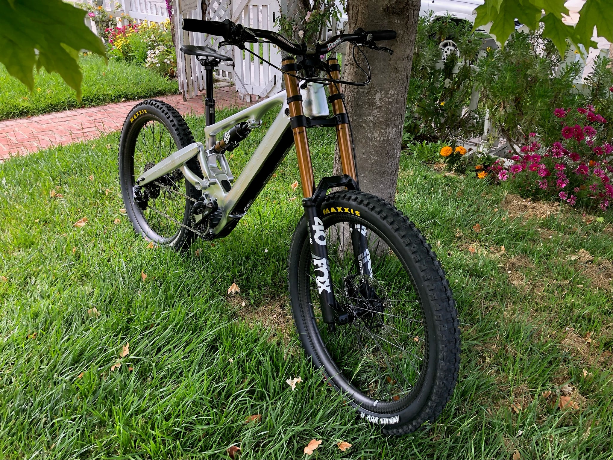

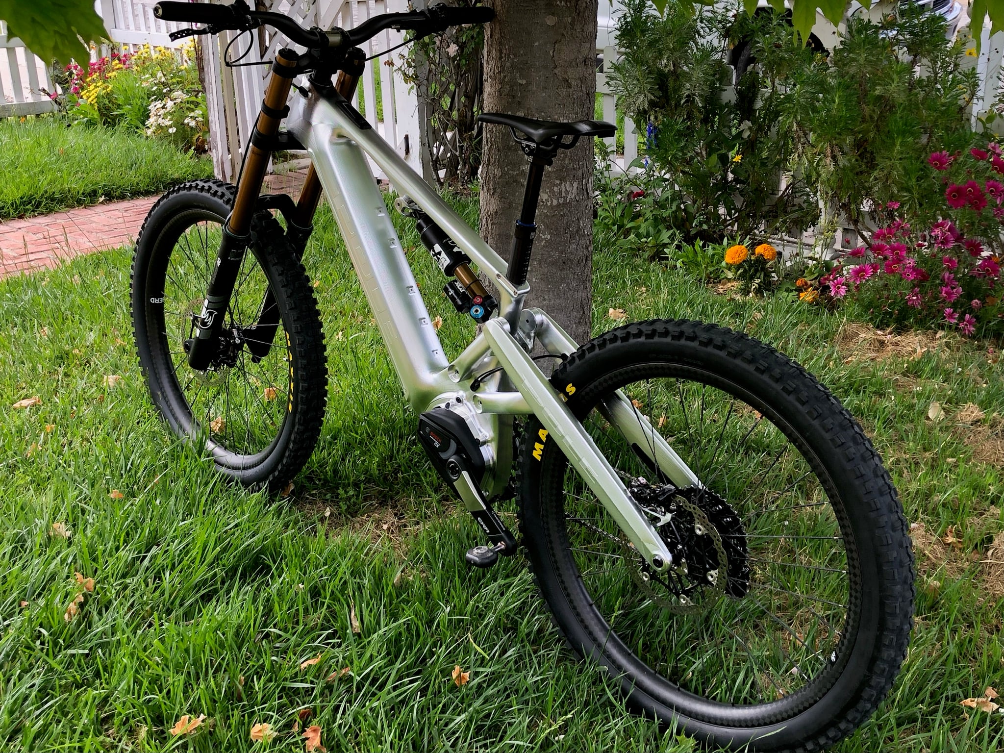

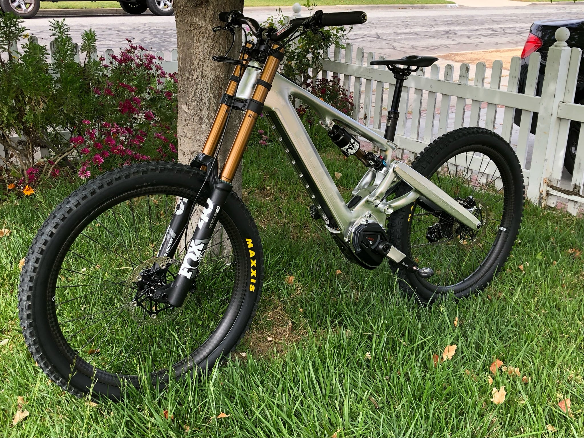

Just finished building my new K1 Race ID frameset. Just waiting for the battery to arrive and it’ll be ready to rip! It should be right around 50lbs with the battery, maybe just under.
View attachment 115389 View attachment 115390 View attachment 115391 View attachment 115392 View attachment 115393 View attachment 115394 View attachment 115395
Looks outstanding with the 40's. What do you estimate the maximum turning angle is, where say 0deg is straight ahead and 90deg is wheel perpendicular to frame?
Also with the decals, I've got the standard black decals on my v1 still but some of the sharp edges (particularly the points on the back of the P's) is starting to lift. I do like the look without the decals altogether and I'm considering removing them, but would you mind taking a photo of the machined surface beneath the sticker? I assume it's not the same as the rest of the frame? Just want to know what I'm in for before I peel!
