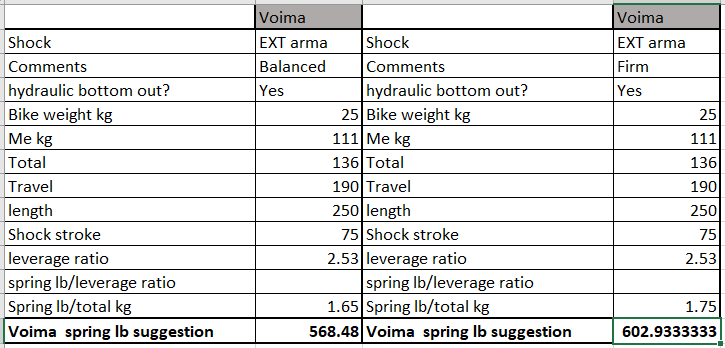

I created a ext spring calculator based on weight and leverage ratio. Here's what it spat out for you.
So 575 to 600lb looks to be bang on the money.

Here's yours on my calculator.
That makes sense to me. 25% sag is running very firm for a 190mm frame. IMO you might as well run an airshock if you want it that firm.

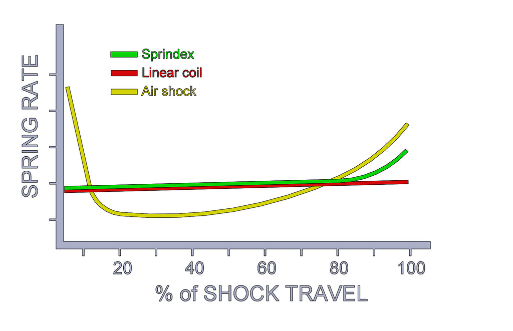

Do you really need a progressive spring when you have a progressive frame and hydraulic bottom out control? I'd suggest probably not as you might end up with too much progression.
As far as my calculator is concerned. Add your ideal weight + the bike weight together for total weight and times that by 1.65. That will give you the spring range at your "race" weight.

Sprindex technically are progressive. Just in the last bit of travel. I've had 3 on different bikes, far prefer a straight coil, even a lower than recommended one with Lsc bumped felt better.

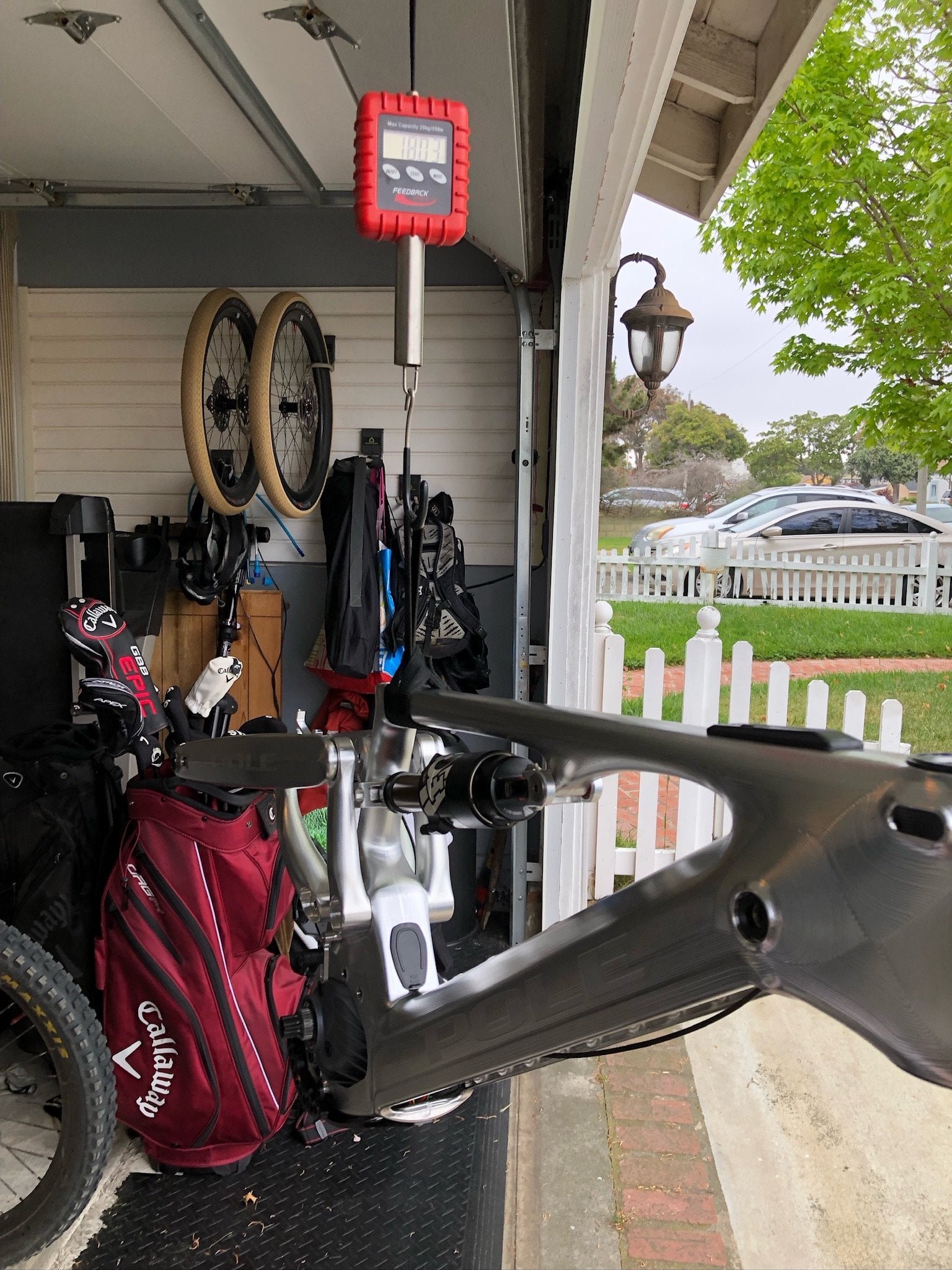

Did you happen to edit this post? There were elements that didn't quite seem right, which led me to return for a more in-depth look. According to your estimations on weight, it wouldn't be possible to construct a 23kg bike. Yet, he managed to accomplish this.
Take into account the Bosch system, which weighs approximately 7.4kg in total. In contrast, common e-bike frames - those rated category 5 - typically fall within the 3.5 to 4.5kg range. Lighter e-bike frames do exist, around 2.5kg, but these do not meet the category 5 criteria and are composed of a thin, fragile carbon layer.
For reference, consider the Pole Voima LED, which we measured at our factory. The combined weight of the frameset and motor totaled 12.34kg. This weight discrepancy when compared to the Levo seems considerable, and I plan to revisit this matter for further examination.
It would be more feasible to weight the frames without the batteries and give the battery WH and weight separately.
My K1 weight without battery, but with a heavier Fox X2. 18.03 lbs/8.17kg.

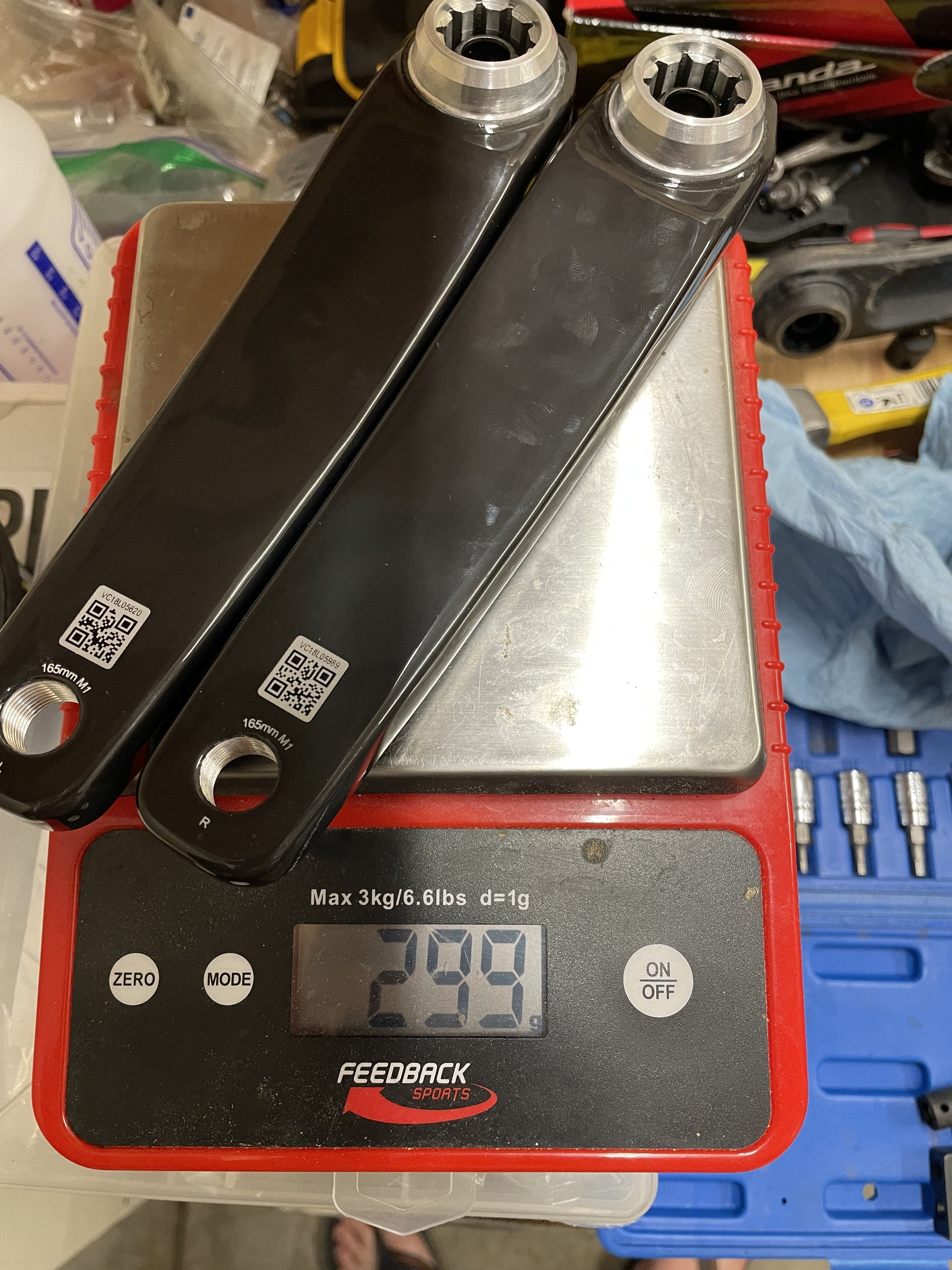

A little less with my cranks. They’re 372g. View attachment 116219

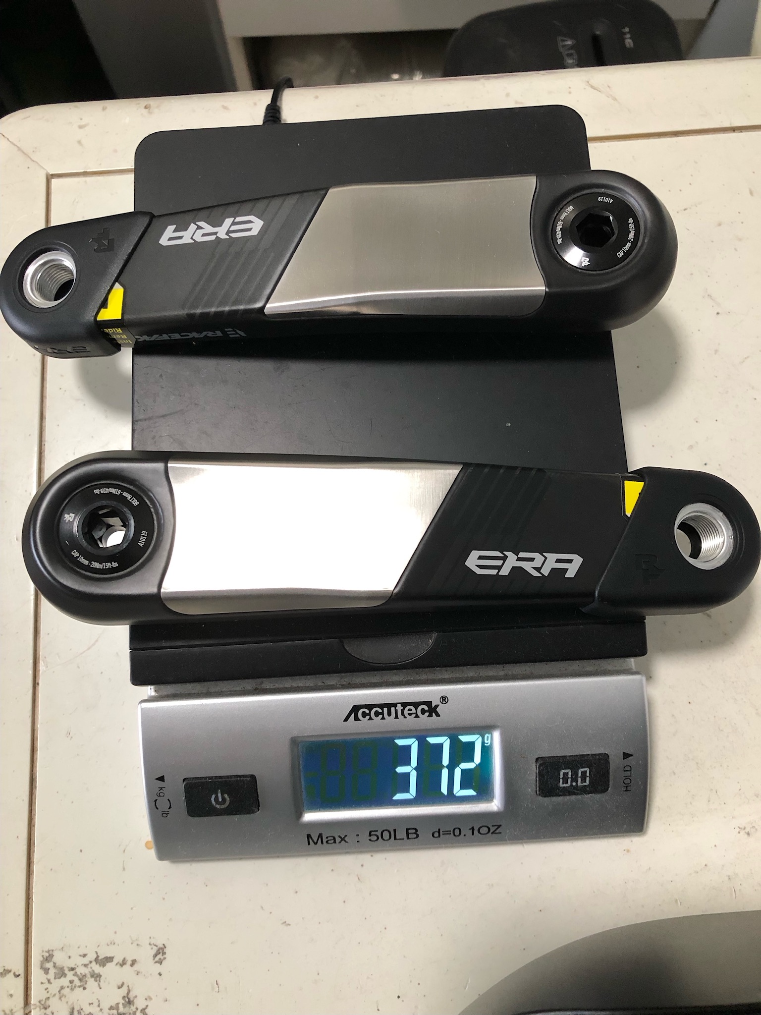

Not that weight is all that important, but Miranda carbon cranks are on sale and are very light. Been moving these from bike to bike and they'll go on the Voima.
Where are they on sale? Do you have s link?
That is a good deal. What do I need in the way of spider/chainring for the voima? i'm not up to speed on whats required on E bikes. The bike is coming with RF affect. I'm pretty keen to swap out to one of these bastards.
You can get a separate spider and chainring or a one piece chainring. The one piece direct mount chainring is a little lighter, but the 2 pc gives you more options. I have both, but I’ve been using the 1 pc direct mount chainring.

Having wrecked 2 sets alloy cranks on drops (and bent half a dozen), the idea of carbon cranks on a 190 rig with a motor is… interesting.
Carbon cranks have been around for a long time on all bikes including World Cup DH bikes. They’re fine on the Voima. I had e13 carbon cranks on my first Voima and they handled everything from black diamond trails and bike park sessions without issues. I’ve personally have had several sets on different bikes over the years, from XO carbon, race face next SL, race face six-c, e13 and now race face era’s on the new Voima and I’ve never had any issues with any of them. 😎👍🏼
