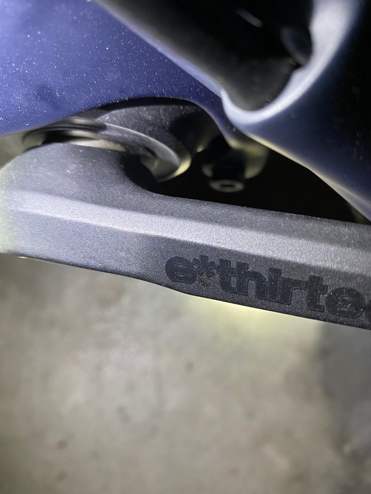

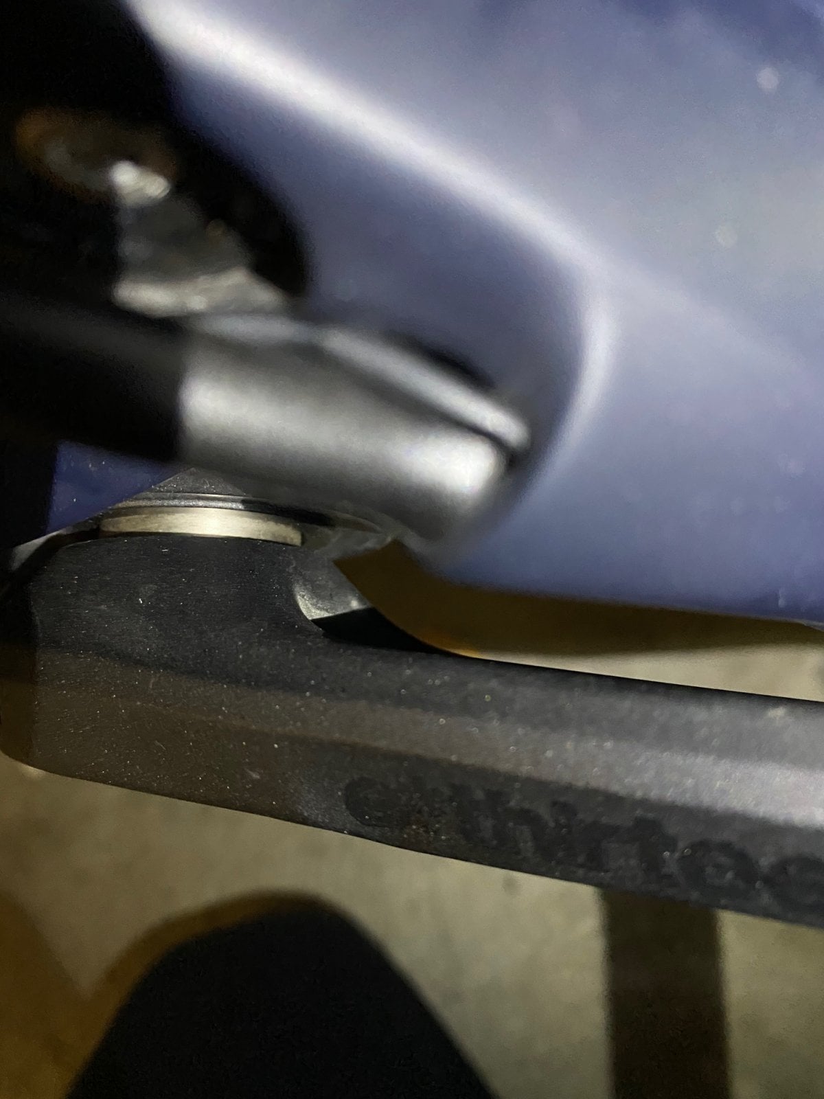

Can you please share some pics of yours to see how deep must be inserted into the thread? I have checked mine and they are already at 14nm so I don't want to remove them and reinstall them if not needed. Here it is the pic of mine!
