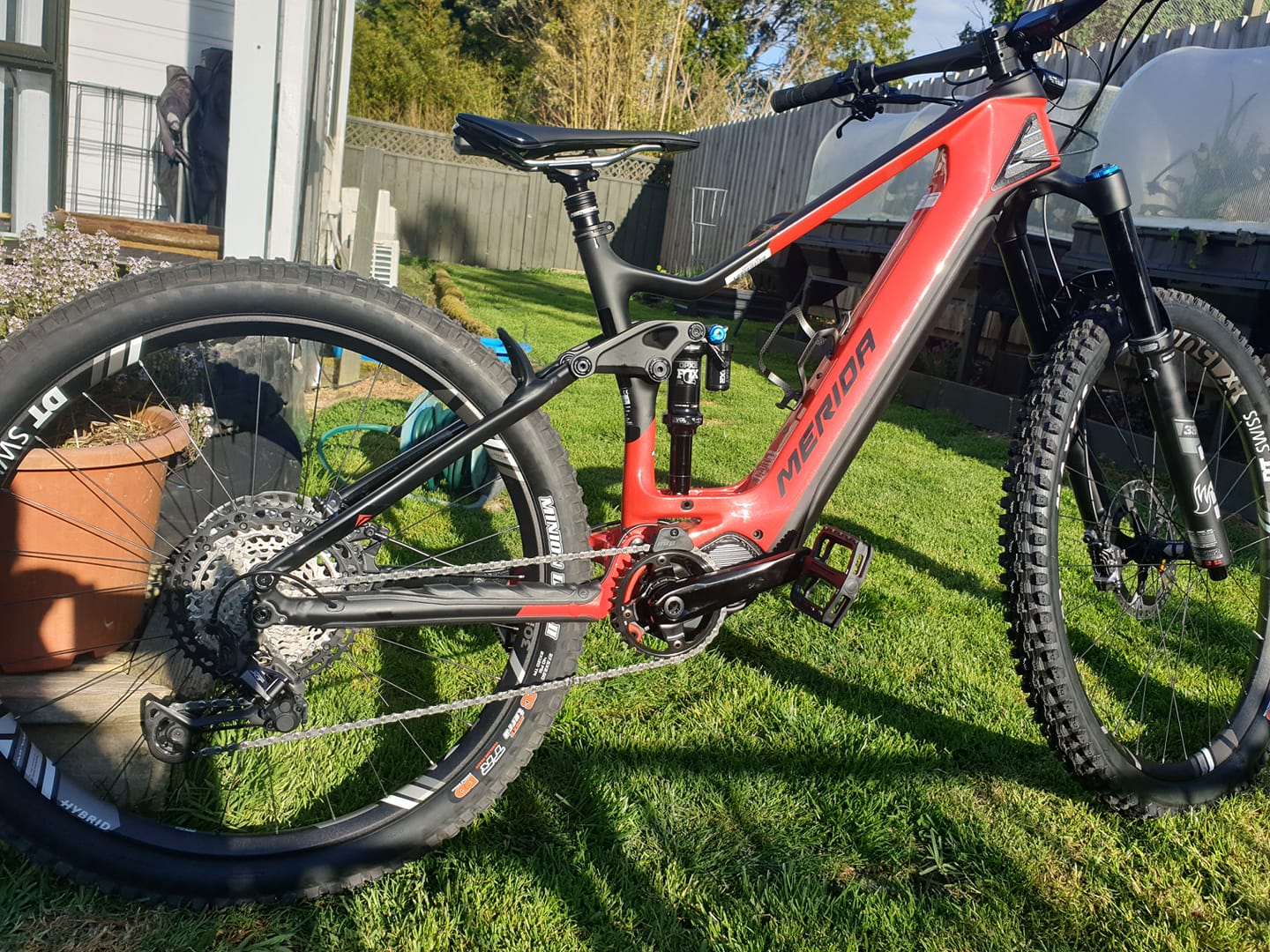

Hi all, new member here from NZ.
This is my EOne Sixty 5000. We got them with 8000 motors where as I believe other places got them with 7000 motors.
Have fitted a Onone carbon bar and gone tubliss. Its gunna be for sale soon as Ive got a 21 EOne sixty 8000 on order.

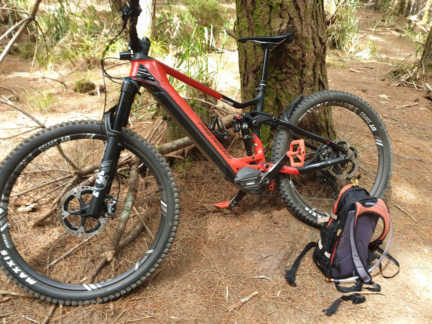

Another 30ks today in the forest. Did some suspension bracketing to get it right.
Fork comes with 4 tokens so I tried it with 2. Felt really smooth but got a huge bottom out on a jump with a rooty landing. Will try 3 next.
Tried profile 2. Perfect for a harder workout.
