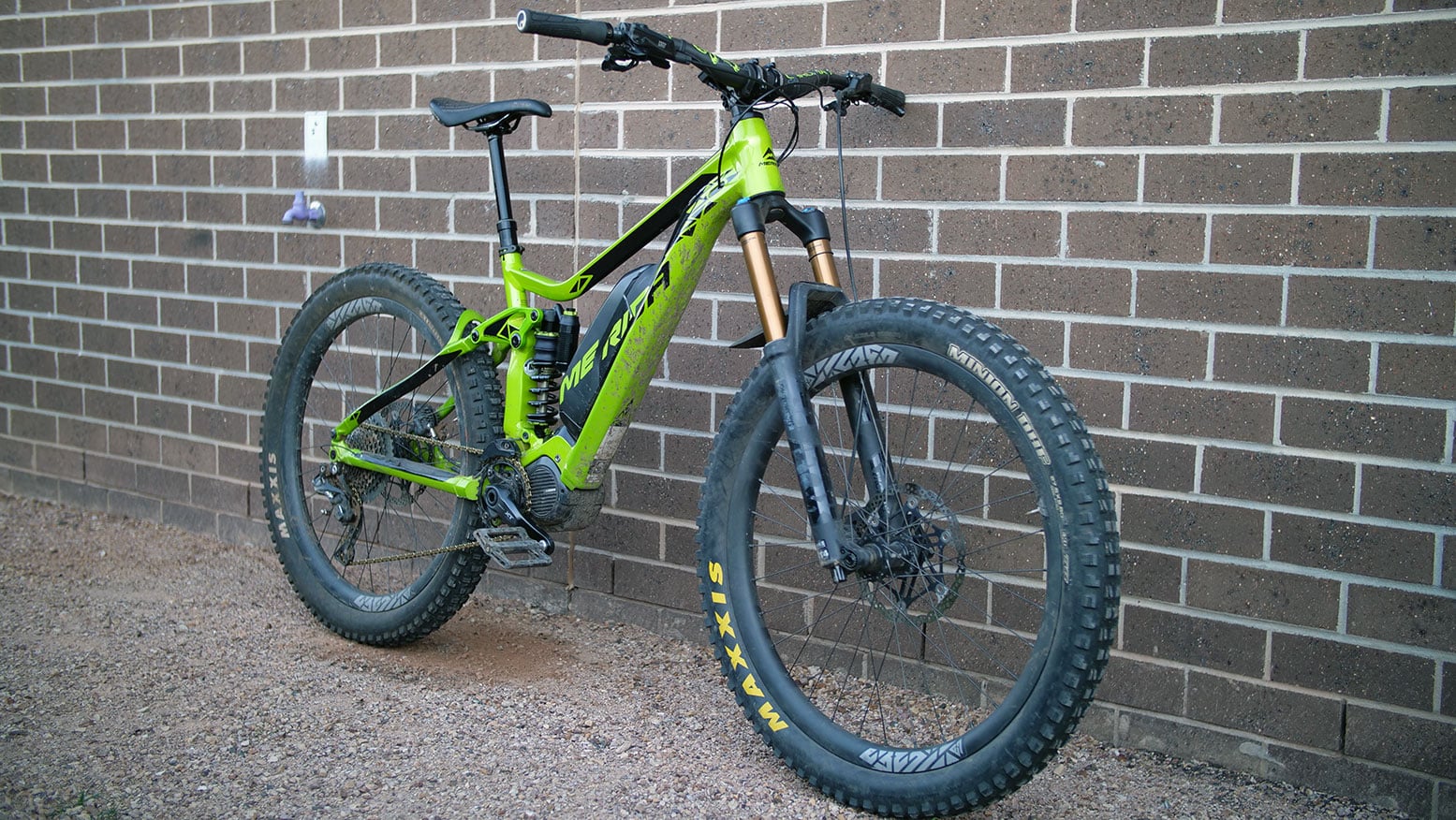

Picked up my brand spanking green e160 900e on Saturday. I took the stock Maxxis DHR IIs off and fitted Specialized Eliminator 2.6s in the Blck Dmnd casing tubeless, swapped the shifter paddles around to the normal positions, downloaded the fox manuals and setup the suspension, fitted my pedals and was good to go. I had my heart set on a Specialized Kenevo, but after a demo day ride on the Merida, and looking at value for money, I could not go past the 900e. Cost me $7000 AU with the absolute top of the line components everywhere. The Kenevo Comp is $7200 AU, and the Expert costs $9500 AU. Went for my first ride on sunday through Glenrock which was wet as f*#k, got myself and the bike completely covered in mud, but did 30km and ran out of energy before running out of battery. I have never had so much fun on a mountain bike. Consider me an ebike convert/fan

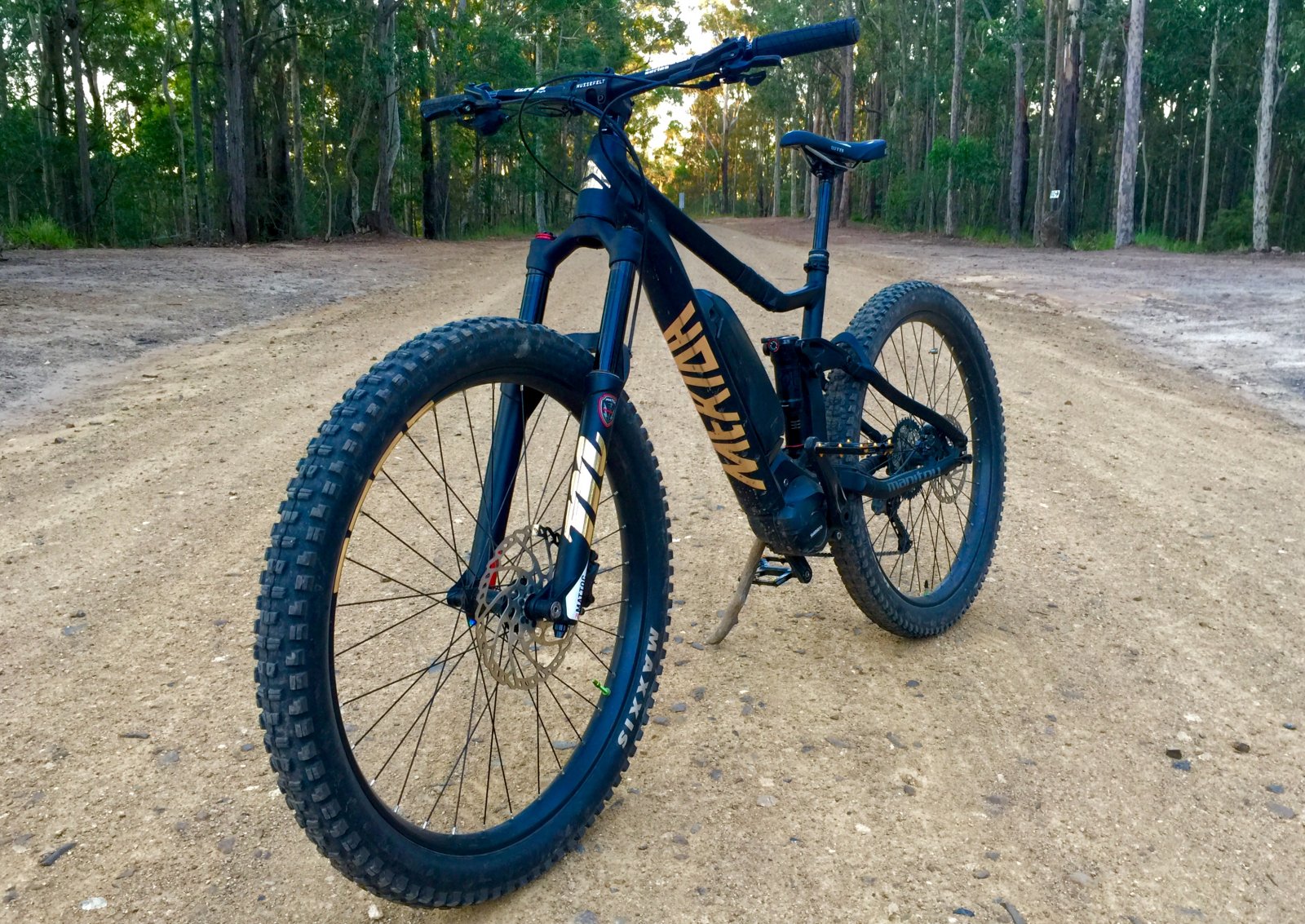

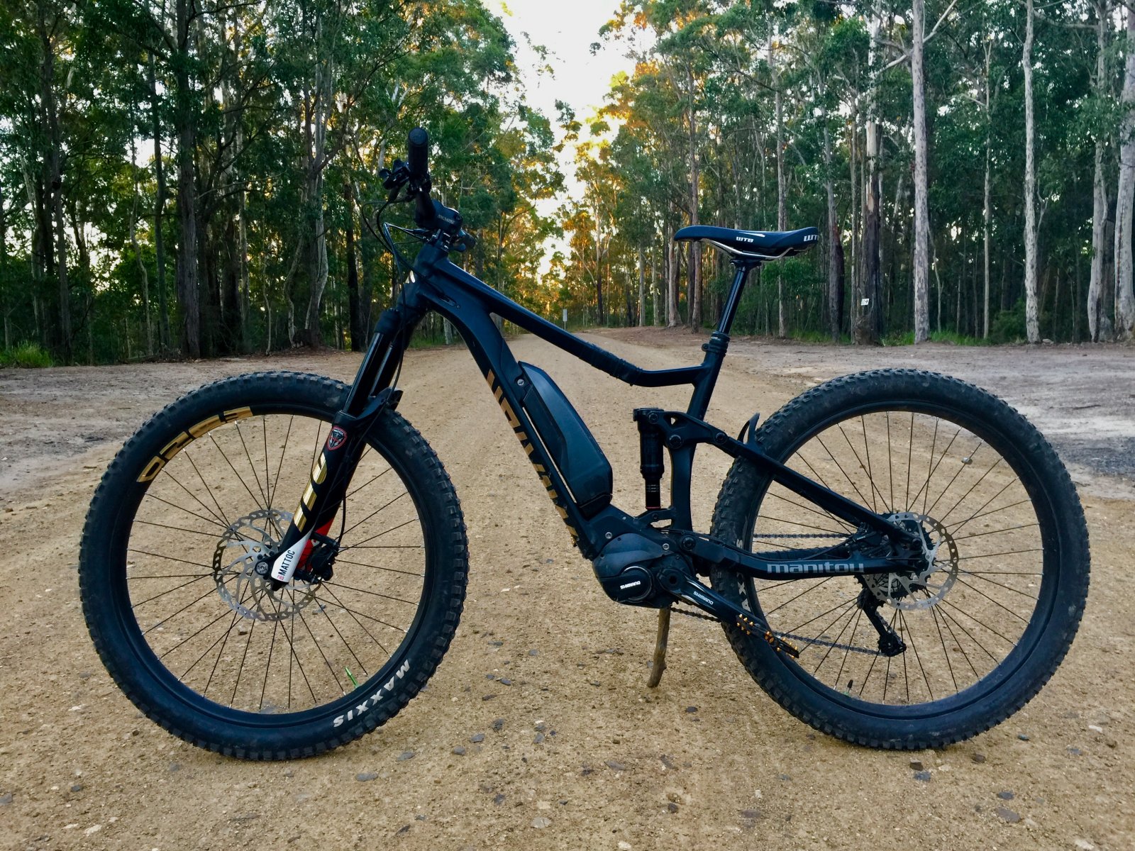

My hybrid e120/160 in it's current form. Waiting for the new Onyx hubs to be released - will be ordering a set in gold :love:

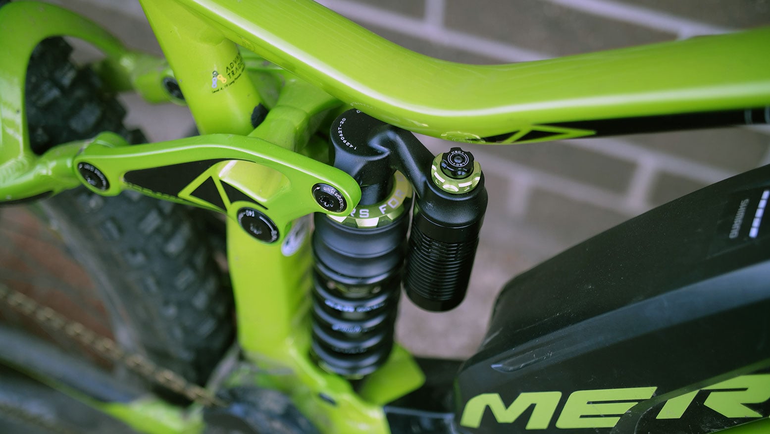

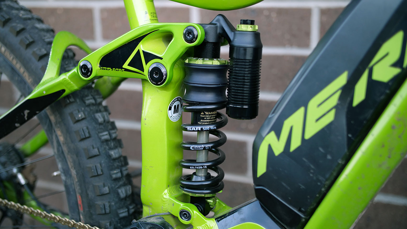

Ohlins TTX2 will fit, i have one on my E160 and there is about 3mm clearance. I took the spring off to check.
Hello drjarvis2003,
Thank you.for.your.feedback. you have it installed in a eOne Sixty and it fits perfectly with the stock spring?
How does it rides? Do you suggest the TTX2 over the CS db coil?
Many thanks

Yes fit is all good and i was advised by Tf tuned where i bought it from. that the TTX2 was a better option than the the Cane creek. They also took the climb platform of and replaced it with a DH mode too.
