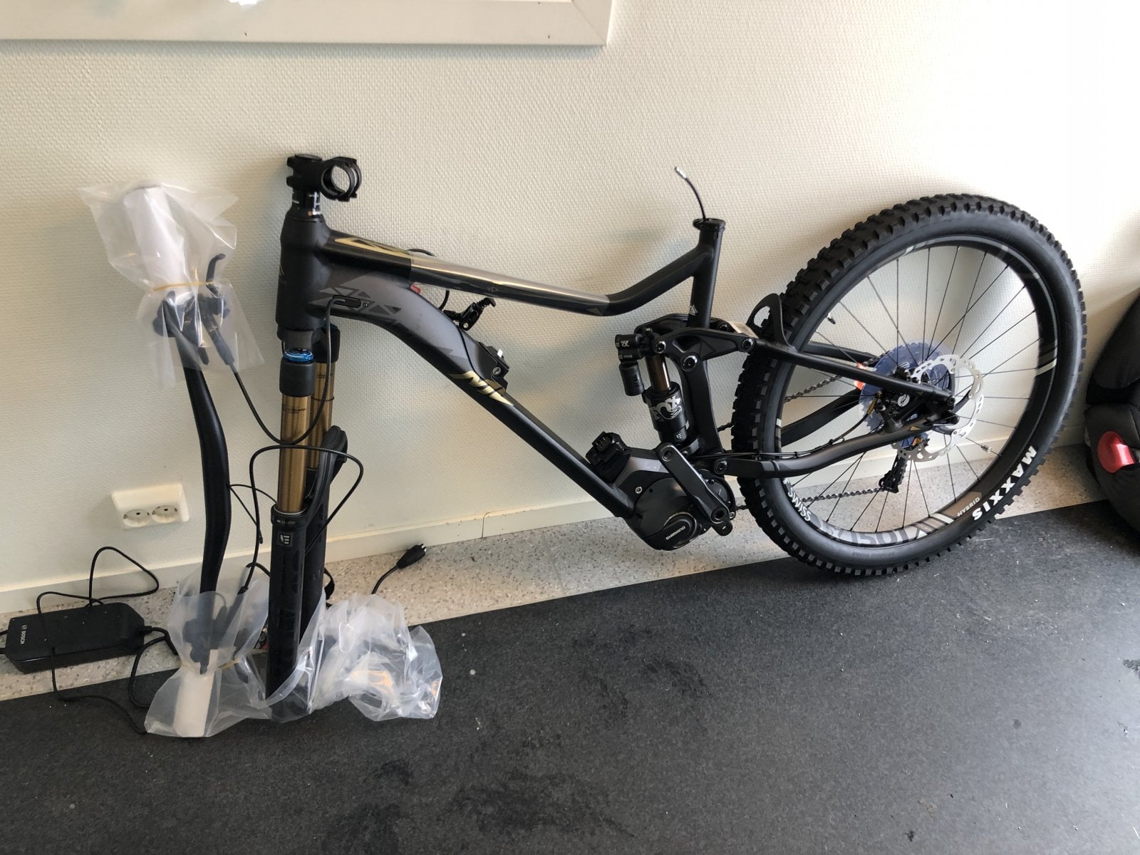

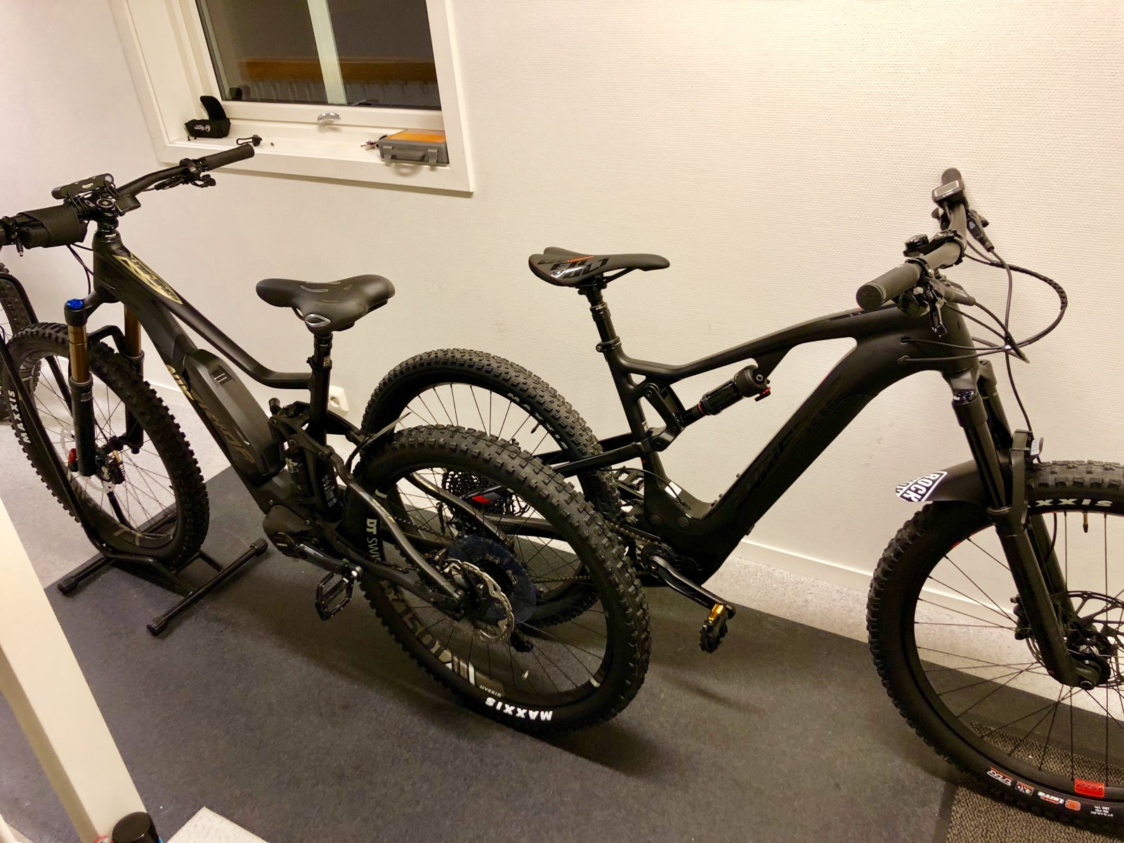

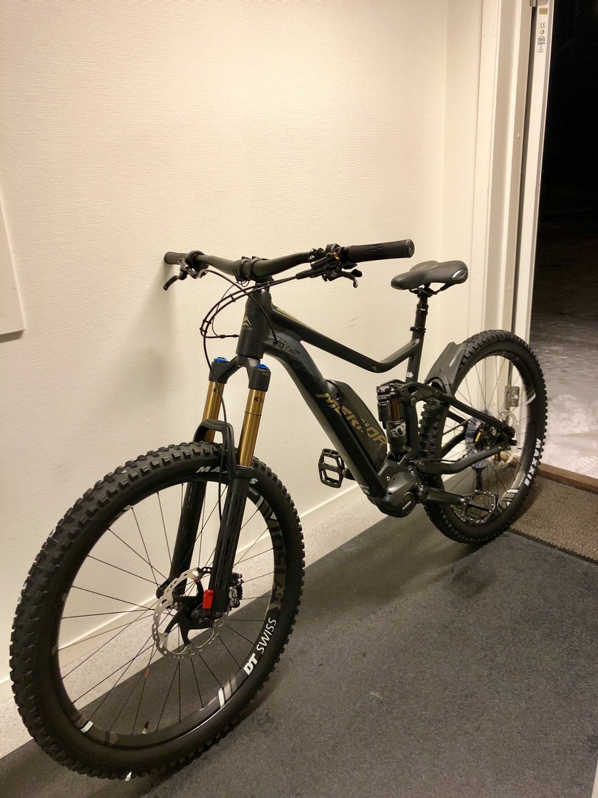

Hey. i have the 2019 eOne sixty 900 black on the way in the mail. and so far i have ordered some parts i like to put on it.
-the gold 800 mm raceface atlas handle
-50mm stem from raceface atlas
-Rockguardz carbon frame protector
-shimano e 7000 L shifter
-2 x reizel mud fenders
-raceface crank boot
But he last thing i wanted to put on for now was shorter crank arm´s and i found two types,
One from shimano that is 165mm and Miranda that have every size´s.
i think that maybe the 170mm that´s stock on the merida is maybe a bit too long for climbing an so.
but i have not tried the 900e ,only the m#rida 2019 (think its the same hight).
To compare i have a 2019 lapierre 900 carbon bosch and on that bike i dont get allot off pedalstrikes, but i think that the shimano and this 900e frame is a bit lower than my lapierre.
but off course i can wait and test when the bike arrive, But hey. i like to order and test stuff. lol
so i see that many others use 165mm but 5 mm is that any difference ?
what about 160 mm ?

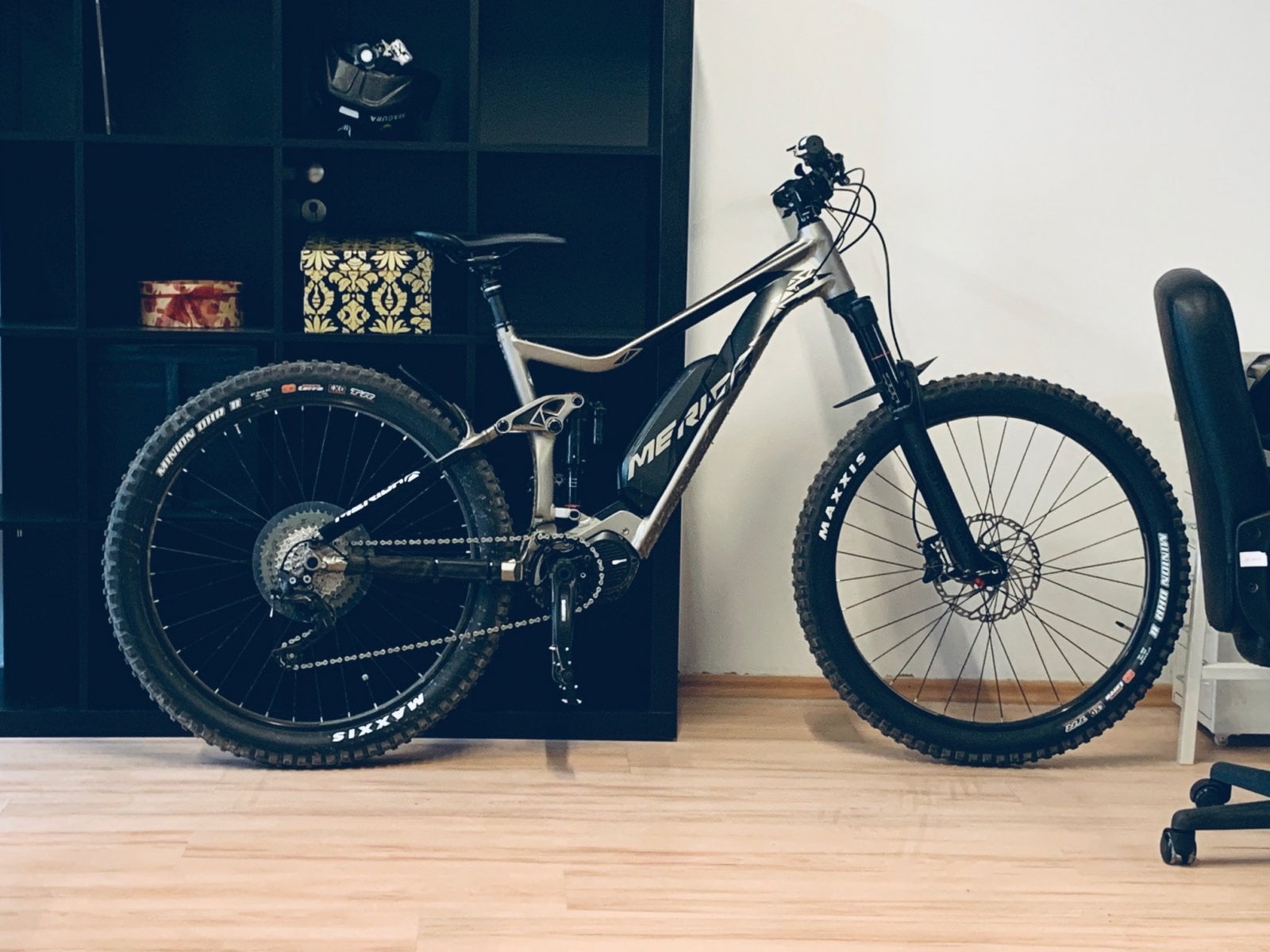

Hey there,
This is my badboy, I couldn't be happier with this bike after my Haibike.
I did some changes, bur I totally agree, the bike in stock is a super bike as it is.
Mine came with 760 mm handlebars, I use 800 mm, so I changed it to 800 with the 35 mm stem (it was a set).
I'm really thinking of a shorter cranks, I have a lot of pedal contact (i don't blame the bike. Low centre of gravity point, 160 mm travel, what do you expect)
Just want to ask is that 0.5 or 1 cm clearence is worth it? (i f I change to 160 or 165)
Is it gonna be harder to pedal uphill with a shorter cranks?
Where should I look for a compatible cranks with good price?
Thanks!
Greg
