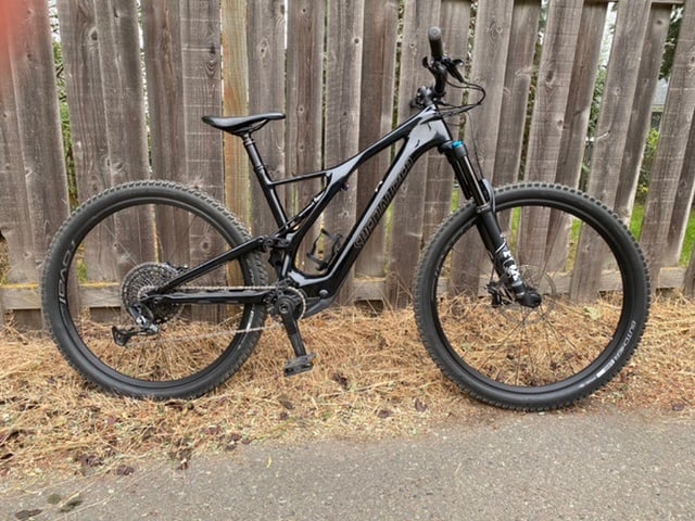

Just went for a ride on the Lyrik. Pretty darn impressive of a fork. I think I might just hold onto this and cancel the Mezzer based on the very extensive thread filled with reliability issues on mtbr about the Mezzer. Ive got some time to decide. I could use the Mezzer on my Enduro if it really is great. This modern Lyrik is leaps and bounds above the one on my other bike.
That’s what I thought after my first rise with the lyric as well. Well worth the upgrade. Enjoy your lyric and good luck with the Mezzer. ??

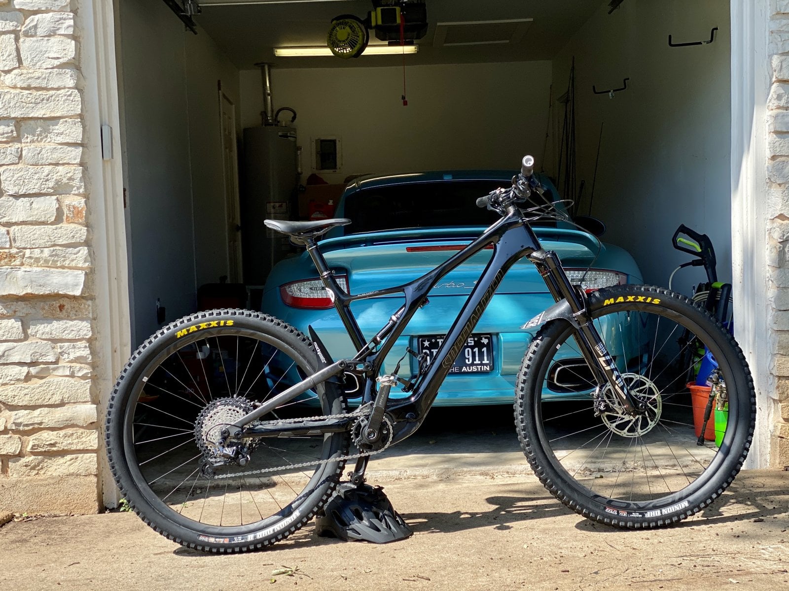

Nice! I love how the cars color puts a little blue tint to the pic of yMy daughter lived in Austin for years. We use to hike that area and I always wanted to ride it!
Couple'a'Turbos
Nice! I love how the cars color puts a little blue tint to the pic of your bike. My daughter lived in Austin for years. We use to hike that area and I always wanted to ride it!

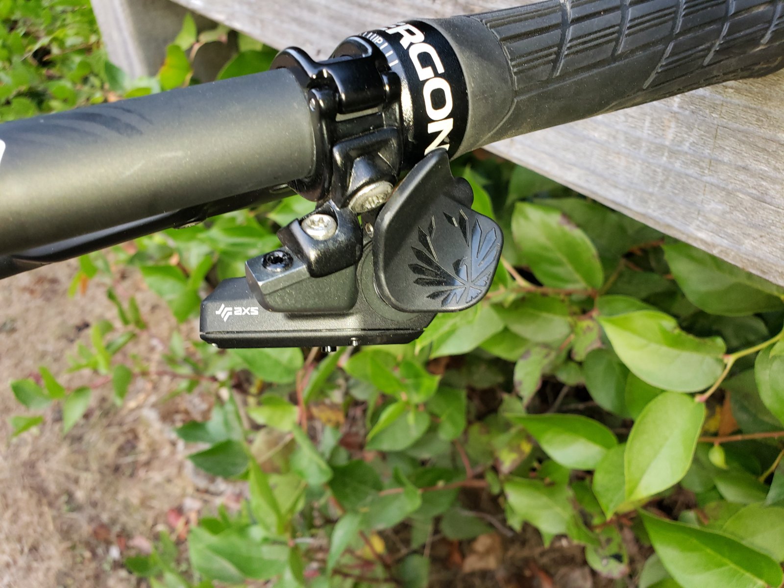

@avocadough - FWIW, I read somewhere that you can remove the remote from the bars without ill-effects. I think you can remove the TCU from the top tube with a T10 Torx and unplug/remove the remote cable.
However, I just took my first trail ride on my new Levo SL and found it to be REALLY handy. My ride started with a 10 mile singletrack climb (done mostly in Eco mode) and while not super technical, I did find myself flicking it into Trail mode to get me through some really steep switchbacks. Definitely glad that that I didn’t need to reach down to the top tube for the little boost. The remote takes up almost no real estate on the bars and doesn’t interfere with dropper operation, so I’ll be leaving mine on the bars! It’s also useful for turning the motor completely off should you want/need to. I was on a an eMTB-legal trail but still shut off the motor when passing hikers so as not to draw attention to it being an eMTB. In any case, it seems worthwhile to leave it on for a few rides and see how and if you use it. Happy trails!
I am keeping mine on. Takes little space, hardly any weight and it has the walk assist which I have used. No reason to remove.
I think that might be the sky reflecting off the bike honestly. Its been wetter than usual around here, so I have been riding the trails that can handle water. Bike has been getting covered in sandy dirt all the time, and I managed to micro scratch it pretty good washing it all the time. Today I polished all those swirls out before I took this photo. Now that I got that pic, maybe I'll polish the other side that wasnt in the pic :ROFLMAO:.
The trails around that park are phenomenal.

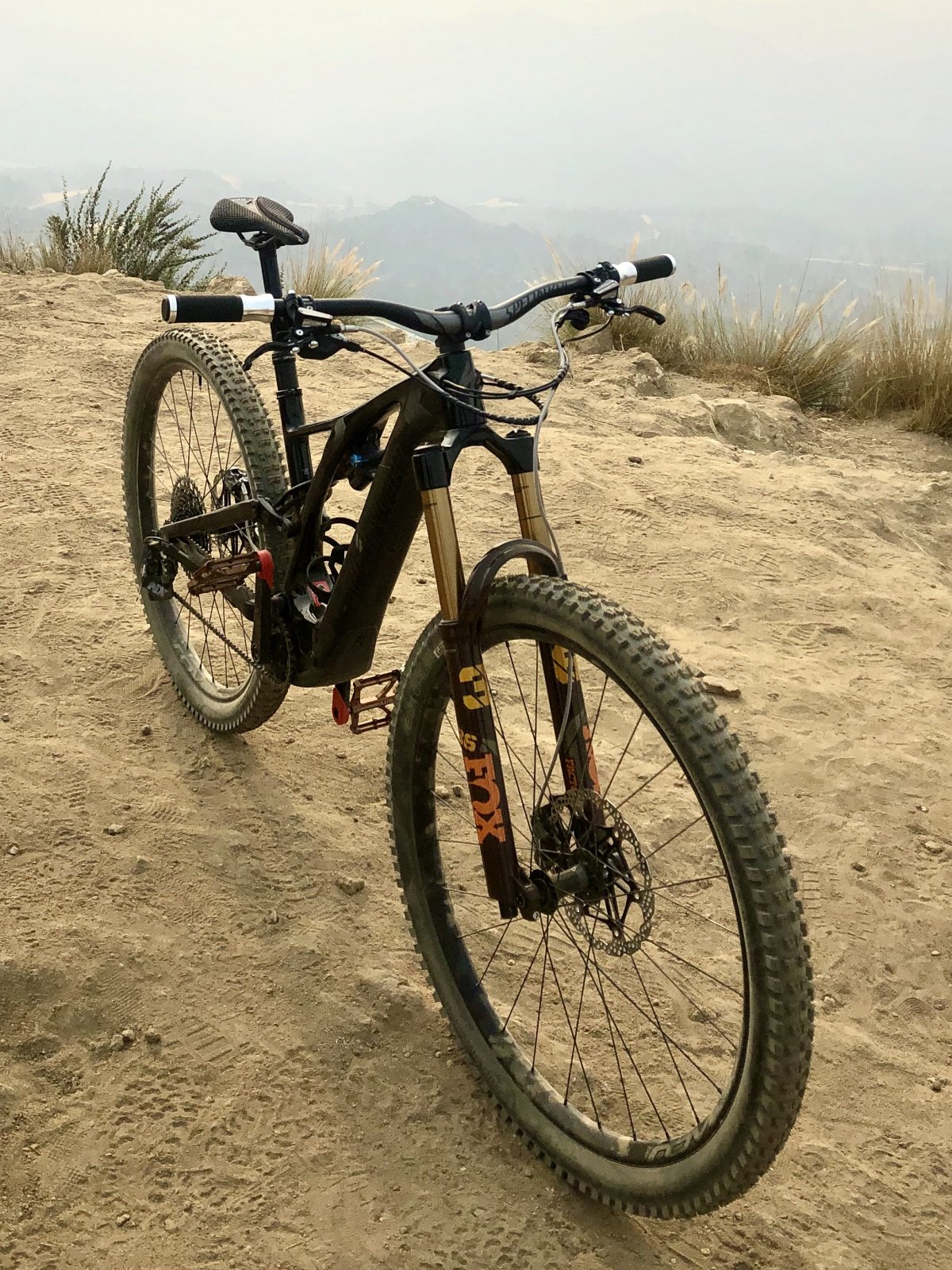

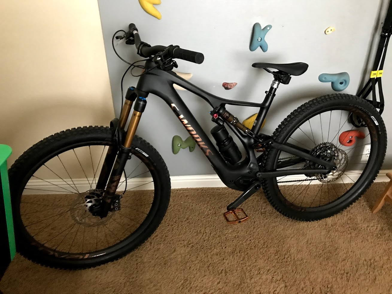

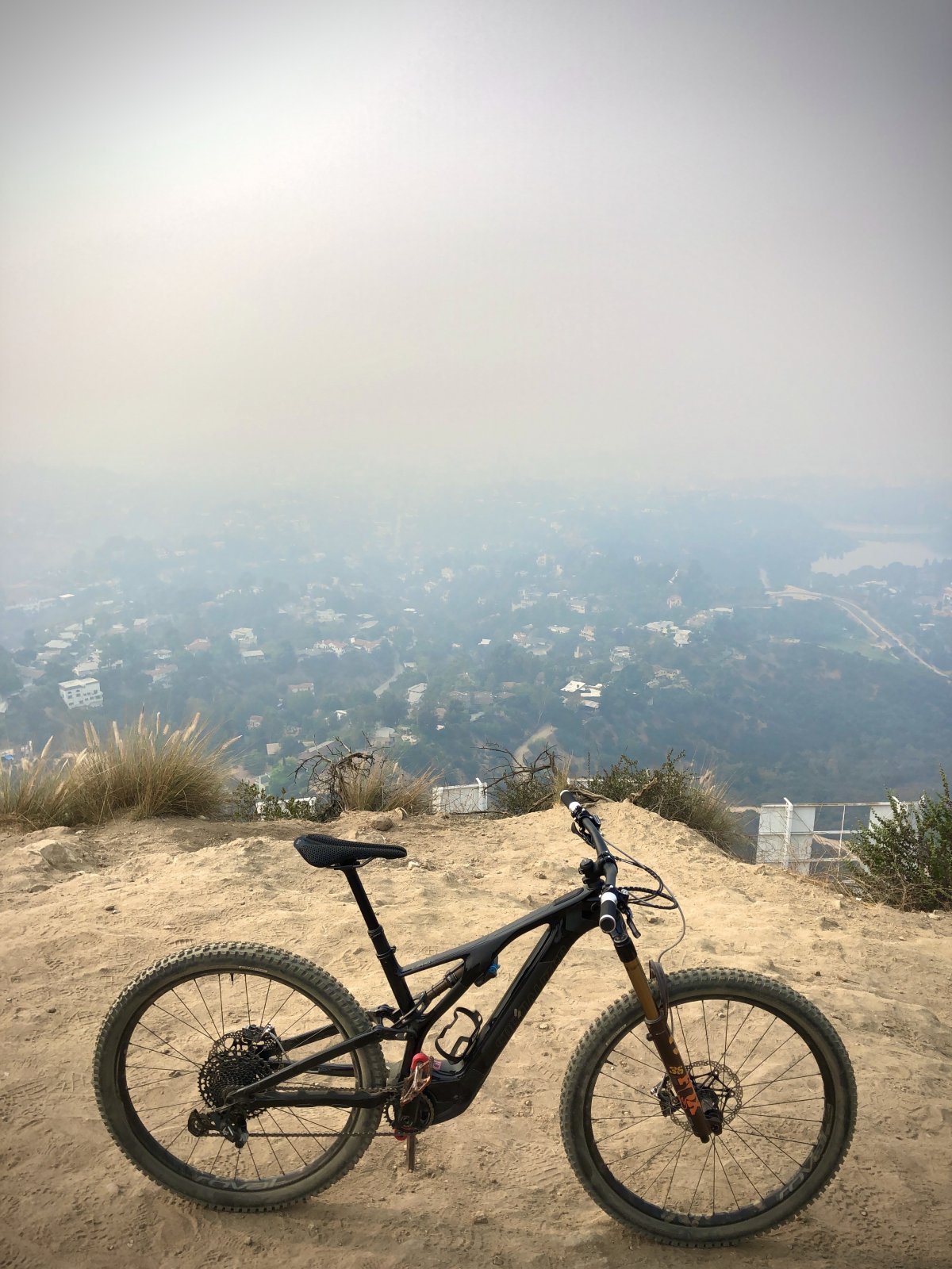

Hey Guys, had been reading this forum for months and had just jointed. Really thx for all your inputs and experience to make my decision easier....... Here is my 2 weeks old Levo SL to share with you. Financially, it's not easy for me as a Husband and a Father of 2. The only way, I got my hall pass was to pretty much sell my collections of toys! (Camera, Drones, old Bikes, etc..... ). But in the end, I got what I wanted and did not regret a sec of it.
Here's my upgrade.
Brakes: Hope E4 203 mm rotors: Sram break was just a little under power from what I needed to feel safe
Fork: Fox 36 41mm offset: I think the 34 51mm offset is okay! But the extra really make this bike comes alive.
Rear Shock: Fox Flot DPX2: Have no problem with the stock DPS.
Grips: Portland design..... Bad decision, it's not for this bike. Will switch back to stock and look for a better alternative.
Saddle: Fi'zi:k Antares Versus Evo Adaptive R3. IMO this is the most comfortable saddle I tried.
Future upgrade: ........ Might have to sell my wife's handbags!!!! for liquidity.

I Liked your post, @modsheep , but not the air “quality” there in L.A.!
I assume you held your breath for the duration of the ride ?
Let’s hope the fires stop and the usual onshore breezes return and clear the smoke.
