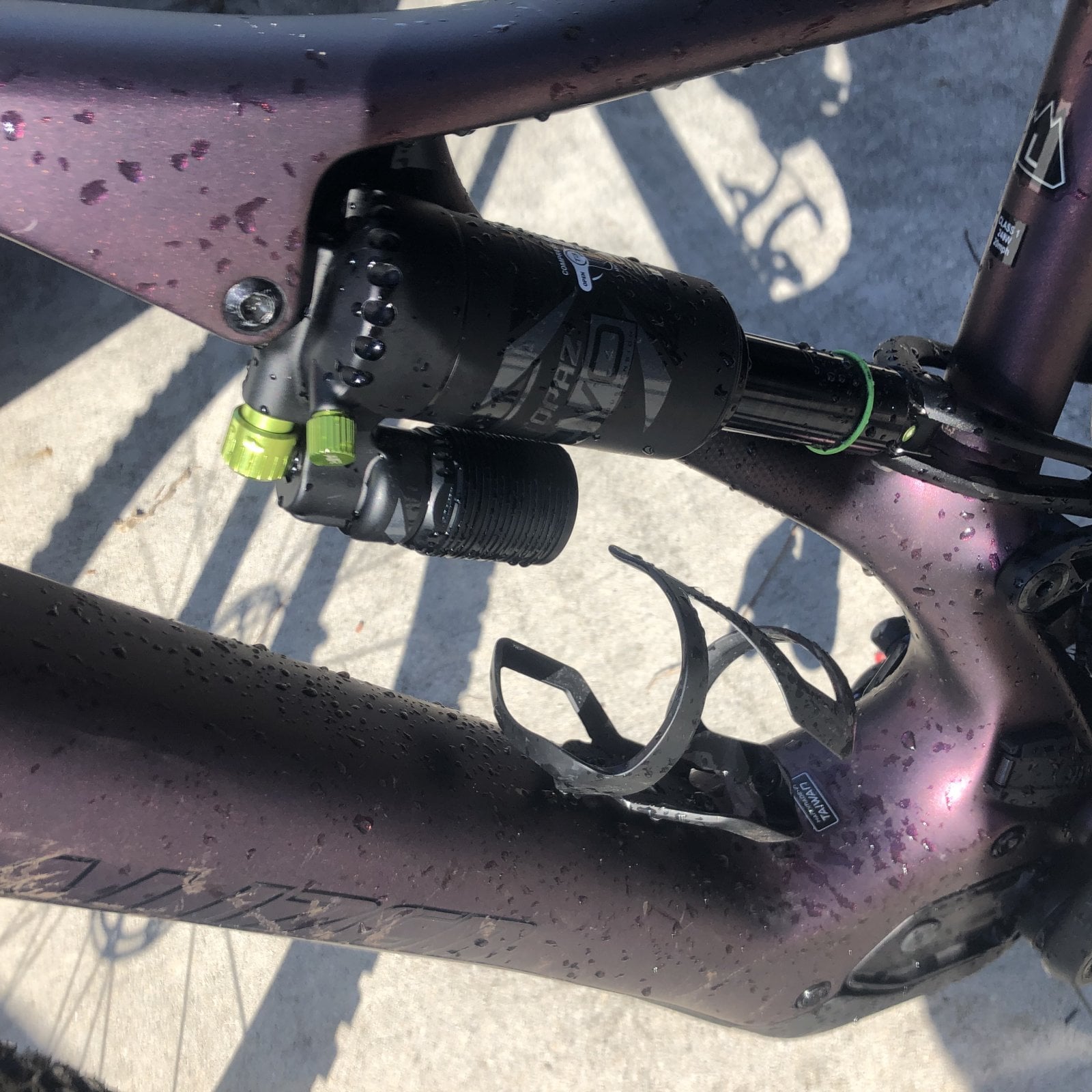

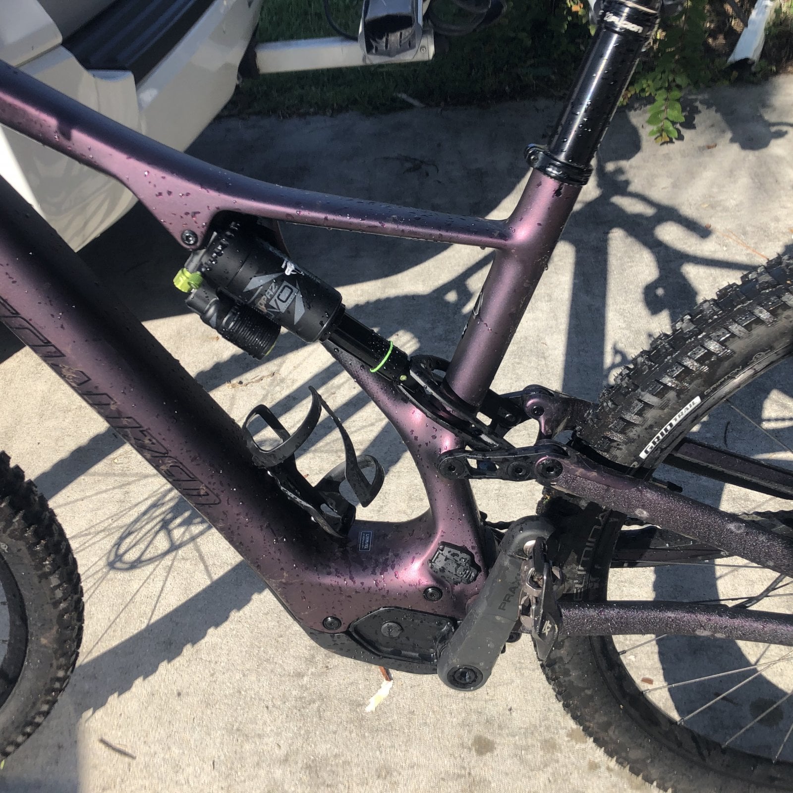

hi, looking into getting the comp carbon sl. I'd like to upgrade the rear shock to a dpx2. is the rear shock yoke universal to other shocks? I know upgrading shocks with specialized in the past has been a problem
MLX John
Jun 20, 2020
88
111
albuquerque, nm
Yes, it's universal. Just transfer the hardware from the Fox dps over to the dpx2. You'll need a DU bushing tool to remove the du bushing from the dps to the dpx2.

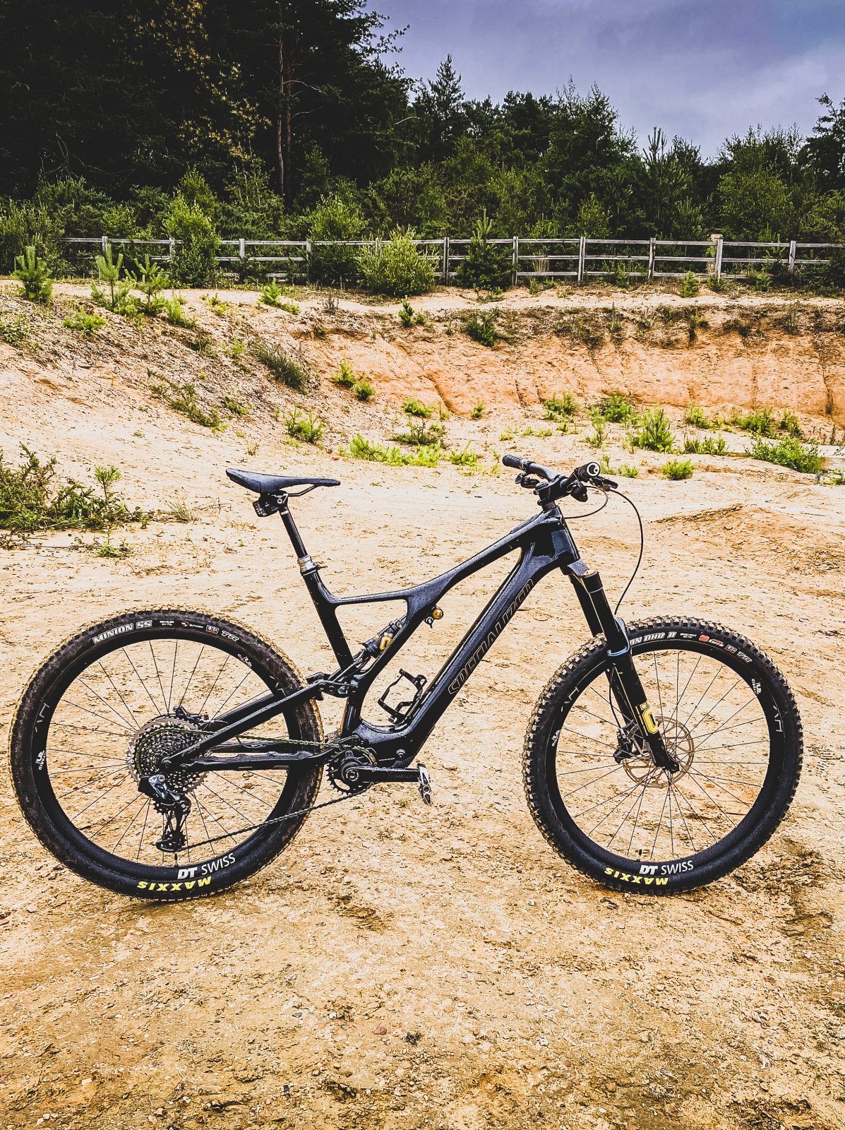

160mm Ohlins M2 fork and TTX rear. Few Carbon bits, wheels, bars. Full AXS. 17.25KG in XL and 16.5 if I just remove the internal run the extender battery.
Head angle with this setup is 64.6 degrees.
Rob, any feedback on the Ohlins yet (both front and rear)? Very interested to hear as there aren't many ride reports out there and I don't want to be going in blind! Is the TTX rear the Specialized specific 52.5mm shock or did you go the generic 55mm?

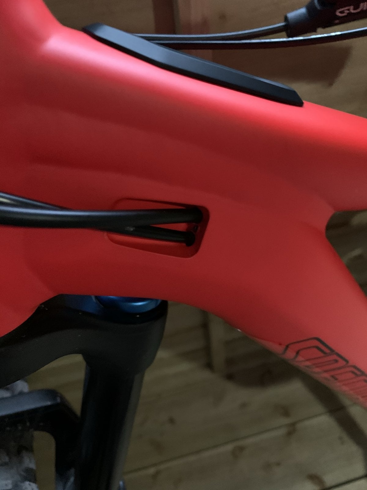

Am I missing a cover here? There is a plastic cover on the other side so just wanted to check I hadn’t lost something. View attachment 36104
yeah its missing, mine also, LBS have been trying to get hold of the part since March ?, all other sl alu I’ve seen have been missing the part also, I called the concept store to see if they knew anything and they were aware of the parts being missing but never had anyone try and get a part. Also they looked on the specialized parts system and the part isn’t listed??? Only the drive side cable guard.
