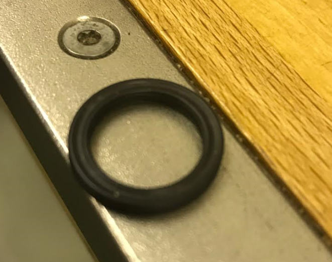

O-ring question.
hi guys - rookie-mistake no. 1 :-( , took shock, rear swing-arm and every moving parts apart for new bearings and re-grease for the season. this was 4 weeks ago - and now with nice weather I assembled today, and now have this one leftover, rubber-sealing/oring 14mm inside 19 mm outside, and cant seem to see where it fit ? WHY cant we have exploded views like when you have your manual for a motorcycle/motocross-bike ? anyone know if its possible to get these exploded views - and have an idea where i have missed this O-ring :)

O-ring question.

Looks like the top of the rear shock eyelet

Ha
That's what you said 6 months ago when someone else did the same thing... I was tempted to sound knowledgeable and say the same and steal the credit ?
Haha did I? I barely remember what I said yesterday! You can take credit for my wisdom, saves me from typing it.

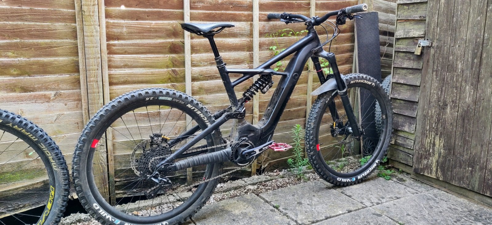

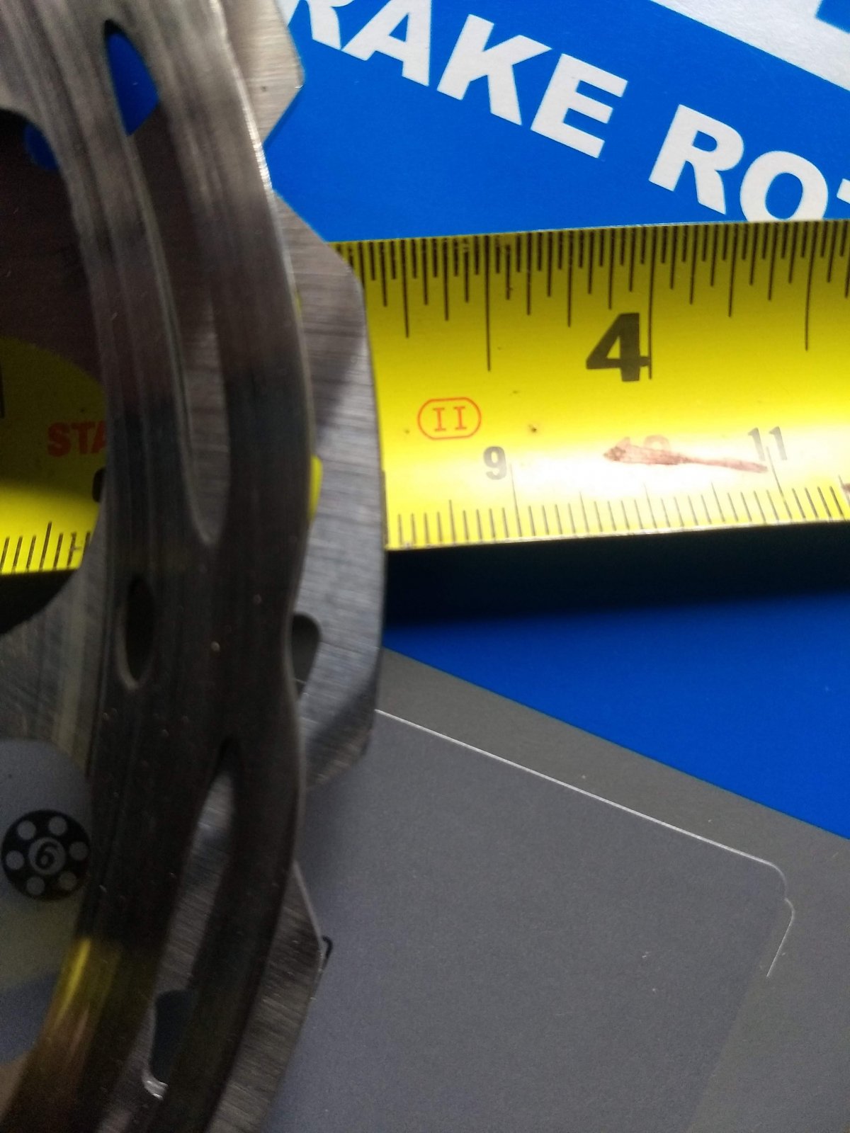

So birthday came and went and I was finally presented with MY disks, spacers and front brake !
Due to a combination of "lockdown" - not being able to ride in public and fractured ribs - hurts to ride there wasn't much impetus to fit them ...
Finally got round to it and checked the original disks compared to the Shimano's .
The Original SRAM centerlines measure in at 198, not 200. The Shimano's measure in at 203.
I guess this is why people have an issue spacing out with 1.5mm of extra washers.
Crap photo angle so doesnt' show the actual 5-6mm difference very well.
All swapped over easily and the new shimano spacers make it easy.
The ice tech rotors both are slightly untrue and I spent hours trying to get the rear right and eventually gave up. Once ridden and bedded in, they seem fine - so maybe do that first if you change them.
And on other news .. Fractured front ribs, hurts like a pig to breath sometimes, but you can ride the bike and just not be too stupid .. Fractured back ribs, doesn't hurt too much to breath but hurts like an absolute b1tch to ride - as when you pull, it's agony ! MERD ! Still .. bedding in was mainly pushing .. not pulling ! :)
For me the Zee's are a world apart from the Code R's, but everyone has their own preferences.
I didn't believe this so measured mine. They are 200mm. You have measured the narrower part of the diss which is indeed 198mm.
That or Europeans have smaller discs. Yes I did say DISCS :)

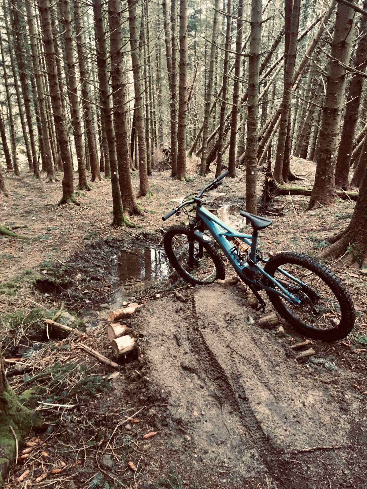

First ride on my new 2019 Kenevo.
Wet, muddy and slippery, but very fun!
Motor feels very powerful and plenty for me, and very quiet , i couldn’t hear it.
On these tecky trails the bike felt a bit big and heavy, so took much more effort to do endo and manuals. But after a few more rides that will probably become second nature again.
Sometimes i felt the bike wanting to get away from me, so I felt i lost control of it.
So I’m going to play around in the app and tweak the power output for when i ride these types of trails. Then again, it might be ok after riding it a few times ?

View attachment 28621 First ride on my new 2019 Kenevo.
It is a lot of bike and it also took me a good 3 to 4 rides to get used to the weight. Now in comparison to my current bike it feels very nimble and light.
Give it a few rides and you will be throwing it around like a pro.

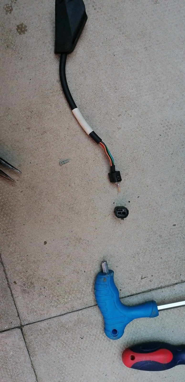

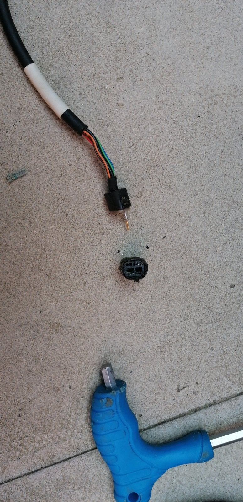

Bike would not engage motor today battery was fine on blevo app but could not find the motor, decided to remove crank and case to check wires inside I noticed the power cable into the motor was loose, pulled the tab down to pull the plug out and was left with a broken plug this it's corroded
anyone else come across this

Bike would not engage motor today battery was fine on blevo app but could not find the motor, decided to remove crank and case to check wires inside I noticed the power cable into the motor was loose, pulled the tab down to pull the plug out and was left with a broken plug this it's corroded View attachment 28650 anyone else come across this
I have had warranty replacements 2x times on that harness. Not that exact failure, but at the charge port. The sockets would deform and lose connectivity. Overall, bad design IMO not meant for the number of cycles we put them through.
Good news is any reputable spesh dealer will warranty it for you
I agree My motor would not engage the other day. I thought it was connection from remote, since remote didn’t do anything, so cleaned up that connection. Didn‘t help. Then tried to reset the battery by pressing and holding on button for 30 secs. It worked after this but I think it was the connection, which was perfectly dry and clean, but just wasn‘t connecting properly. Bosch system so much better - battery just clicks in - no need for a connector that can get dirty, wet or distort.

Iam hoping mine will work better after this power cable replacement had a few times where came to turn bike on and nothing from motor I think/hoping its always been a dodgy connection inside the plug after seeing the state of it

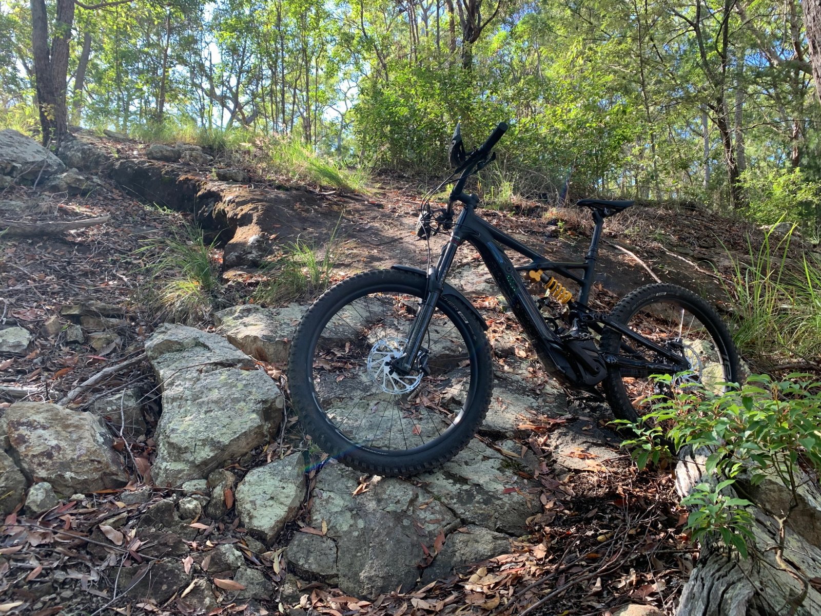

Hi all. Picked up a 2019 Kenevo expert a week ago. What a weapon.
Was not sold on the first ride, mainly due to old firmware so not allowing power changes per mode, and some suspension set up issues causing the front to push.
But 6 rides on, I love it. Suspension is ridiculous. I upgraded the rear spring to a 640 before 1st ride to make sure it was balanced straight up. Yes its a bit slower through single track, but when it comes to bombing rock gardens, bigger drops etc it is just an amazing rig. Could not be happier with it.
Its nice to have a bike that I'm not thinking about upgrades on. Brakes are good, fork and shock are amazing, motor is superb (coming from 70nm E8000 to 90nm Brose is a big improvement for me at 95kg).
I'm rapt!!!

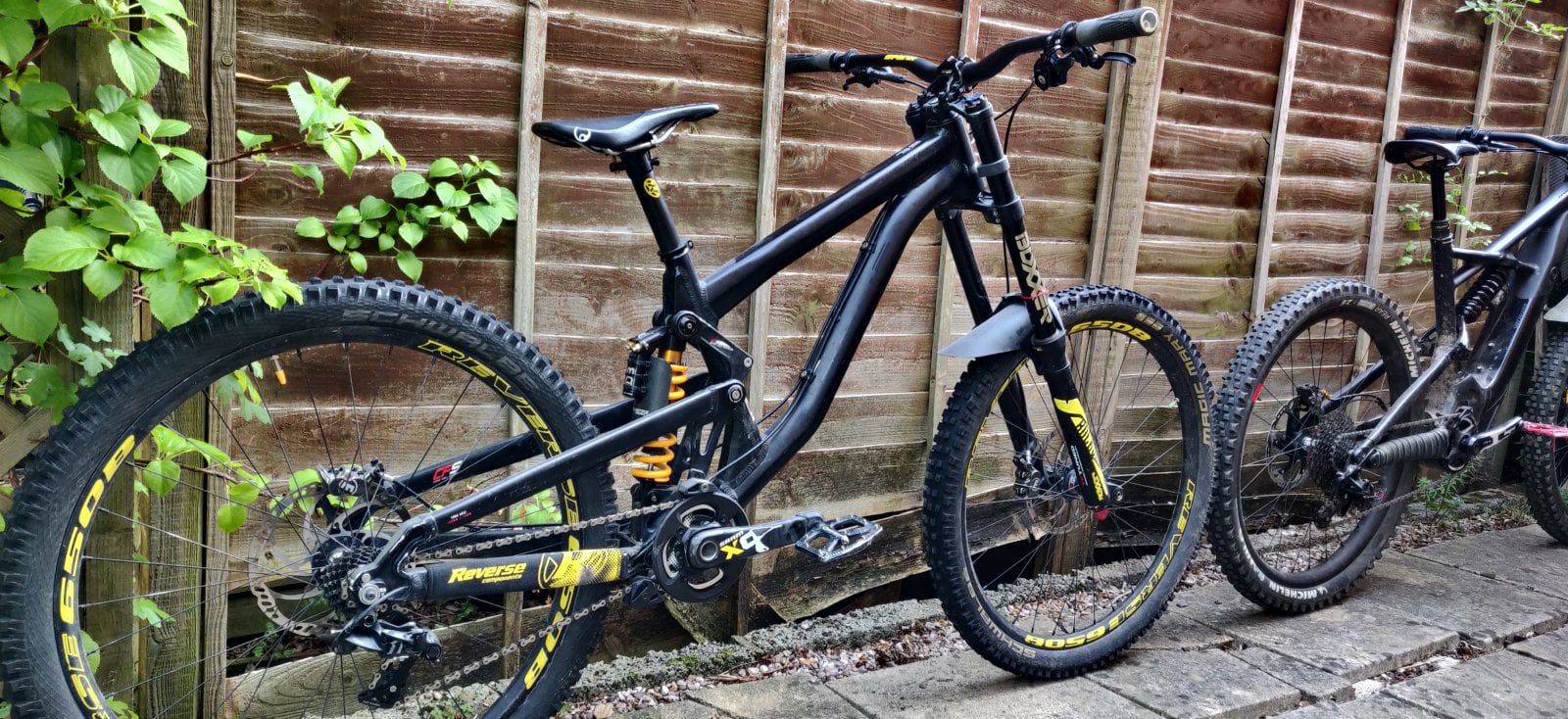

Seeing as this year is likely a right off for uplift days, I can't see my DH bike getting any use at all. Fortunately with the kenevo and 2 batteries I can self uplift at a lot of places!
I also have an itch to scratch by trying dual crowns. In steps the solid strike DH bike!
So I have everything I need bar a 1.5 to 1 1/8 headset fork adaptor to try this out.
Could get costly if I want it to stay like that though, will need to buy some boxxers and get my expense santacruz reserve wheel rehubbed to 20mm.
Will update once I've ordered the bit I need ?
