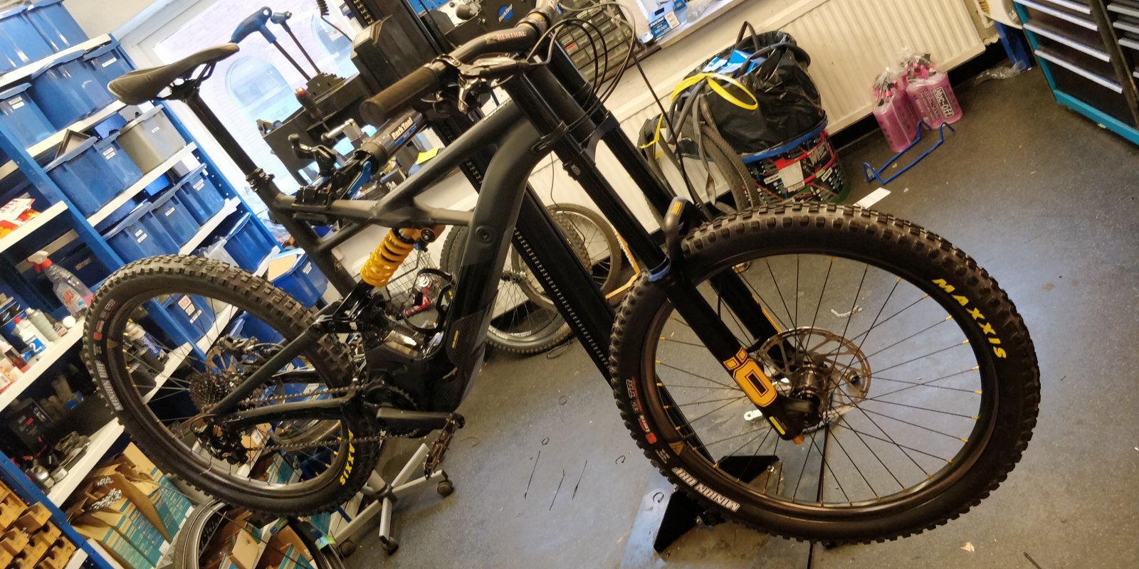

just ordered this badboy :) cant wait to shred som trails ;)
