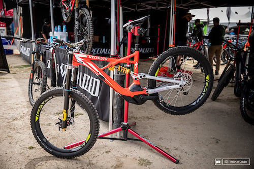

This was on the Spesh stand at Sea otter, I usually like a murdered out bike, but this is pretty special, looks like a throwback paint job similar to the stumpy Jason McRoy used to ride

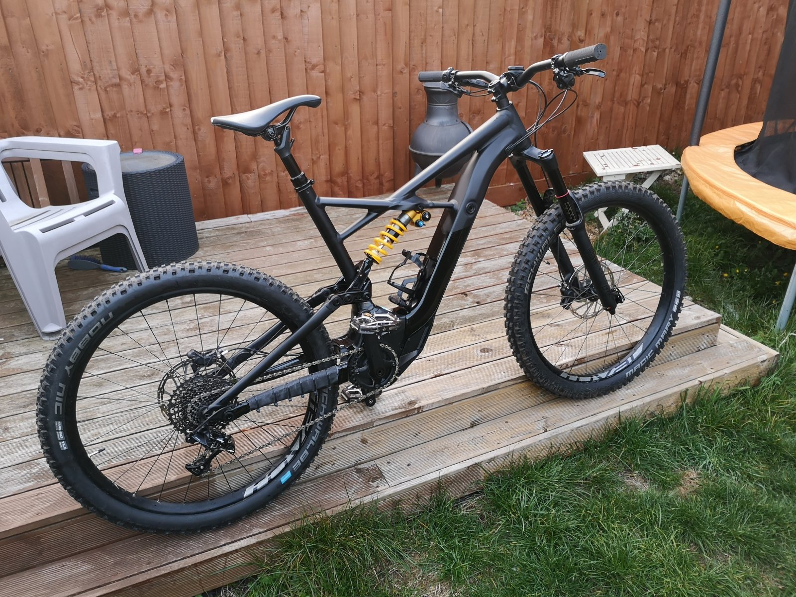

Hi all new to ebike scene and enjoying so far I've bought a second hand 2016 levo, just could not bring myself to part with cash for a new one!...
My bike does not come with the buttons to control the settings on the bike and I see there are a few threads on retro fitting the switch, I'm having trouble sourcing one so any help would be greatly appreciated or any other way of controlling the settings I've also downloaded belevo but not yet set it up to the bike can this be used instead?
Cheers
Cheers
If you don't want to fit a remote on your handle bar, you can use the buttons on the battery indicator where you switch it on/off.
Blevo and Spezialized MissionControl both can change the settings, but while riding a trail i wouldn't recommend tapping buttons on your phone to change motor support. The apps are a nice & very useful addon but for riding i would totally recommend the small remote next to your grip.
