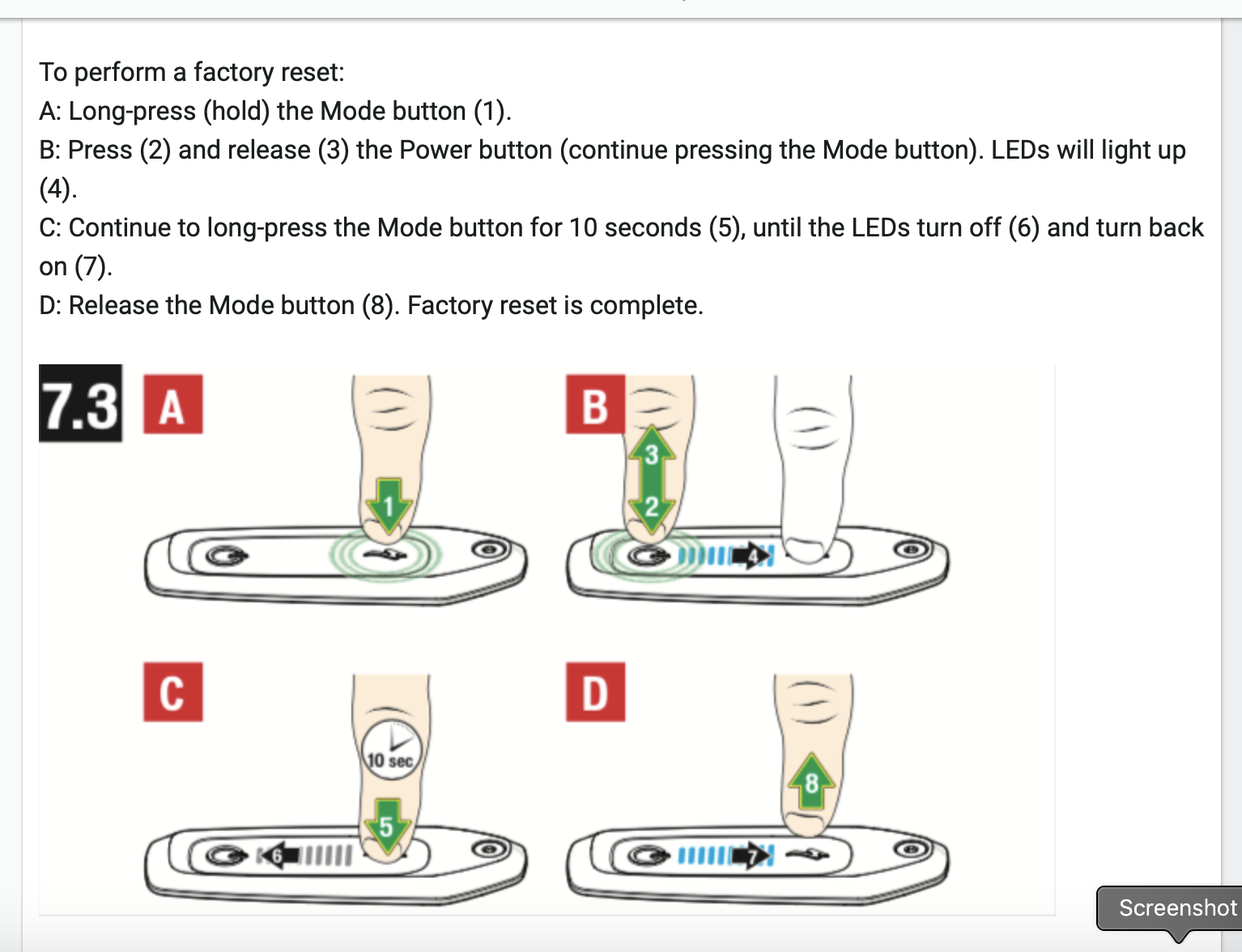

Hi all!
I received my new Kenevo expert last week and it's really an awesome bike. However, I'm having a bit of a problem connecting the bike to Mission control and was hoping maybe someone had some insight on what to do.
The problem is my Mission control can't find my bike, it just won't show up in the list. I've tried all the usual methods like restarting my bike, phone and the app. I have the location services and my Bluetooth on and I really have no idea what more could I do..
I've emailed Spesh but they haven't replied yet. Is there a way to maybe reset the battery? I've come to a conclusion that maybe the bluetooth unit of my bike is dead, as even third party apps designed to see every bluetooth device won't find the bike..
Thank you already,
Niko
Hmm are you using iOS or Android?
Have you tried a factory reset?
My next recommendation would be to delete all other Bluetooth pairings. Also reason I asked if you were using iOS or Android is - if you're using Android, can you try with an iPhone & vice versa. If all that fails then I think safe to assume it's the bluetooth module on the bike.
DisasterHamster
Aug 6, 2019
9
11
Finland
Have you tried a factory reset? View attachment 16774
I tried the Levo factory reset and it doesn't seem to work. Is there a way to do factory reset on a -19 Kenevo?
I'm on Android and don't have an Iphone to try. However, I tried connecting my Garmin Fenix 5 and even that doesn't recognize my bike.. I think it uses Ant+ instead of bluetooth.
