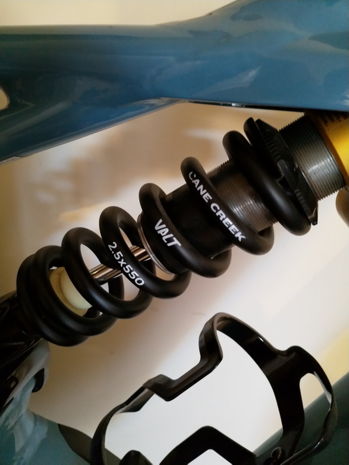

Cane Creek springs only come in 50Lb increments so available spring rates are nowhere near as granular as what you can get with the Ohlins springs. Ohlins have smaller increments between spring rates thus there's scope for achieving a more precise match for a riders weight. That said, if your riding weight is as you have told us then your current 548Lb/in spring is probably the correct one. A 525Lb/in recommended for a 88kg rider is going to have greater sag which may or may not work for you but its always worth a try to get a proper comparison.
For anyone who's interested, I've included a picture of the 2.5x550 Cane Creek Valt spring installed on the Ohlins TTX fitted to my Kenevo.

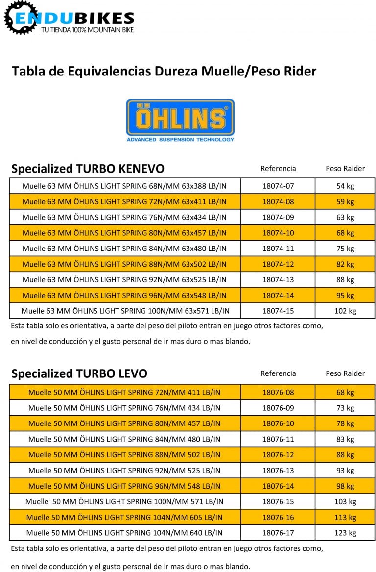

I did a test-ride on the Kenevo today and I'm stoked!!
After that test-ride the choice is now pretty easy - taking the black now with a little discount, or wait for the blue where pricing and delivery date is still unknown. Guess I will go with the black and start riding it next week ^^ Will think about it till Monday and then call the dealer...
Regarding the coil-spring - I'm 100kg so I want/need a stronger one. I took a photo of the spring in the Kenevo size L which has 502 lbs:
Interesting was, that the Kenevo in size M has a coil spring of 457 and the size XL has a spring with 548 lbs (hope I remember correctly).
Here's the table with recommended rider-weight and part numbers.
Rider-weight is rider + gear + backpack, so "ride-ready" weight.
In that case, the 571 lbs spring is the choice for me:

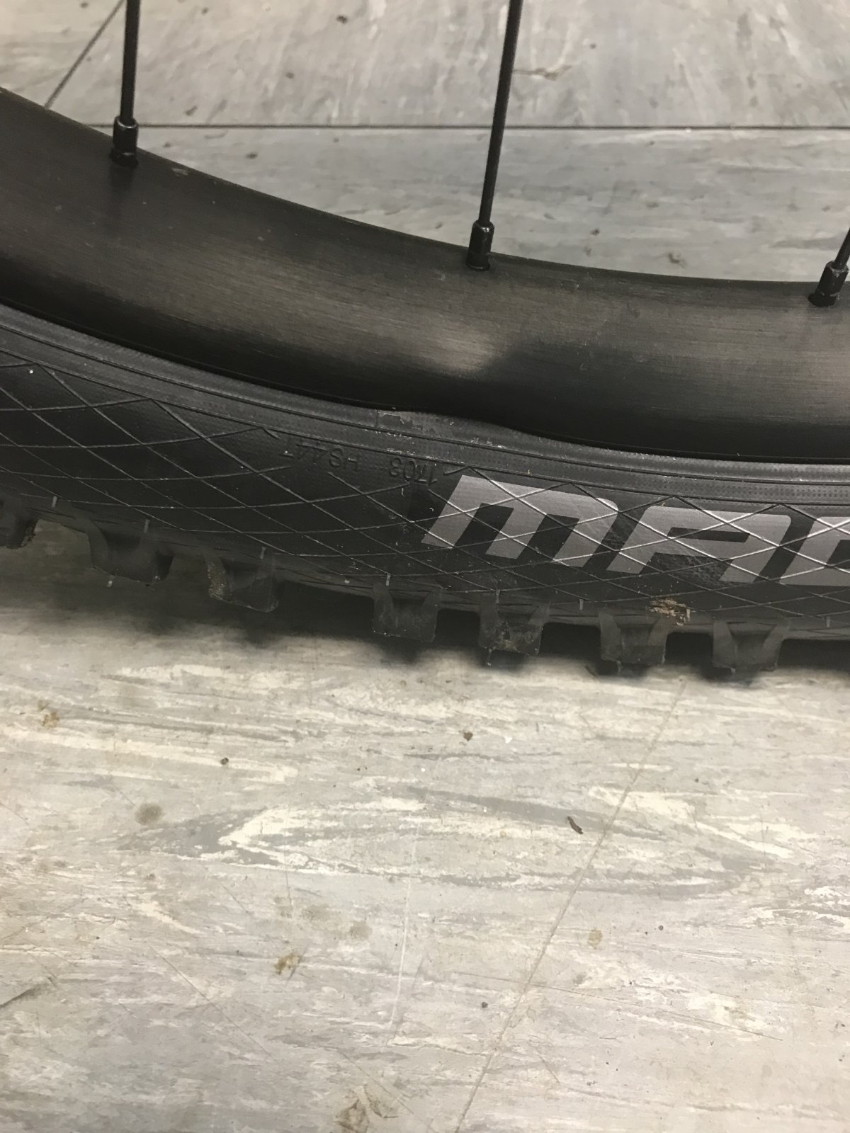

Dented my rim first outing on the commute to work I rode up a small kerb at speed. Testing out the plushness! ? I’ve not even ridden it on the trails yet I’m Gutted. what’s my options if I press the sidewall of the tire it leaks air. What’s my options, tempted to have a go with some soft jaws and a soft drift to remove it. Whats my options after some adivse.
lcdavies5
Nov 1, 2018
18
12
South Wales
I've previously used an adjustable spanner to to bend back a dented rim on another bike. There's a few tutorial videos on YouTube I'd advise watching if you go down that road. I know the rims can crack if not done properly.
