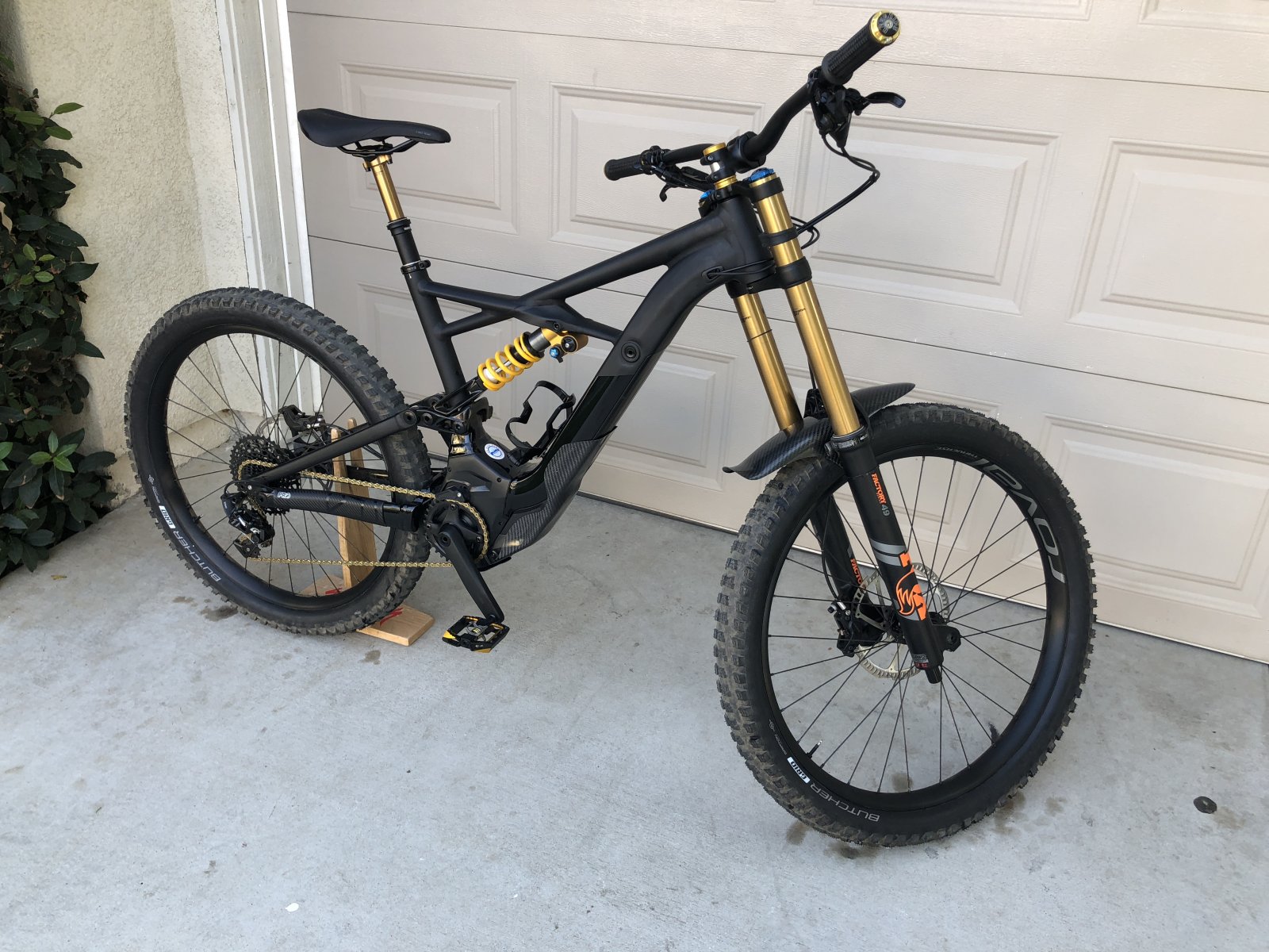

This bike is hands down a blast to ride, the extra travel gives so much more potential for DH to XC where as I would not DH a levo even the new one.
Two different bikes for different folks.
I’ve modded mine and intend to finish my build with a direct mount stem and carbon wheels, brakes are now 203 not 200 also.

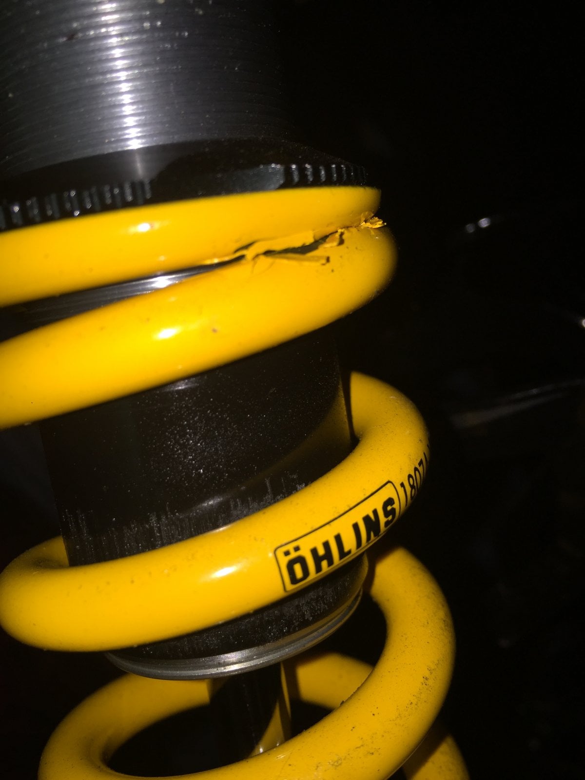

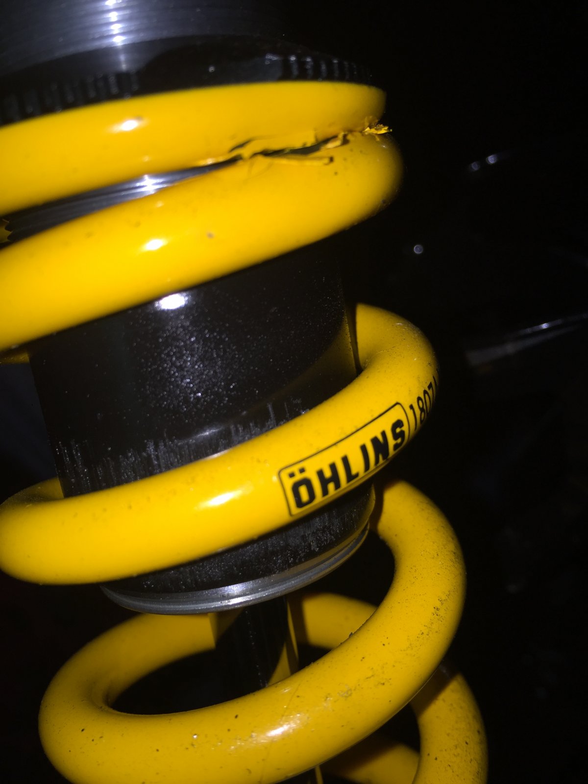

Only had my Kenevo a couple of weeks but have noticed the öhlins spring coating is cracking. Has anyone else had this issue?

no, springcoating is ok after 6 very hard riding days
only chainrings and chain has to be changed after 477 km. pretty early but motor power so strong and one doesnt use it smootj ... ?
