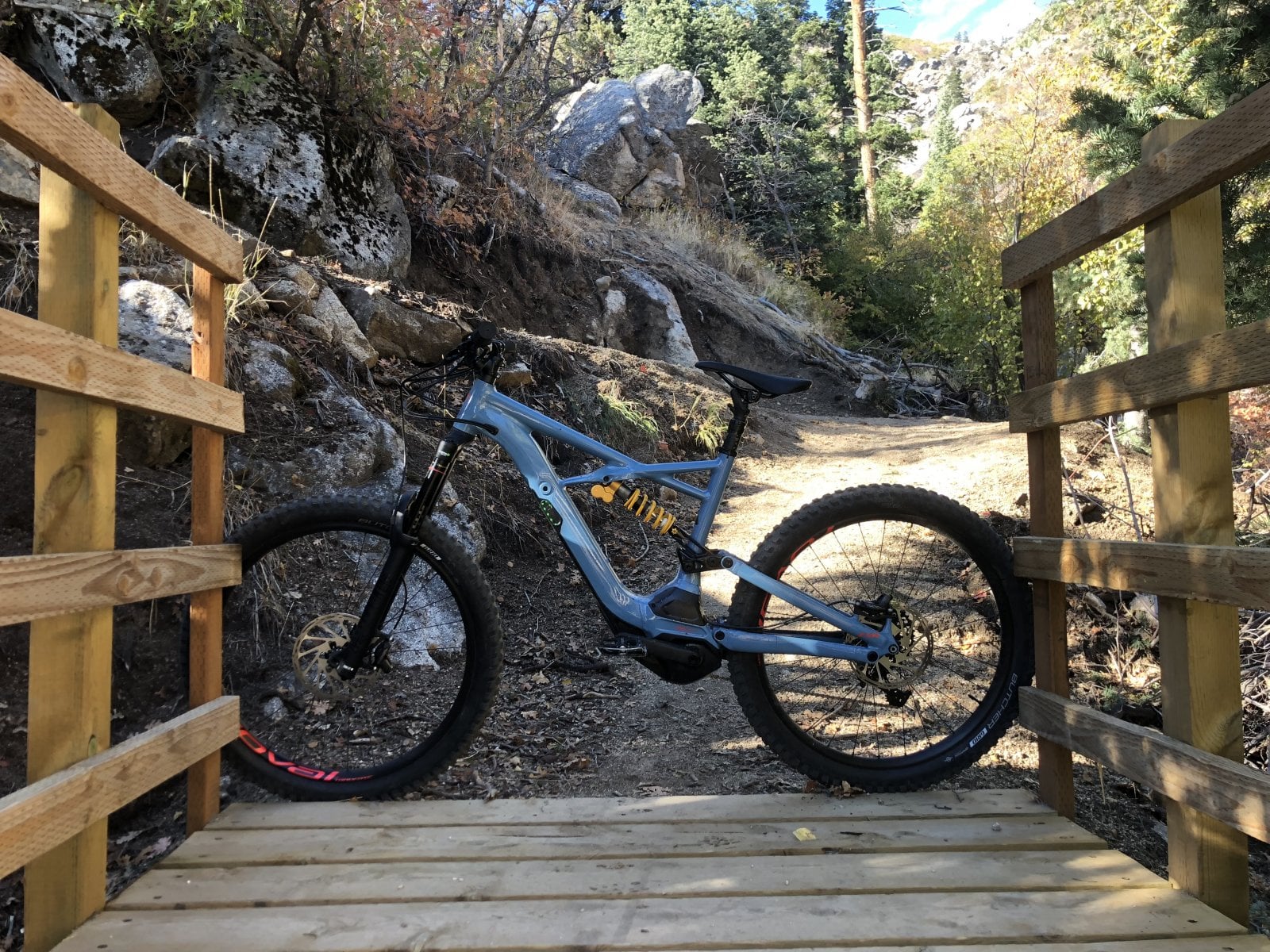

Oooo baby, in love with this gal. I've ridden the 18' Levo, 19' Levo, 19' Kenevo Comp, and decided on the 19' Kenevo Expert. So stoked!! It feels similair to my Enduro Expert but the Lyrik and Ohlins TTX really sets it apart. Pump those 2.8" butchers up to 23 front psi, 26 rear and they hook up well. This bike absolutely rips out of the box. Those questioning between the comp and expert, if you can swing the extra $ it's worth it. The higher end suspension, 38mm internal width wheels, and larger battery paired with the 1.3rx motor really make the difference. The comp was still a blast, I prefer its non tilting seat post, and I was however, able to get more distance out of the comp in full turbo mode vs full turbo mode on the expert, probably because the motor isn't able to consume/output as much power, there for not pushing you as fast or hard up the steeps.

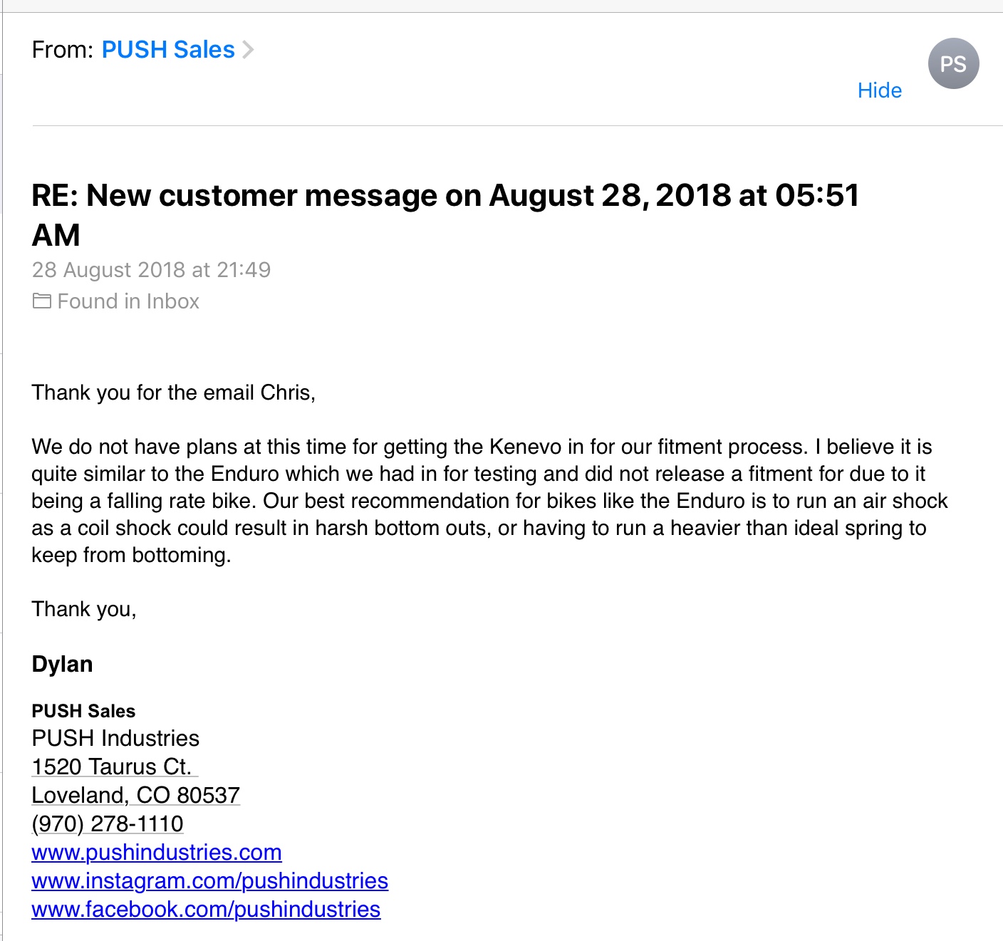

They make an 8.5x2.5" shock that will fit with the new Kenevo bikeyoke
Is the shock you are getting specifically tuned for a Kenevo?
I have the Push rear shock on my Santacruz Nomad and enquired with Push in August about retuning it for a Kenevo and they said they had no plans to get the Kenevo in to carry out their fitment process.
Has this changed now? If it has, that is great news because this rear shock is an awesome piece of kit which is unfortunately not doing a lot as I have not ridden my Nomad since March this year.
Al Boneta
Dark Rider
Jan 18, 2018
1,351
2,603
California
They don’t have one specifically tuned for the Kenevo, because as you keep pointing out, they don’t make one that fits the Kenevo. Nothing has changed, other than BikeYoke is making a BikeYoke that fits the Kenevo. Which good news for people who would like a different rear shock. Any 215x63mm (8.5x2.5”) will fit. If you use an air shock it will actually give the bike 10mm more travel than a coil. I really dislike Öhlins on anything bicycle related, so I can’t wait. I have already ordered a Fox Float X2 and DHX2 for myself
A PUSH shock will be my end goal. I have one on my Yeti and it lives up to the hype.

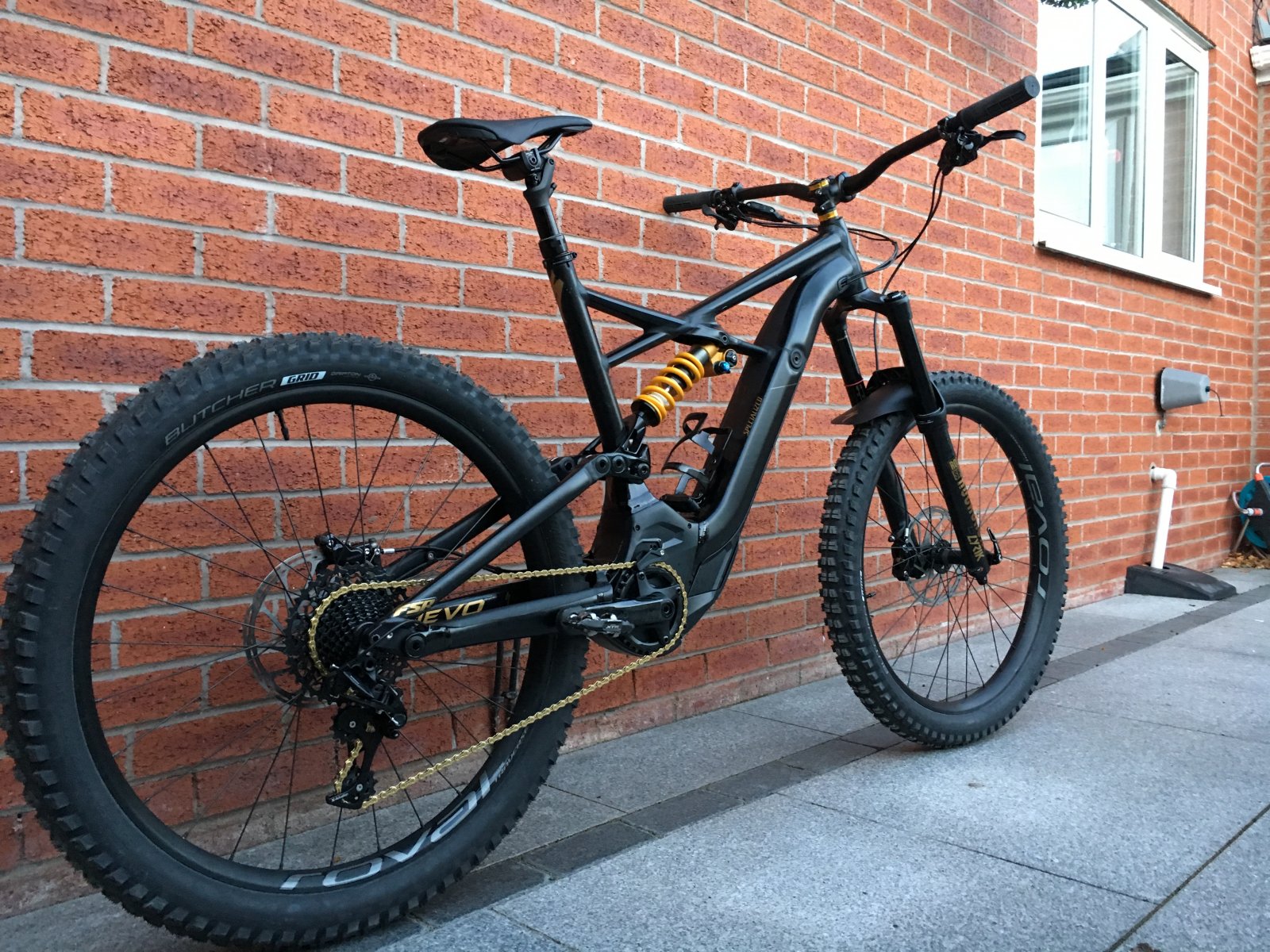

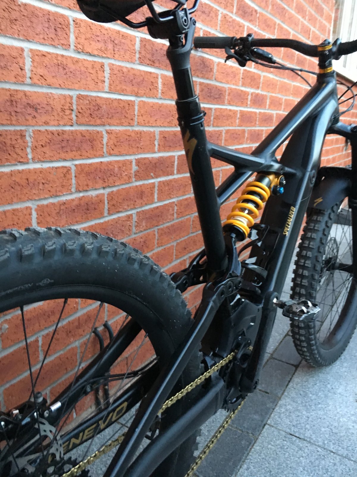

Soon to be kenevo owner. What does everyone use for protecting the chainstay, I’m surprised they have not got one fitted as standard as most bikes these days have them intergrated and I don’t fancy wrapping in rubber and tie wraps as it looks pants. Apart from lizard skins what’s the options out there?

I'm too wondering this. Couldn't help myself and went out on my new kenevo before I managed to protect the frame and the chainstay is all chipped.

so i have to have a serious word with my shop ?
Yes, that should be something that should be done as a part of getting the bike ready to go to the customer. Makes you wonder if they even checked the bike before they gave it to you!!
