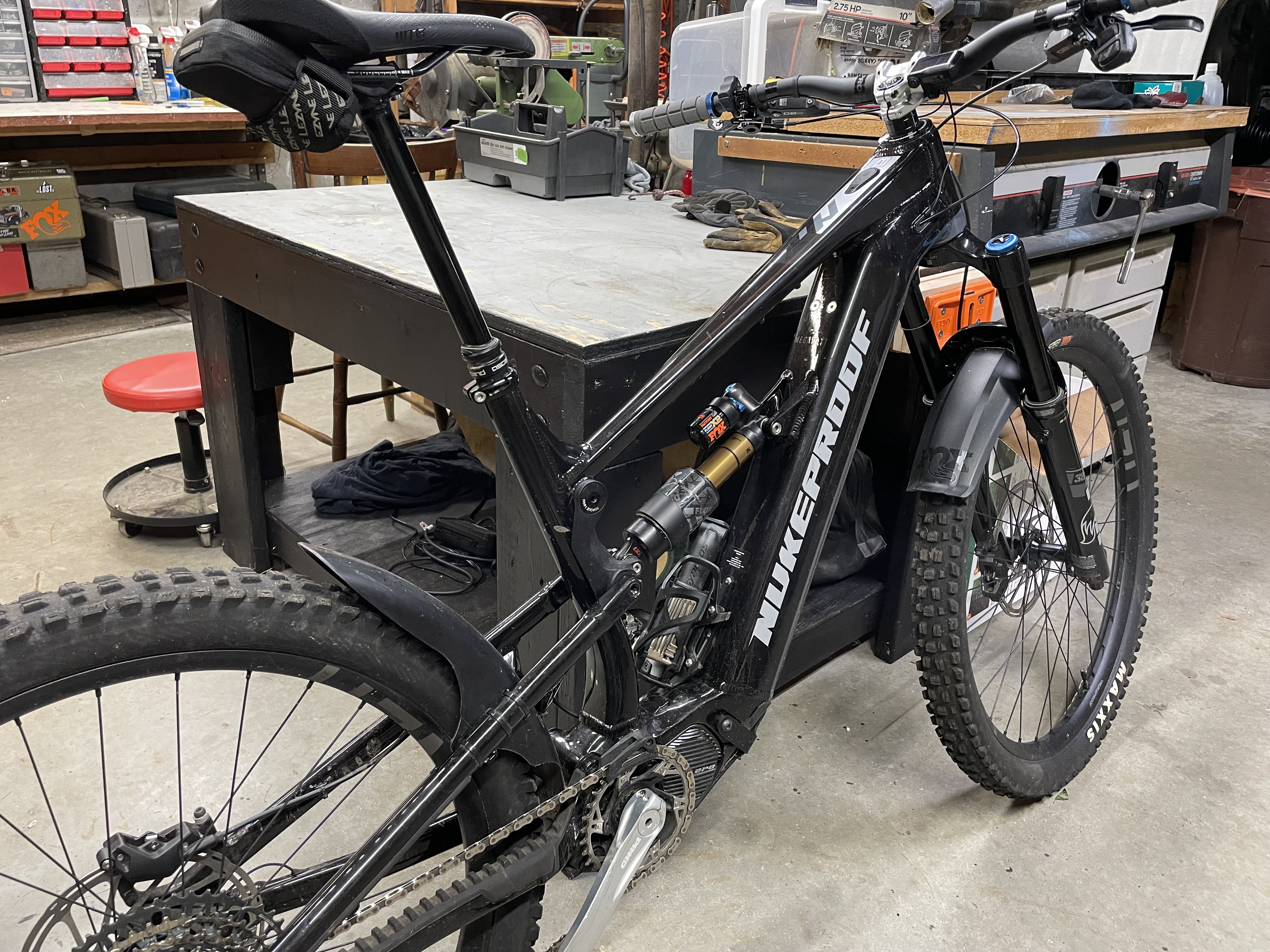

Hi all, just bought a used 2022/2023 Megawatt RS and and looking for what people use for mud guards on these bikes. Thanks
I have a Fox fork on my '23 Megawatt Elite and I'm using the Fox "long" bolt-on mudguard up front. I think you have a Zeb so you could run the Rockshox mudguard which is short, or go with an RRP Proguard if you want a longer bolt-on mudguard which seems like a good option for Ireland. I have one on my regular bike and it works great.
RRP makes a rear mudguard that would probably work on the Megawatt. I made my own by buying the cheapest molded front fender that I could find on Amazon then I cut it and molded it with a heat gun to fit. It works great. I was getting huge piles of crud in the chainstay pivot area before I put this on.
