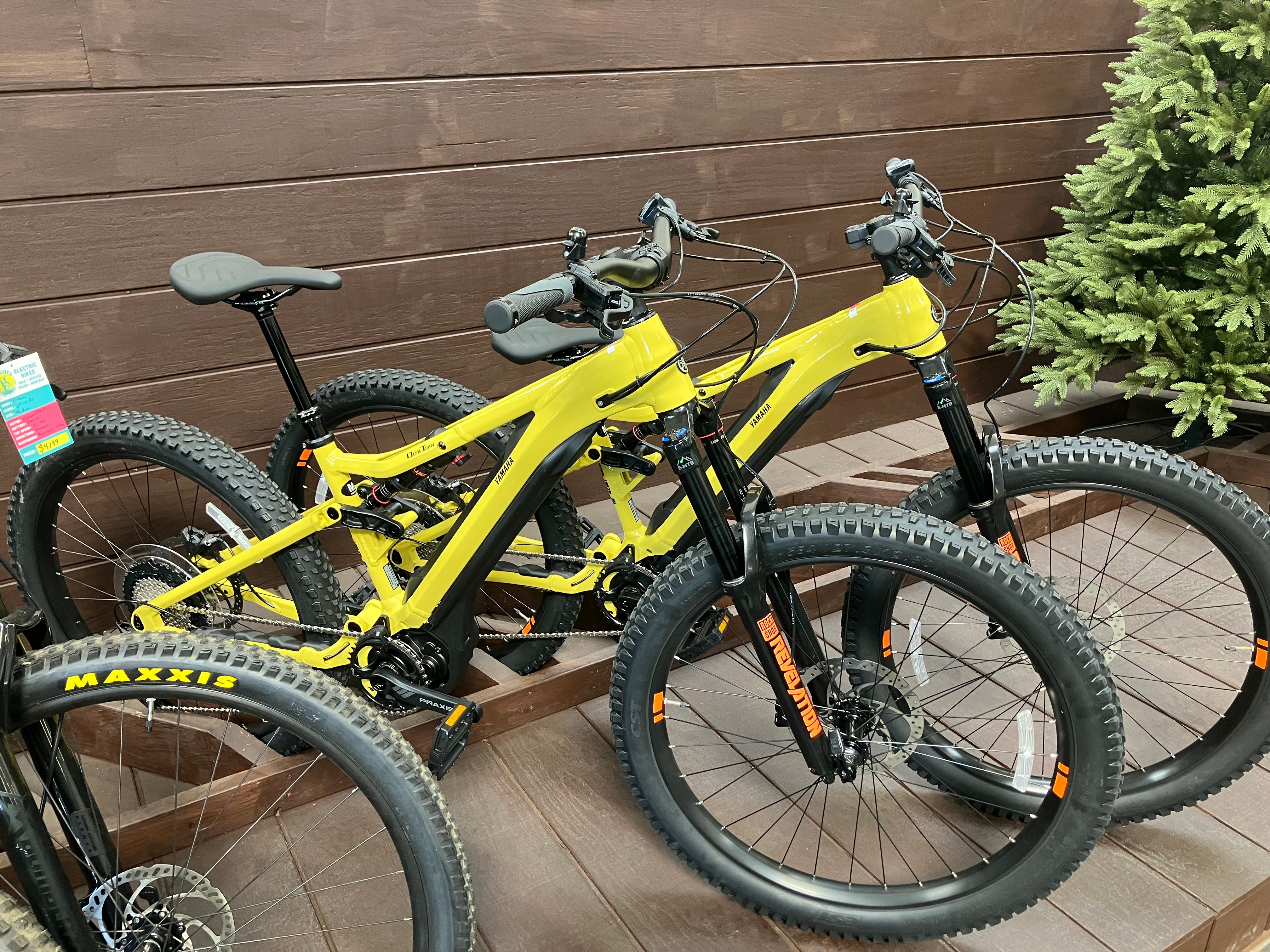

FYI - These guys have them and you can test ride on dirt right out of their shop. (Poway, CA)

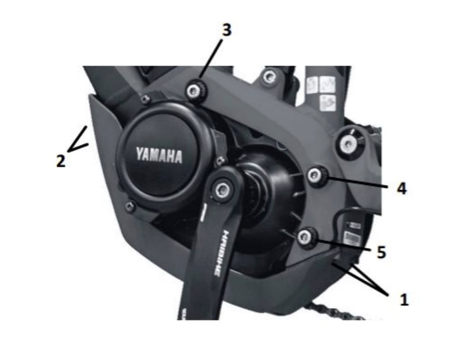

Interestingly enough, also had a motor mount bolt come loose as some have mentioned, rode on it with 3 bolts for a whole park day, sheared a second one off. Had a ton of trouble replacing those bolts, ended up going back to original shop purchased from (San Diego Electric Bike) and the owner was SUPER nice, willing to pull down one of his floorstock and pull the bolts off a new bike. He said that Yamaha has made it an absolute pain to get parts and service, and plan to drop them altogether because of it. It’s a bummer Yamaha hasn’t provided more availability for parts and service, because I’ve absolutely loved the bike.

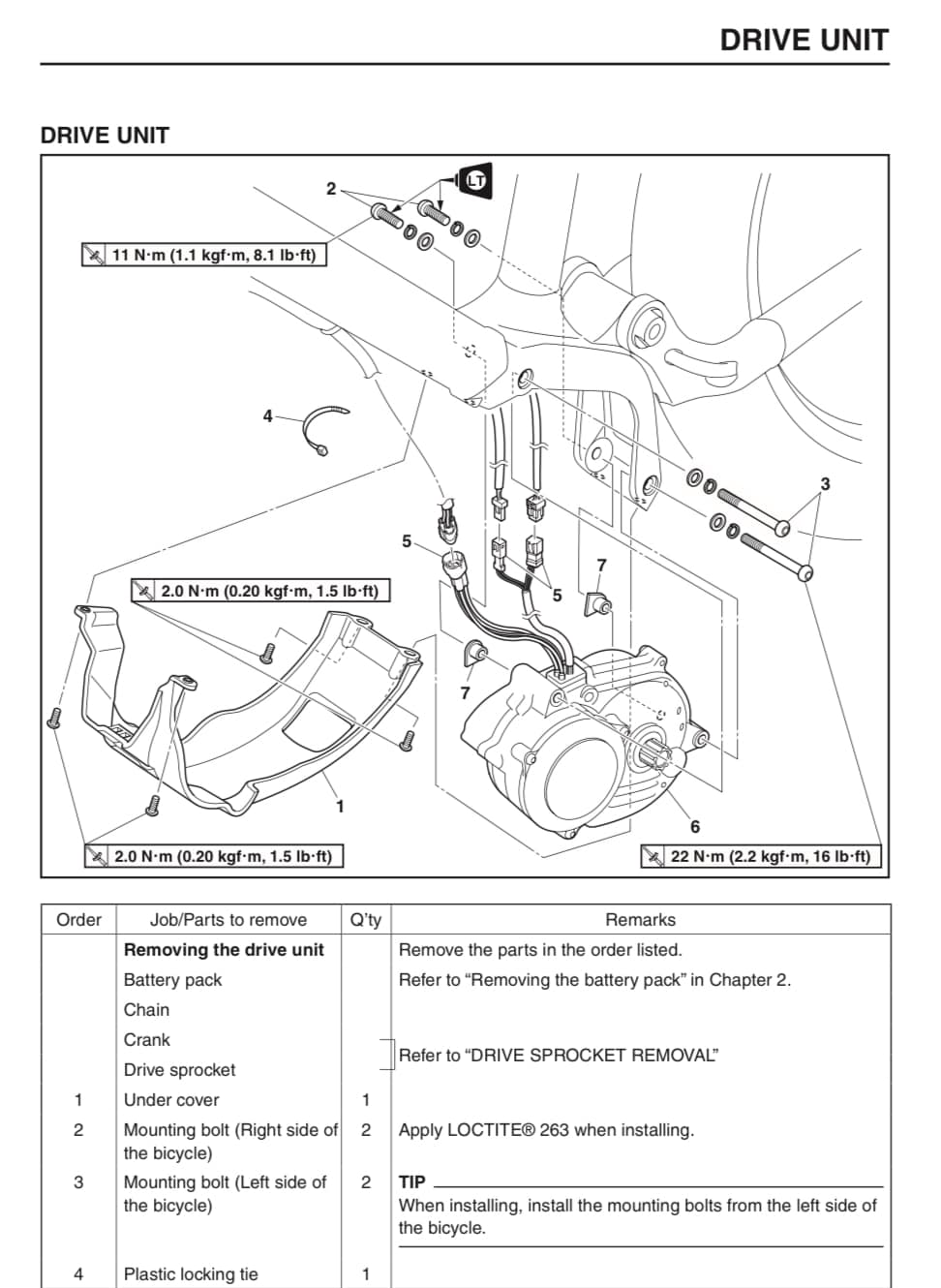

Also, anyone able to find a more extensive torque spec list than just the basic assembly manual that’s on Yamahas website? That one does not include torque spec for those motor mount bolts for example…

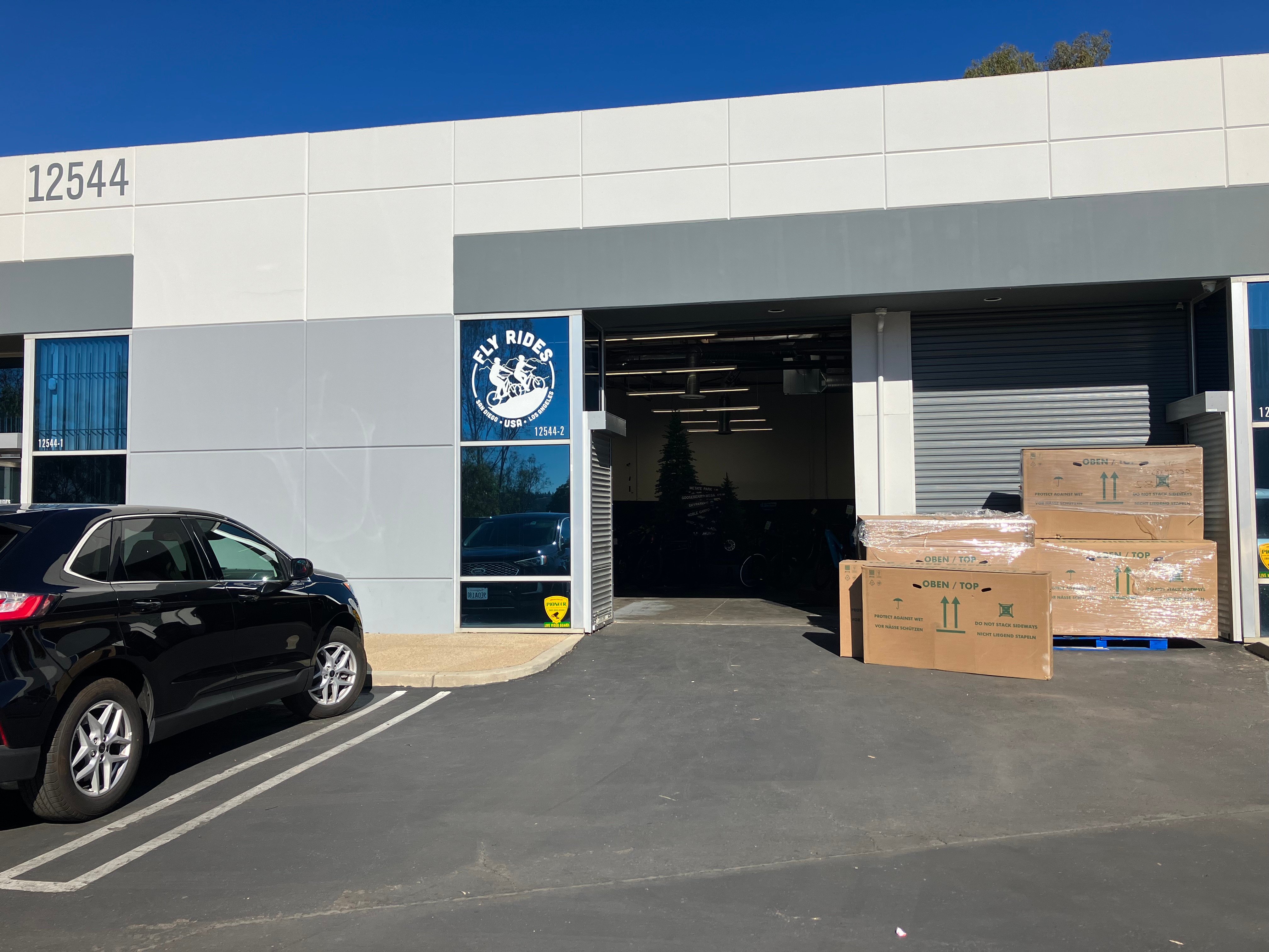

Hi all--I know this is an old thread but I just bought this from Yamaha (and hopefully take delivery of it in the next few days). I am reading that I should loctite the motor mount screws and I am curious if these are the screws that I need the extra TLC.
Also, for those in San Diego, I spoke to the Fly Rides shop in Poway and they said that they can service the bikes.

I would DEFINITELY locktite those suckers. I have had several issues with them backing out, though I had the pw-x2 motor the 2022 version, it looks from your diagram they have made some adjustments, perhaps for that exact reason.

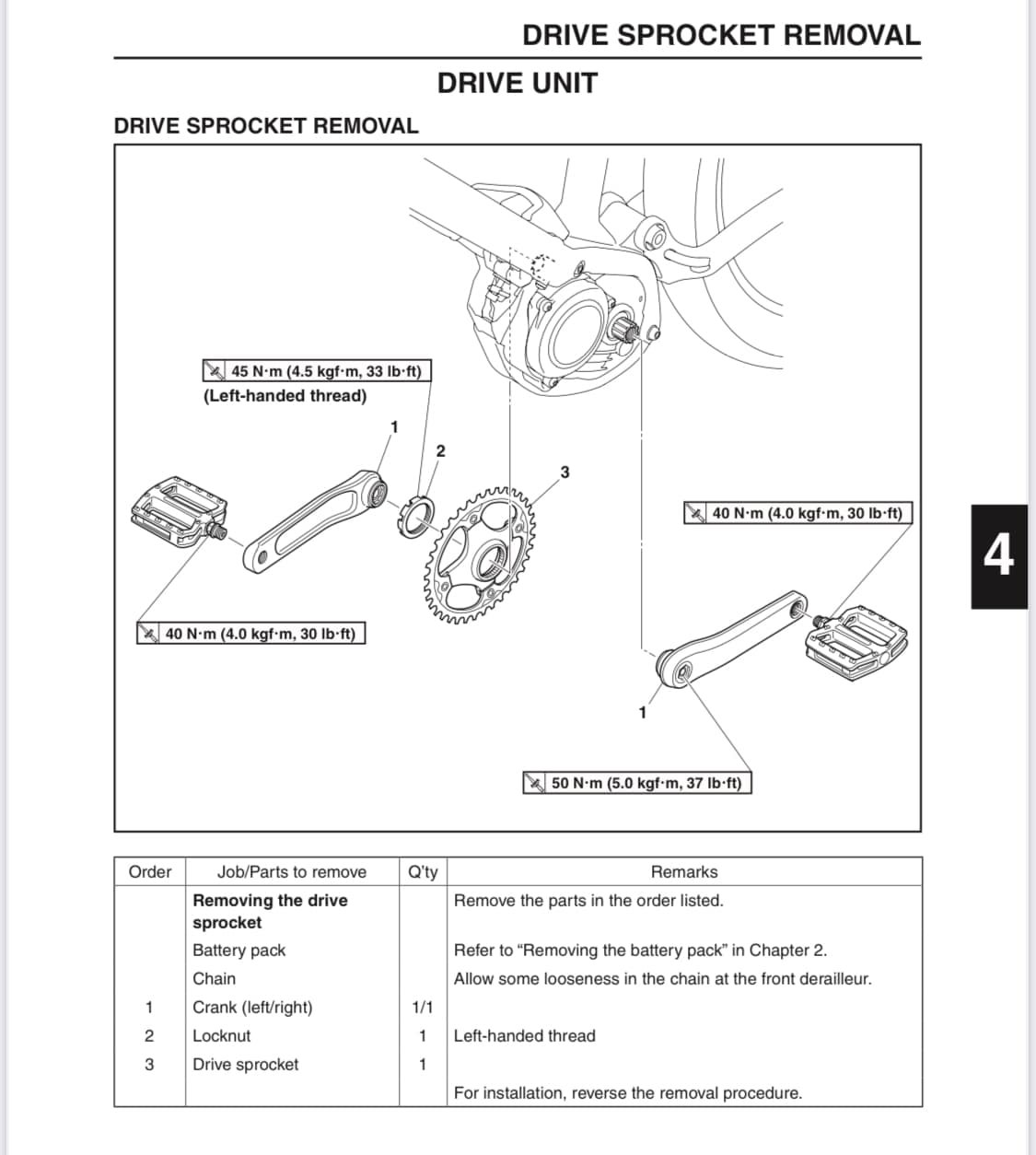

Actually that is also a really good idea, that is the one other piece I've had multiple failures. I can't speak to the current model, but my model had a derailleur attachment that seemed weak in design, and in practice snapped twice under minor incidents. I have since replaced with an sram eagle electronic drivetrain system and that thing has been absolutely bombproof. They likely upgraded in the current model, but picking up a spare is a really good idea of they have one. Ill see if I can dig up a photo of the part I'm talking about.

I went through alot of trial and error before I got the motor mounts on mine to stop loosening (I also had the PW-X2 on the original moro - yellow one). It was always the drive side. I replaced the bolts with regular hex bolts and tried blue loctite. That would not work. Eventually I had to pull the motor, clean the mounting surfaces from dirt and grease, and use orange loctite to get it to stop.

Same it has always been the drive side (fascinating that they use huge through bolts on the far side and tiny 6mm bolts on the drive side)
Great idea to clean the mounting surfaces, will have to try that, I’ve had the motor shift twice from major pedal strikes. were you able to find actual torque specs on those bolts? Even the links suggested earlier in this thread did not contain accurate specs (was for a different motor all together or something)
I never found good actual torque specs, but I probably over torqued them. lol I ran them TIGHT. The motor mounts on this thing are really funny. I’ve had to pull the motor twice due to cable routing and discovered they are odd. They have a sleeve that both bolts go into and the motor kinda “floats”. It’s odd but works.

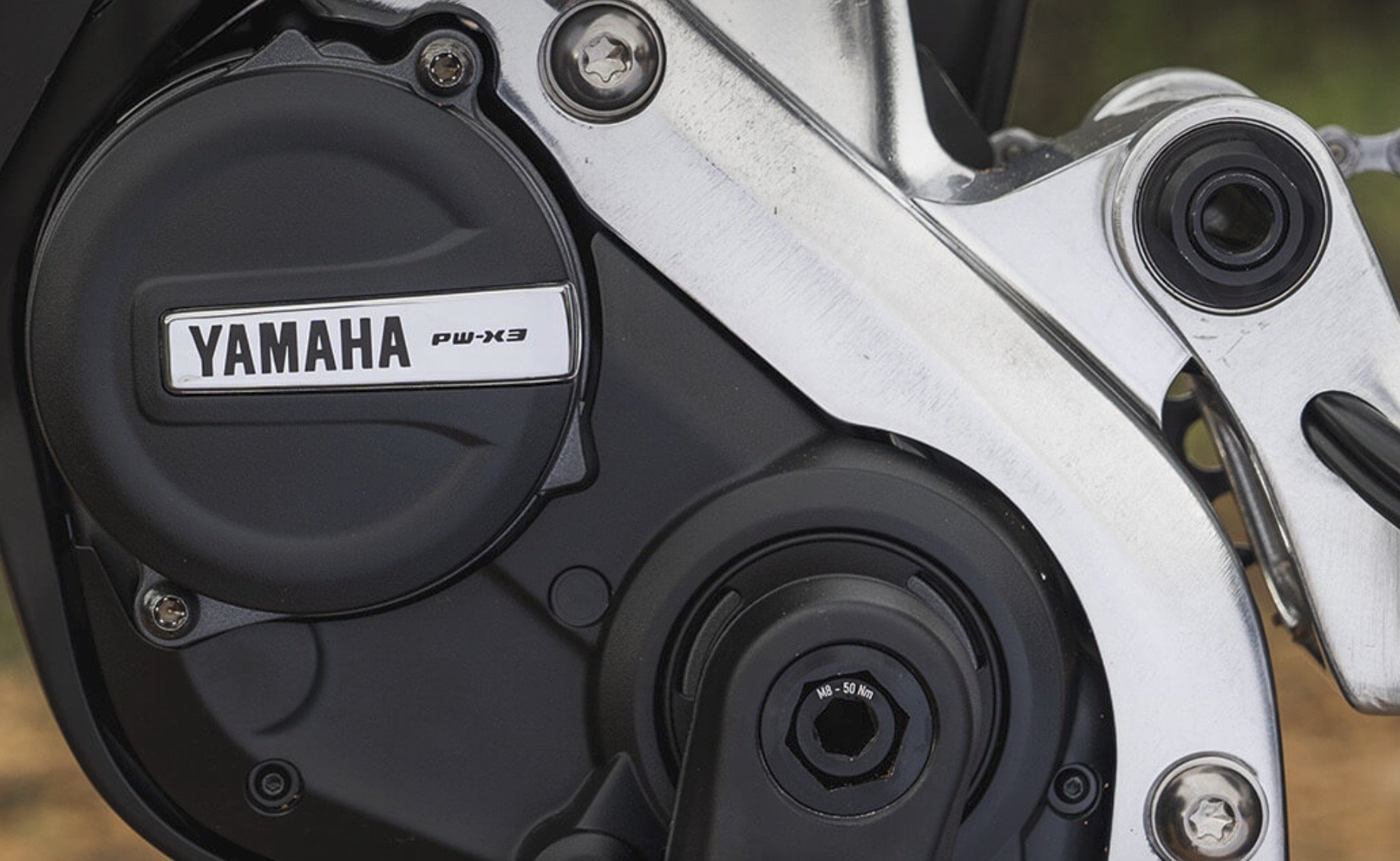

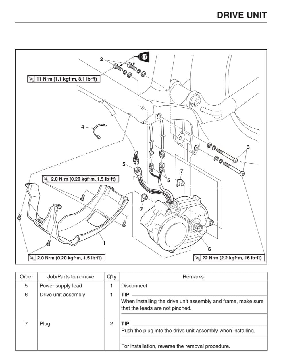

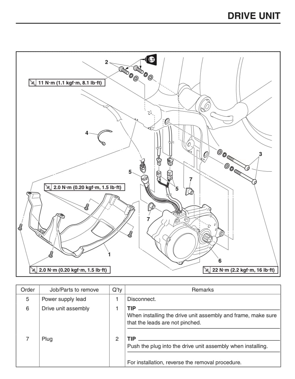

I am looking at the marketing photos and wonder if they didn't use the security torx for these photos, but ended up doing it on the release bikes. Thanks for letting me know--I almost picked up a kit of normal torx bits based off this picture alone.

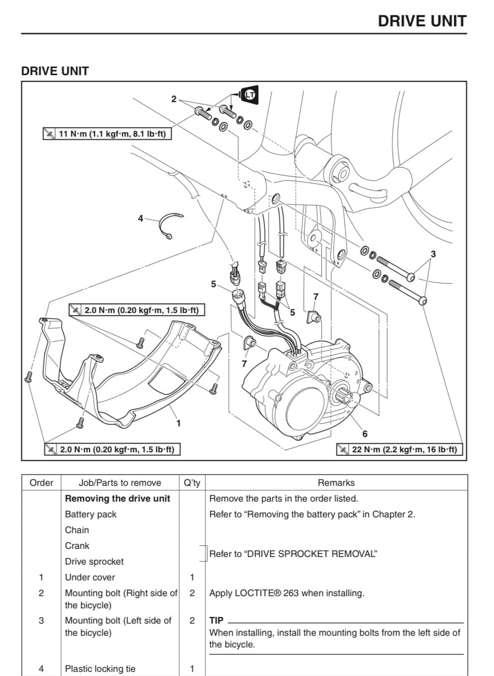

The actual torque for the long motor mt bolts are 22nm, the short bolts on the drive side are 11 nm. Don't use 22 nm on the drive side or they will sheer off. Completely remove each bolt and clean the old lock tight off. Blue lock tight and torque down the non drive side first.
Amazing, I torqued them at 20 & 10 just based on sizing of the bolts, pretty close 😂 thanks where did you find that?
