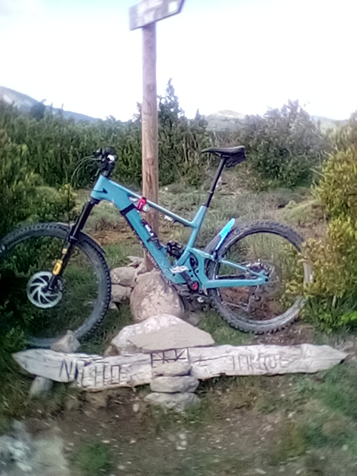

Bought a 4060 Z ST as I got a hot deal. 7k for the XT Model. Could've had a Bullit 29er S Kit for 8.3k, but with those cheap parts on the SC the scor is a steal..
Obviously they got rid of the well known Problems. Battery sits tight, no gap, chain can't rub the frame anymore - there's a tiny piece that looks like its some sort of metal/Aluminium.
I tested sizes M and L (I'm ~1.78m/5ft10) and went for the longer frame. Still handles pretty nimble and stays calm at higher speeds. Not as capable as a Kenevo or so but Way more versatile and fun..
So far, I'm happy with it. Feels lighter than it is..

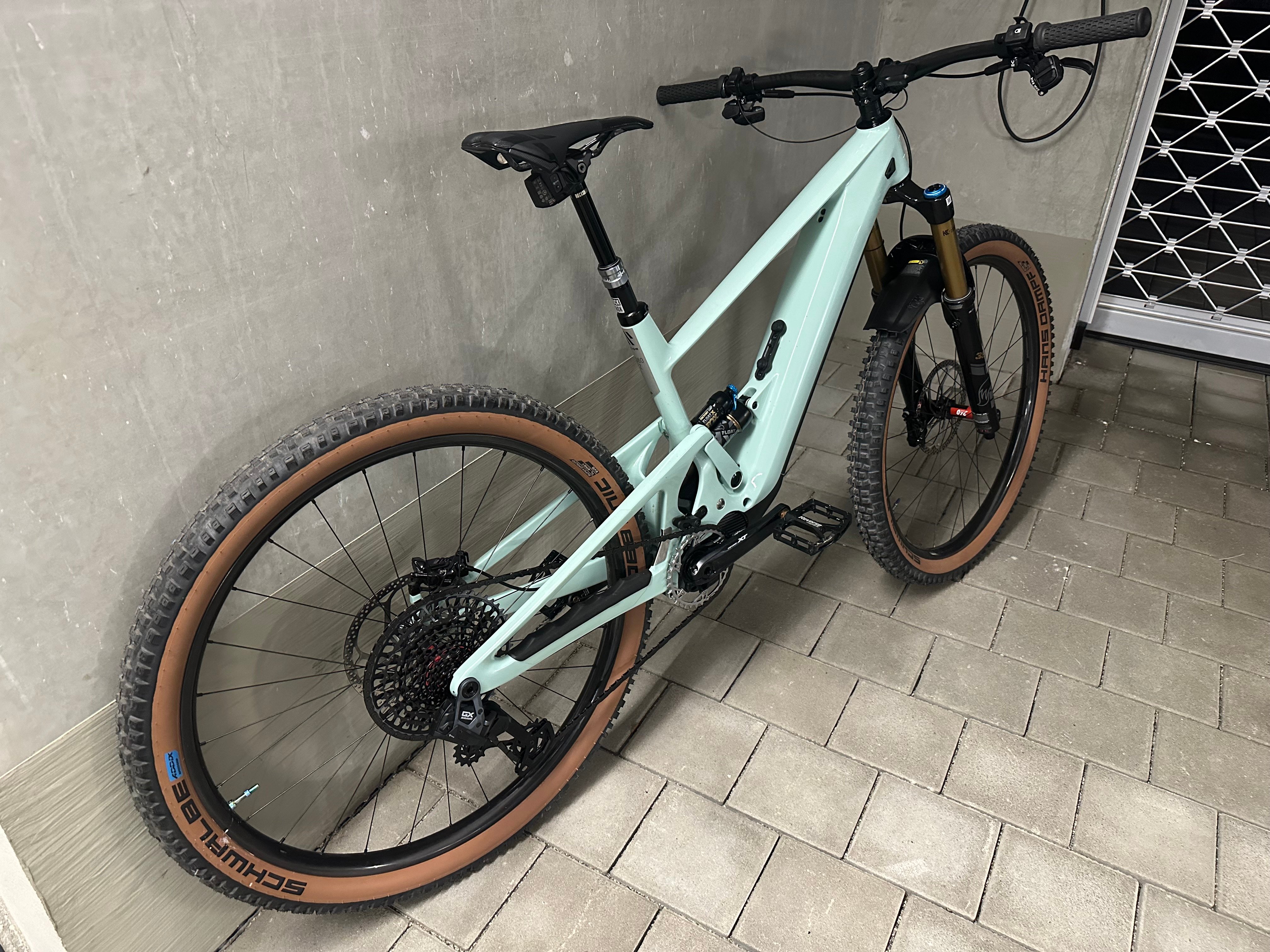

Great looking rig! I am considering one of these; the purple LT XT version. Currently on a Bosch equipped Cube Stereo Hybrid 160R, which has been bullet proof, and have zero experience with Shimano EP8. Have you had any issues with the powertrain / drivetrain at all? Any issues with the frame or suspension at all?
LautSprecher
Jun 2, 2024
71
62
Got her ready last Thursday. Now she has already 180km on the clock. Beautiful riding and very playful bike!
If you like the EP8 + 720 I’ll highly recommend it.

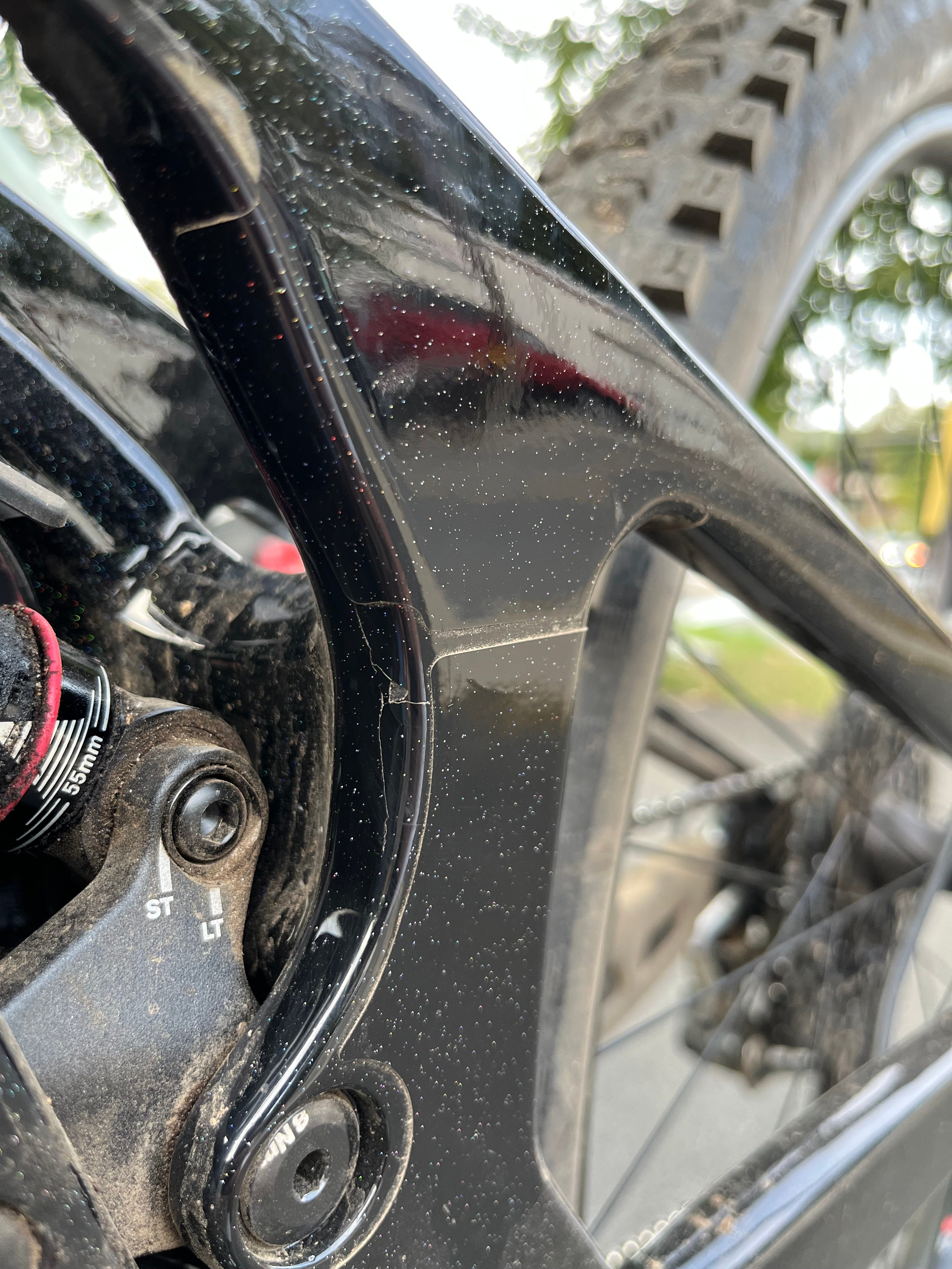

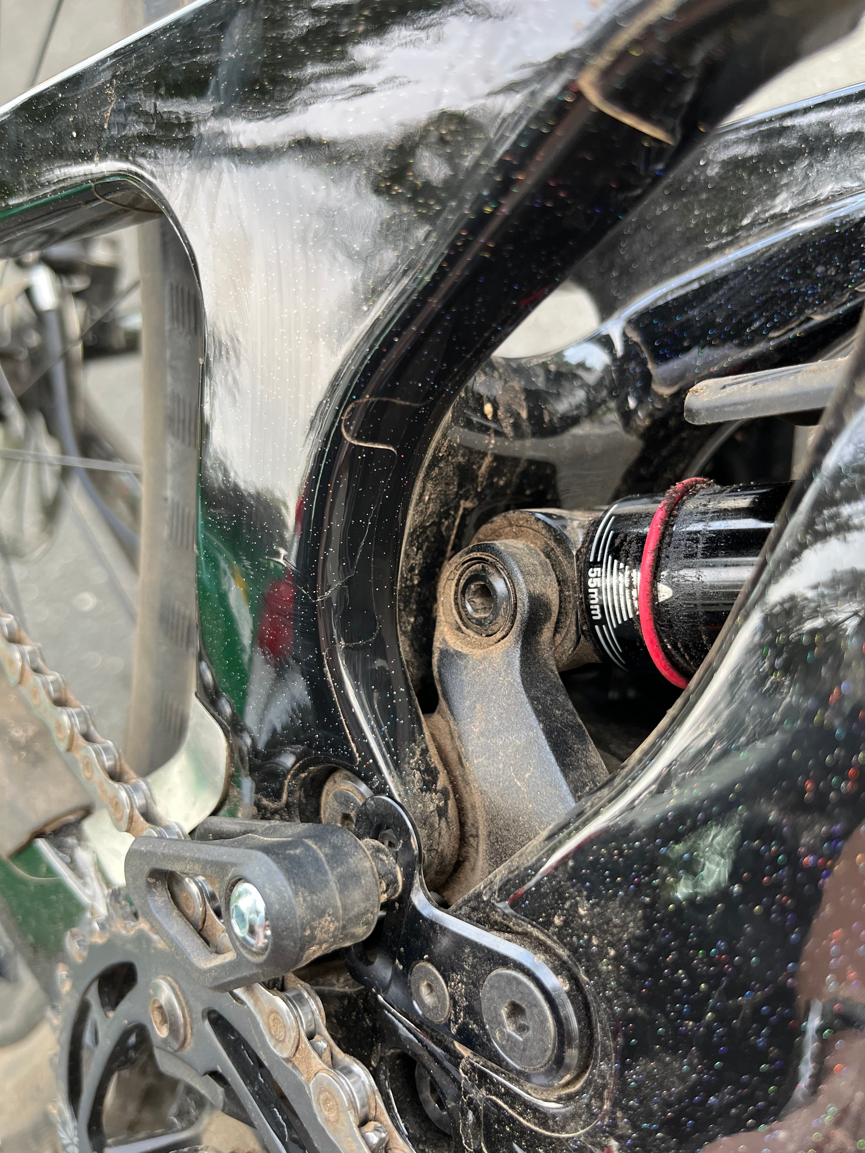

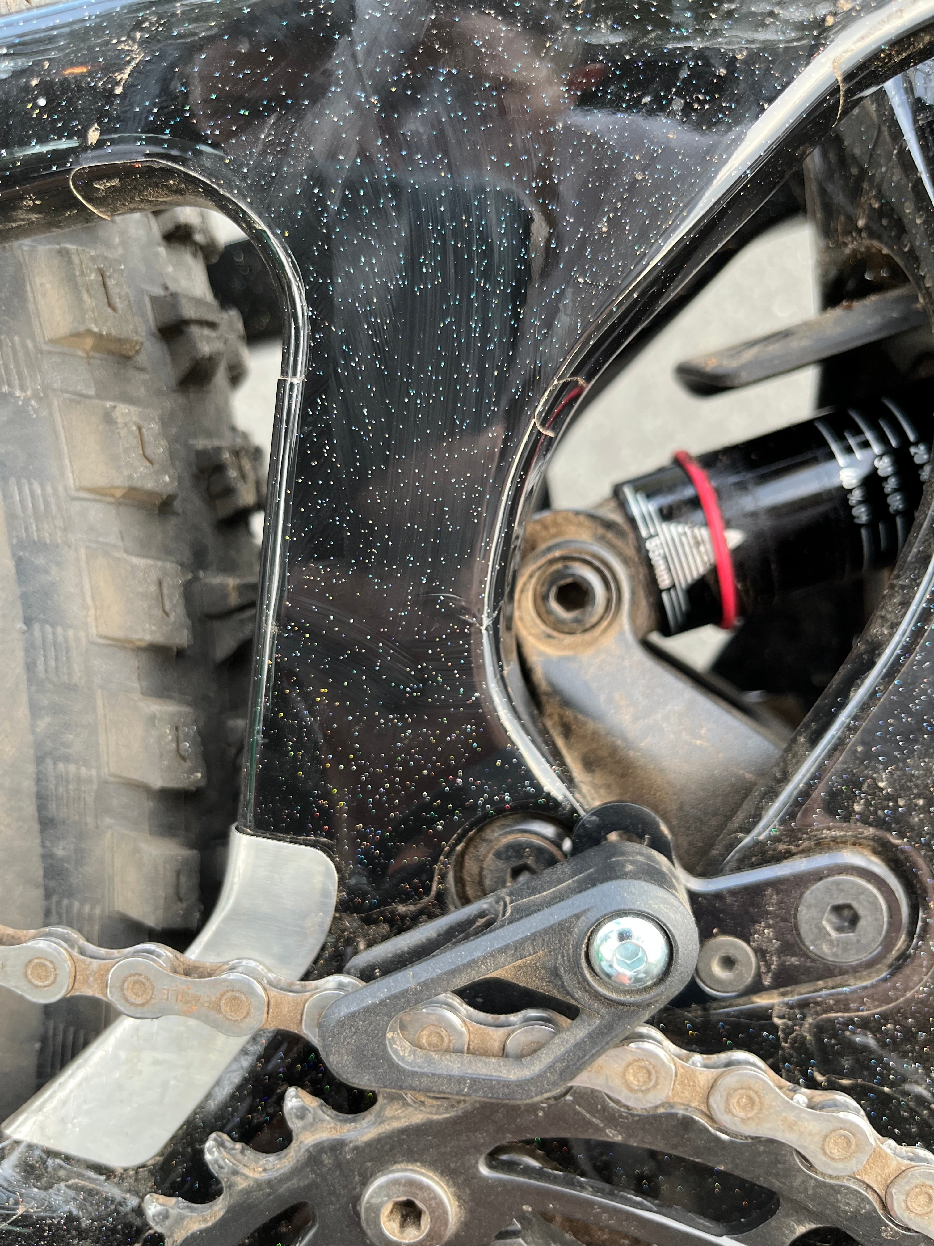

Rear wheel Hub Knock/Play issue:
Less than 10 rides into owning the bike the rear hub developed play. Removed and re-tightened the thru axle, to proper torque, to see if that was the issue. No change. Removed the wheel and loosened the hub end caps on drive, non drive side and lock nut then re-tightened so the bearings flowed smooth and that did not work to remove play. It took me a fair bit of research to find out the producer of the XDH 130 wheel set. Nothing comes up online. Thought it was Novatec based on the naming convention. Messaged Novatec and they said it wasn't them. Once I got the free hub off, I could see it had a "Xero" drive side bearing. This gave it away that it was a Formula Hub/whee lset. My best guess is that it's a DHT 1481 hub based on it's appearance and other web forum reports. It seems to be the exact same hub that Specialized uses on their entry level Roval Traverse EMTB wheel set. The rear hubs are known for developing play and knocking . What was interesting is the drive side bearing felt rough when I spun it, with my finger, still in the shell with the free hub body off.
The bike shop suggested replacing the bearing to see if that would fix the issue. Had an Enduro Bearing installed. The mechanic commented that the stock bearing once removed spun smoothly. This suggests it may have been not seated properly or poor sizing. Having the Enduro bearing pressed in seems to have fixed the play issue. My assumption is that the OEM bearing was either poorly installed, hence the roughness, and it didn't allow proper tolerance with the axle or the new bearing is better quality/size and is a tighter interface for the axle.
I will give credit that the 32 spoke build and rim have been reasonably tough up against the extremely rocking terrain here in Southern AZ.
I had this exact same issue with the 4060 Z ST SLX. Pulled it apart and sure enough the drive side bearing feels like it's packed with gravel and the rest are buttery smooth. Gonna order an enduro replacement and we'll see if that fixes the issue. Have you had any issues with yours since the replacement? I also notice a lot of pawl skip with these hubs, have you experienced this as well?
