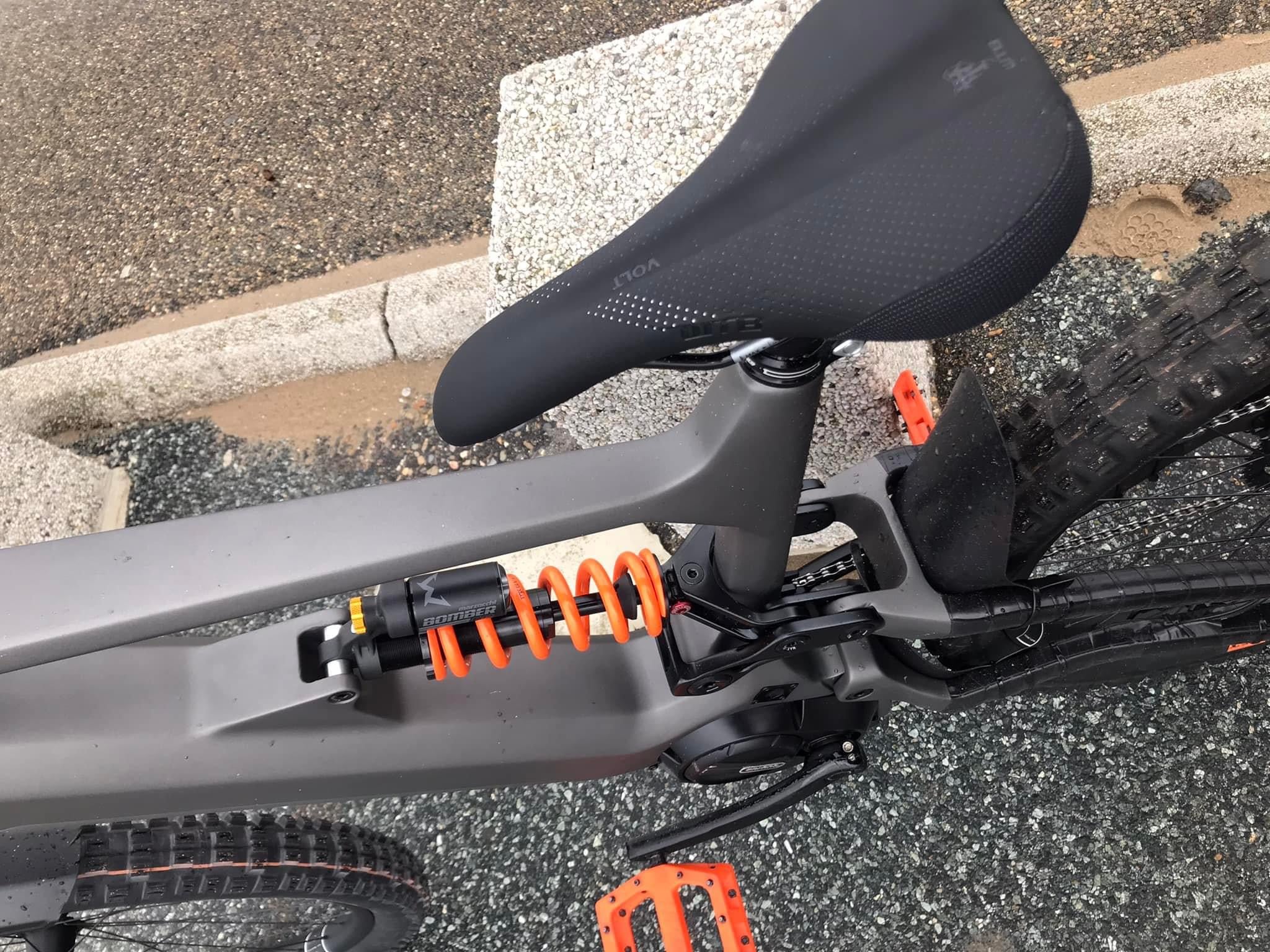

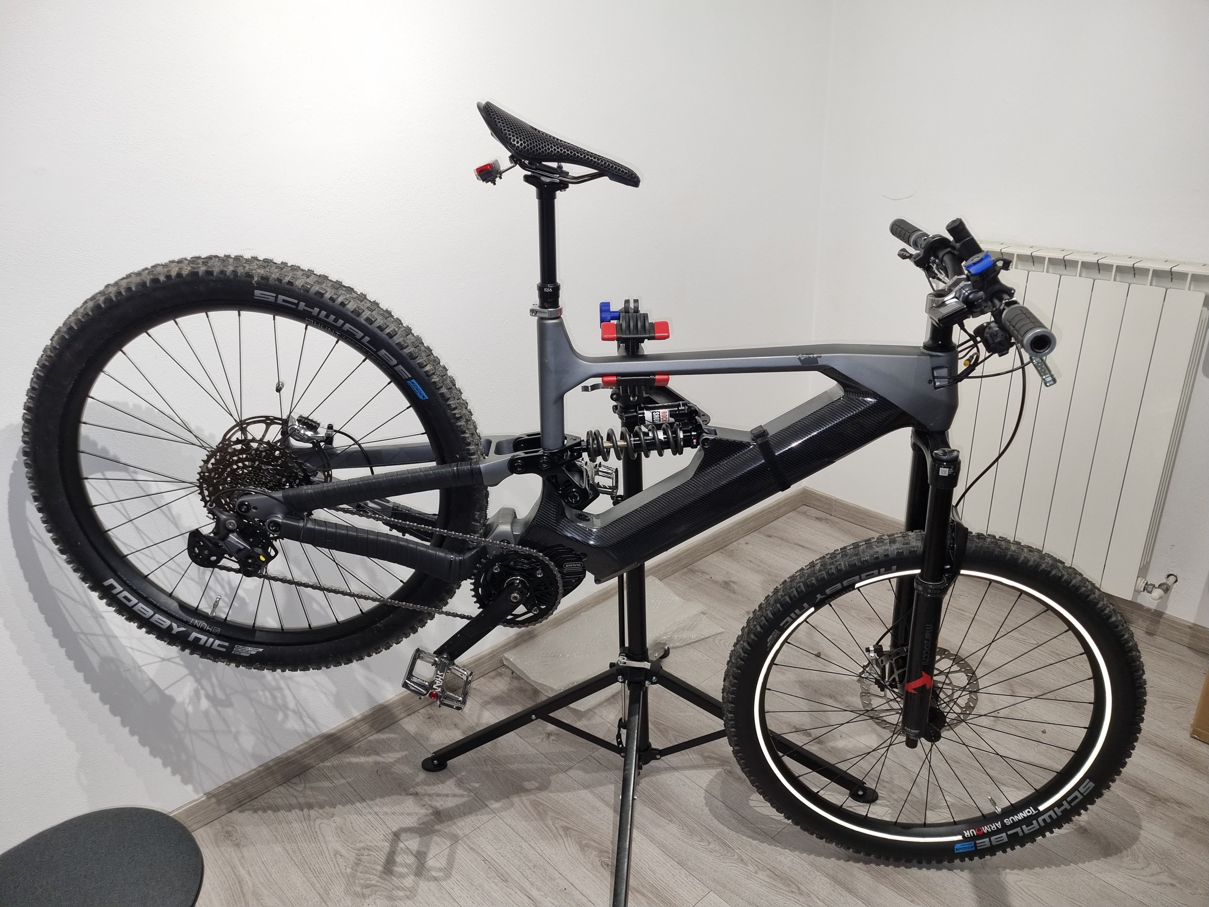

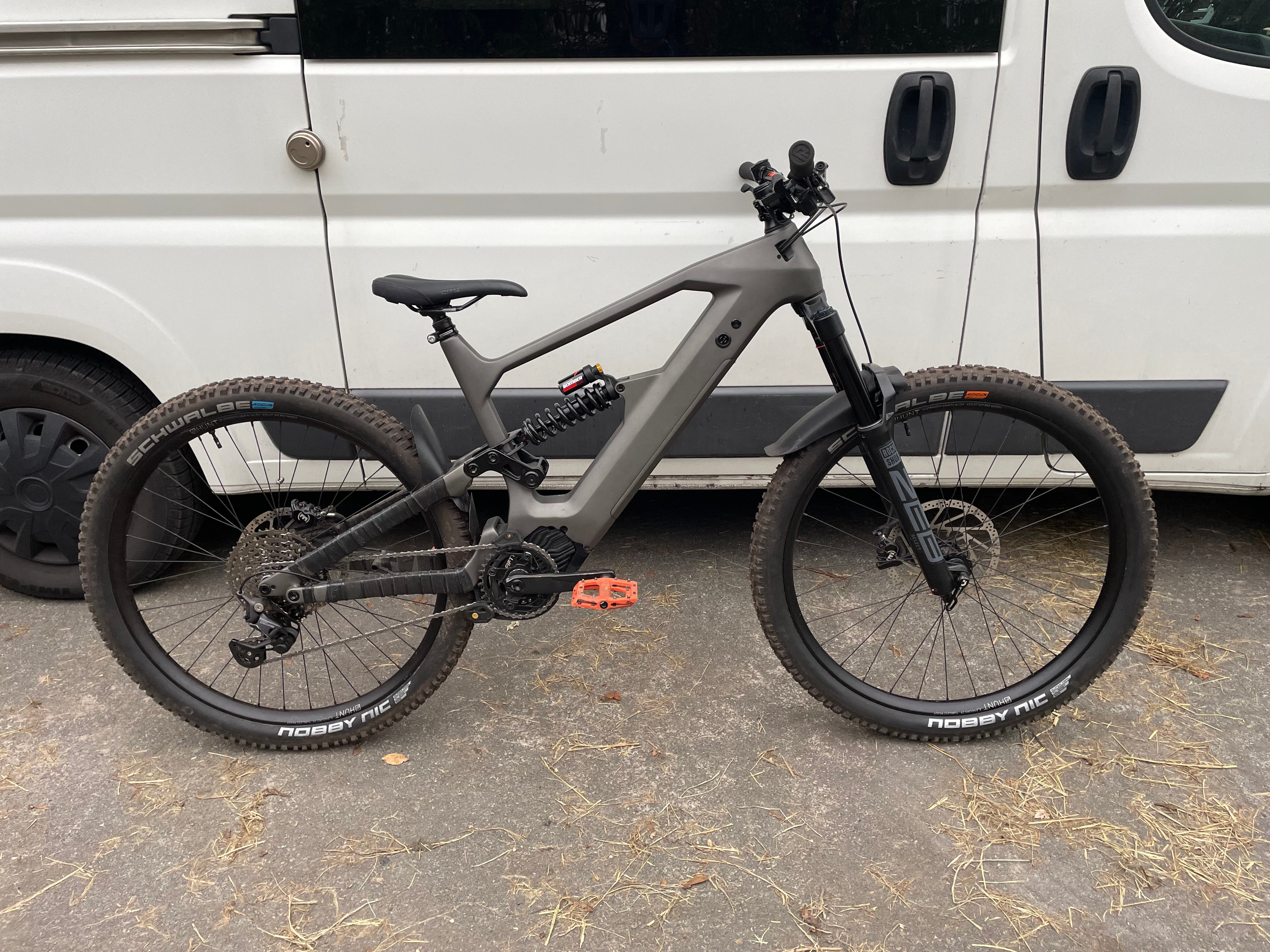

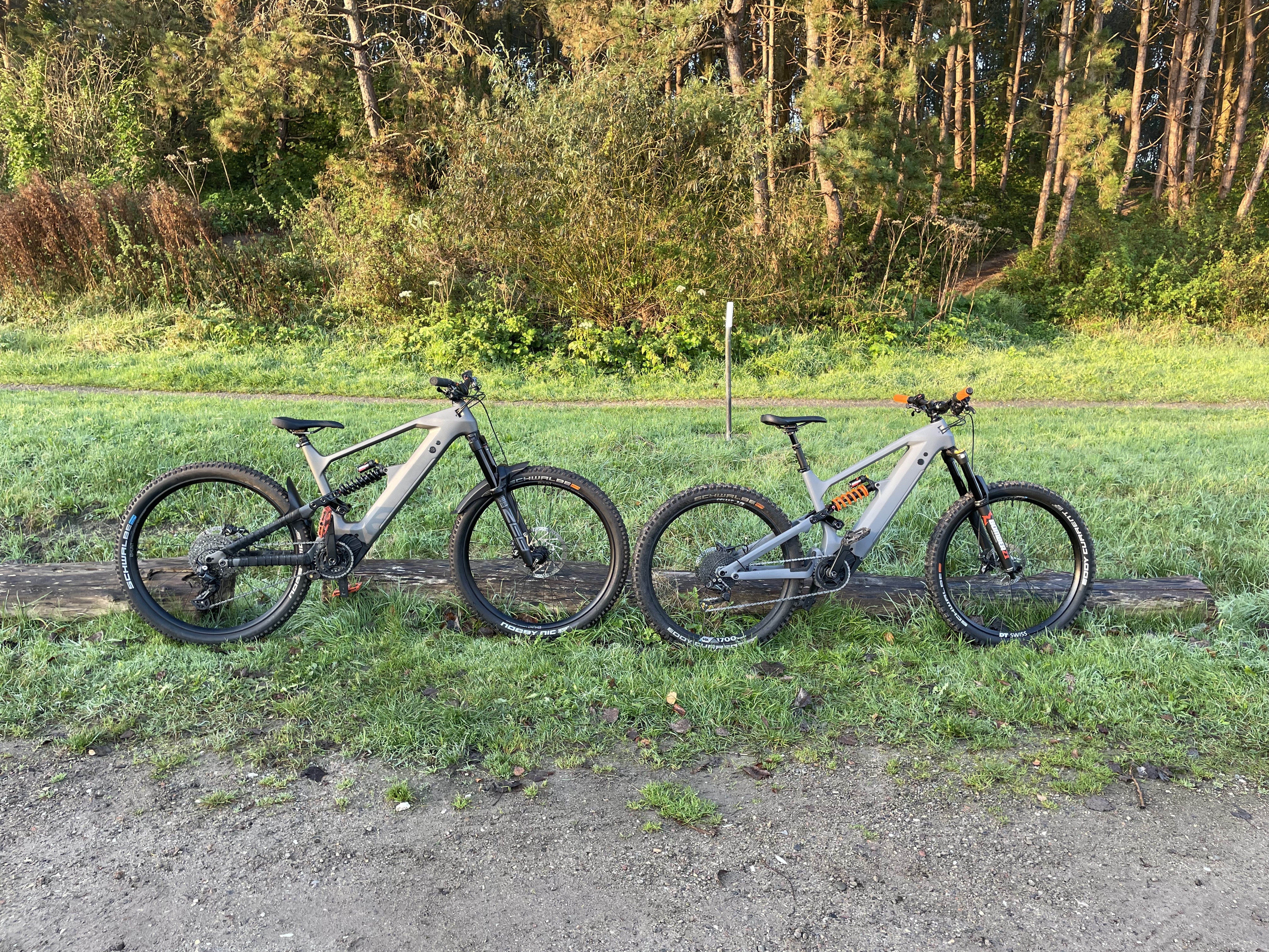

She's ready! Some minor things must be done, but it's 99% done. I used a cheap "carbon fiber" vinyl to cover the paint damage:
Before:
Also, when removing the old paint protection film, some of the paint peeled off. How ironic!
After:
I used an inner tube to cover the damage on the chainstay and seat stay.
Before:
The paint has seen better days:
After:
Me fixing the paint damage:

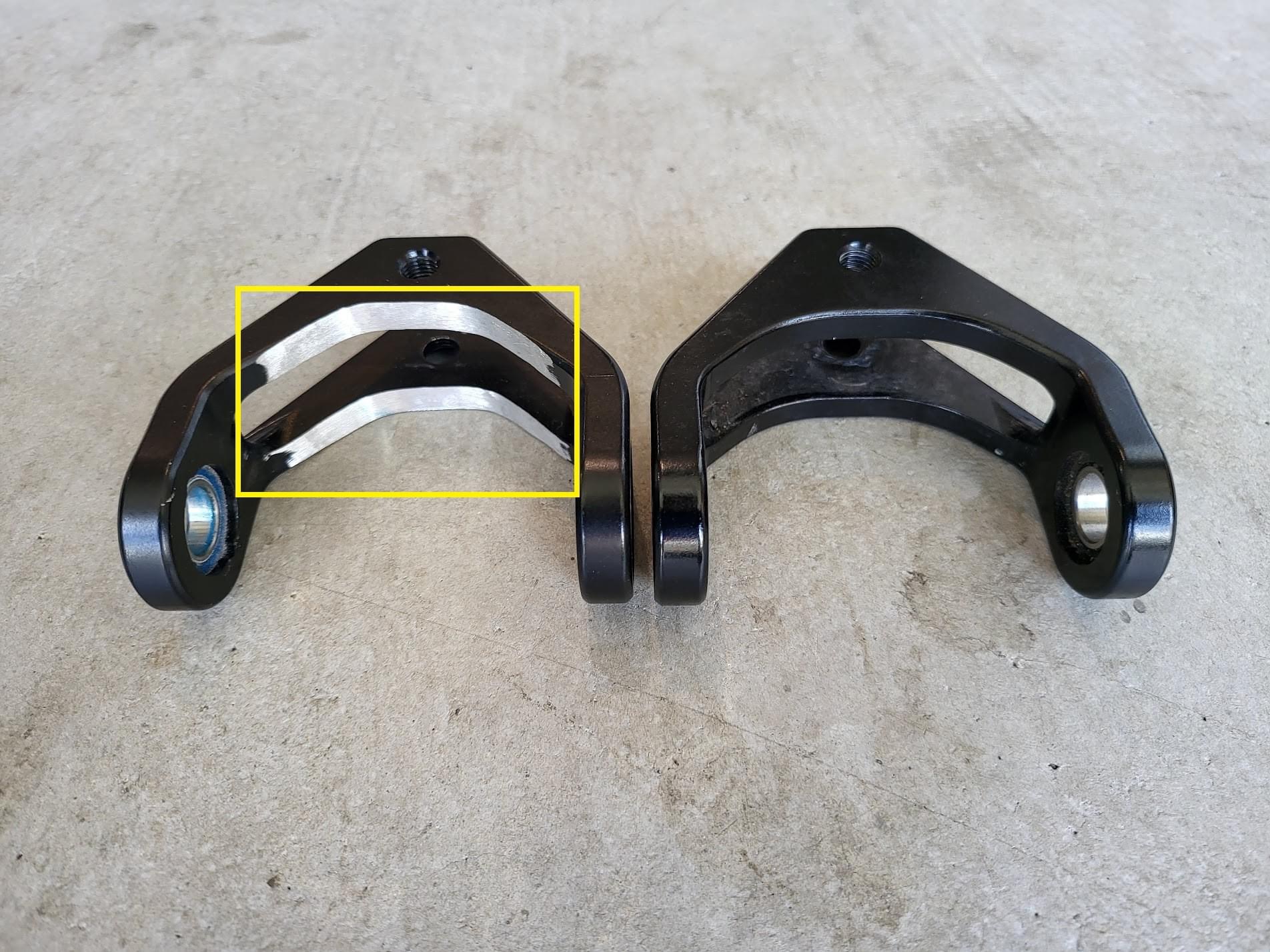

I filed 2mm of material off the yoke.

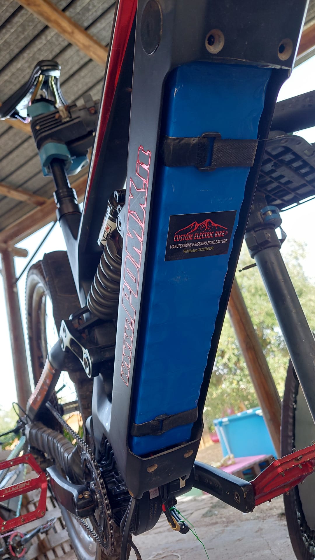

Custom battery. LG cells, 960Wh made by Custom Electric Bike, Italy:
I'm using a XT90S antispark connector.
Piece of plastic from a Coca Cola bottle to shield the battery connections from dirt:
I noticed that there is a German seller on eBay selling a 1200Wh battery for the same price as mine. Unfortunately, I only found this out after I got mine. But Andrea from Custom Electric Bike is a really nice guy. We even had a 30 min phone call where he answered all my questions. And he offers a 1 year warranty, so I'm happy with my purchase.

Total weight: 27,5 kg.
