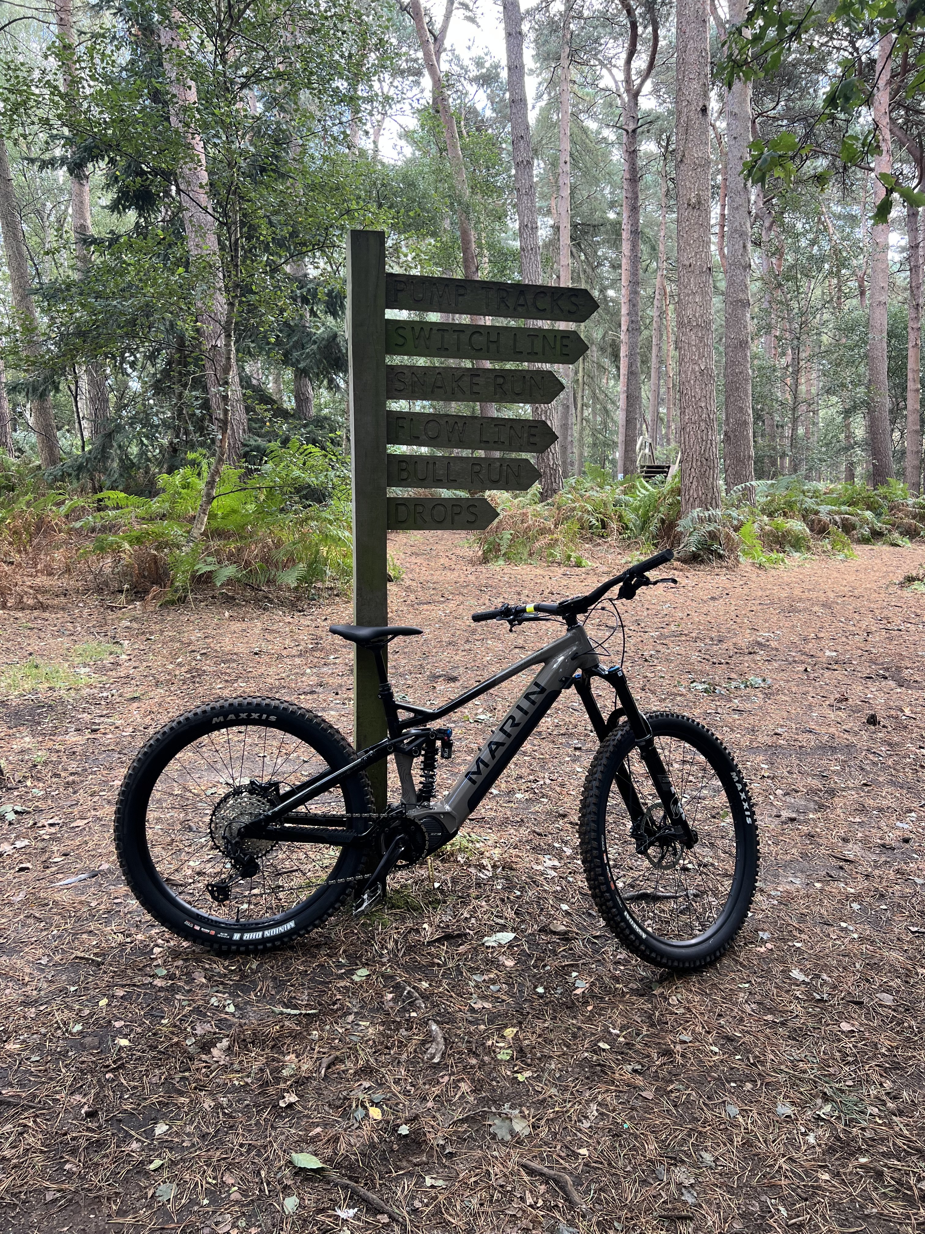

Just got a great deal on an Alpine Trail E2. First impressions are great. Friendly/stable playful and build quality appears great. Looking forwards to getting many more miles under my belt
