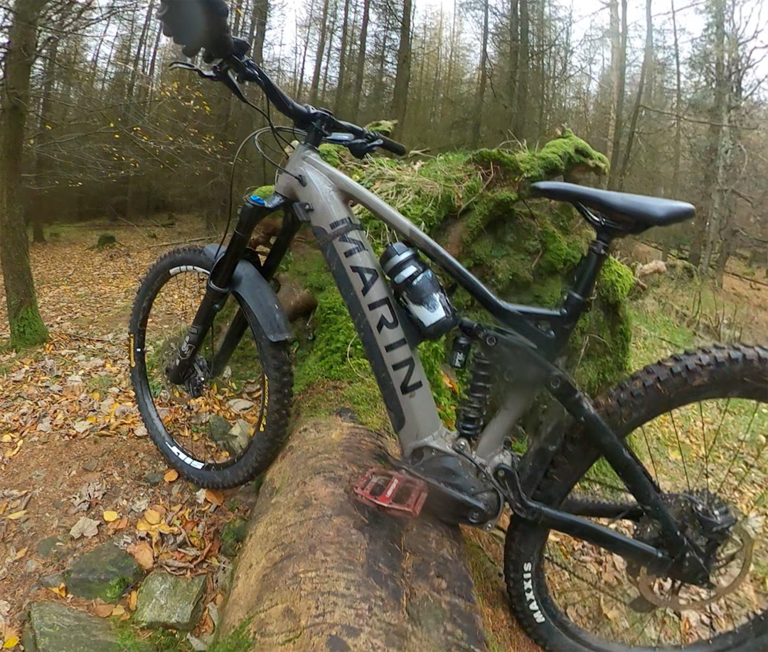

Anyone find these weapons sit very low?
Is it just me and my lack of speed and technique?
Every time i ride it I smack the pedals or the motor or chain ring. In this pic I got off on the approach as I knew what would happen if I tried to ride it.

Thatā€™s one of the reasons why I went with a 170mm fork and 29ā€ wheel on the rear.
Yep, I did exactly the same. And also went down to a 36 tooth chainring.
Has reduced the number of pedal strikes and motor / chainring hits to virtually zero.
I always thought the 38 tooth chainring was a bit of an odd choice but in real use it has not been the grind I initially thought it would be. I will change it when worn out though.

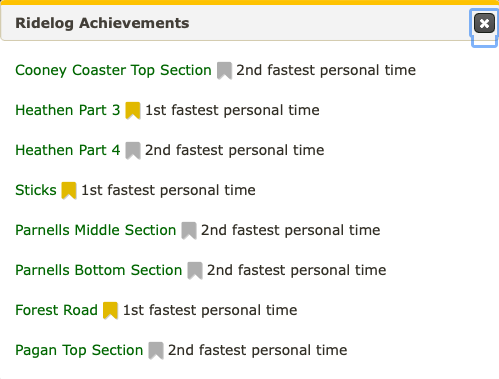

Had my first spin today on the E2 in full 29er mode. Too early to tell if it means reduced pedal strikes, but I don't recall any so the early signs are good. I had some good personal results too so perhaps it also rolls faster as a 29er though it could just be the weight saving from not running the Marin Wheels and the Cushcore inserts.

I'm now three rides in on the E2 as a full 29er and for sure there is way less pedal strikes than in the mullet setup. How can a couple of mm make such a difference?

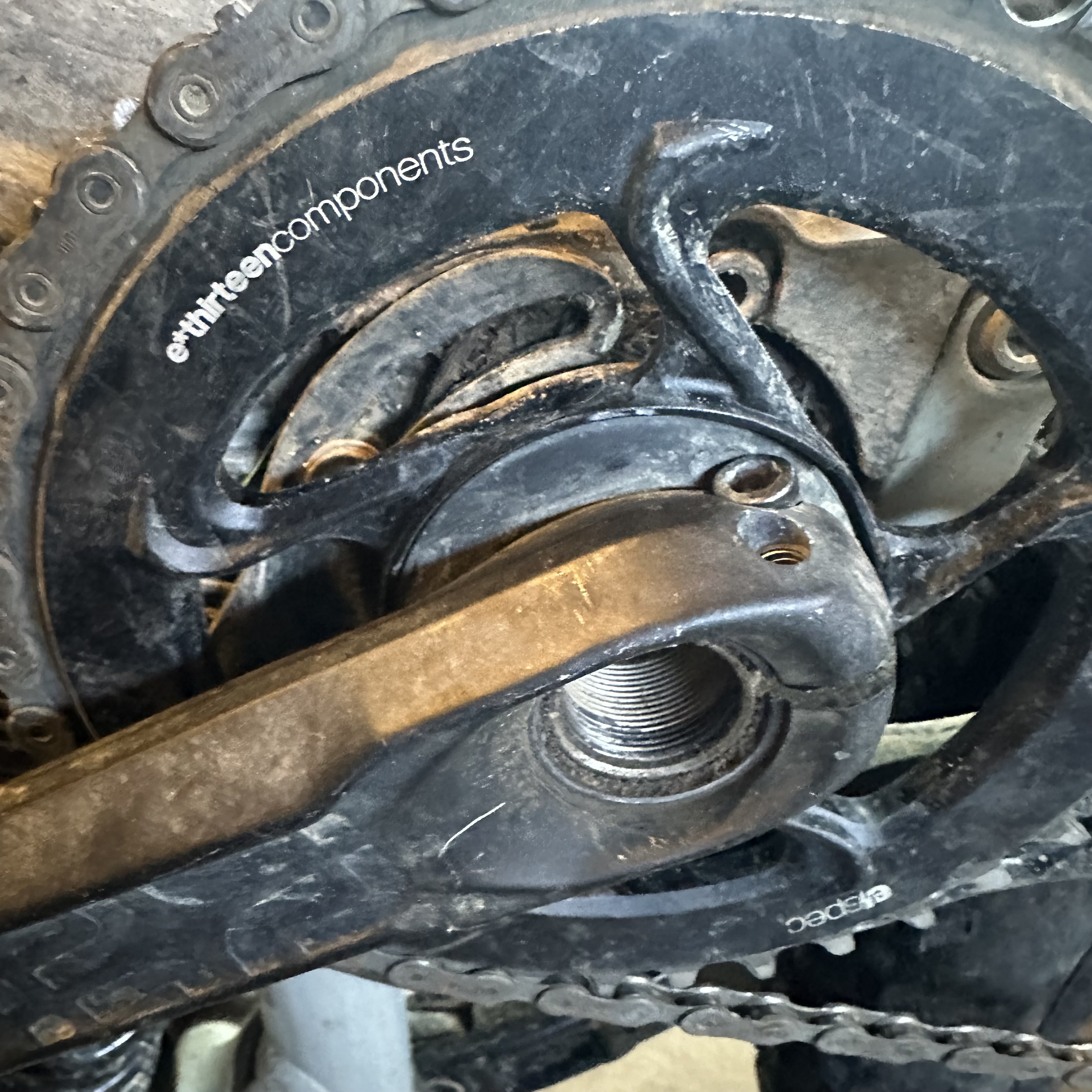

Has anyone removed the e13 Espec cranks so that they can remove the motor?
I did it in the past but now Iā€™m trying to do it again and i think im missing a step or something is stuck.
I got the crank arm off in the non-drive side but I canā€™t get the drive side crank off. I took off the dust cover and loosened both crank arm bolts. The crank arm feels a little loose but wonā€™t move away from the chainring.
Iā€™m not much of a mechanic but I have a little experience with bikesā€¦.
Thanks for any help.
