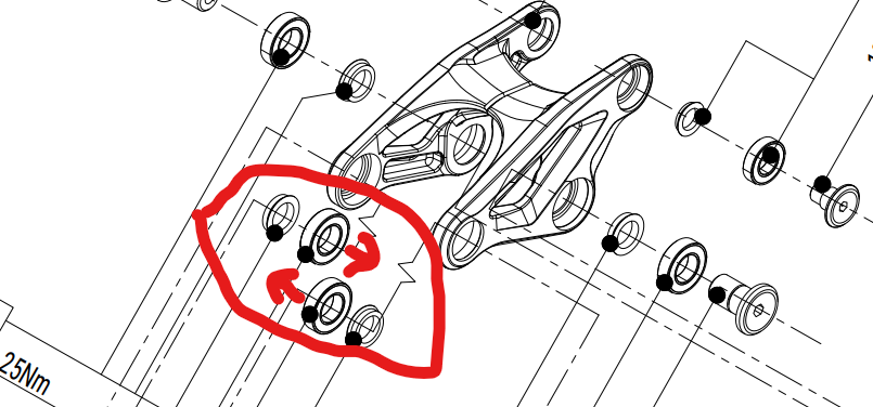

Has anyone tried changing the rocker bearings? I'm not quite sure how to get the bearing out as there's a plastic / cheap metal spacer on the 'blind' side (outside) of the bearing. I'd use a blind bearing puller, but the other side of the rocker is in the way as the bearings need to come out in the direction of the arrow. I suppose I could just press the spacer which will in turn press the bearing, but the spacer doesn't seem that it'll be strong enough. Any Ideas?
Just stripped my suspension down and when the extractor and press kits turn up I’ll be doing exactly what you’ve mentioned, I’m also concerned that those spacers look a bit fragile and hope that pressing them out won’t destroy them🤞🏻
Out of interest, what extractor and press kit did you go for - I had a look but couldn't work out what I needed, so was just going to use the stud / washer / socket ghetto version.
And I'll be interested to hear how you go with getting those bearings out.
Hi mate, I went with the RRP Bearing Press Kits 7 and 11. They’re a bit pricey but I’ll likely be doing the job again(defo won’t be leaving it nearly 2 years again!) so I don’t mind, plus I’ve got 2 mates with E2’s who’ll be needing to do theirs sooner than later especially as we bought our bikes within months of each other!
I didn’t buy the actual RRP press cos it was nearly £70, nicely made but I can do the same job with a piece of M8 all thread and a couple of nuts and washers! Haven’t had time to do the job yet but should have it done this weekend.

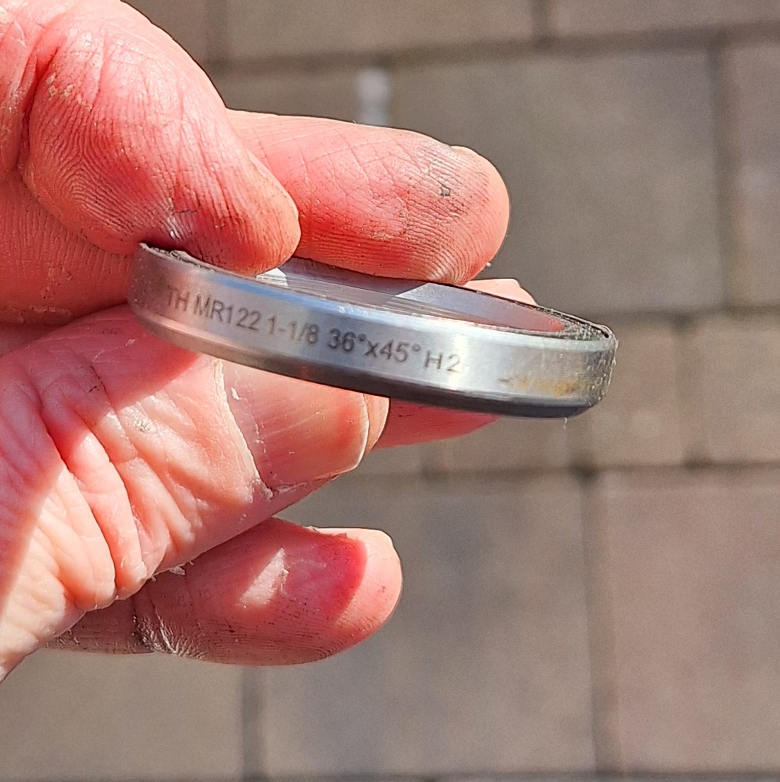

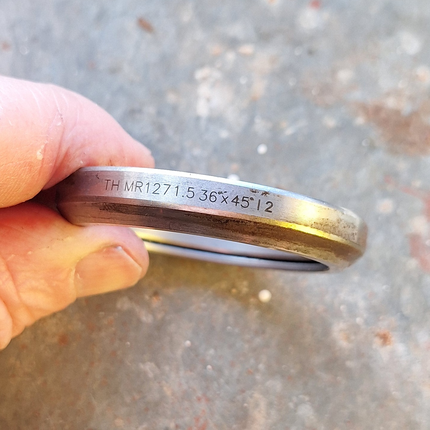

Is the upper and lower headset bearing race and balls or sealed cartridge? If cartridge does anyone know the bearing codes? Quite some creaking out of mine today, need to pull the fork out and investigate
mxh
Aug 27, 2018
117
52
They're sealed - although you can always remove the seal with a pick, clean and regrease
.But whilst the bearings might need replacing, I often have to remove the fork and re-grease everything - the bearings are fine, but there's lots of interfaces in there which can dry up and cause creaks.
