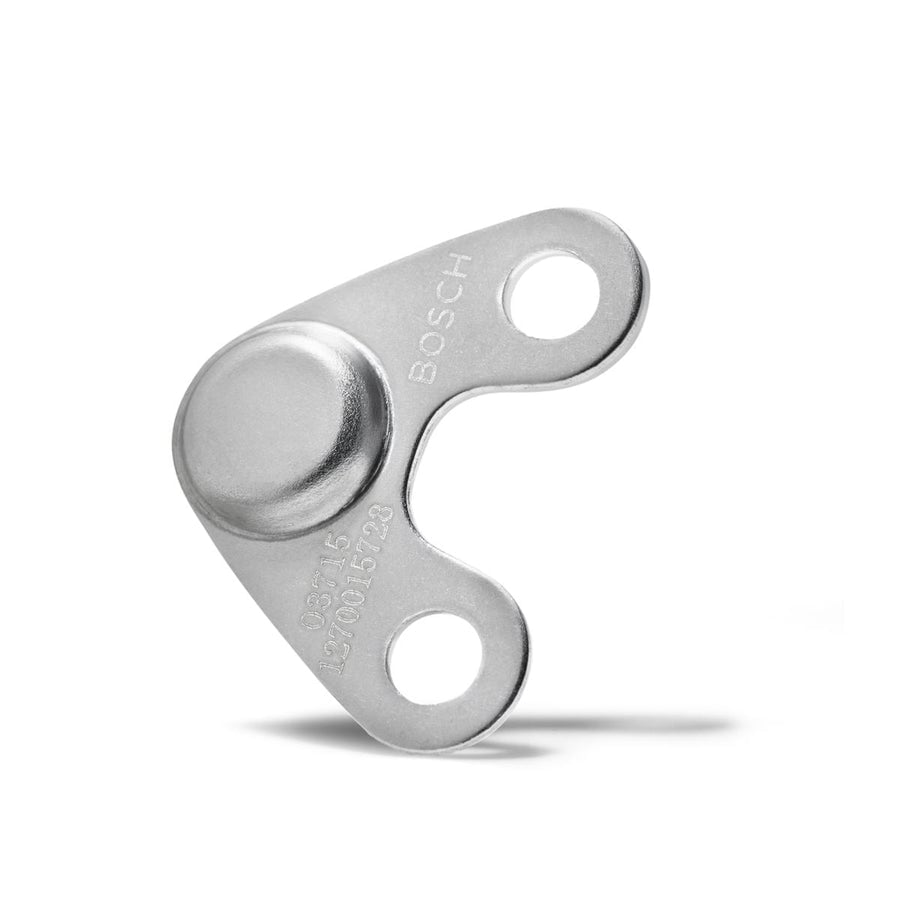

Anyone used a 6 bolt disc on their rear wheel? I want to have a 2nd set of wheels with faster tyres for commuting, I've only got ones with 6 bolt hubs. I've seen a few magnets that bolt onto the disc, but not sure how touchy the speed sensor will be on the ep801 system.
Cleggy
Aug 11, 2023
220
222
Northern Ireland
Replying as I too want a definitive answer to this.
Galfer do list this as Shimano compatible
iadmtb
Jan 23, 2023
53
32
Thousand Oaks, CA
I have a 6 bolt on my rear, both on the 27.5 and 29” rear wheel setup on the E2. Used a Bosch magnet and the Specialized magnet that came on my turbo Levo and both magnets worked perfectly. I actually preferred the specialized magnet because it sat “flush” against the rotor.
iadmtb
Jan 23, 2023
53
32
Thousand Oaks, CA
Looking at that Galfer link, the first magnet and second magnet would work. The specialized magnet that I’m using looks similar the second magnet. I would go for the first magnet just in case.
