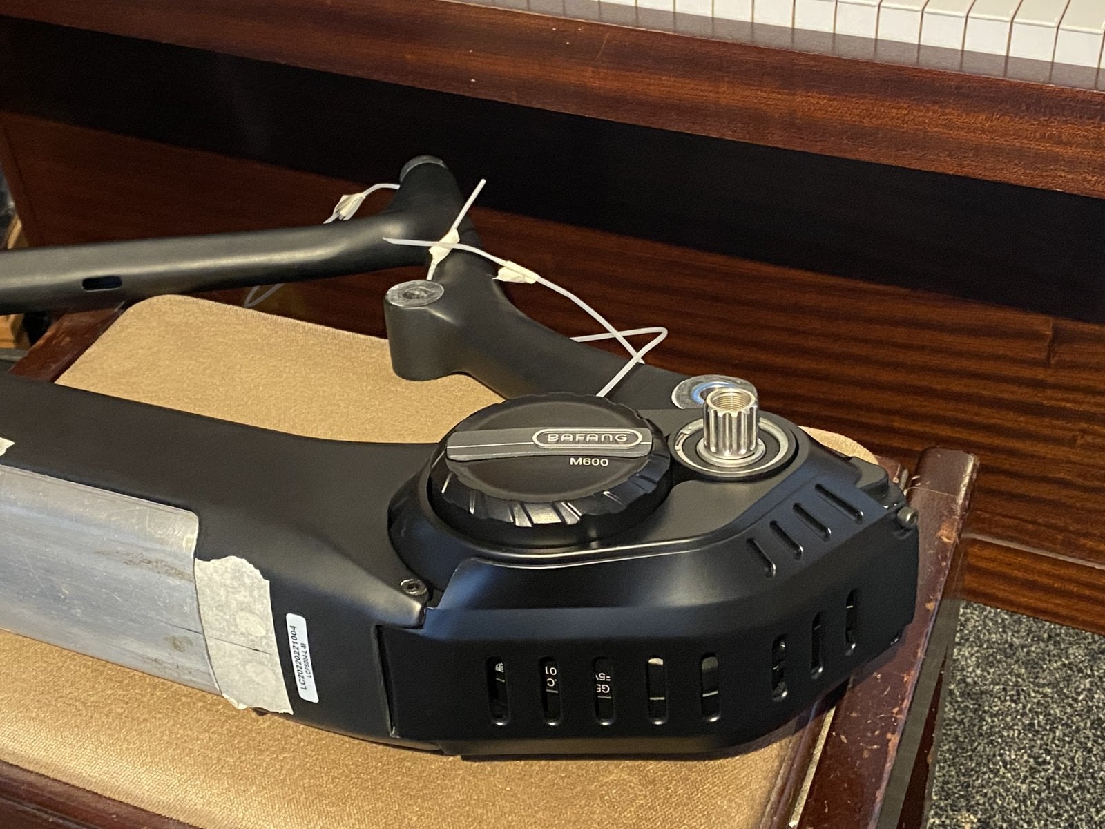

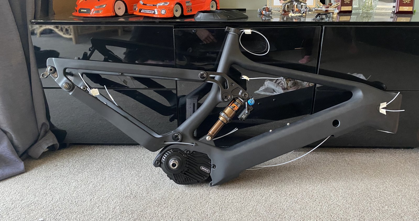

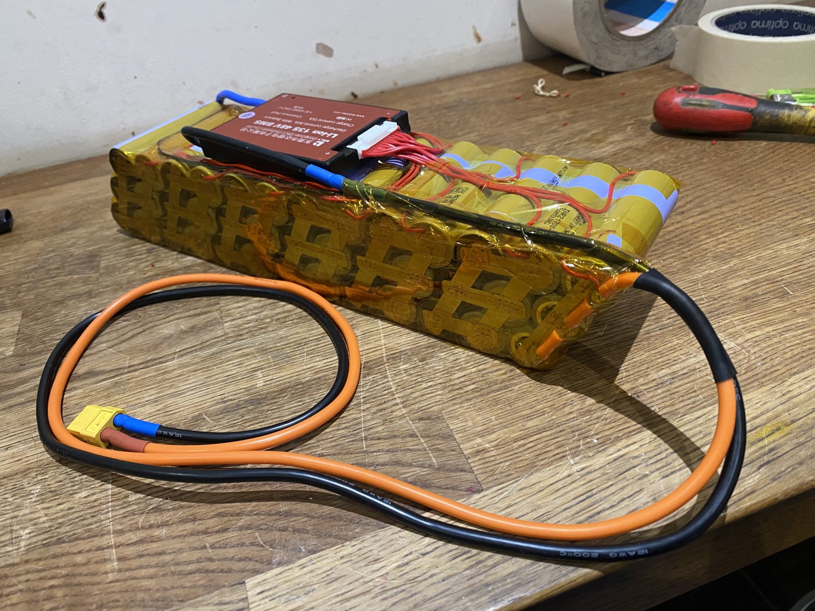

I’ve just started my build 🥳

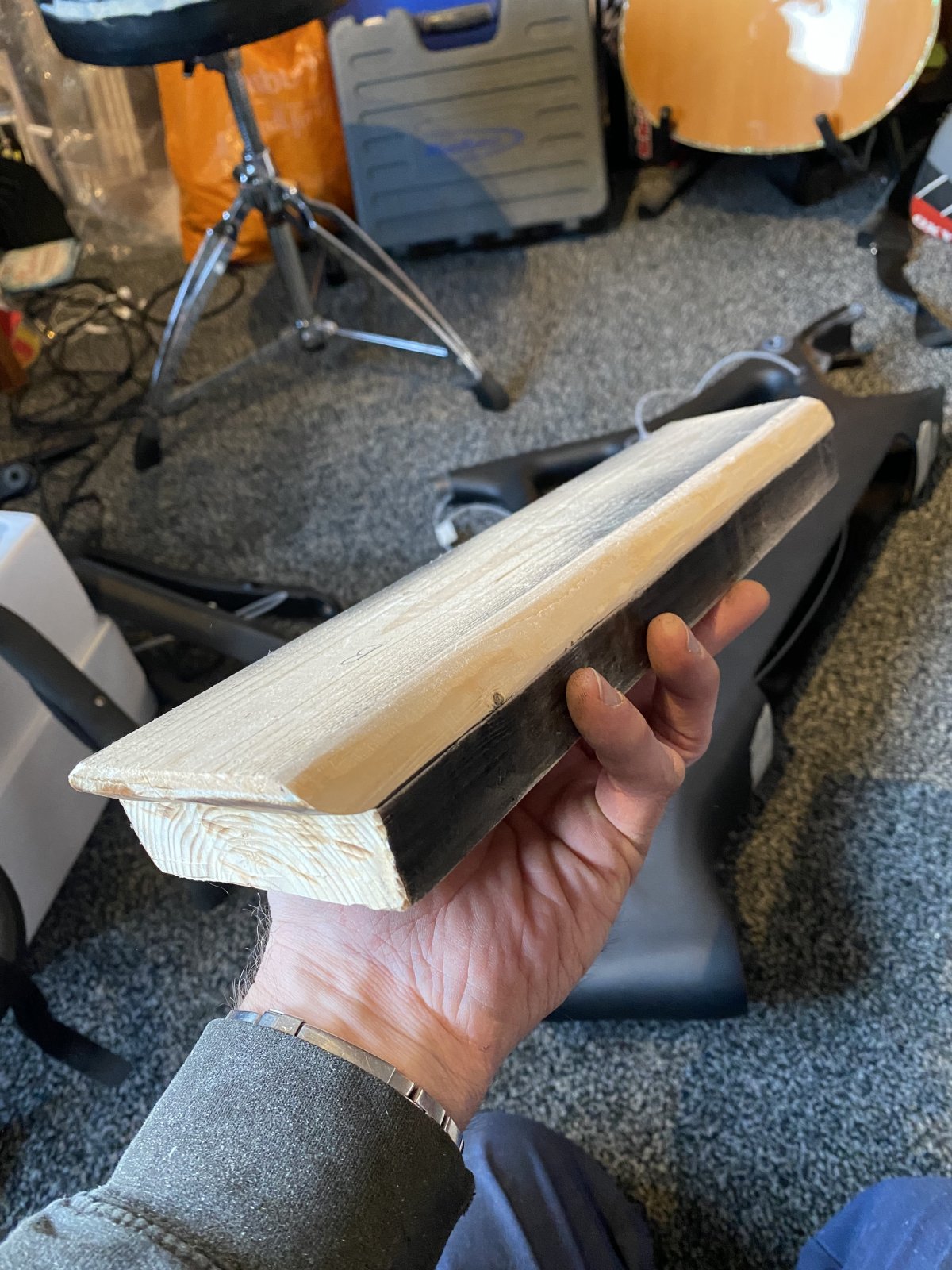

Hopefully get the battery cover finished this weekend just the brackets to make and Tig on. Also starting on the battery build tomorrow 🙂
“Lovely frame” let down by having to make a battery cover it would be soooo easy for Lightcarbon to manufacturer one for us battery builders
Well done with the battery cover. 👍🏻
I ended up buying a separate cover from a btf03 battery. I’m using that instead.

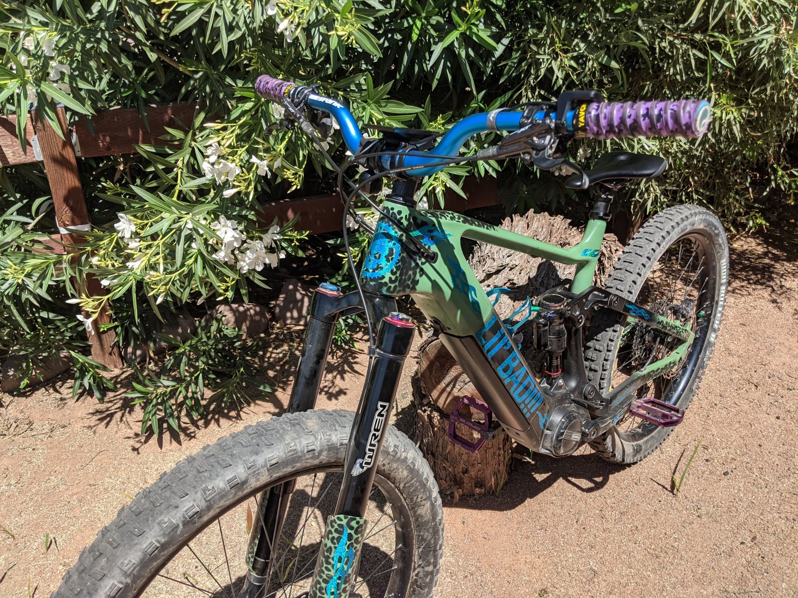

Wow what a unique bike! What are those handlebars please??
TCFlowClyde
Feb 26, 2022
1,396
916
Mesa, AZ
cpc&utm_source=google&utm_campaign=Google%20Shopping&gclid=Cj0KCQjwjN-SBhCkARIsACsrBz5HY3ikPkuhHUUsRCZmJTOpnmdShjskgGc8-E57bOLPQP5OYHXfe2oaAnHFEALw_wcB
Spank spoon 800 35 mm 60 deg rise.

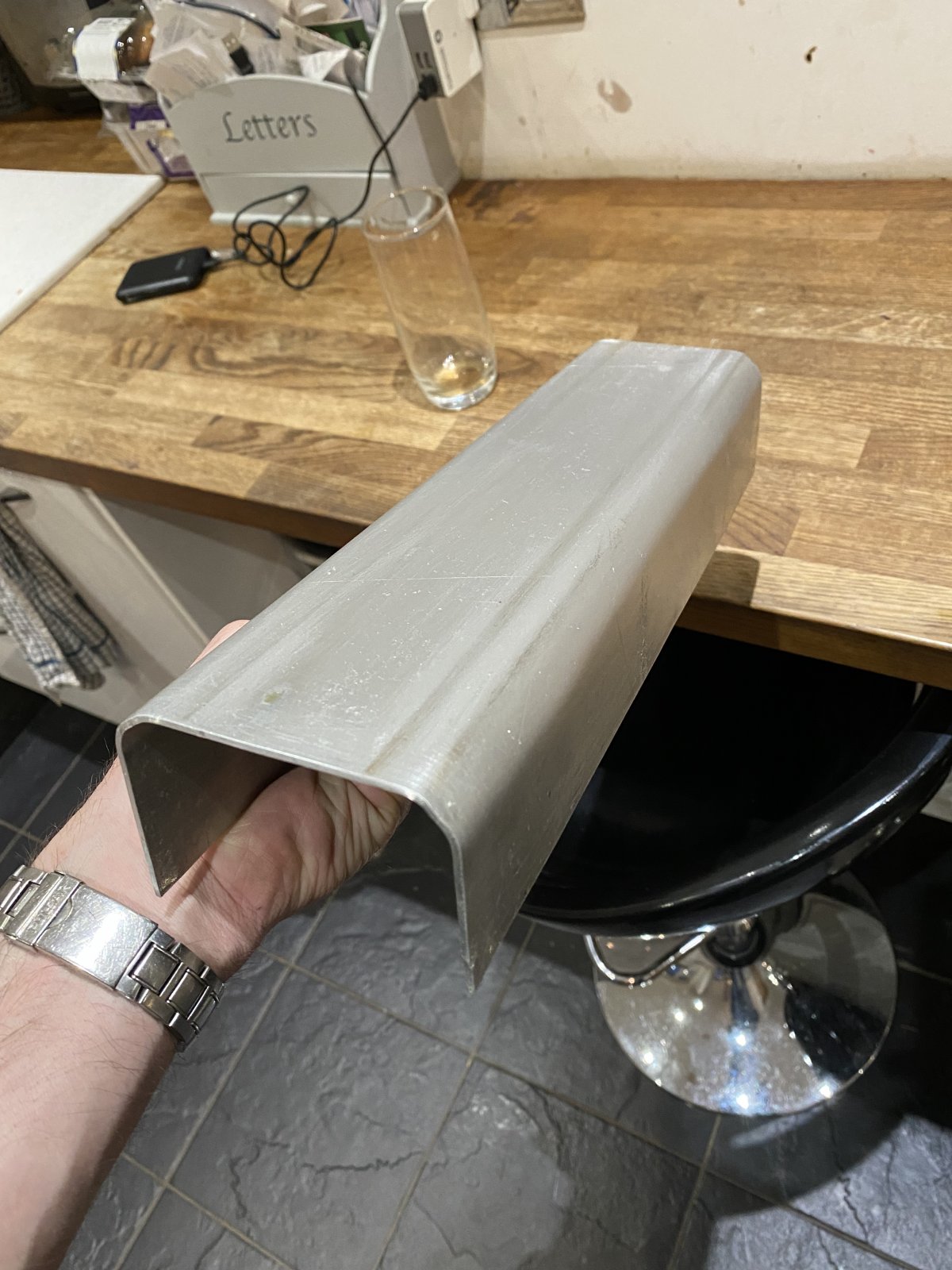

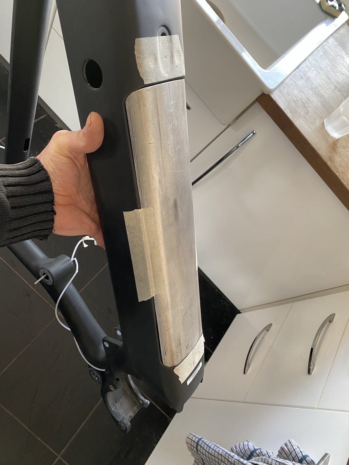

I happen to be metal sculptor so bending a bit of aluminum something I do constantly. I used 1.5mm (1/16") thick. The bigger issue was screwing it to the frame, had to epoxy 4 screw mounts top and bottom to frame. I also had no use for the giant hole in the side of the frame so I ended up Bondo-ing that up. But yes certainly would be far better if the manufacturer had a cover plate option.

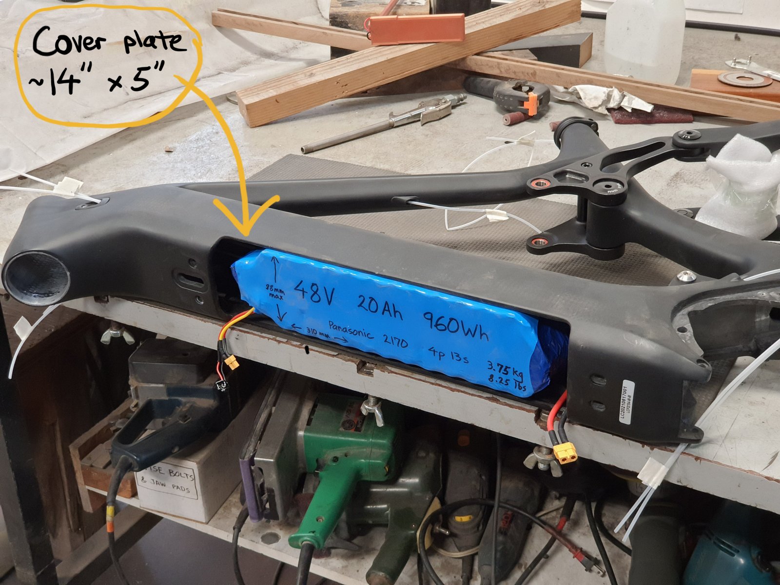

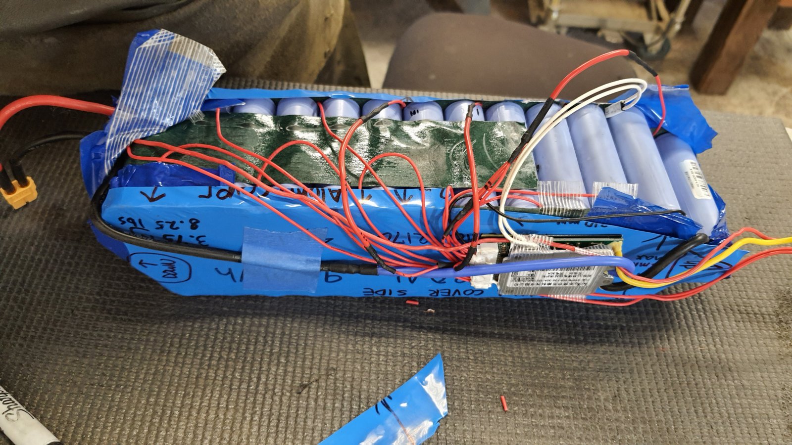

Actually building a battery pack from loose cells, that is a bit beyond me, and also not really necessary because you can buy the shark pack or high long package batteries. I really looked for one with 2170 cells specifically because those just fit much better more efficiently packaged into this particular frame than 1865s.
So the cells fit well but the real problem was the positioning of the BMS board. Once you commit to moving it and resoldering extra length wires on, well you can put it anywhere you want.
Battery capacity may not be a problem for everyone, I've ridden a long ways on a 640Wh pack. I just think it depends on your riding style and your trails. Having two 640Wh packs that you can swap in and out is I think a great solution if you're willing to carry one in your backpack. It's also great cause you can keep one fully charged at all times. However at the time the biggest swappable packs I saw for this frame we're only something like 530 kWh. I could not see taking a step back like that.
OTOH this is 2022 and I don't think it's too much to ask for for a 1 kWh battery pack in an eMTB. 2x 1kWh swappable would be even better, or a 1 kWh in the bike and a spare lighter one as backup.
Unfortunately with my slick metal cover setup, a battery swap is no longer a quick simple pop in affair. Now that I know that a 1 kwh pack will fit (ok it's 960 Wh) I guess the next level would be to build two and make a custom release and pop in and out connection system. That would be sweet but not real high on my list right now!
ArtInvent
Apr 13, 2022
CommercE42
These are photos of the 960 kWh pack, with the BMS board being moved to the side where the ends of the cylindrical cells are. Note some wire splices to lengthen. I re-shrink wrapped the whole thing and I believe when inserted into the frame,the side with the BMS board is up against the top wall of the frame. There is space up there although you have to contend with the wiring passing through as well as the water bottle mount nuts which I filed down a bit and taped over. Again this is the pack with 2170 cells. I also ended up filing down the opening in the frame along the left and right edge rim maybe 1 or 2mm. Pack slides in and out nicely and it's not wedged in tight or anything. There is a little rubber padding around it and it doesn't rattle around or anything like that. Really a perfect fit.
I can't remember if that second photo is the actual orientation or if it was swapped 180°. I might also have made an xt60 extension cord with those yellow connectors I think that's what they're called. It's been 6 months and I just can't remember all the details.
