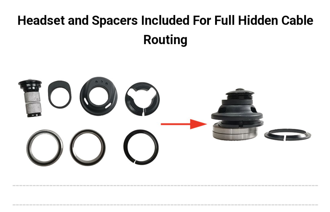

Internal Cable Routing (ICR) headsets come stock/OEM on many higher,-end Orbea E-mtbs in the past few years, so now also this is true for the Bafang M820 (close-integrated downtube battery) frames. Consequently, they're new, and traditional manufacturers like Cane Creek and Chris King are not making them yet. So a few of the FSA-type custom ICF are being utilized it seems in both the CEF50 and LCE930.
What are some good upgrades to purchase before installing the cheaper-grade (likely FSA bearings) ICR bearings that might serve as viable alternatives?
I was thinking of just replacing the stock bearings with Enduro headset IS 52/66. But now can't find the 66 mm in the Enduro website. Unless I'm missing it somehow.
Also, I know that there are pros/cons for the ICR system and may serve as " a solution w/o a problem". But unless you intending to drill ports in the frame yourself, for which is an option, probably you have to use the ICR system regardless.
Just exploring options here...

No. It's likely decent. It probably has FSA bearings on nonbranded topcap etc. FSA can make both higher end and lower end. I doubt they're higher end. So, better quality is out there than OEM.

The German company Acros makes higher quality bearings with their headsets.
Here's a link for the upper 52:.

Ritchey offers a one cable headset under the same name in the US the Logic-E but I don't see the two cable. Now that I think about it us mechanicals will need three cable holes.
Could drill out one more port? Or just slot it with Dremel type Mimi cutter? Plastic insert?

It looks like the one supplied is like that. I wanted to use the Ritchey to get a tighter seal around the cables. Will have to see what is possible.

I went with an Acros 66 bottom headset from Ridewill.com $65. And Enduro 52 top headset bearings from Modernbike.com $36. So, I'll use the stock top-cap with IRC. Total upgrade is $100 for heavy duty bearings.

Are you sure you got the bearing chamfer right and the height? I don't know if the supplied cup use 30d or 45d bearings.nor how high the bears are

I don't know where they found the headset they use. I can't find any like it anywhere.
The chamfer used is all over the map plus the height can differ within brands.
Just have to figure it out I guess after it comes.
The chamfer used is all over the map plus the height can differ withing brands.
Yeah, hoping I didn't waste $35-100 for upgrade.🤞
But given that once the rear brake cable is fed through it and bled on the intial build, I was willing to risk fitment for a higher quality upgrade.... especially overforking it a bit. 🤔

Wow! Less than a week from Italy. Update. I ordered just 4 days ago! FedEx was only choice!
Acros 66 bottom headset...I guess it's the new "oversized" headset to allow for more cable routing space?
And crap...It's big!
Used my teacup for size context!
