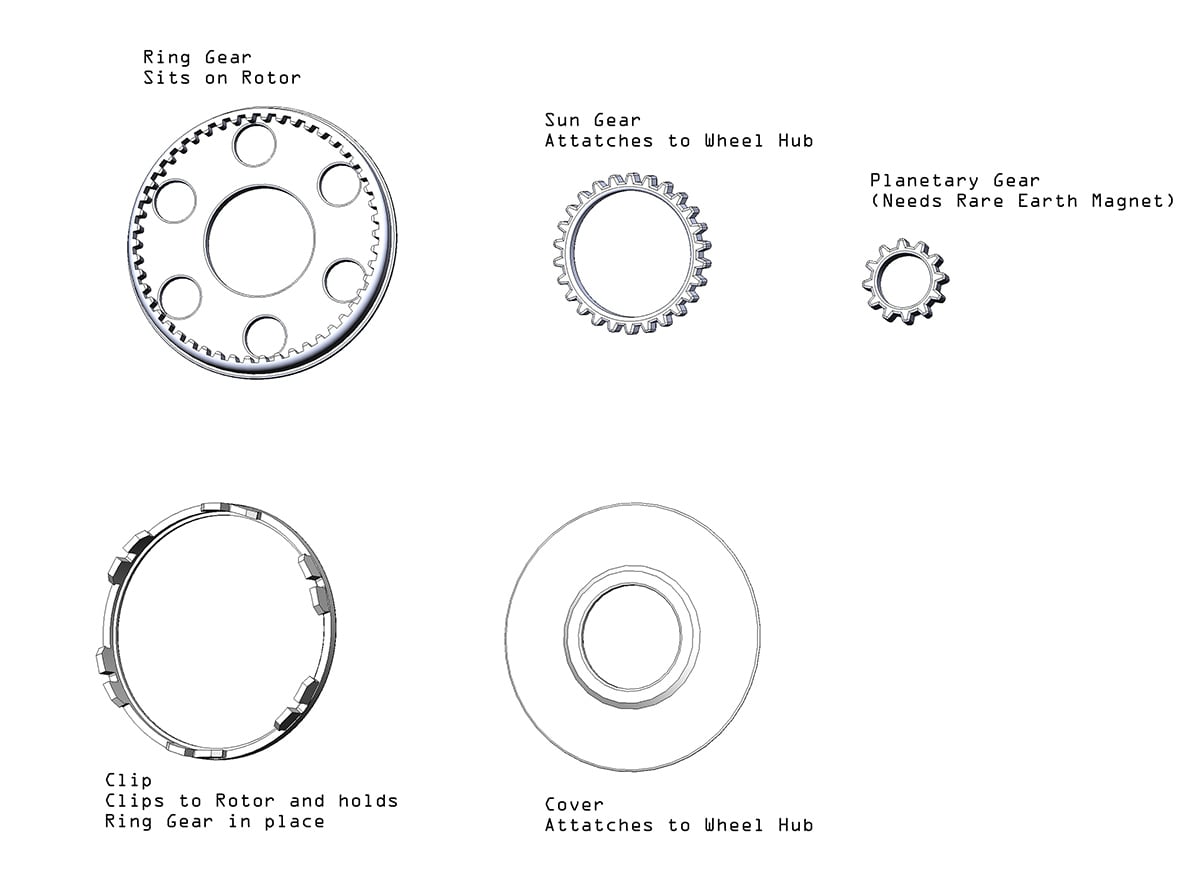

Hi MattyG, welcome to the forum! I realized I need a picture that shows the name of each part as this should make it less confusing when referring to a specific piece so I just did that here:
Based on your description it sounds like the sun gear is not sitting tight to the wheel hub, is that correct? Is it slightly loose, or really loose? If it is only slightly loose could you wrap a layer of electrical tape on the hub to make it a tight fit? There should be no sliding between the sun gear and the hub. The cover also mounts to the hub so is it also loose?
Now that I think about it, if the sun gear is able to rotate on the hub it would negate the gear reduction and I think you would be left with the usual speed limit so maybe that is what's happening here. If you have any pictures that could help as well.
Previous post updated. The Sun Gear is really loose, I am away from the bike now but guessing 1mm gap around sun gear versus hub. Cover is similarly loose.
I'll try the electric tape plan, but potentially for these hubs we'd need a smaller hole for the Cover and Sun Gear. (Edit - I will try rubber washers)

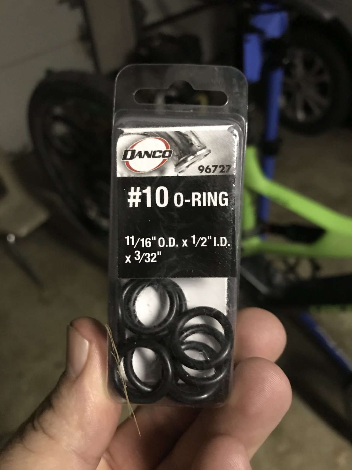

I went to Lowe’s and picked up some #13 rubber washers. I placed about 8 or 10 on over the hub then put the inner gear on over the washers. This created the right fit and worked great. I even had to put one over the dust cover as it doesn’t fit snug like it does on the comp.
Good luck!
Thanks Mhugdoc,
Those washers sound great, I couldn't find #13 on Lowes site, I am in Australia, do you have the dimensions so I can try and find them locally? Thanks in advance.

Here is the o-rings

My o-ring fix isn’t that trick. In fact I may try and modify it due to the sun gear not sitting flush. Hopefully new part options will be available for different diameter hubs.
Sorry Mhugdoc, are you saying the o-rings aren't working that well?

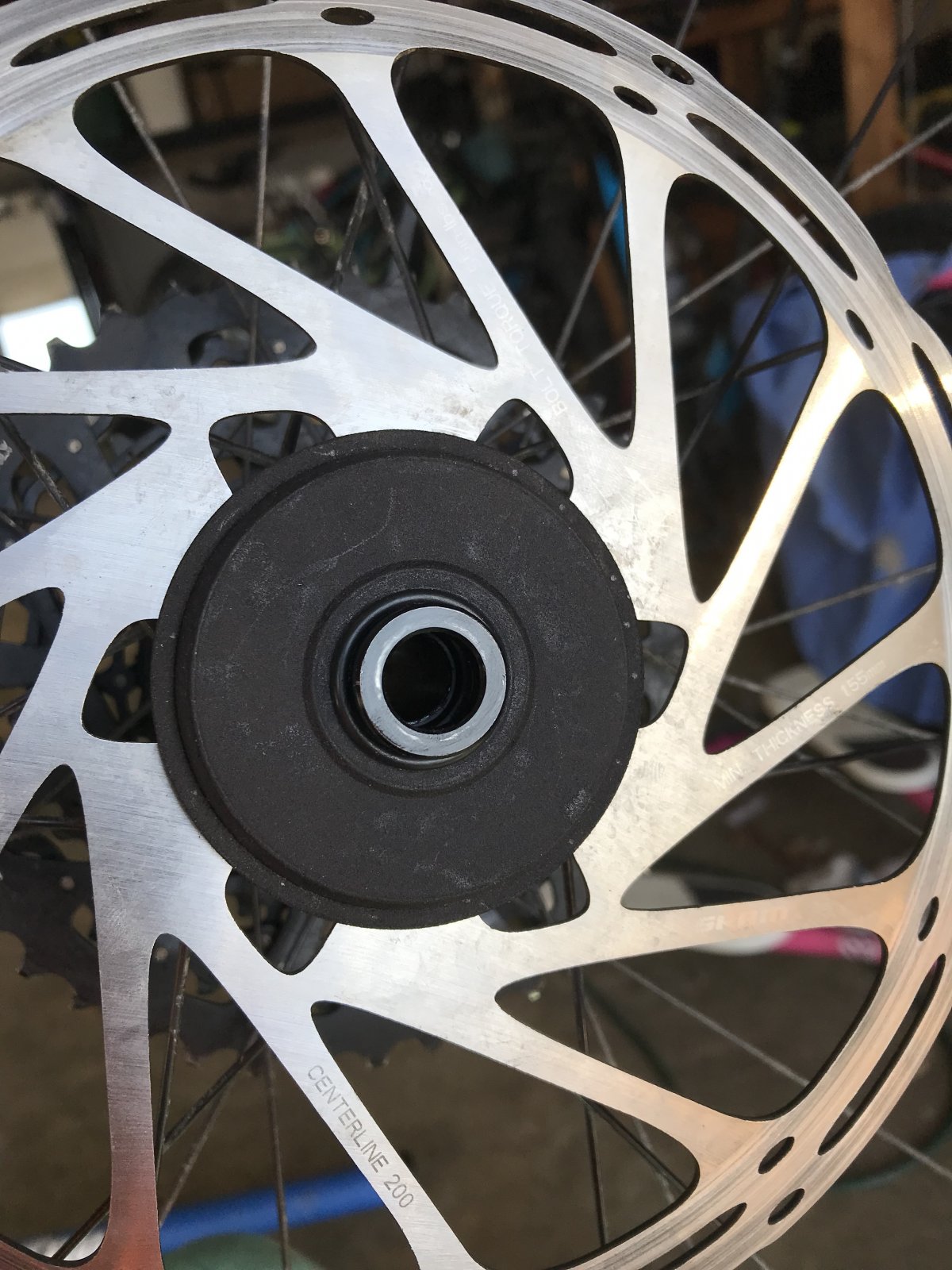

So here is my tweek:
I had one to many o-rings. I put enough o-rings on the hub so that when I put the sun gear over an o-ring the o-ring that the sun gear was on wouldn’t push in on the hub. Also I found it MUCH easier to put the initial o-rings on the hub until flush with the ring gear, then I put the sun gear on, holding it flush against the ring gear then tucked the final o-ring under the sun gear. Easy peasy. Then I put the dust cover on then one o-ring over that,centered, then mounted wheel. Works beautifully!!
If and when we get hub specific parts I may switch but this is solid.
Also I put a spare magnet in my SWAT tool just in case.

Your setup looks solid, thanks for the pics. I actually did create hub specific parts but I put the info in a reply to someone (above) which may make it easy to miss. I'll create a new post with the info so it's easier to find.
