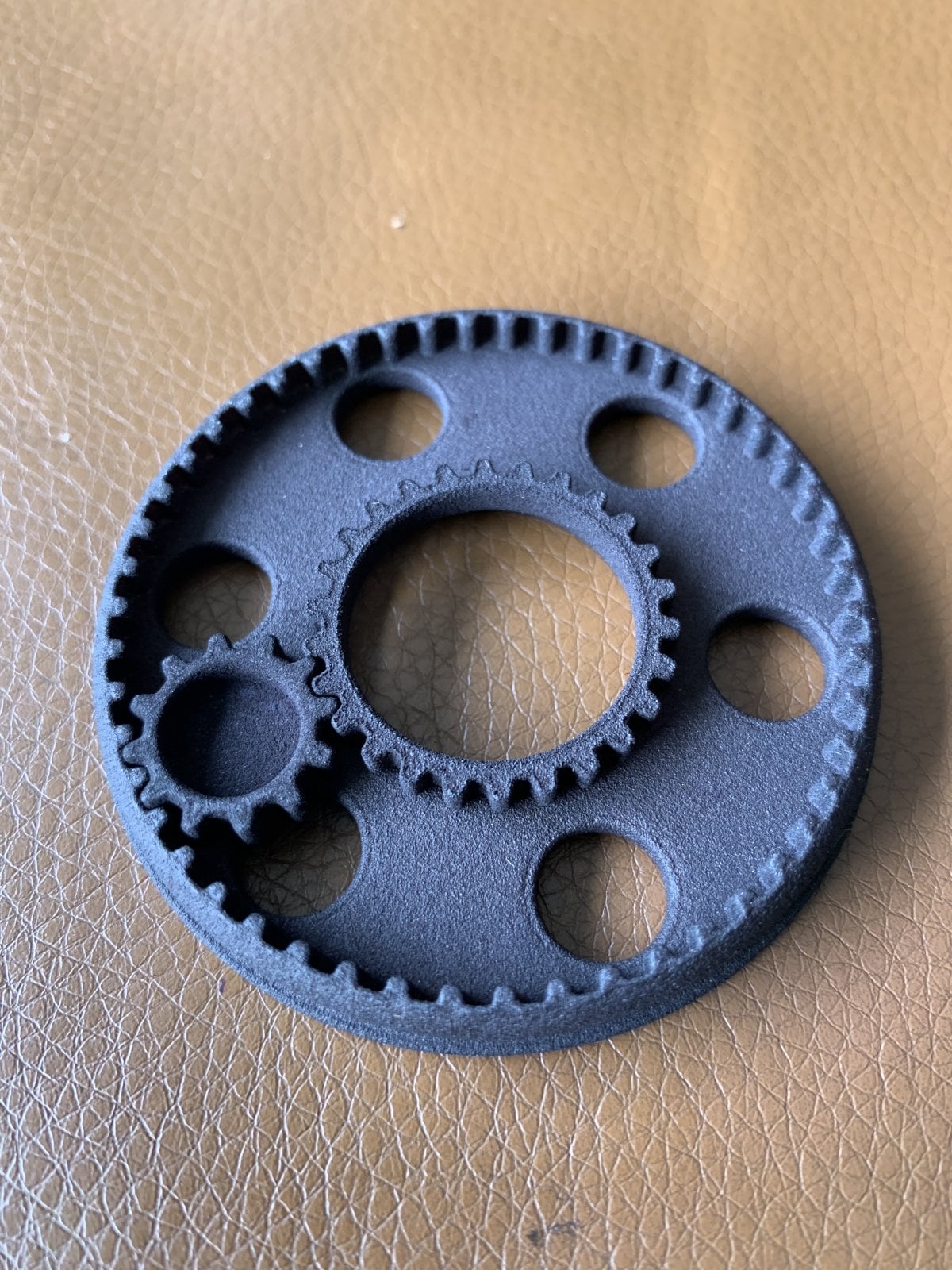

I received the LSS today, the finish of the pieces is good
I'm waiting for the magnet, I'll send you a picture of the installation before you ride
thank you for your ingenuity
hello from France
You are the first I've heard to receive one, so congratulations! I'm glad the prints turned out good. Do please let us know about how well it fits and if there are any issues. I'm sure we would all love pictures as well :)

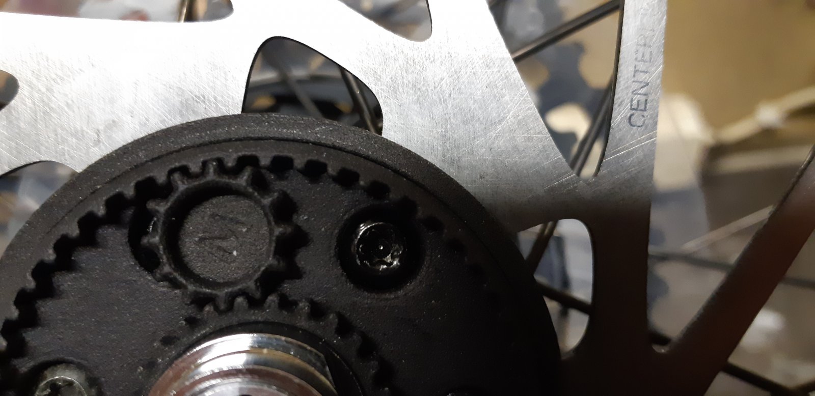

I noticed that the teeth of the magnet pinion are too thin
Hi Jacoo,
If you rotate the wheel axle, does the planetary gear rotate smoothly? There are 2 things that may be happening:
1) After first putting the item up for sale, Shapeways contacted me as they didn't like the fillets on the planetary gear nor the "M" inscription on it, so I adjusted those and updated the model. It looks like you got the previous version, but both should work just fine. The larger fillets on the planetary gear make it look like the teeth are smaller.
2) I'm noticing that the prints from you and 2manytickets look a bit different. I think this is because you are in Europe and hence Shapeways is printing from their Netherlands office, whereas orders from the USA are coming from the New York office. There may be variability in the machines used (I can look into this with them if it is an issue).

Hi Jacoo,
hello jd-3d
I also think that it should work,the planetary gear rotate smoothy
soon I would order a second LSS because I have two pairs of wheels, one for the road, and another for the mountain bike
may be during this second command, it is possible to obtain a better planetary gear?

If your order a second one, it should automatically be the newer design. If you'd like just the planetary gear to update your current LSS then I could upload that as a separate product. Actually, once I get feedback from a few people that everything is ok with the design and it's working I can upload each part individually so that if anyone needs a replacement part they can buy each part separately which should be much less expensive.

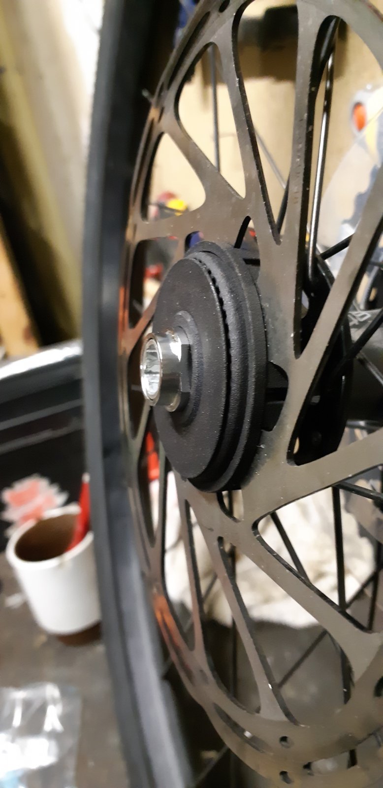

Part IV
I switched my brake rotor bolts to Titanium as the magnet was being attracted to the steel bolts and causing some noise. Throughout the design process I had noise issues where you could hear the gears making faint sounds. Finally I realized I could print the planetary gear in a soft TPU-like material which should quiet things down significantly. It ended up working great and now I cannot hear the gears at all when riding the bike. I think with the latest design the steel bolts would be fine.
The final prototype has a dust cover which also makes it more stealth. In my design the dust cover is slightly short because I still wanted to see the planetary gear so I knew it was working properly.
Final design w/ dust cover:
Final design with dust cover hidden. Note I realized the planetary gear would be kept in place by the magnetic attraction to the steel brake rotor, so that saved on some complexity compared to earlier designs:
A photo of the latest version on my bike:
A few photos showing the tight clearances. I'm right up to the limit in several areas:

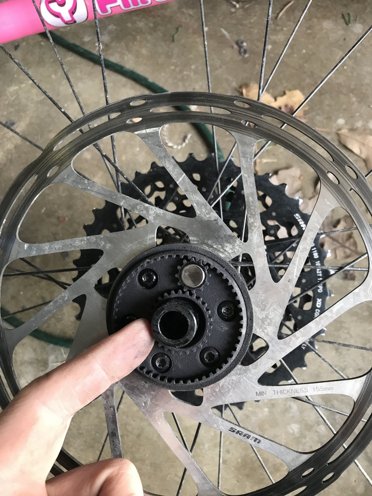

So I did not realize your hub was larger than mine. I have the 2019 Levo expert. The hub is black and smaller than what you’re showing. So the inner gear is just wobbly. No worky.
Help.

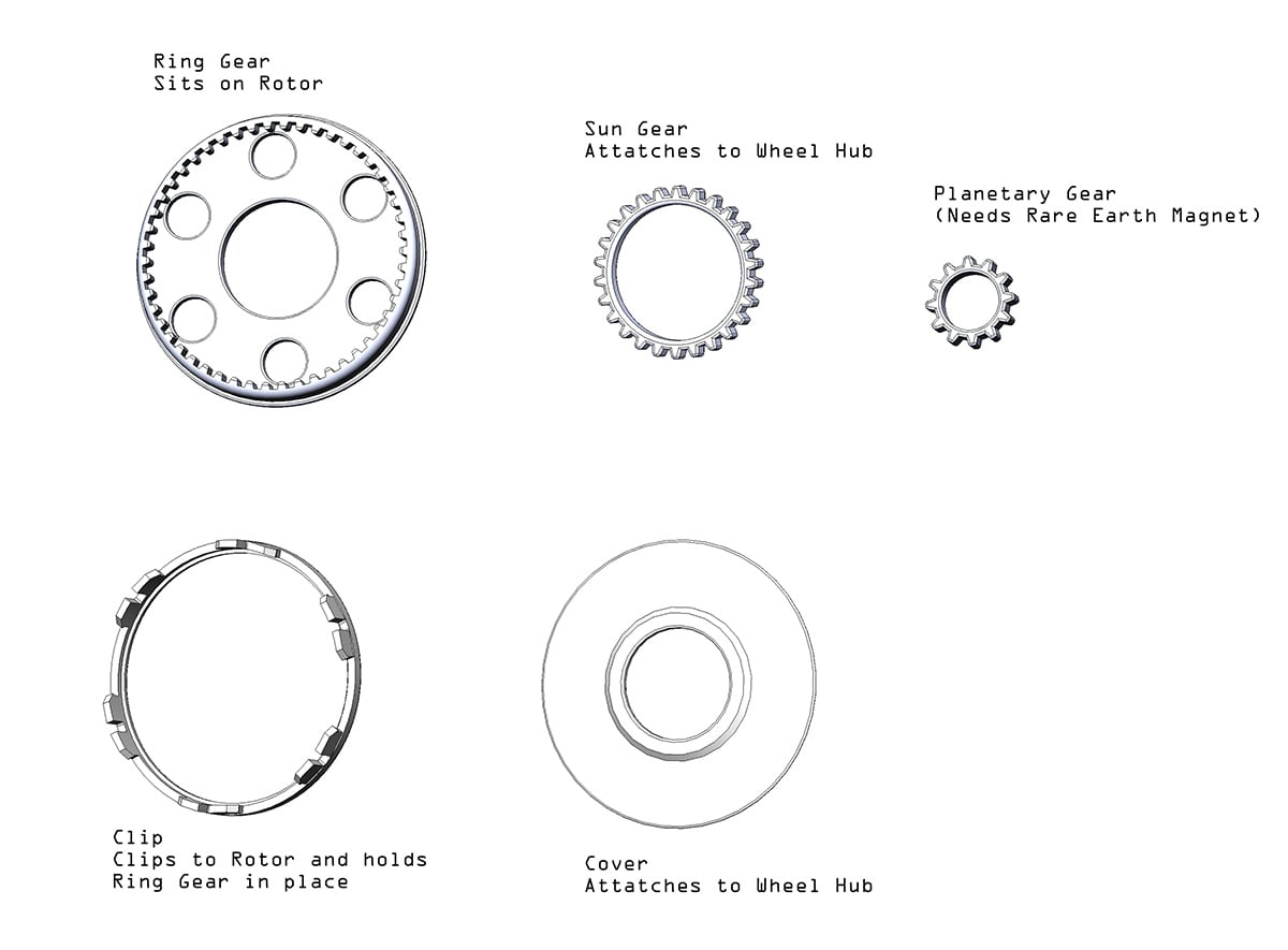

(updated for more accurate naming of parts)

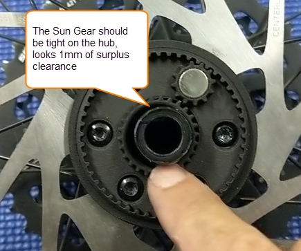

First-time poster, hello to all. Reading this thread has been great fun and thanks to JD_3d for all this incredible work.
So my LSS arrived yesterday, looked great out of the box and there was no need for any sanding or filing as far as I could see. This morning I had some fun trying to install the LSS, here is my experience so far installing on a Levo 2019 Expert:
1. Removed wheel from bike and removed magnet from rotor - pretty straight forward
2. Glued the magnet into LSS small planetary gear with super glue.
3. After some fiddling managed to clip LSS 'Clip' and 'Ring Gear' to the rotor, then inserted the 'Sun Gear' over the hub. All seemed OK except there was a lot of play between the Sun Gear gear around the hub. Immediately I saw this would be problematic as the planetary gear mechanism needs a close fit and the Sun Gear should not rotate on the hub. The Cover was also very loose around the hub.
4. Optimistically I installed the 2 rotor bolts, and got the wheel back on and went for a short ride and took the Garmin for speed measurement. I could not get it over 25kmh which surprised me as I thought it would either a) not work at all or (b) be all weird, or c) work well and let me ride at 35kmh +.
So maybe I've done something really silly but is it possible the hub diameter is much
smaller on the expert model?
.. my mate has the Turbo Levo Comp so will try on his bike on the weekend.

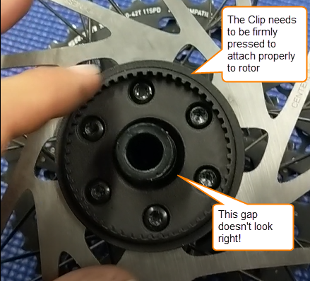

3. After some fiddling managed to clip LSS to the rotor, then inserted the other parts of the LSS assembly which seemed OK except there was a lot of play around the hub. Immediately I saw this would be problematic as the planetary gear mechanism needs a close fit.
So maybe I've done something really silly but is it possible the hub diameter is much smaller on the expert model?
Hi MattyG, welcome to the forum! I realized I need a picture that shows the name of each part as this should make it less confusing when referring to a specific piece so I just did that here:
Based on your description it sounds like the sun gear is not sitting tight to the wheel hub, is that correct? Is it slightly loose, or really loose? If it is only slightly loose could you wrap a layer of electrical tape on the hub to make it a tight fit? There should be no sliding between the sun gear and the hub. The cover also mounts to the hub so is it also loose?
Now that I think about it, if the sun gear is able to rotate on the hub it would negate the gear reduction and I think you would be left with the usual speed limit so maybe that is what's happening here. If you have any pictures that could help as well.

Mattyg
See the post above yours. I have the expert and had the exact same problem.
I went to Lowe’s and picked up some #10 o-rings. I placed about 8 or 10 on over the hub then put the inner gear on over the o-rings. This created the right fit and worked great. I even had to put one over the dust cover as it doesn’t fit snug like it does on the comp.
Good luck!
