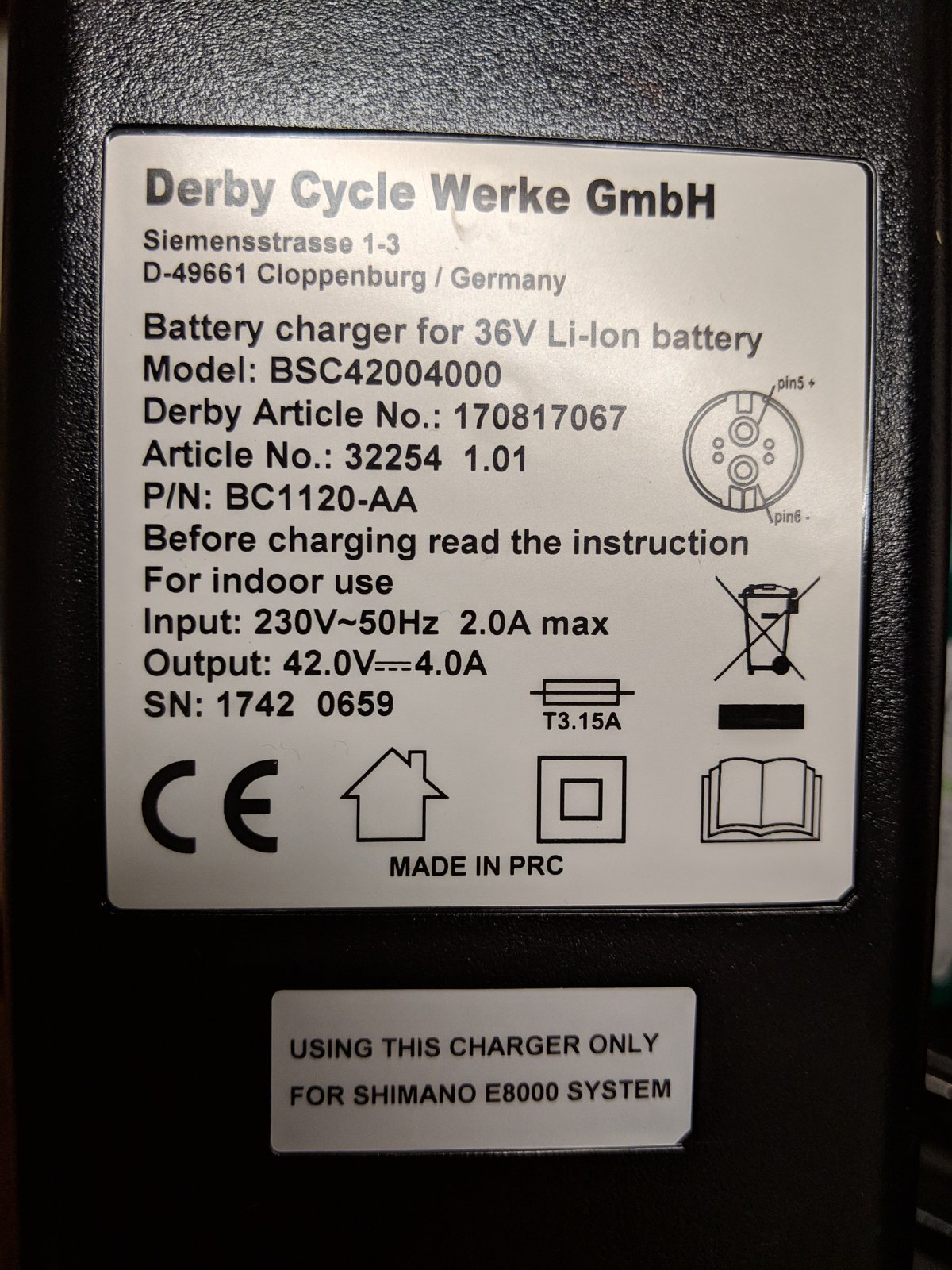

My battery has just done the same, 2 week old bike, the first time the battery has been drained; no problem topping it up so far (above 25% battery power) I ran it out to nothing, and now the charger only flashes green (charging) 9 or 10 times then all lights go off.
My mate has the same bike, luckily his charger was the 4.0A output; borrowed it, plugged it in and presto, charging as normal. Ill call the dealer in the morning...

These are the details on the reverse of the charger that seems to solve the depleted battery charging issue.

That’s the one I have on my 2018 and never had an issue.
But you did have a battery that went kapput.
Maybe they upgraded the charger (the Chinese makers that is) because with the old one, too many batteries were blowing, but now the new one has a fail safe that is causing the current (I mean the present) problem. A problem I encountered over the winter.
Just a thought.
Whatever, Focus are keeping pretty quiet about it.

I too have the 4.0 amp charger and have never had a problem charging the battery no matter how cold , I got the bike in December last year and it always charged fine in a freezing cold garage , until the battery failure!
So far so good with new battery and am loving it again, fingers crossed
Just a thought.
JE James have only seen 3 failed batteries , the old charger is 240V only whereas the new one is 100-240V enabling distribution to more countries, I don't think the old style charger is the issue, the battery failed on a ride so I don't see how the charger could produce that effect.
As I said "just a thought", but there is definitely something that clearly is not quite right and once circuits are controlled by micro chips and software then everyday logic goes out of the window..
