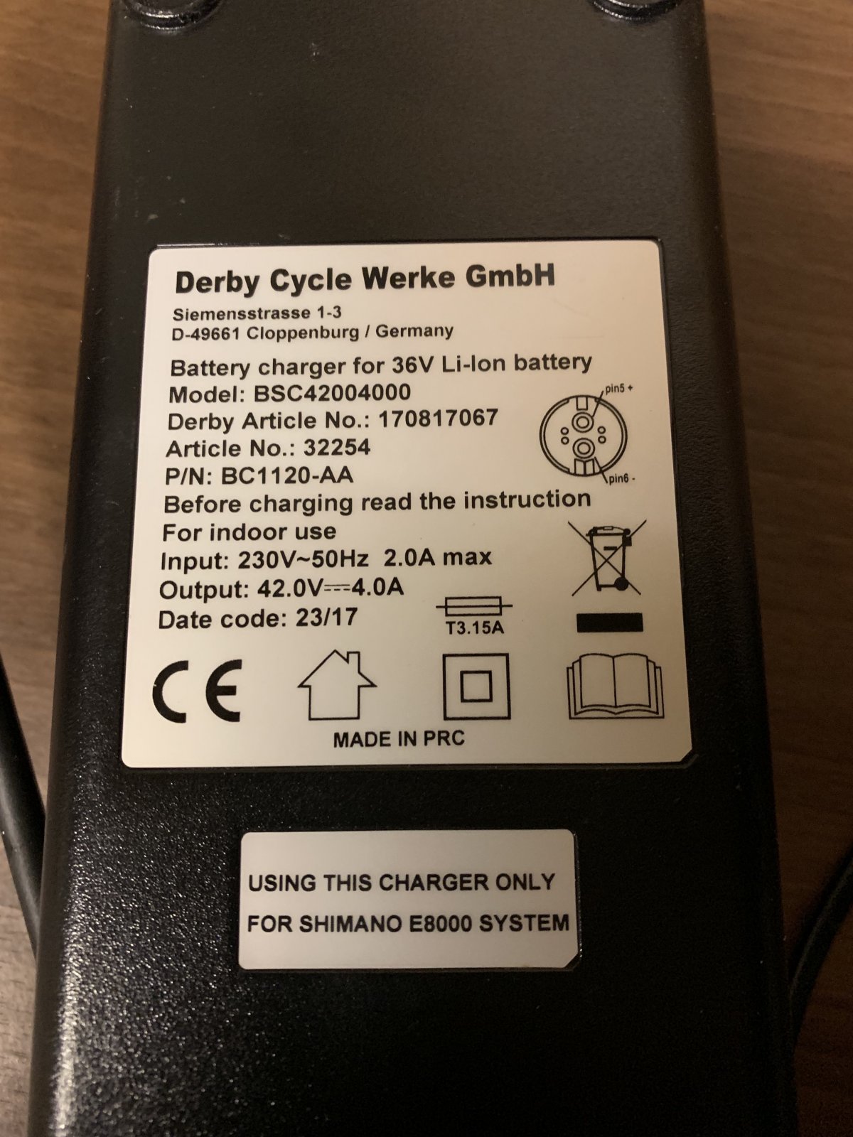

Can you send the serial numbers of both your chargers to see if there’s a pattern

I don't have the serial numbers of either charger as they are both with the LBS.

Progress report:
JE James in Sheffield (the Focus dealer) have had the bike for two weeks (I was on hols for one of them). They have done repeated tests on bike and charger. They are convinced that the charger is the problem. Low battery charge + cold charger = charge fail. This is whether the bike (ie the frame battery) is warm or cold. They had two batteries to play with and they swapped them over repeatedly and got the same result (both 4.5 Amp chargers).
They contacted Focus with the details and were told very clearly that Focus have a process to follow and they did not want to listen to what JE James had been doing. Focus have sent a new frame battery that they know is fault free. The new battery is to be installed and tested according to a Focus test regime. The mechanic told me that Focus are difficult to deal with and all he can do is to wait for the new frame battery checks to show the same faults and only then will he be able to get them to listen. (Personal note: I have dealt with many Germans and I can fully understand why Focus do not appear to be in listening mode; they have a test process designed by their experts and they must follow it! Otherwise what are experts for?)
I thought Focus would be only too keen to dump this problem on Shimano, whose name is all over the battery, motor and chargers. But in fact Focus are probably following a Shimano fault diagnostic. So if they don't follow it, they may not be able to hold Shimano responsible!
In the meantime, I have collected my bike because I want to ride it. JE James have given me a brand new charger that is the earlier model, ie the 4 Amp model. The bike is charging right now, but I would have expected that with the old charger, because it is warm.
When the new battery arrives from Focus, I will book in the bike for more tests. What an arse-ache! But I am doing this for all you Focus bikers out there. Also I don't want to be in a position where when if get the same problems again next winter, I don't want Focus to be able to say "well you didn't co-operate last year, so we can't help you!
It occurs to me that Focus owners in warm countries, or those that keep their chargers in the house will have experienced zero problems, even if they have a faulty charger. They must be wondering what all this is about. But let them take their bike away overnight in the colder weather and where the charging point is outside in the shed and they may discover the same problems.
Winter is fading now in the UK and we are unlikely to get much more cold weather, but in the meantime, keep your chargers indoors. :)

Another thing has occurred to me. The components being tested are all Shimano, why aren't other Shimano batteries/chargers having similar problems?
Not so, neither the battery nor the charger are Shimano, or even Derby if I remember rightly. I'm sure the name of the actual battery manufacturer has been posted on here somewhere but, regardless, both of those components seem to be the weak links in the system. Not surprising given Shimano's reputation and the relatively cutting-edge nature of the bikes.
Console yourself that all other brands suffer issues too, some more worrying / serious than the cold/wet charging issue.
Good luck in your explorations and thanks, on behalf of all northern-European Jam2 owners, for sticking with it until it's solved!
I didn't expect the actual manufacturer to be Shimano, but they are branded Shimano, not Focus. I am correct to deal with Focus as it is their package I bought. But Shimnao must carry some responsibility somewhere. As I said above, maybe Focus are following Shimano's test procedure.
