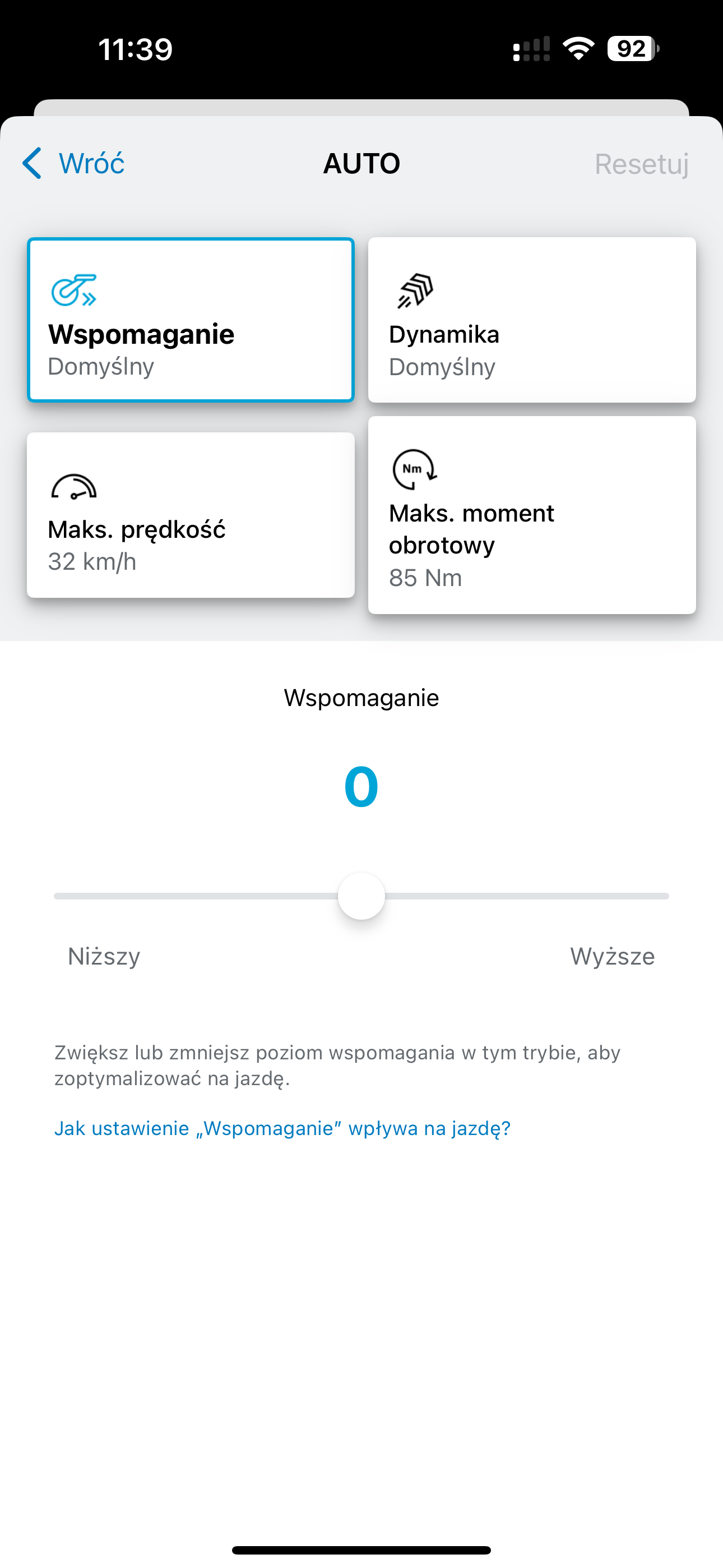

Sir_Szendi
Apr 10, 2024
17
Poland
If someone has a magnet on the rim and the manufacturer does not want to agree to change the configuration to move the magnet to the brake disc, the best option in my opinion is to change the software to the US
then we have a speed of up to 32 km/h the display shows the correct speed, and it is not detectable because it is the factory software from Bosch

Sir_Szendi
Apr 10, 2024
17
Poland
Let us know when you've done that.
I'll have the New Zealand software on mine please...
What is the top speed of the ebike in New Zealand?
So how fast can you go on an E-Bike? New Zealand supports E-Bikes with motors of a maximum sustained power output of 250 watts and a maximum speed of 32km/h for off-road models, and of up to 45km/h for models designed for road use. So can it go faster than the motor supports? Yes, it can.
I live in Poland and here we have a support limit of 25km/h After changing the software to the US, I have a limit of 32km/h (screenshot from the application in the attachment) I changed the software in a bike shop. I looked for a shop that sells bikes with a 32 km/h limit and asked them to change the software on my bike. They did it on the spot in 5 minutes

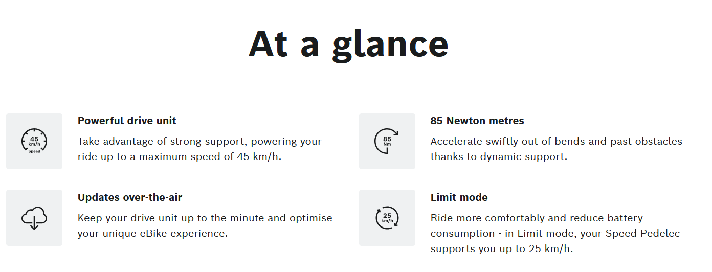

martyfrommonmouth
Mar 5, 2025
14
9
Kent
The Bosch website states the Performance Line Speed goes 45kmh. I wish we would have simple options to unlock that speed. Its annoying. Cars or motorbikes can go faster than the Speed Limit but the motors are not soft locked to the legal limit of 70mph. I don't know why ebikes motors are treated differently.
Anyway my chip works well so far so not too much of an issue.
