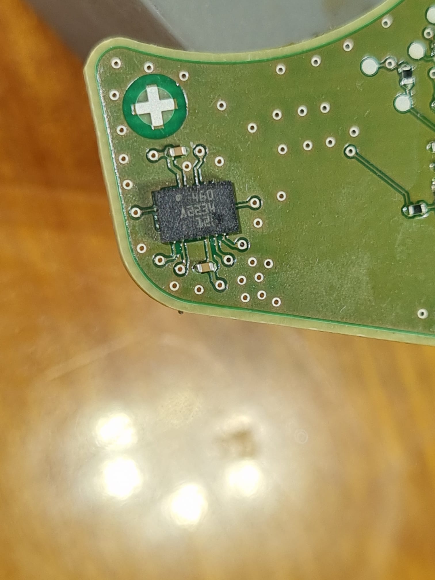

Hello,
I'm a hardware developer, and also a new owner of this crappy smart system. I wanted to see exact what kind of sensor is using inside the motor, for the RIM magnet, took the motor out and opened it. Unfortunately I cannot find any datasheets of it. It seems a multi axis hall sensor with SPI, at least based on the pin count and signal routing. Now if we are dealing with a 3 axis hall sensor I don't think it will work the electromagnet. I attached a picture with it. Maybe next week i will pull out the signals trough a cable and check what signals are provided to the microcontroller. Is still hope there is a PWM line from the sensor that can be ower-written.

Hello,
so this tiny chip is the cause of all the problems ?

Hello,
Hi there!
It's possible that the sensor you're dealing with could be from Facet, a well-known company in the automotive industry. Specifically, it might be the "KW 460 223" ABS wheel speed sensor, which is actually manufactured by EPS, a part of the Facet group. This type of sensor is used for measuring wheel speed in ABS systems. It's also conceivable that Bosch might be using a similar sensor with a slightly different product name for speed measurement purposes.
Hope this helps! Good luck with your troubleshooting.
