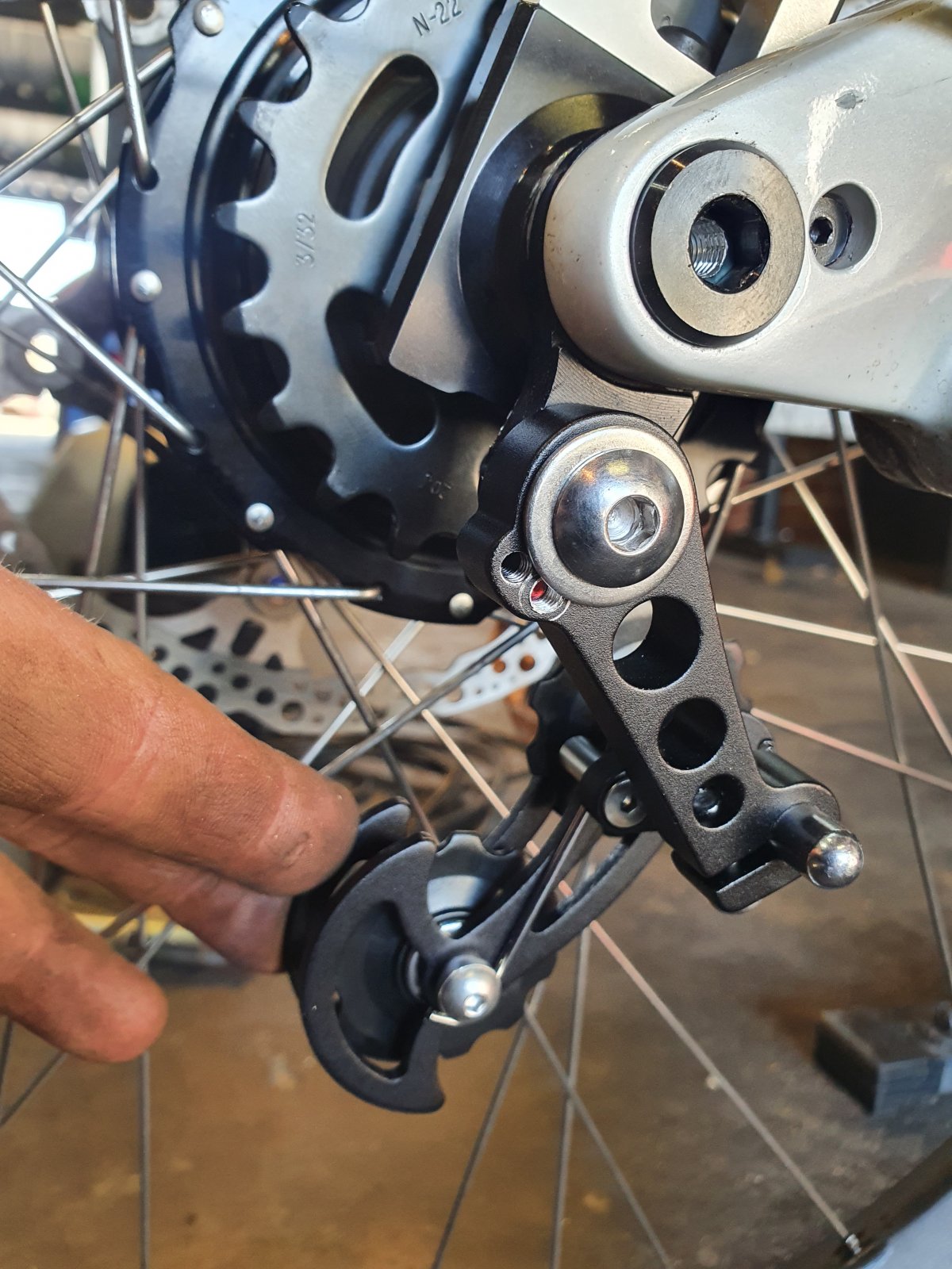

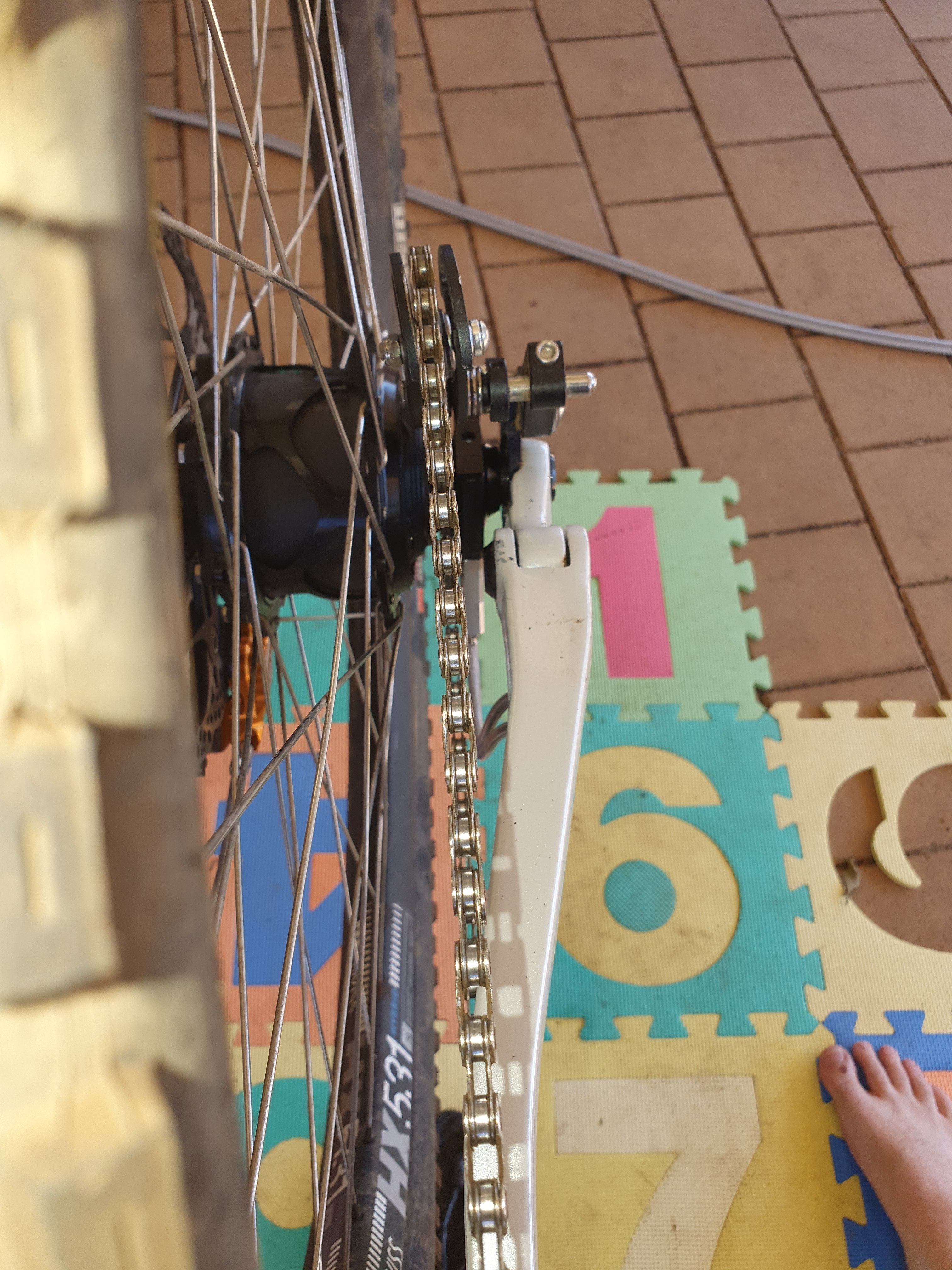

Managed to sort this issue. The metal pin that is used in place of the B screw has m4 threads. So I was able to unscrew it, and the drill and tap a second hole. That gave just enough clearance for the chain to pas between the rear hub cog, and the upper tensioner wheel.

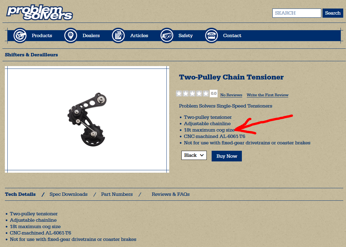

This is Problem Solvers chain tensioner and it is designed to accommodate 18t cog maximum
I purchased the tensioner directly from Kindernay, as well as the 22t chain ring which fouls on it. (which is a KMC). At no point anywhere did they say that thier chain tensioner won't work with thier 22t large cog.
That chain tensioner is a total piece of shit. It has so much slop in it. If it was a derailer, it would be jumping gears all over the place.
And while we are discussing Kindernay. I am still working through the leaking hydraulics with them. This one will make you laugh.... They did admit to me that they have a known fault with thier hydraulic hose system. The compression nut does not have enough chamfer lead in, and causes the compression olive to jam up and get crooked. This causes leaks at the hose crimp.
So kindernay sent me new compression nuts under warranty. But they sent me the exact same nuts with the exaxt same defect. LOL.
They did also send me a brand new shift actuator. So im hoping that fixes the issue of the leaks coming from the bleed screws.
Although, because they only supply the bare minimum length of hose with thier kits. And I've now had to shorten the hoses a few times because of thier leaking hose system. I'm gonna need to replace them too.

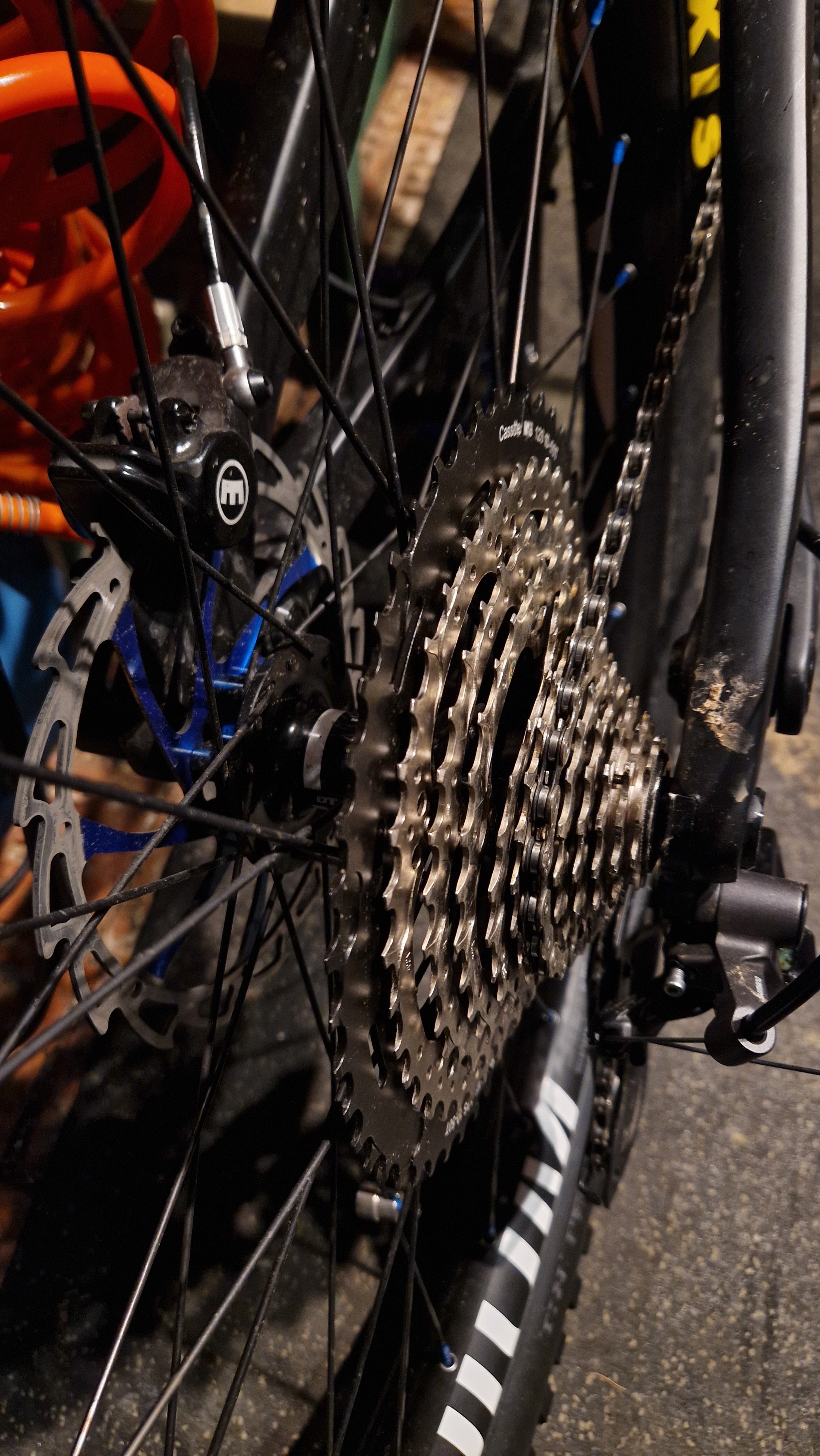

This happens when your nephew takes the bike to a spin, but you still havent set up the rear derauiler.
There were a few gears where the setup was a mess, so i am looking for that EDS from wheeltop (i saw a video where you can set every gear individually via app). Anyone has any good source to buy it from? It is cca 505€ on aliexpress..

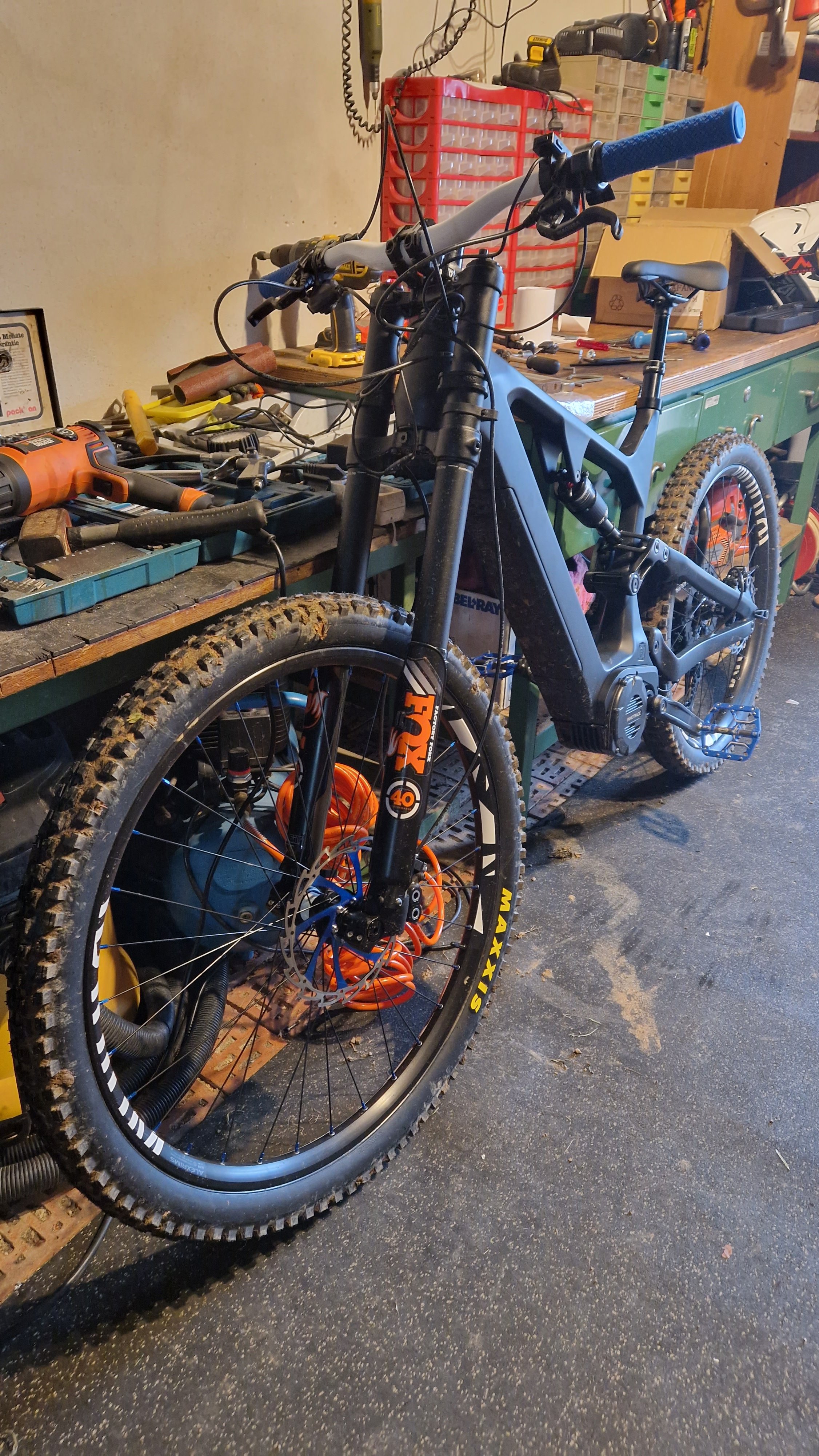

It happened when he hit the snow and the bike suddenly almost stopped, he hit the throttle and then you can imagine what sounds he was hearing. I already contacted Timal, but got no answer, will look into some videos on youtube if there is any other store mentioned to buy it from.
However I did found an article, that wheeltop probably removed it from his site, perhaps sram has something to do with this. I think I am gonna have to grab one via aliexpress if it is still available. One more photo of my build, i still have to arrange the cables in front.

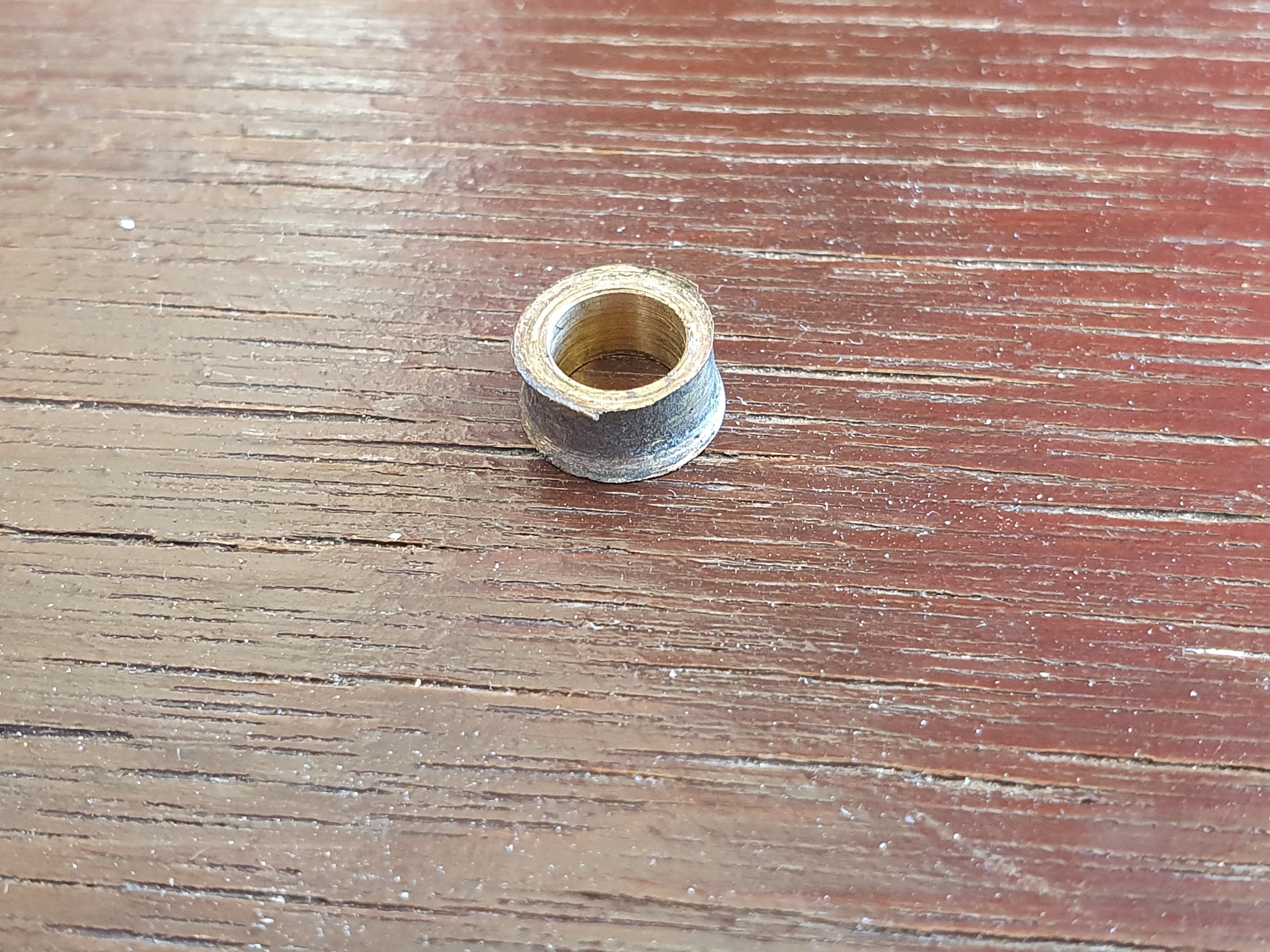

In other news. I think I have possible solved the leaking Kindernay Hyseq hydraulics.
I received a new shift actuator from kindernay under warranty. And some new fittings, as they have a known issue with leaks. They had to send them out twice, because they literally sent me the same parts with the known defect the first time. LOL.
Anyways. Because my original kindernay hose was so short from multiple attempts at fixing the leak. (And that it was too short to begin with from new to even fir an e22 large frame). I purchased a set of Hope hoses. I choose Hope because I know they are high quality. And I have never had any leaks from any of my Hope hydraulics brakes EVER. The Hope hoses had plenty of length and I even had spare length to cut back to get them to fit nicely.
I still had to use the Kindernay compression olive to match the shifter and actuator geometry. As it turns out, the hydraulic hoses kindernay use are actually Taiwanese brand called Aligator. Which I don't think is very good. Reading between the lines, they look like the ones that supplied the defective tube nuts to kindernay. And their stuff is not very high quality from what I can tell.

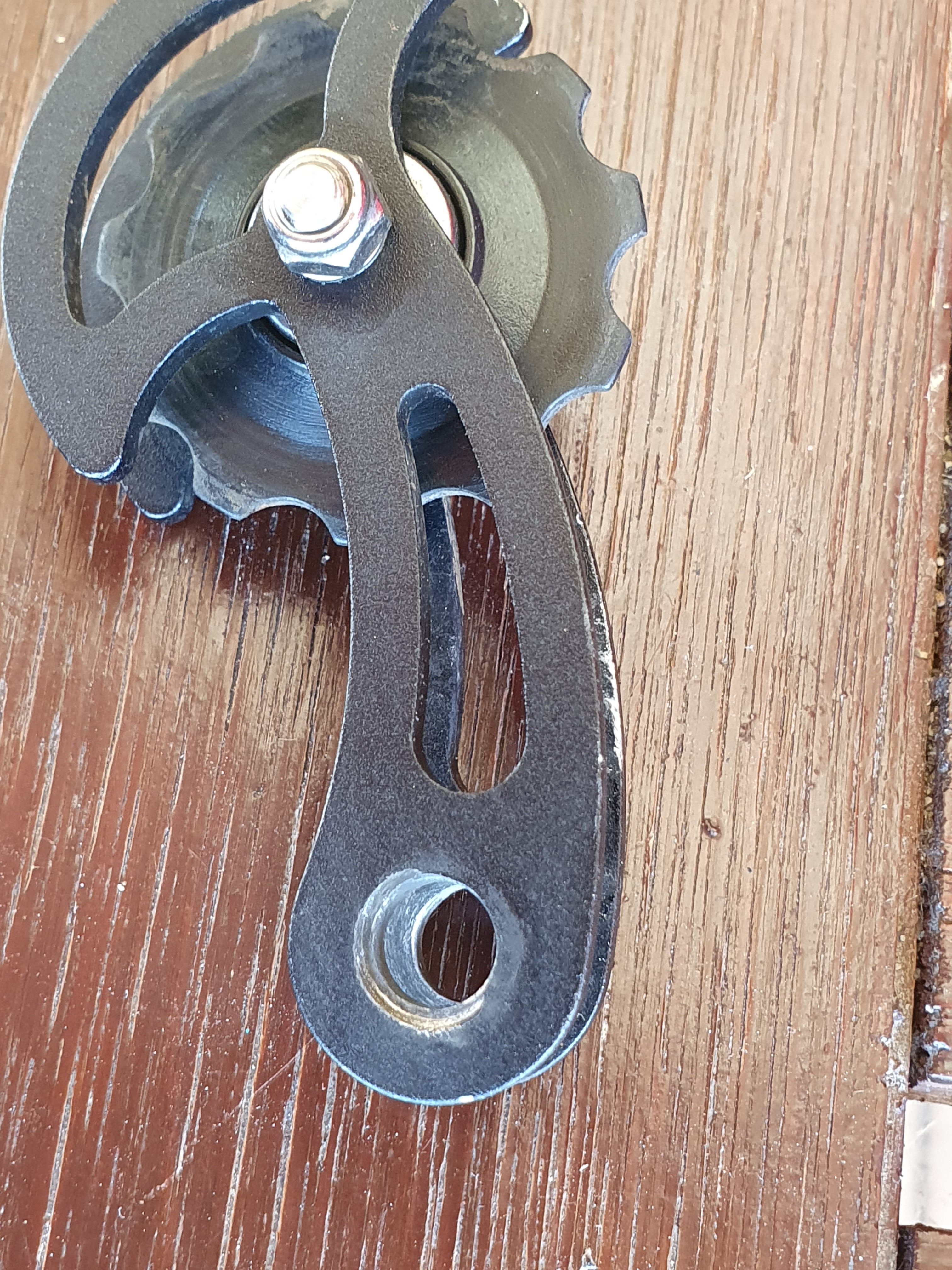

That's interesting failure. My tensioner has many southlands miles under the rain and has no issues. Maybe it was out of alignment with the cog?
bram.biesiekierski
Apr 18, 2022
424
258
Perth WA Australia

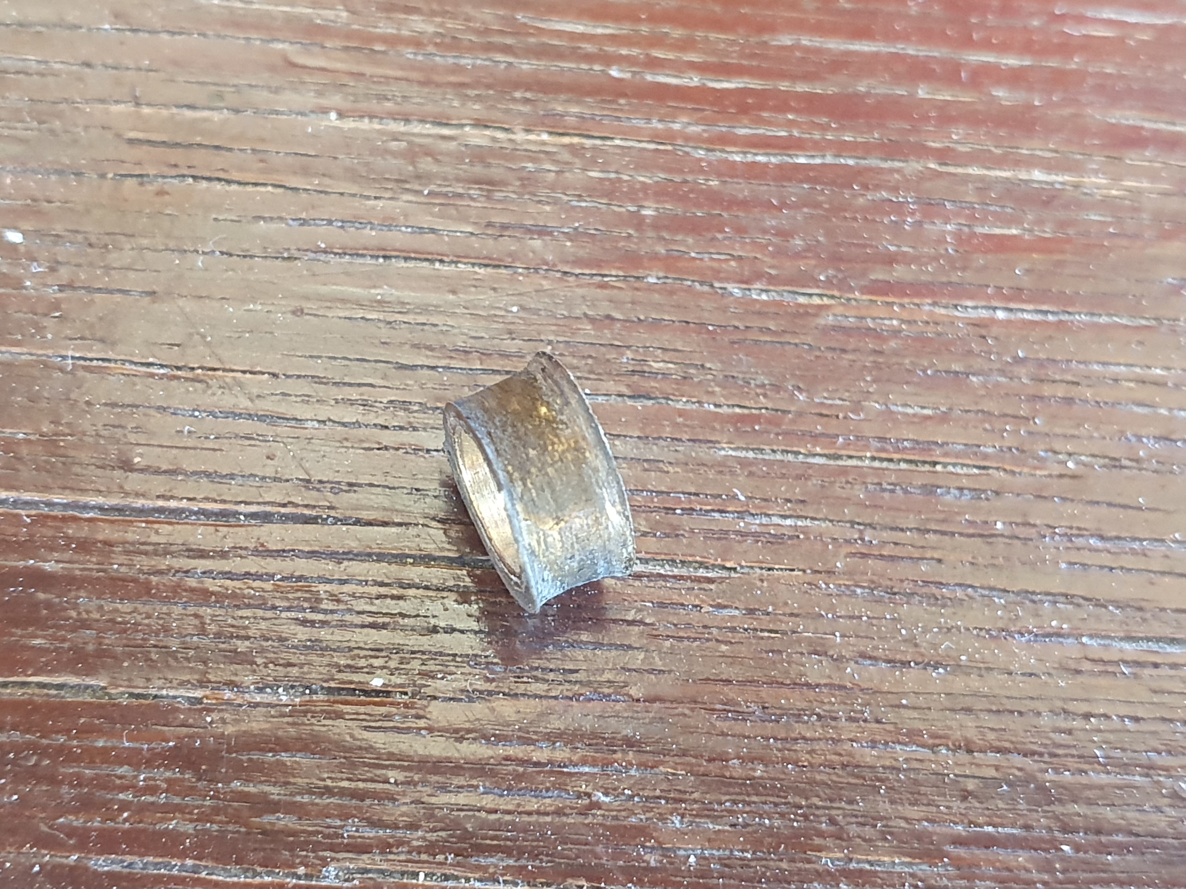

No, it was all aligned with the cog. The pulley wheel that is closest to the main cog is still in good alignment. As it rotates over the axis of arm pivot. So is not subject to any twisting as the arm deflects. (Although with alot of side to side slop, as it has a sintered bronze bush instead of a ball bearing in its point of rotation.)
The derailer hanger is straight aswell. The main body of the tensioner sits straight on it too. It's just the tensioner arm the has the excessive deflection. There are no signs of bending in the pieces of aluminium that make up the arm aswell. I dissasembled them, and checked them against a straight edge just incase the arm was bent from an impact etc. But it appears ok.
Perhaps I had too much tension on the arm? I have somewhere between 45° and 90° of spring wind-up to give tension on the arm. With the way the chain slaps on the e22 chain stay, I wanted to keep the tension up. It's on the high side of the spectrum, but I dont consider it excessive.
I have never greased those pivots. Although, I wouldn't expect to have to, atleast not at such low use interval. I don't pressure wash the bike. But I do garden hose wash it occaisionaly. And from time to time have got water on the tensioner. Although looking at the general open design of the tensioner. Any lubrication present would quickly be expelled regardless. It is not sealed in any way. And is of a very basic construction.

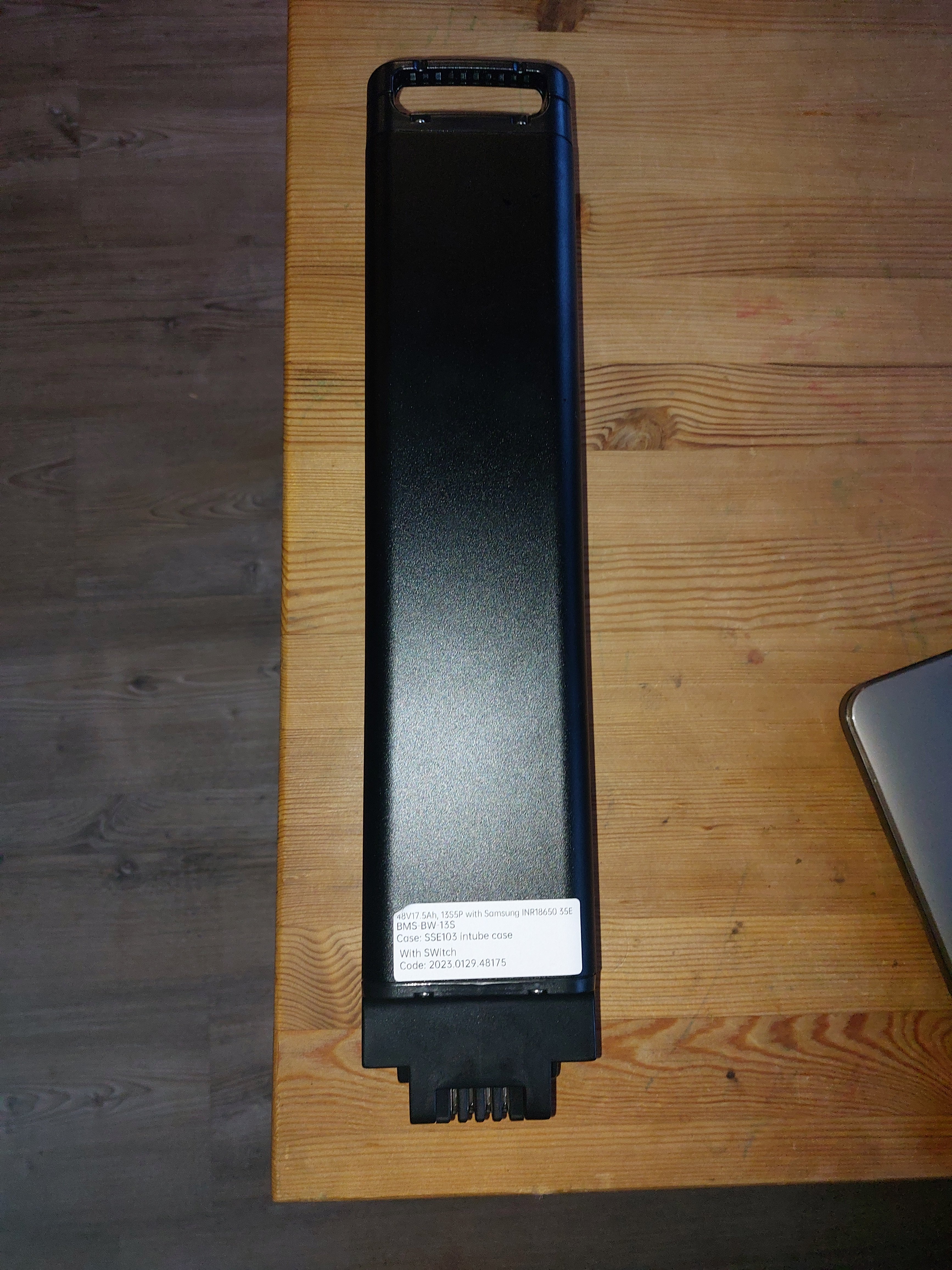

Hi guys, do you have a wiring diagram for bafang E10/E22 battery? I need to figure out what wires go to golden pins (the button connectors) from the BMS. Do you also know if there is a way to reset the BMS?
bram.biesiekierski
Apr 18, 2022
424
258
Perth WA Australia
Pretty sure the 4 slot type terminals are battery positive and BMS negative. (2 terminals each)
And the BMS switch is the 2 circular contractors above.
If you look at the battery mounting block with the connector in it, you can kinda follow the wires under the silicone adhesives, on the rear side of the block.
eugene8
Nov 12, 2022
27
mainland
Thank you for reply. I will get back to your comment again later as for now I have no idea what 4 slot type terminal is. I am trying to fix a lemon that i bought so was looking for a wiring diagram from BMS to those pins. The battery now gives incorrect data, I will need to rewire it.
