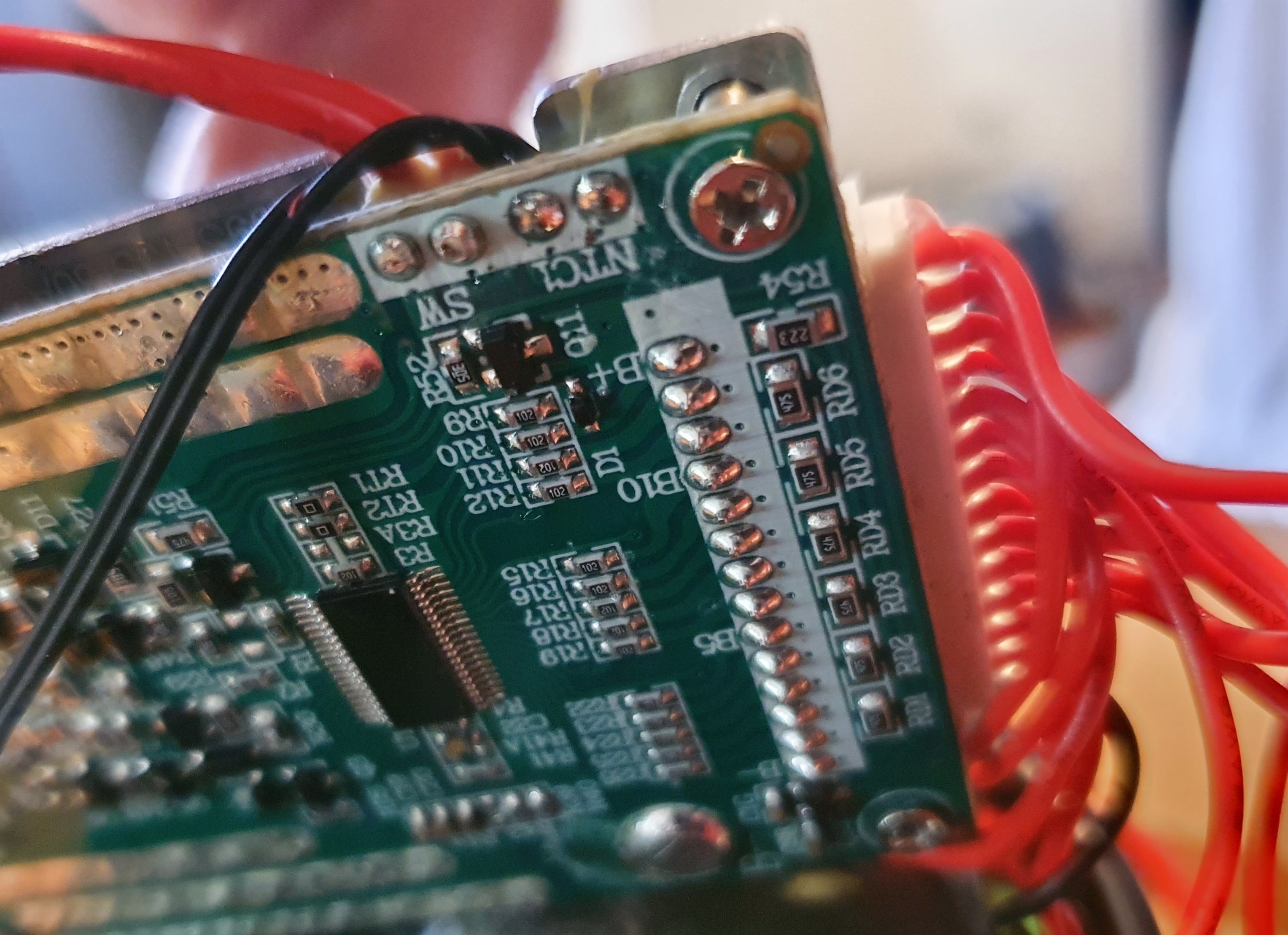

Hi guys, do you have a wiring diagram for bafang E10/E22 battery? I need to figure out what wires go to golden pins (the button connectors) from the BMS. Do you also know if there is a way to reset the BMS?
The 2 golden pins are connected to the on/off switch. Inside the battery it will be 2 thin(usually red) wires. Many people prefer to shorten them to due to contact issues on the 2 golden pins.

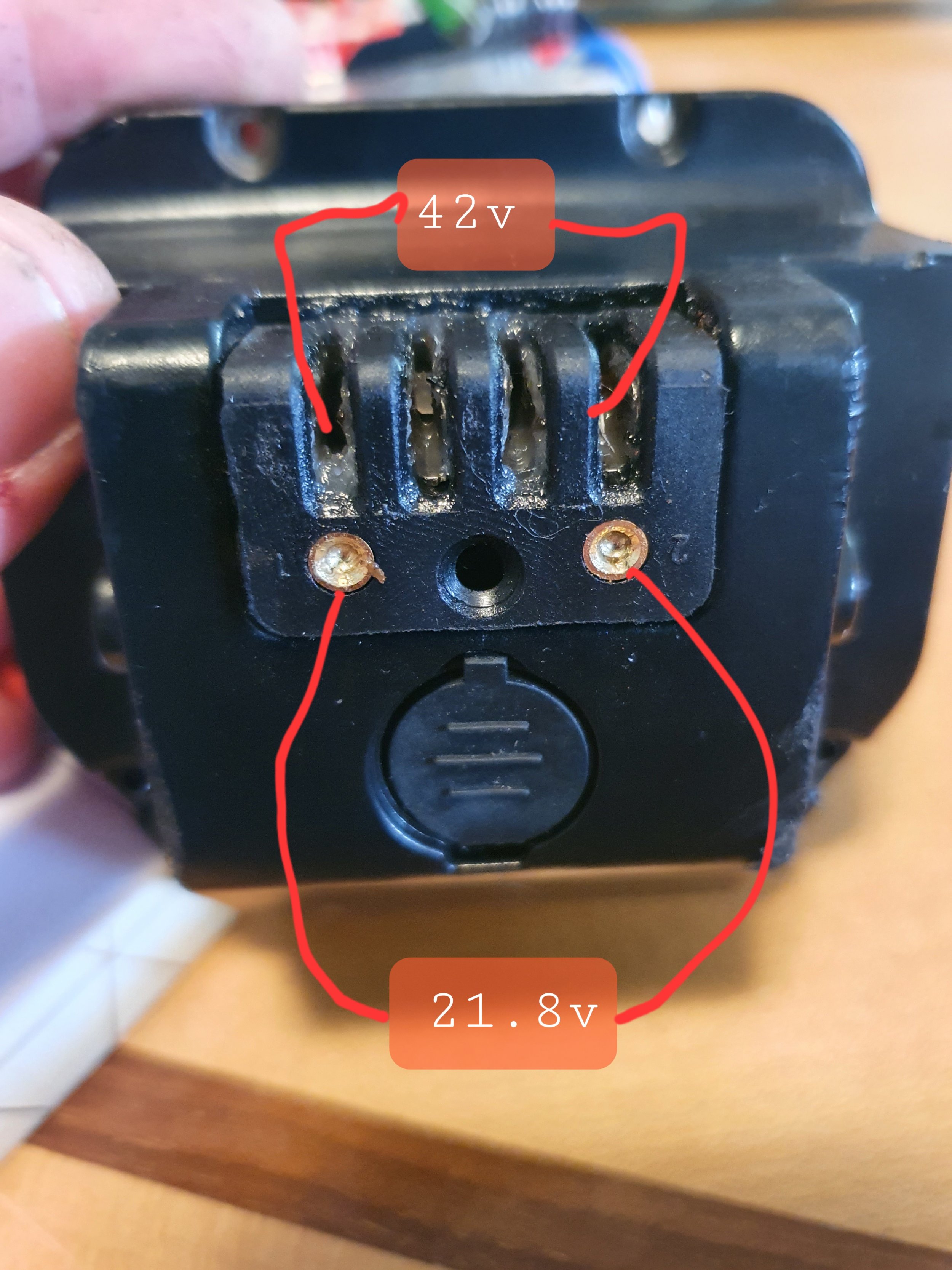

Thank you for reply. I will get back to your comment again later as for now I have no idea what 4 slot type terminal is. I am trying to fix a lemon that i bought so was looking for a wiring diagram from BMS to those pins. The battery now gives incorrect data, I will need to rewire it.
This is the 4 slot terminals i am talking about. (Marked as 42v)
The 2 other terminals (marked as 21.8v) are the ones that go to the "SW" terminals of the BMS.

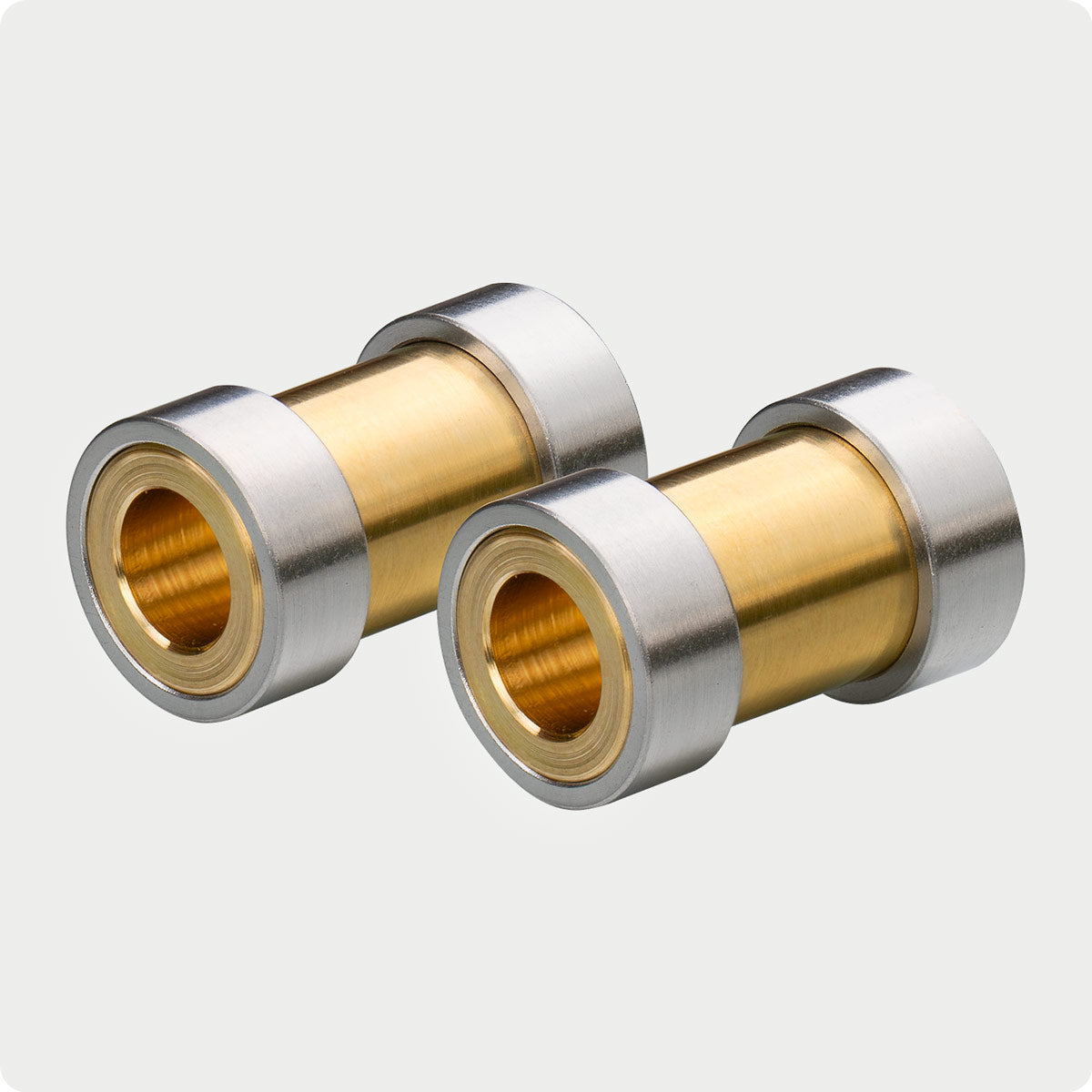

Also just got the E22 today. Mine didn't come with shock mounting hardware did you guys did?

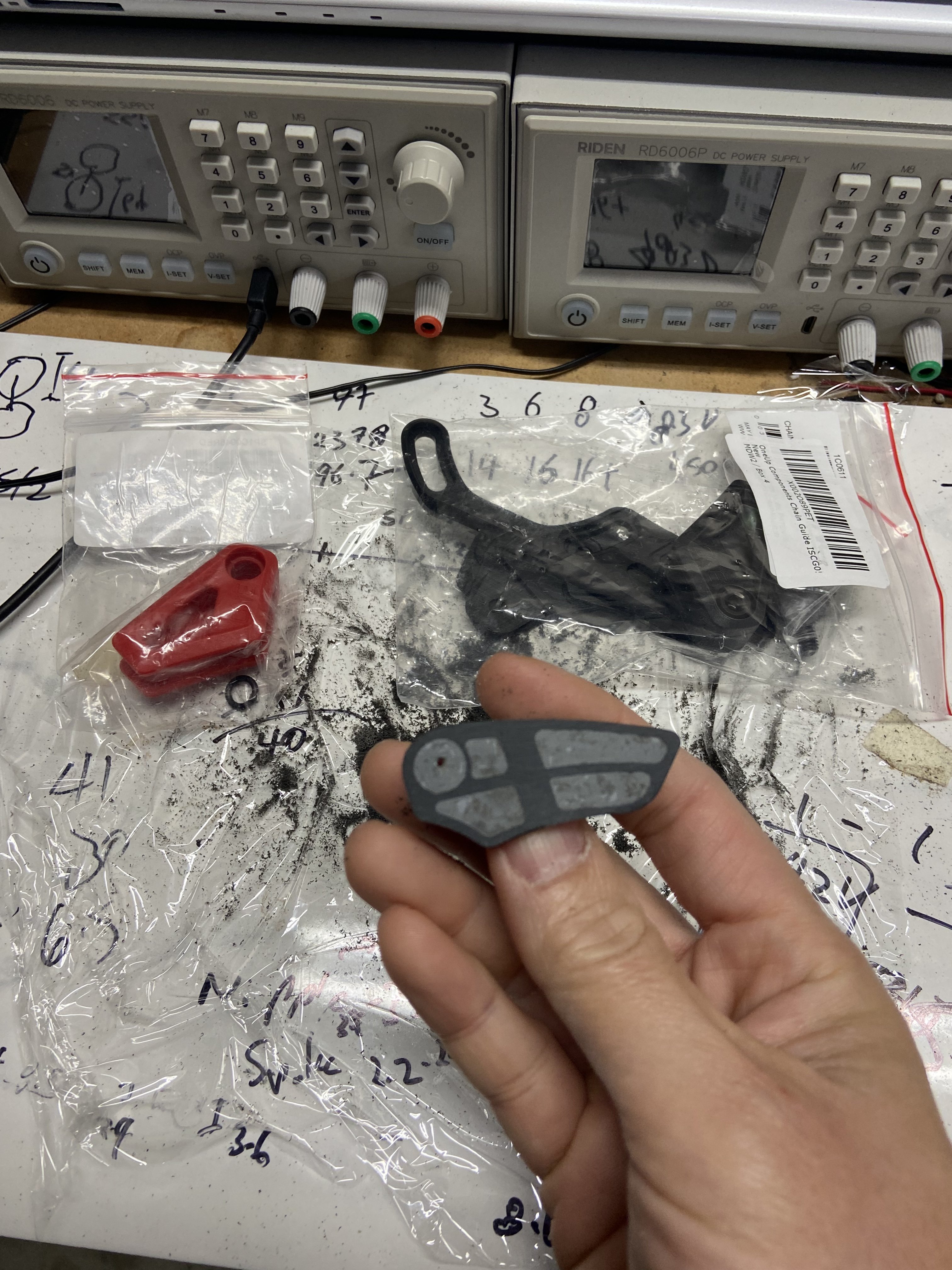

Thinking of getting 1 or 2 sets of these:
TeoElFeo
Apr 13, 2022
185
63
Tallinn
hmm, I might be interested to have a second battery. How much?
These are the correct ones, I have ordered those myself.

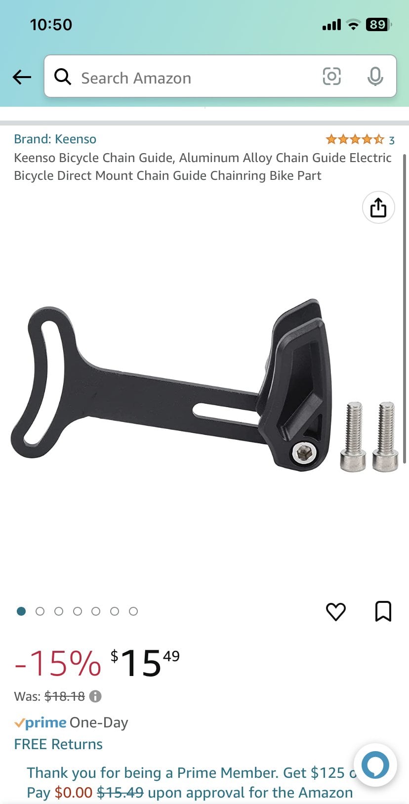

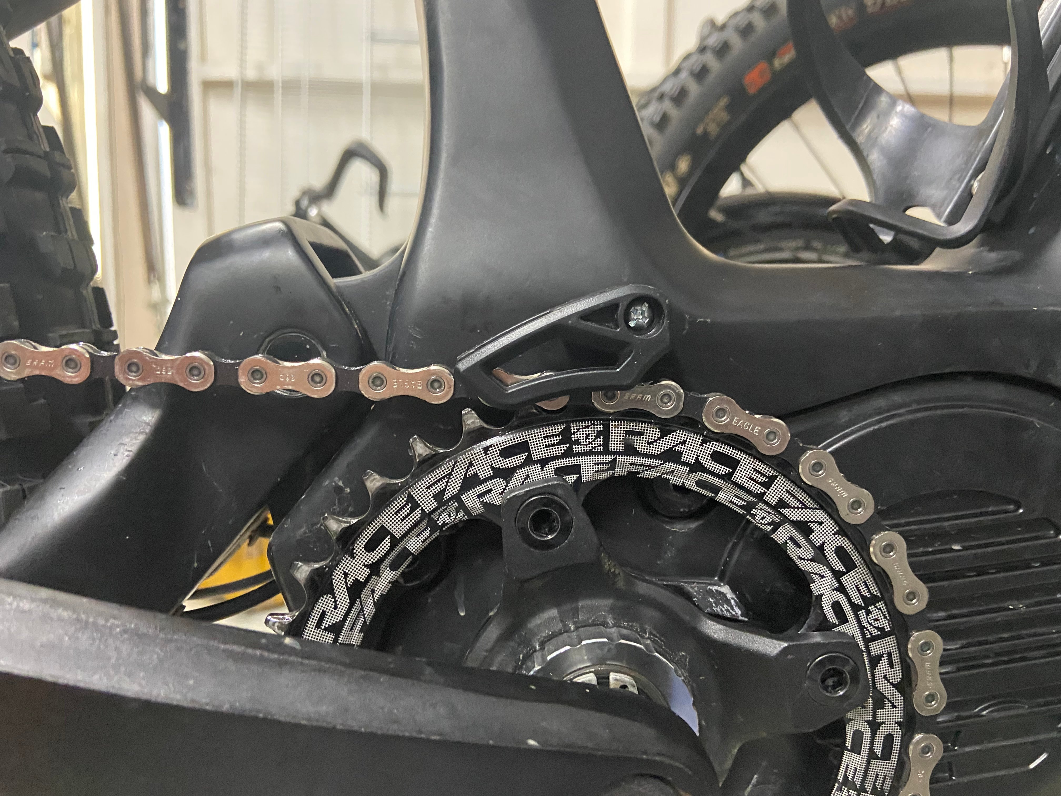

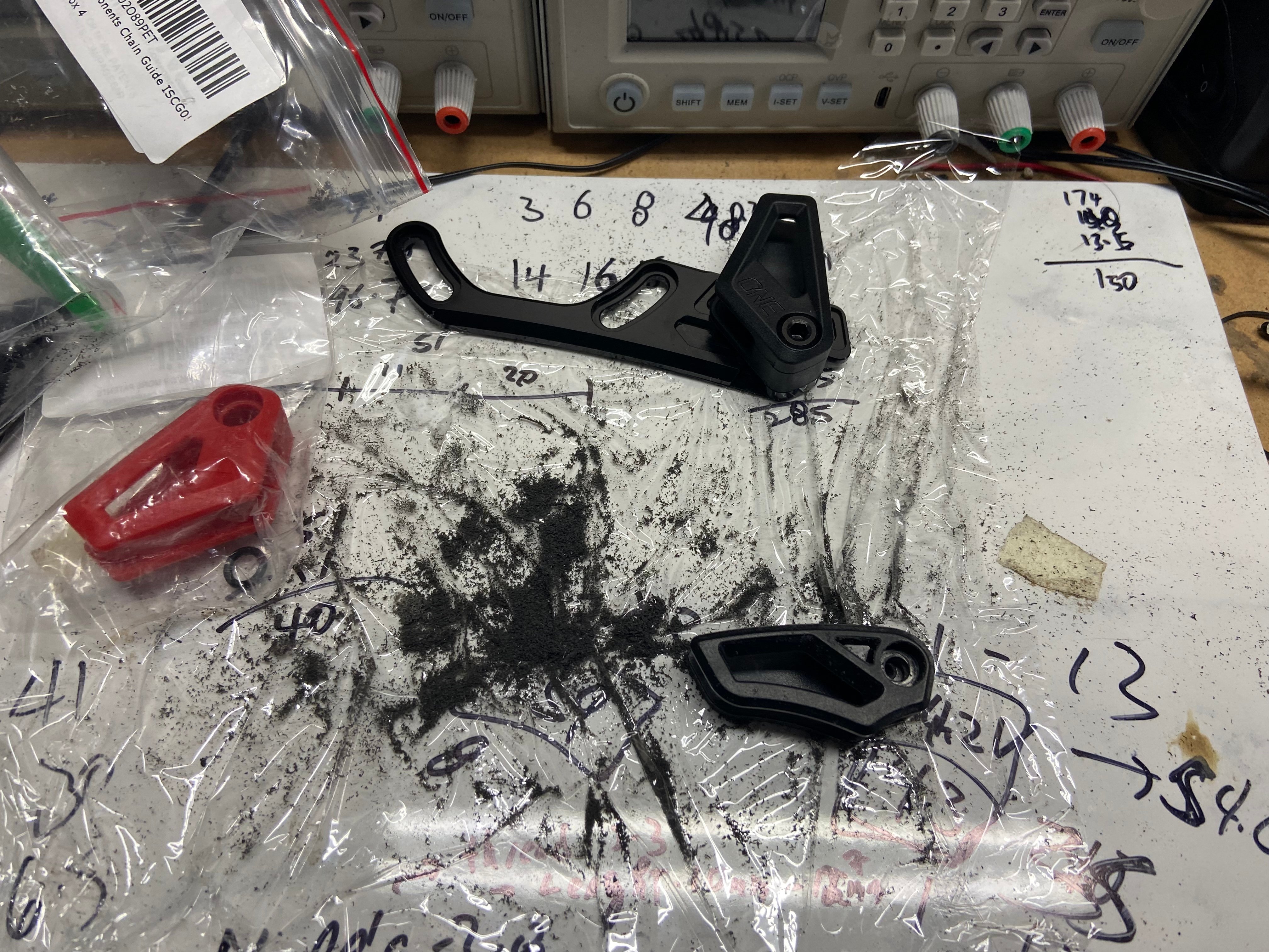

Hi team, does anyone knows where we could buy one of these?
I used one of these. I had to do some work by filling the back side with epoxy so I could secure it using double sided tape to the frame and filed it down a little so it doesn’t rub on the chain. It has not fallen off yet. 😅
The Oneup chainguide would work also with some modifications.
Granted it is not adjustable to different size chain rings, but I have no intention to change my 38T setup. If I do, I can always redo the double sized tape.

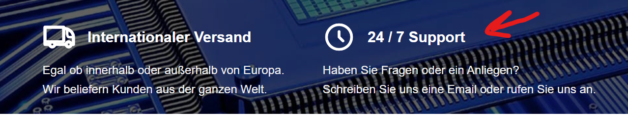

Same experience with Innotrace - poor response before the purchase of the unit from them and no response after the purchase of the unit from them. My guess is they do not speak English (it is noticeable in their "English" instructions on their support page) and maybe use Google translate for response and it is probably a big struggle for them they do not want to deal with.
It is funny they advertise 24/7 support

Yeah, I noticed that as well (24/7 support advert). I also tried calling their phone number at one point near the end and no answer there either.
I think the language diff could be a factor, but I got the feeling there was more to it than that (totally speculating, though). I had an order and just needed a couple adjustments before finalizing payment, but never heard back and stopped trying at that point. Seems like that might have been worth the follow up ;) (+fwiw, I had kicked things off in both English and German in the first email several months prior and they said English wasn't a problem)
Anyway, sounds like I wasn't alone in my support experience, which makes me feel a bit better about my decision (I was previously hard sold on going Innotrace for this build). Still a lil bummed, since I had read good things about their controller/responsiveness/efficiency (though, I think the efficiency may just be a side effect of using FOC).
